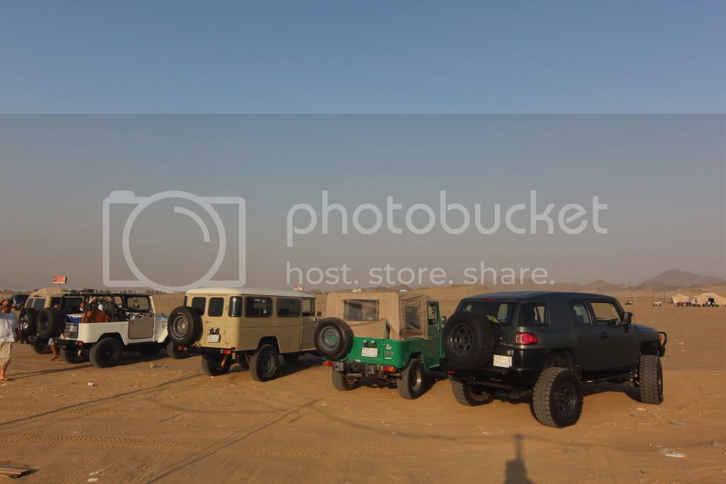

Here are a few pics from our small outing last weekend. It was a fun day, and the troopy held up well along side the other rigs.
On the road to the desert. CRUIZA's '83 FJ40 shoring up the rear.
Mcladin's awesomely painted matt white '82 FJ40. I owned this puppy 6 years ago, didnt do much with it, and then sold it to Mcladin and he did a complete resto on it.
The group also includes surf n turf's sick FJcruiser on 6" fabtech lift and 35s.

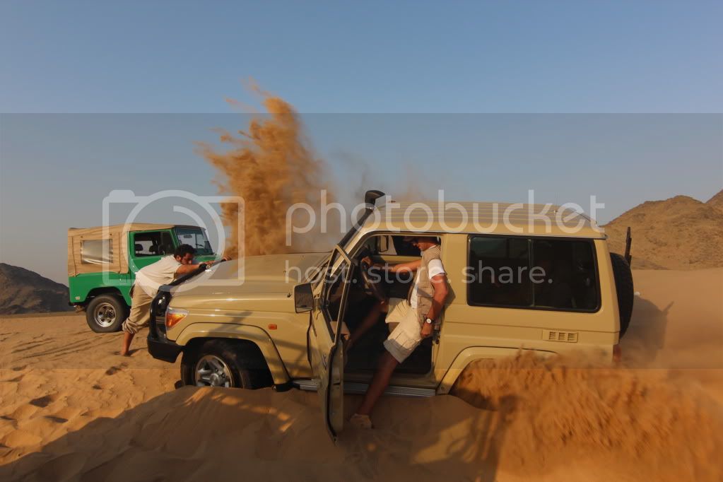

Returning back after dark, the troopy got stuck, and needed some winching action to get free again.

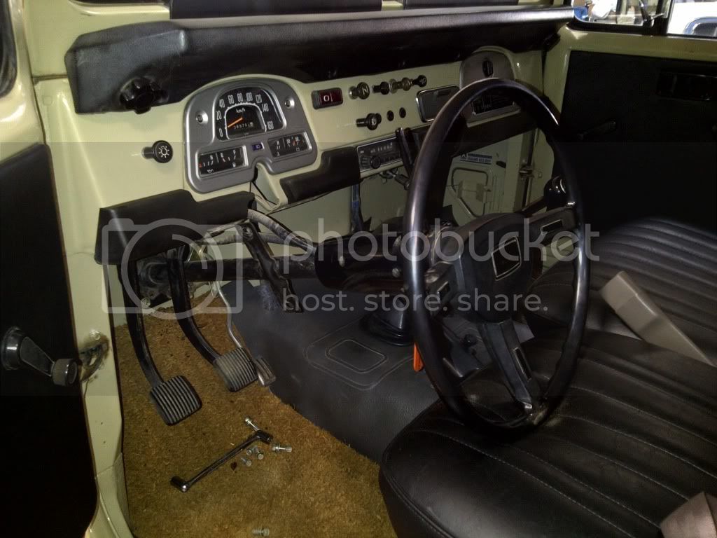

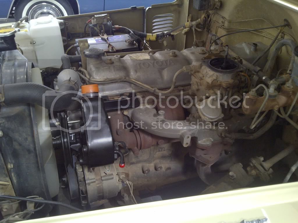

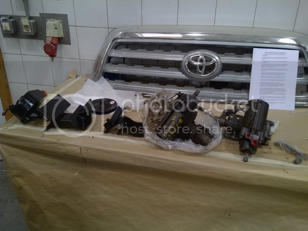

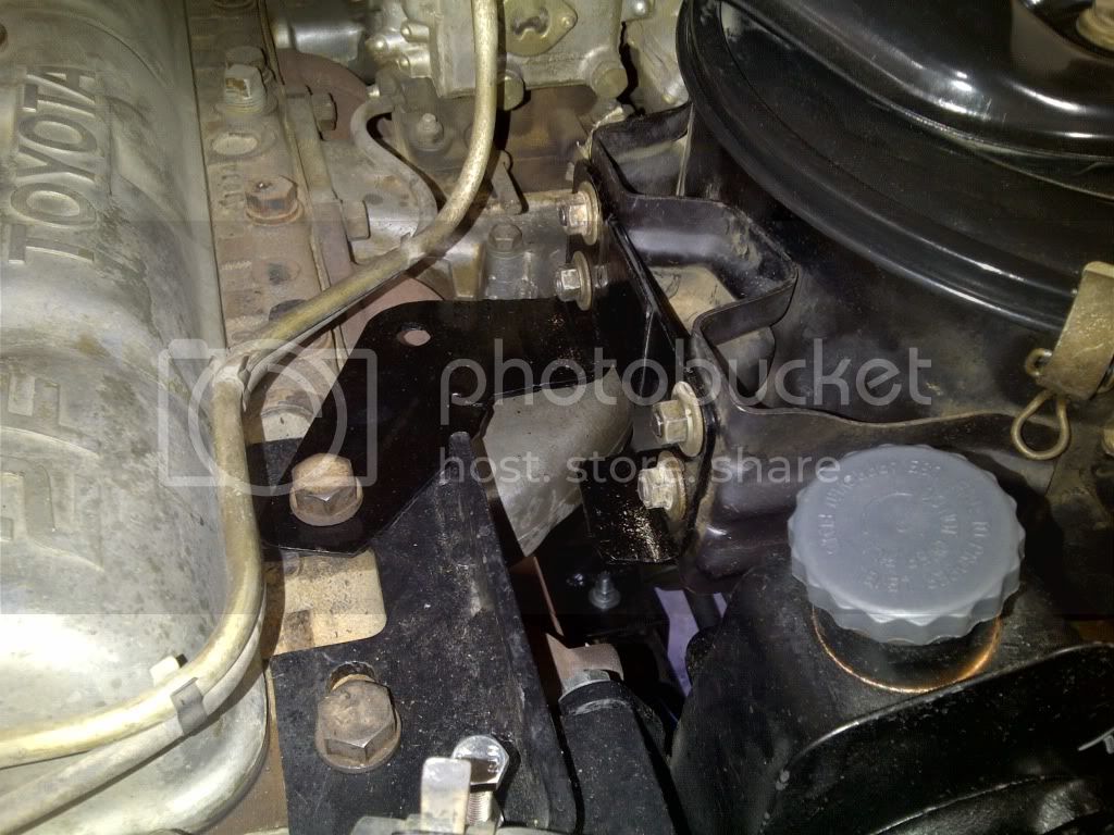

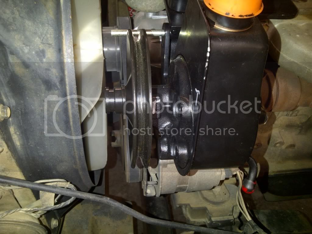

All you purist please do not read on, for I had the PS kit installed, and it contained a GM pump:meh: I was desperate and it was the only thing I could find. Here are a few shots
All the parts
Steering column loosened to allow install for the reman Toyota PS box
Pump

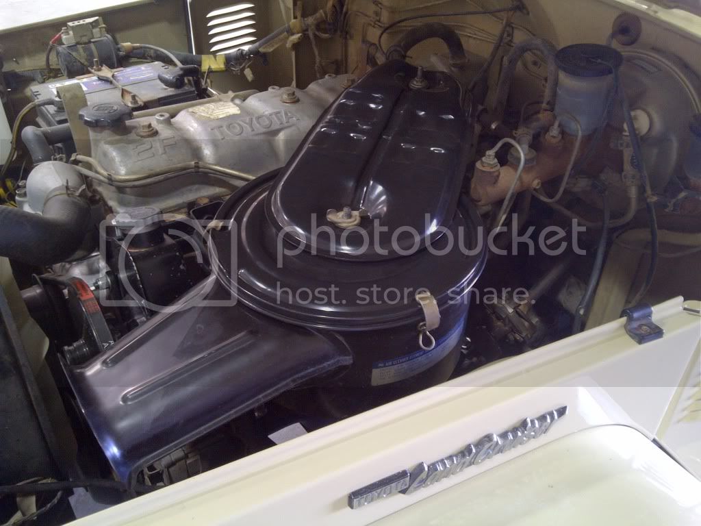

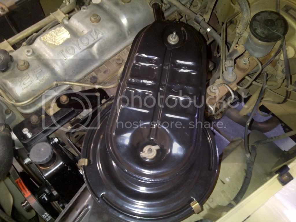

Ran into a snag as the air box no longer fits in its original position, as the stock Toyota pump is mounted on the other side of the engine.:mad:
After much debate and fiddling around, we decided to shorten the arm between the carb and the air box. We cut out about 1.5" and re welded it back together.
The finished article.
We fabed a new bracket to fit the air box. Bolted right into the same place as before.
At least to the naked eye it looks stock and in its original position.:p

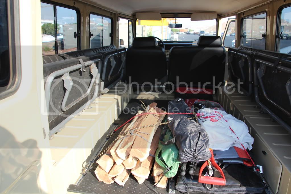

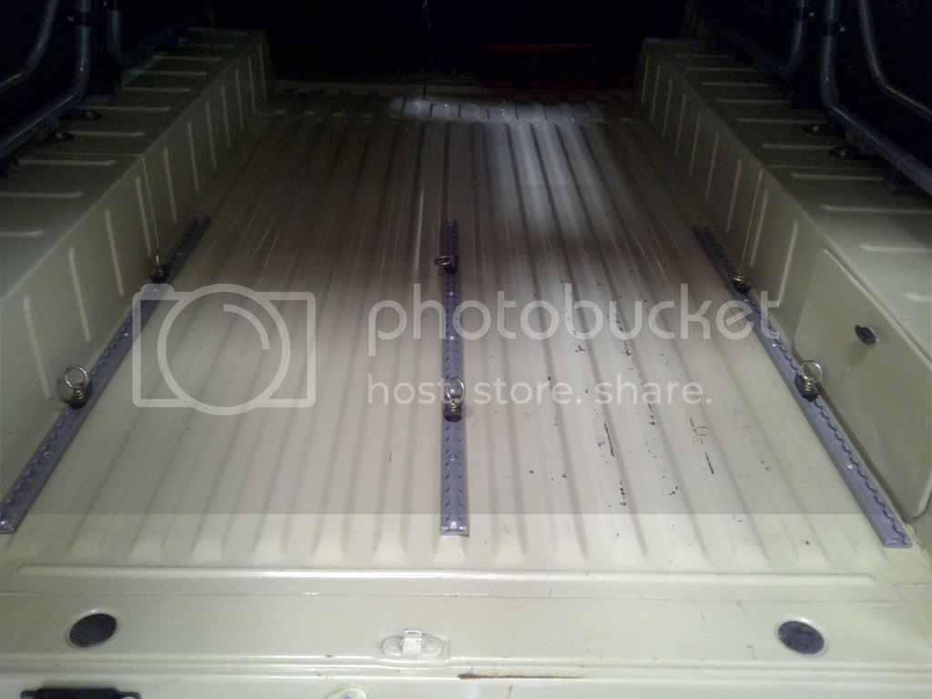

Also managed to get a set of tie down racks, and had them drilled in. Its a great product, and extremely effective for tying down junk of all different sizes. I love the adjustability of it.

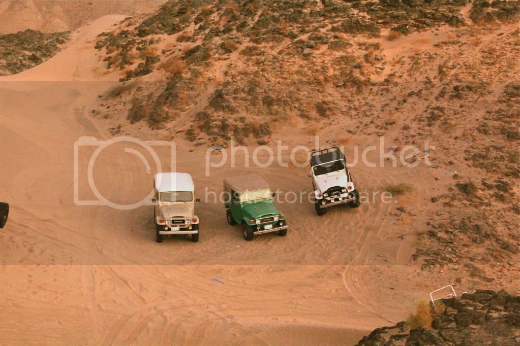

The weather has been fantastic the last couple of days, down to 20C. Rounded up CRUIZA in his newly painted matt beige FJ40 (it was previously turtle green), and we hit the dunes at Bahra, 20mins outside of Jeddah. We went for a light afternoon run, with a small bbq thrown in at sunset.
A few shots of the trip
The rig drives like a dream with the new PS kit. Dont know how I lived with it before!
CRUIZA making his way up around the back, passing an abandoned torched Hilux
Kicking it up a crest. Spot another 40 in the background

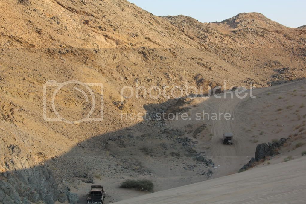

Our playground for the afternoon

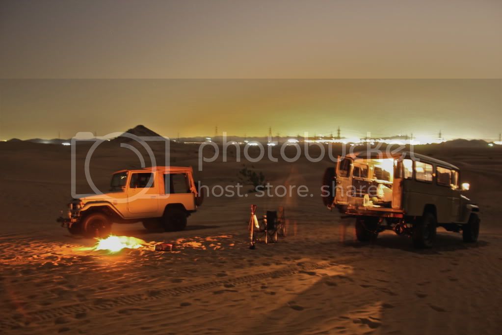

Some long exposure shots.
Another

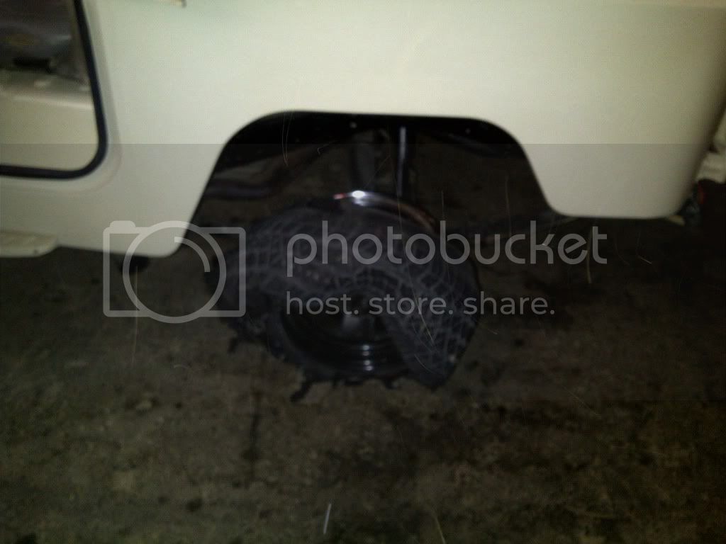

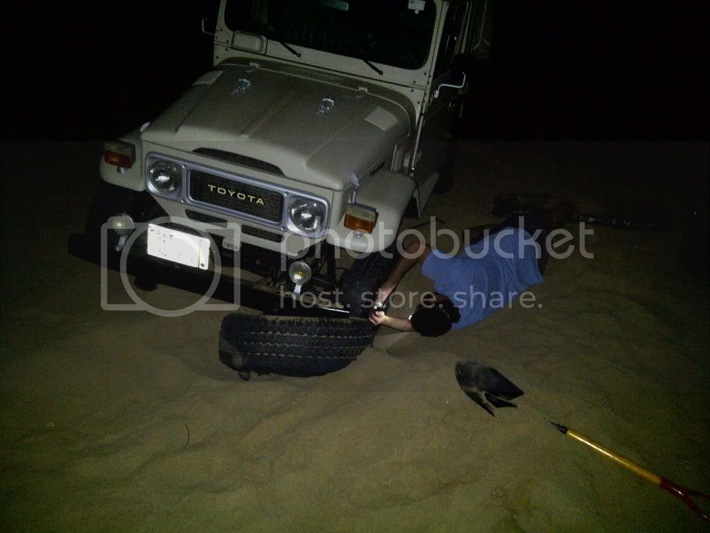

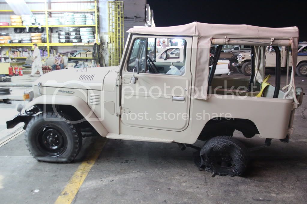

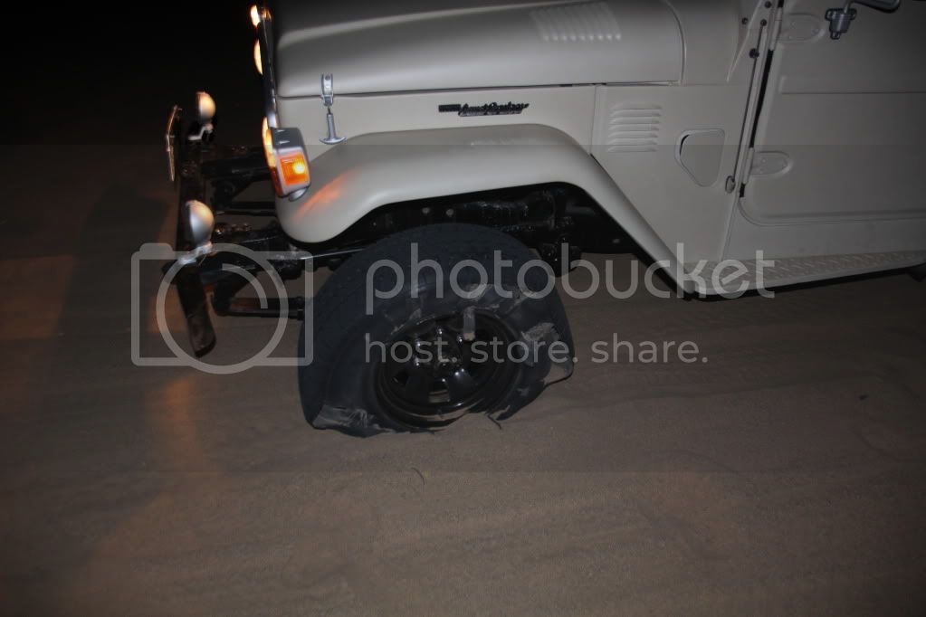

CRUIZA blew a tire on the way back.
Without our highlift jack, or the exhaust balloon lifter, we had to settle for the bottle jack to lift the rig. Needless to say it wasnt successful, and so we propped the rig up with the blown tire, and dug a hole deep enough to fit the spare.

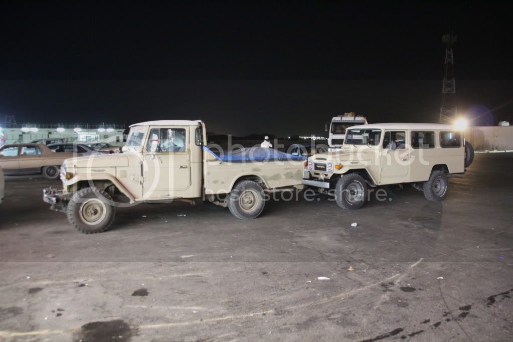

Right after we dusted ourselves down from this, CRUIZA's bad luck continued and the rear tire blew.
Luckily the petrol station, that doubles up as a tire shop was just down the road. CRUIZA managed to limp in.
And here our troopy and FJ40 found another member of the family. This one was beaten up, and looked like it had some serious miles on it:steer:

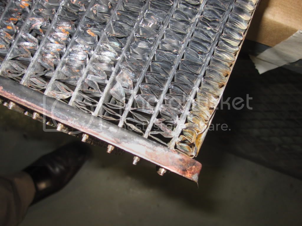

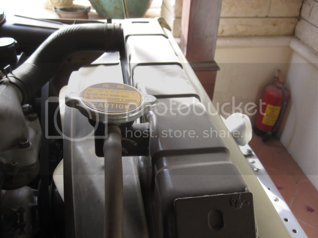

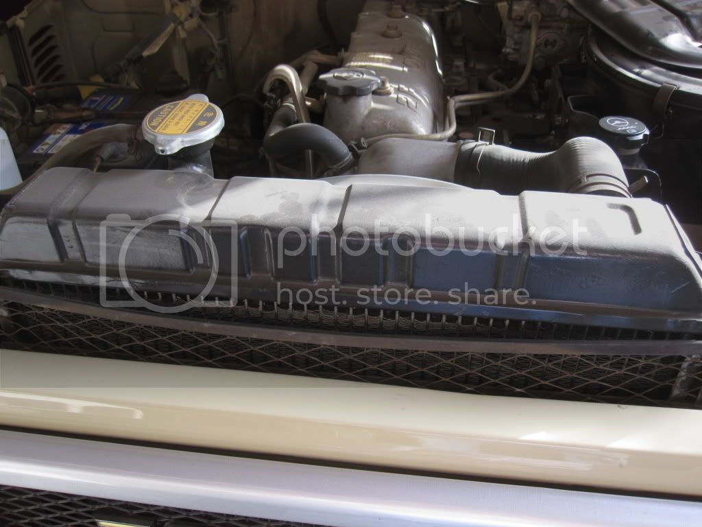

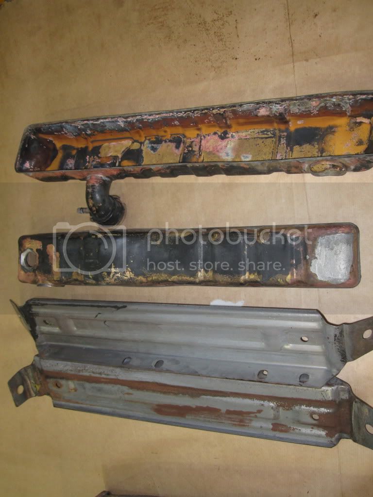

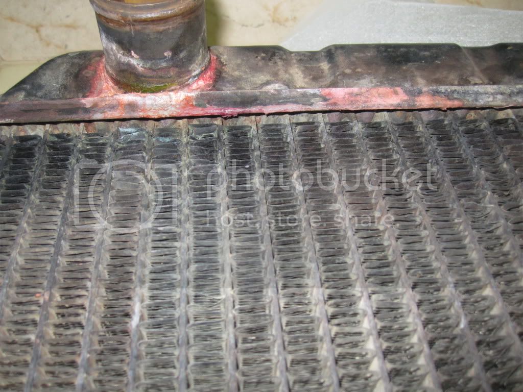

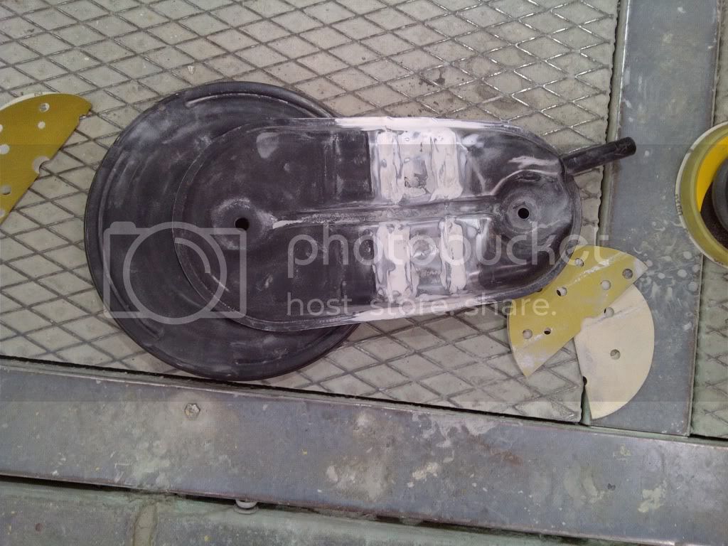

Here is a small belated update. We had the radiator checked by a vendor that does a lot of work for us repairing radiators for our customer's diesel generators. I had them take a look at the leak, and upon taking it apart, they immediately traced the source, and said the whole unit needed to be replaced. I was planning to get an original one from the dealer, but the vendor gave me an offer I couldn't turn down: a free unit. Albeit not original, its a reman unit from Jordan. Its got 2 more cores than the original, and I've used it now for two months without any issues. So far.
The original unit
Stripped down.
The leaks origin.
The new unit.

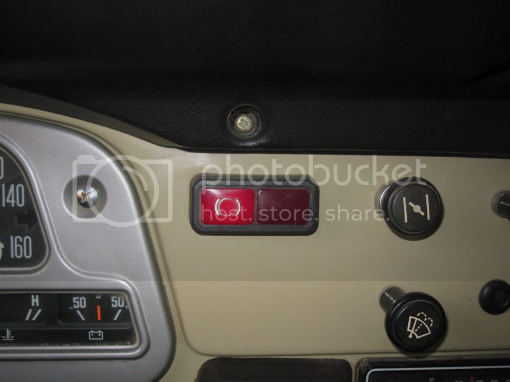

Got a little issue that I cant seem to troubleshoot. Whenever the parking brake is released, the parking brake light does not switch off. What seems to be the issue?
You were doing so good up to this point! That's ok, you can always go back and change the pump to a Toyota pump.
