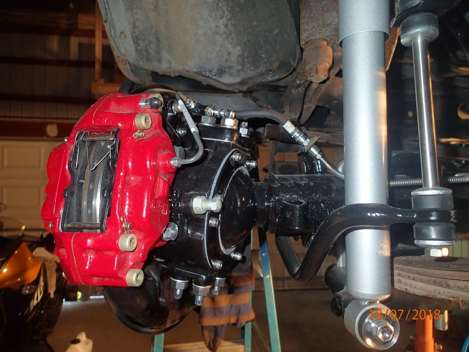

Cleaned Chassis etched and solvent prepped and Por-15 and top coat
I'm a huge POR15 fan and have had really good success but you have to follow the instructions particularly prep to a "T" You'll have people who don't like POR15 but it works for me.
