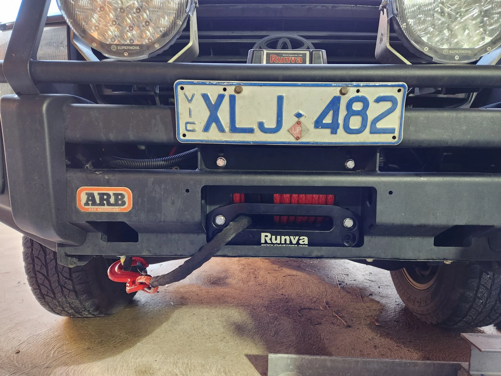

Way less swearing than I was expecting. Probably took longer to connect up the cables than it took to bolt on the winch.
A question though about the fairlead.
To make the fairlead work its only held on by two bolts, which are the same two bolts that hold the winch, as shown.
The bolt is long enough to go all the way through, but is two bolts enough to hold it into position? I was too lazy to drill out the two lower holes, as I would expect 2 bolts would have enough strength for 13,000lbs of tension.
Would that be a correct assumption?
