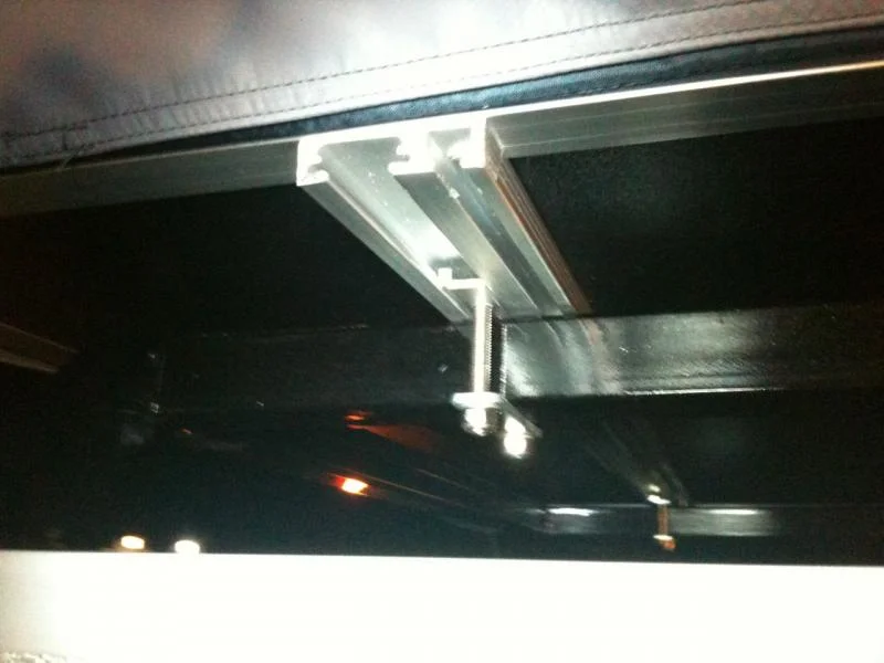

Sorry for the delay...this is the ARB Simpson III on my bars...
how many screws/bolts are holding the channels to the tent itself?
Each channel gets 2 bolts going through the floor and the channel..it also gets to small ( 3/4" - 1" ) screws that go into the edge channel at the very ends...
The instructions were obviously written by an egineer...because sure as hell anyone that knew anything about proper layout, bolts, nuts or connections didn't write them...
I have a eezze awn RTT and the mounts are similar to the one on the pic above..
I installed mine right on top of the trailer roof (drilled holes on the alum lid).
