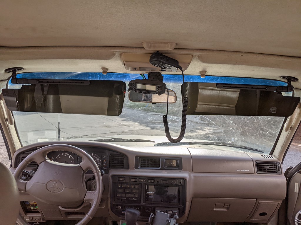

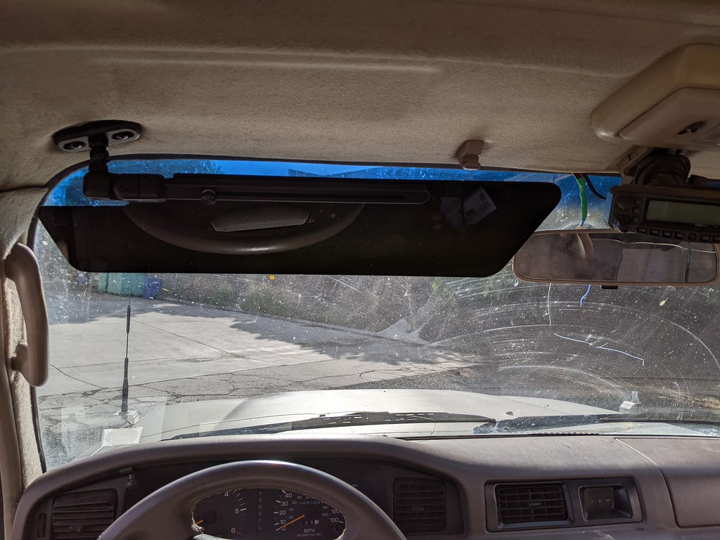

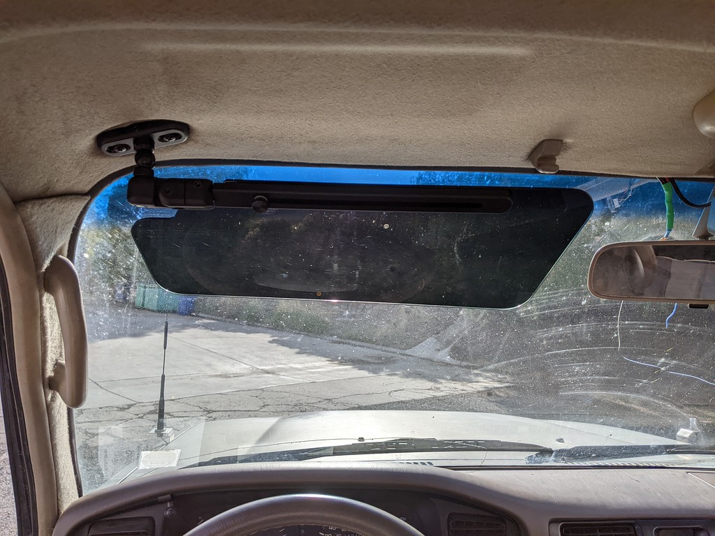

Here is what I came up with. I special ordered a 'dark grey' transparent cast acrylic sheet. It is more along the lines of a light welding helmet shade whereas I would describe the Rosen lenses as a not so dark sunglasses shade. I had to order a full 4' x 8' sheet. The color Rosen uses is a custom color that they have manufactured for themselves, the color I used is a special order color that is made in limited quantities so it's not generally stocked at any supplier I could find.
Here's the new lense I made:
I made it significantly wider than the original lense. The origin lense did not fit the truck properly and when driving directly into the sun, you constantly had to slide the thing back and forth. This corrects that issue and it still moves and pivots without interference pretty much as freely as the original lense did. My design is much closer to the OEM visor shape.
Here is the original for comparison:
Now both sides with my new lenses

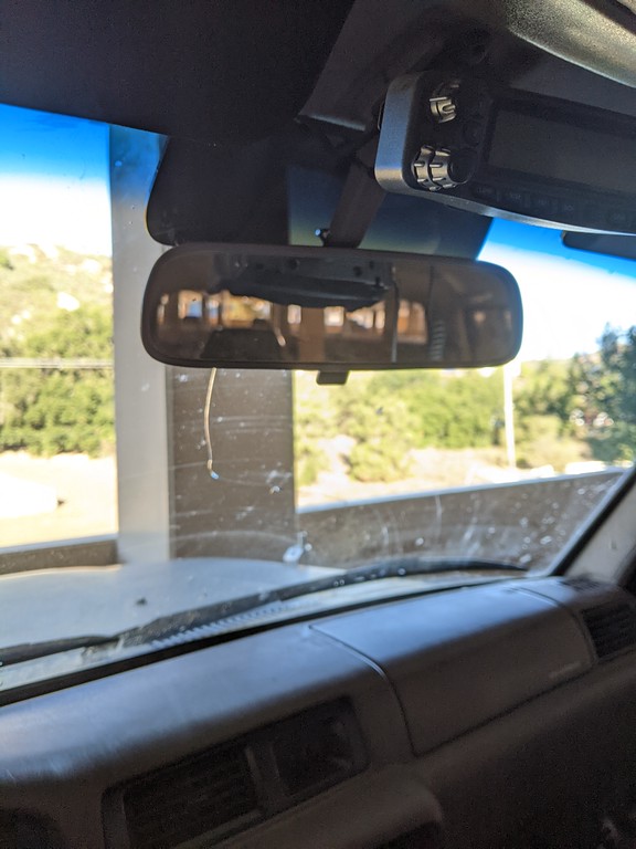

I also made this little piece that attaches to the mirror stalk and bridges the gap between the visors and the mirror, and also provides a place for my forward facing camera to mount. Yes my windshield is cracked.
I am much happier with these new lenses. They do have a slight color shift to them, they aren't as pure of a 'grey' as the originals were, these cast a slightly green tint to the image when looking directly into the sun, but it is minor and the added shade level and added coverage is worth the slight color shift. The extra width to get full coverage is really good, there will rarely be a time I need to slide them into any position other than the default. There is enough transparency to see a stoplight through the lense which is nice.
