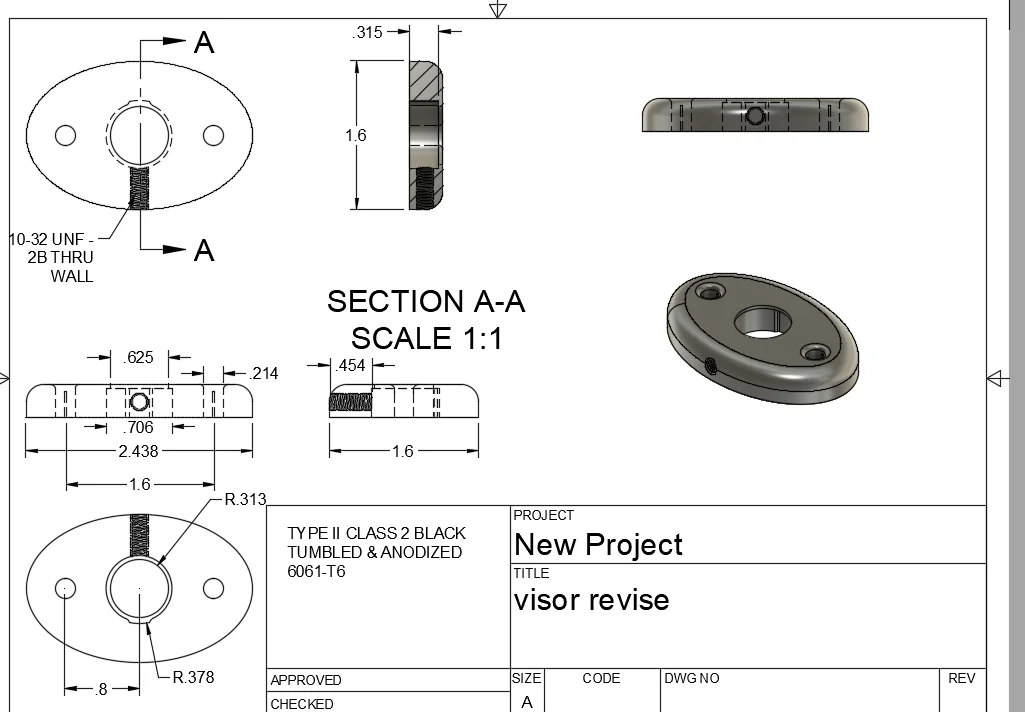

Got a drawing from them with some good specs and may have enough to get some made and test fit but still need to check fitment with the actual visor and would MUCH rather do a one stop shop with the proper mount to save a little $$$. The nice lady I talked to there said if I pulled the trigger they would likely swap me a base when finalized but that was a year ago. Thinking it would be fun to say WTF and see if I can make these mounts work. Just forgot to stop by the local shop to see if they would entertain machining this on the way home today... Seems like a lot of places online now to send this 360 drawing to and they would machine and some even would anodize and clean them up.
Any Rosen reps on here that would take my donated time to use this and finalize this mount if I didn't butcher this too bad? Willing to sill pay full price, just want to get this over with already.😂

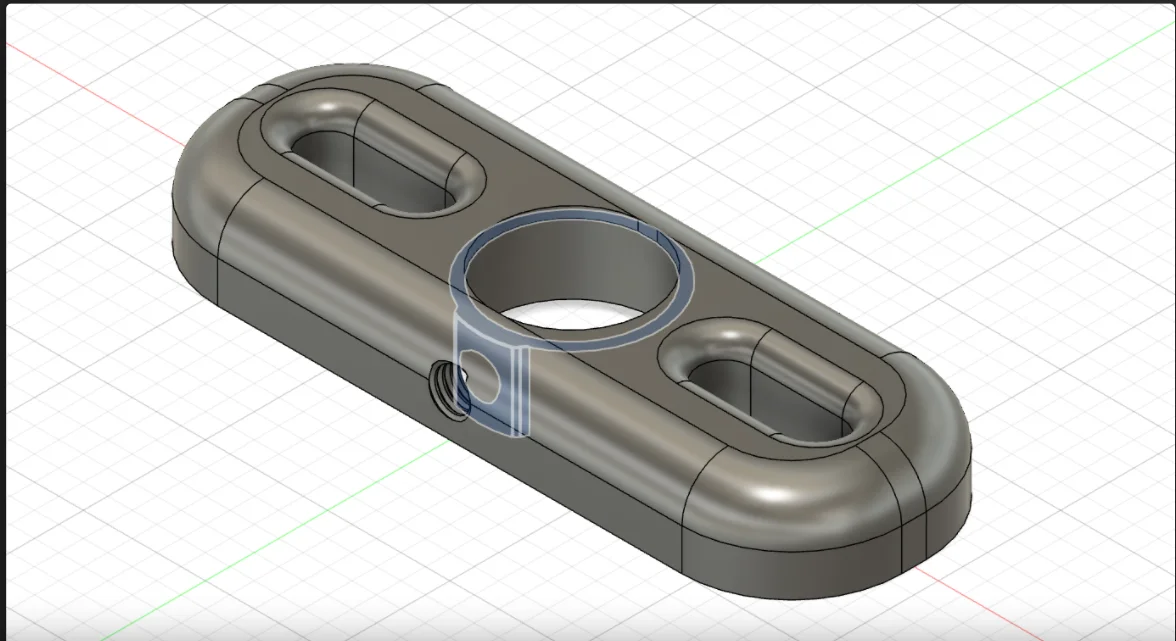

Made this off a few quick measurements on my OEM set. May need a few tweaks and need to import the proper black screw mounts from McMaster-Carr. Sounds like the OEM length works well. Along with a longer 10-32 set screw, but don't see why their shorter screw wouldn't work. Fixed mount and ditched the slots.
based this off initial drawing and should be pretty accurate of what they currently offer outside the slot on the set screw side.
Would be interested in a pair of correctly shaped mounts if ever available. The slotted thing works but it looks really stupid considering the price.

I actually did this and sent to Rosen a year or two before I started Wits' End. I thought they moved to the new design with the 80s going forward but maybe not. I could machine a bunch if needed.
