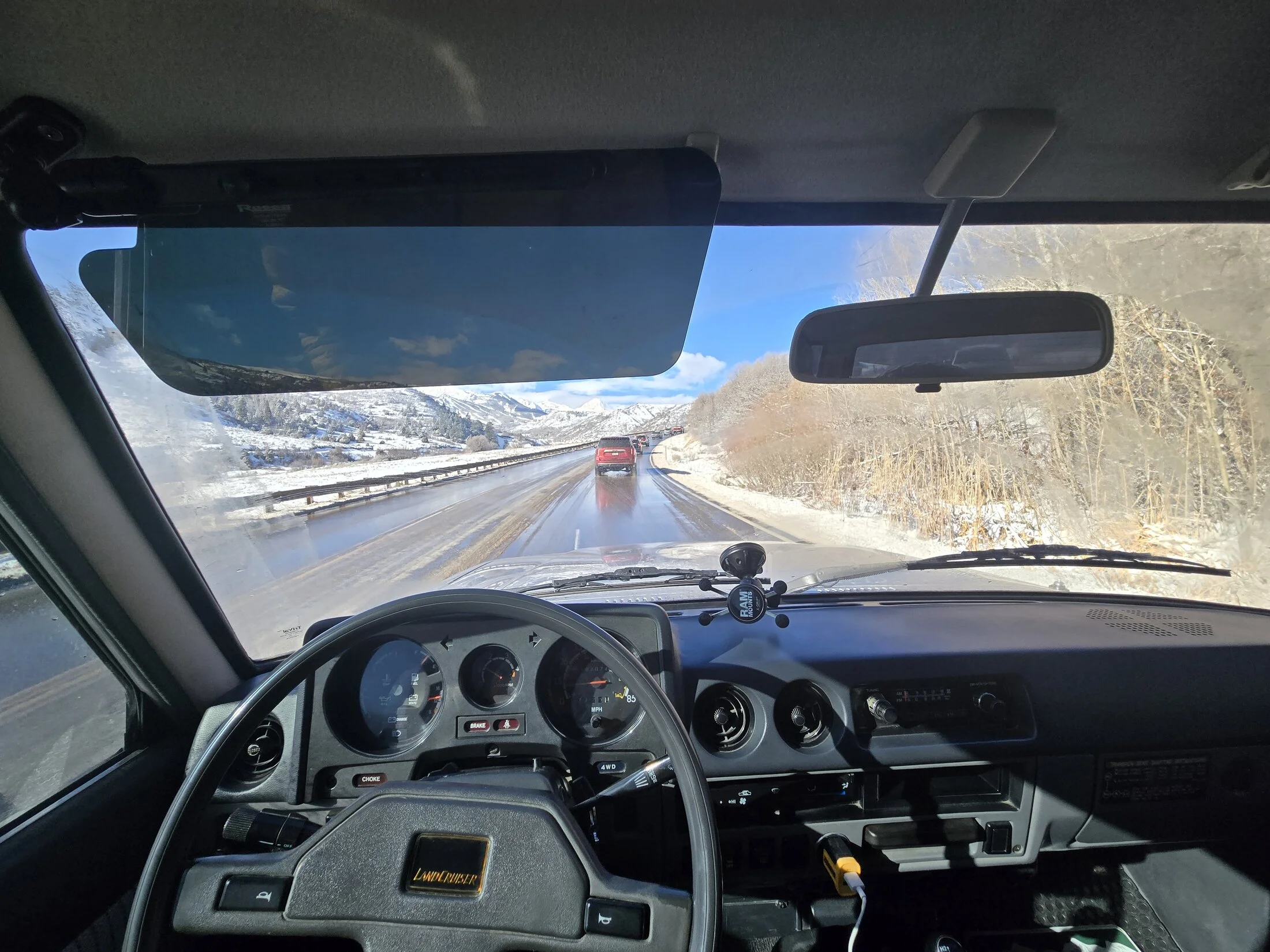

Moved mine to the 60. They rock! If you are wearing sunglasses the opacity is perfect, in my opinion.

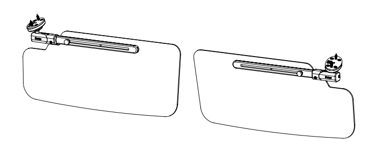

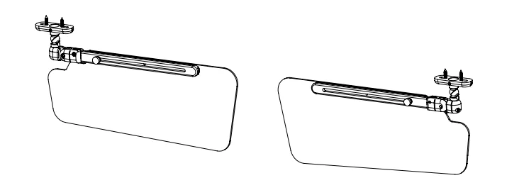

So I have been running the 80 without visors for years and finally decided to call and get a set. Great timing, they are releasing an 80 series specific set now. I think they start shipping in august and look to be $15 more that the original.
Part number
R1525600-0
Original
7S10075-0
From Dan @ Rosen
The approx. lens dimensions for the new design are 18” x 7.5” vs the 15” x 6” lens used in the original version. Also, the mounting plate on the new design is slightly larger to provide better coverage of the opening in the headliner from the LC factory visors. Below are drawings for both systems and attached are images comparing the 2 systems installed. The new version was designed specifically for the 80 series, but will likely fit on other models (except 40 and possibly 55 series)
