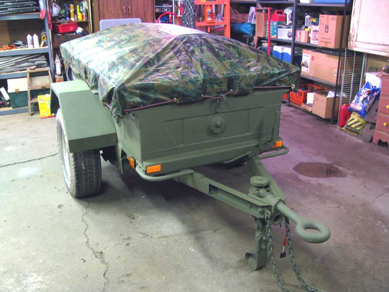

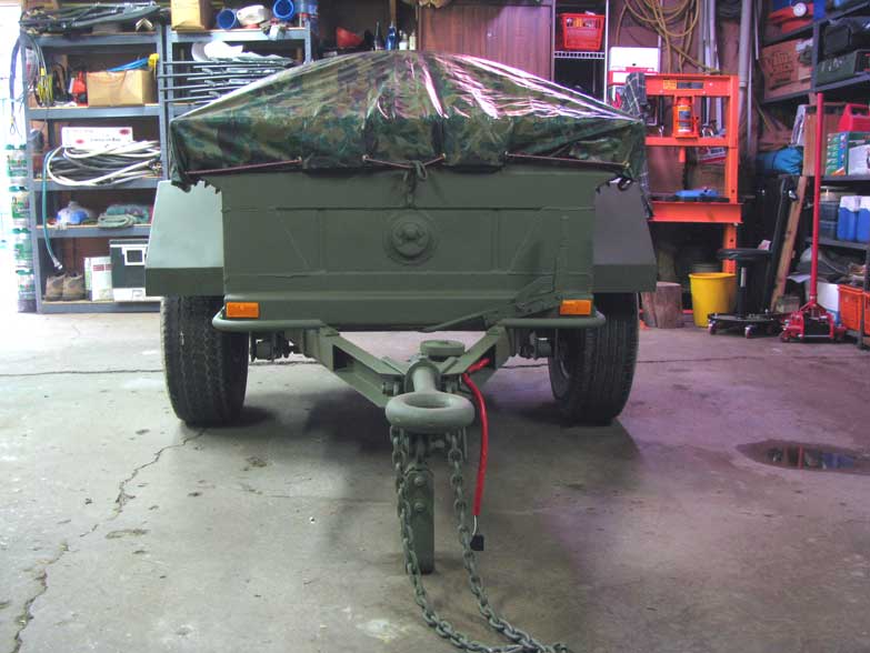

On our M101, I wanted to run the same rims as fit our 80, but it actually came with a set of narrower 60 series rims on it that already set the tires partway out from under the factory fenders. The 16x8 80 rims are even wider.
I just decided to have wider fenders built. So long as you don't go taller than 33", you don't need to SOA. It looks good, but wasn't cheap.
And with the 33s...
The fenders are wide enough you can set your water jug on them, conveniently enough.
