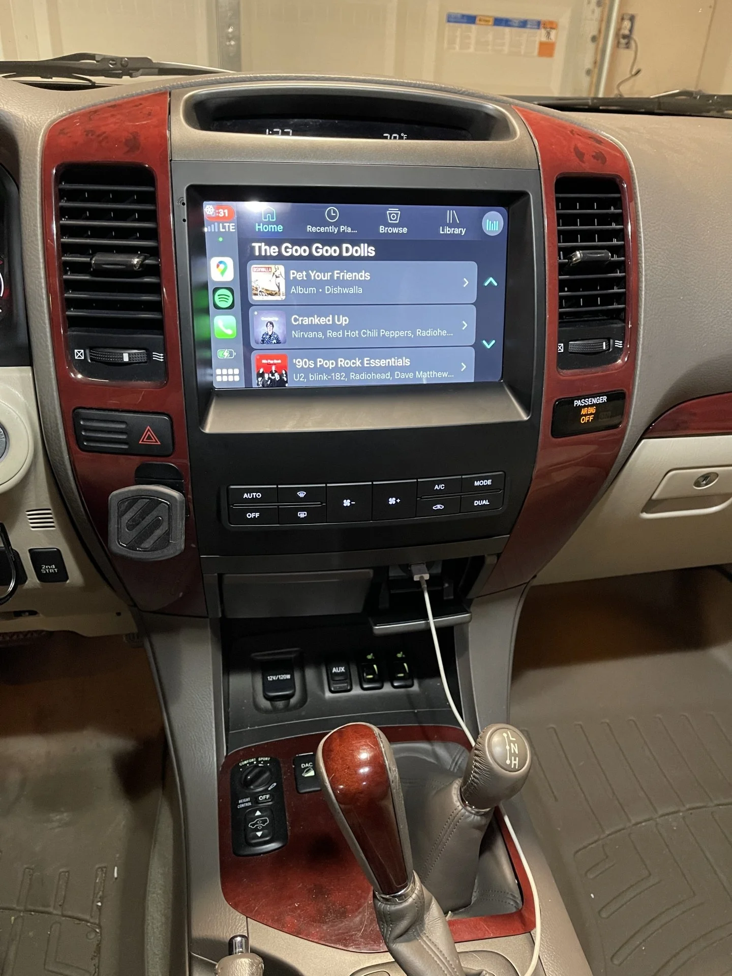

Good morning everyone! Longtime reader, first time poster. I recently acquired a 2009 gx470 with navigation. I was super excited to get one of the “Tesla” screens…until I got one and realized how horrible they were. More on that later. Bear with me as I’m writing this on my phone while I have some downtime at work. I’m sure I’ll forget a few things and I’m hoping some of you will ask questions that I can address in order to help out other navigation model owners!

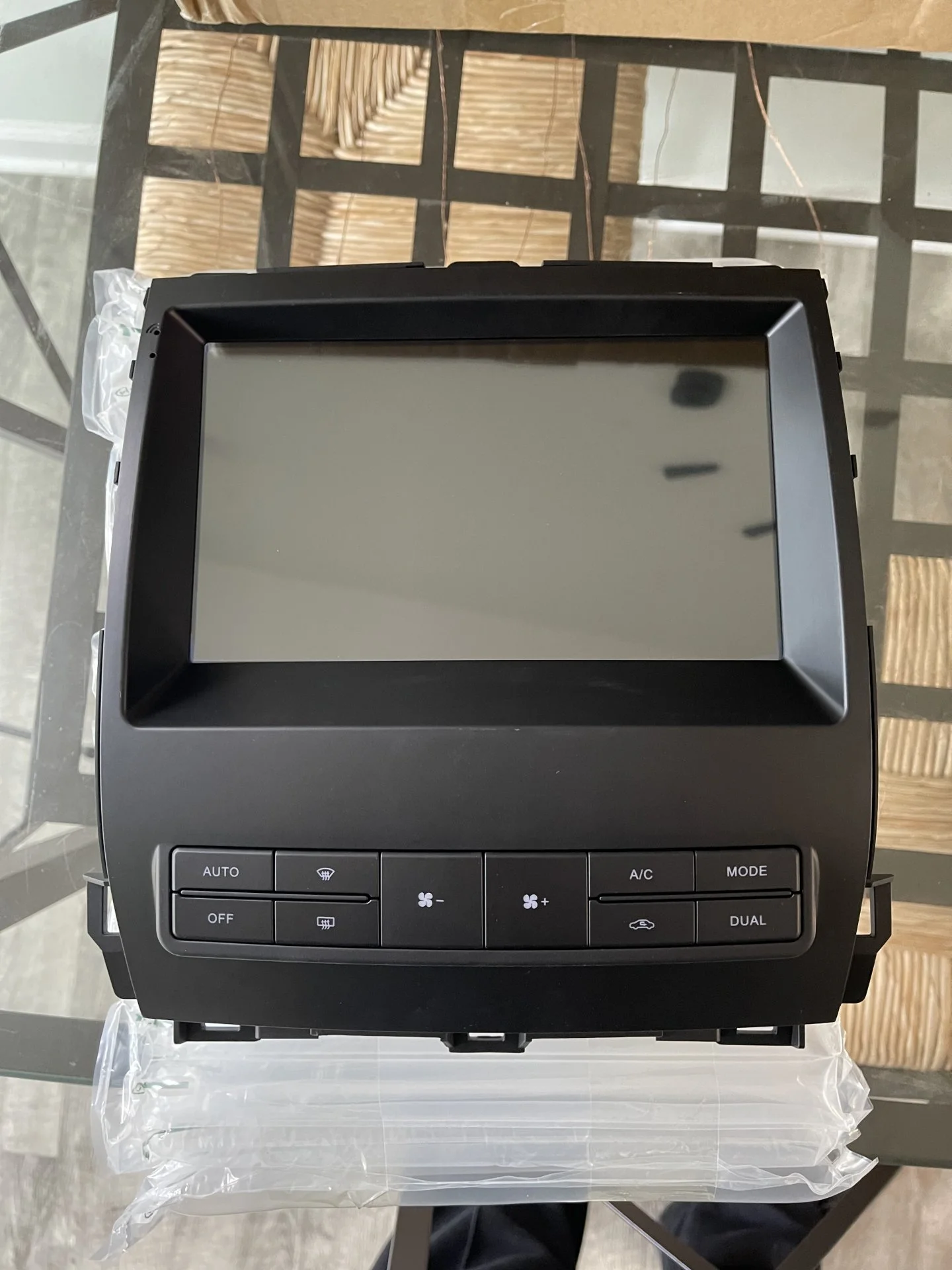

After sending the Tesla unit back, I ordered this unit from Ekiy on Aliexpress. This unit works navigation model 470s.
Ekiy Android Radio
I had seen a YouTube video of a similar radio from T’eyes with a 9in android and the same style faceplate with climate controls. It looked pretty decent but I couldn’t find it anywhere so I took a chance on the Ekiy.
I did not take pics of the installation as it was very straightforward. The wiring harness is simple and all the plugs are unique so they can only go to one place. You do have to remove the clock from your factory unit and attach it to the Ekiy. After that, it all just clips in. It is slightly recessed vs the trim pieces it’s not terrible but it’s not perfectly flush I’m terrible with measurements so I’ll just say it’s about the depth of an average pocket knife blade thickness
a second package came later with the usb cables, free backup camera, and the rest of the wiring harness. The factory camera will NOT work with this head unit
booting was fast but for some reason I had no audio. I can’t really remember how I figured this out but there was an app labeled “Car UI.” I clicked on it first and within the app is a radio, CD player, and something else, I forget. I clicked on the CD player and hit and then I all of a sudden started getting sound. I have no idea why this occurs but I have to do it every time I turn the car on. I can only assume that somehow this triggers the car amp? I have waited several minutes without pressing anything to see if it was just a time thing…but it wasn’t. I have also pressed lots of other buttons to see if that got me audio…but it didn’t. So for some reason you have to hit the Car UI button and go from there. This has been confirmed with another Reddit user who bought one at the same time I did. There is a factory setting for the amp which I turned on but it appears to have no play in this situation.
Car UI video
***i now believe this to be a canbus issue that I am working on resolving with the seller***
after figuring that out, I was quite happy with the radio. Everything functions wonderfully, including wireless carplay. One of my issues with the Tesla unit was laggy carplay. This Ekiy unit takes a bit to connect but so far it has been 100% reliable. Don’t judge the music choice, I was on a 90s kick

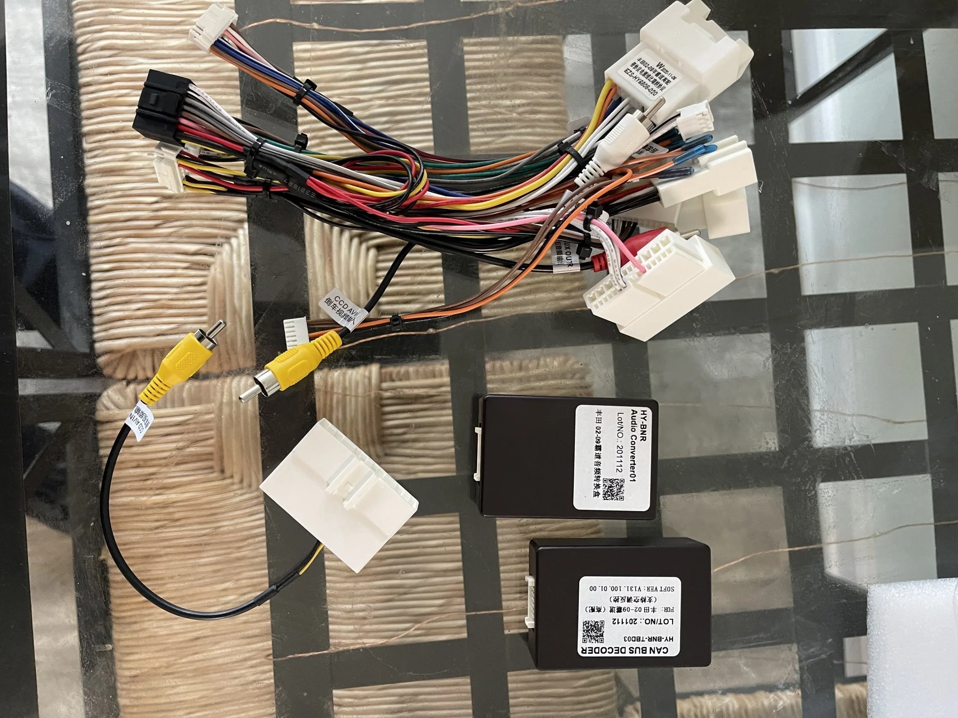

As mentioned in the nav to non nav swap thread, you will need two adapters to make your fm radio work.
Y adapter
Antenna adapter

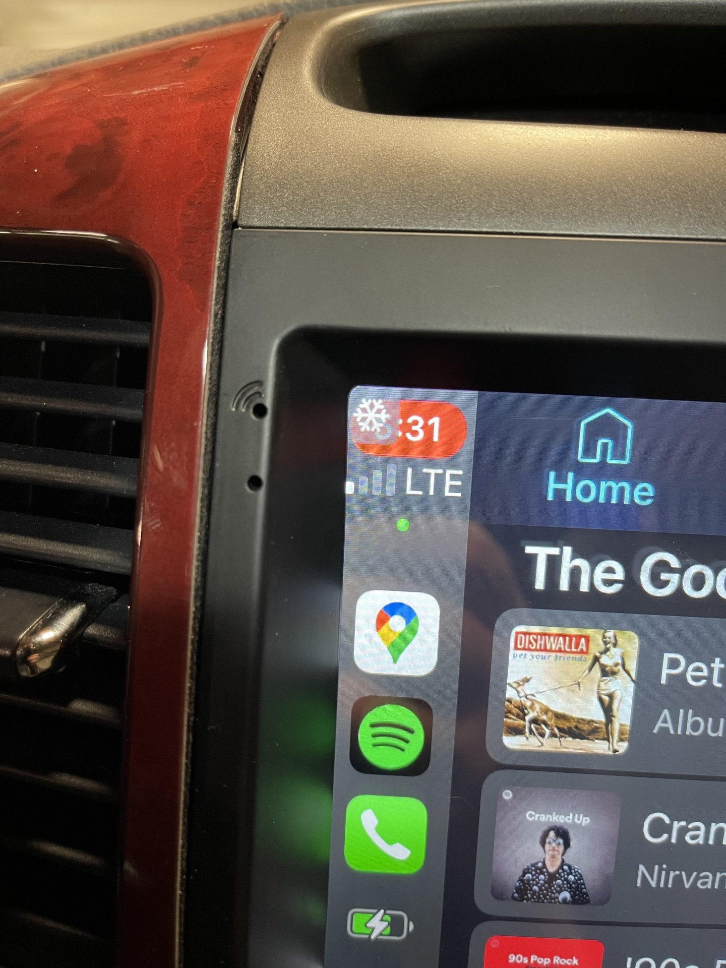

As you can see in the above pic, there is a front mounted microphone. This is a standard 9in android head unit with a face plate over it so the mic is recessed behind the faceplate. As such it is essentially useless and you will need to add an aftermarket mic which is not included.

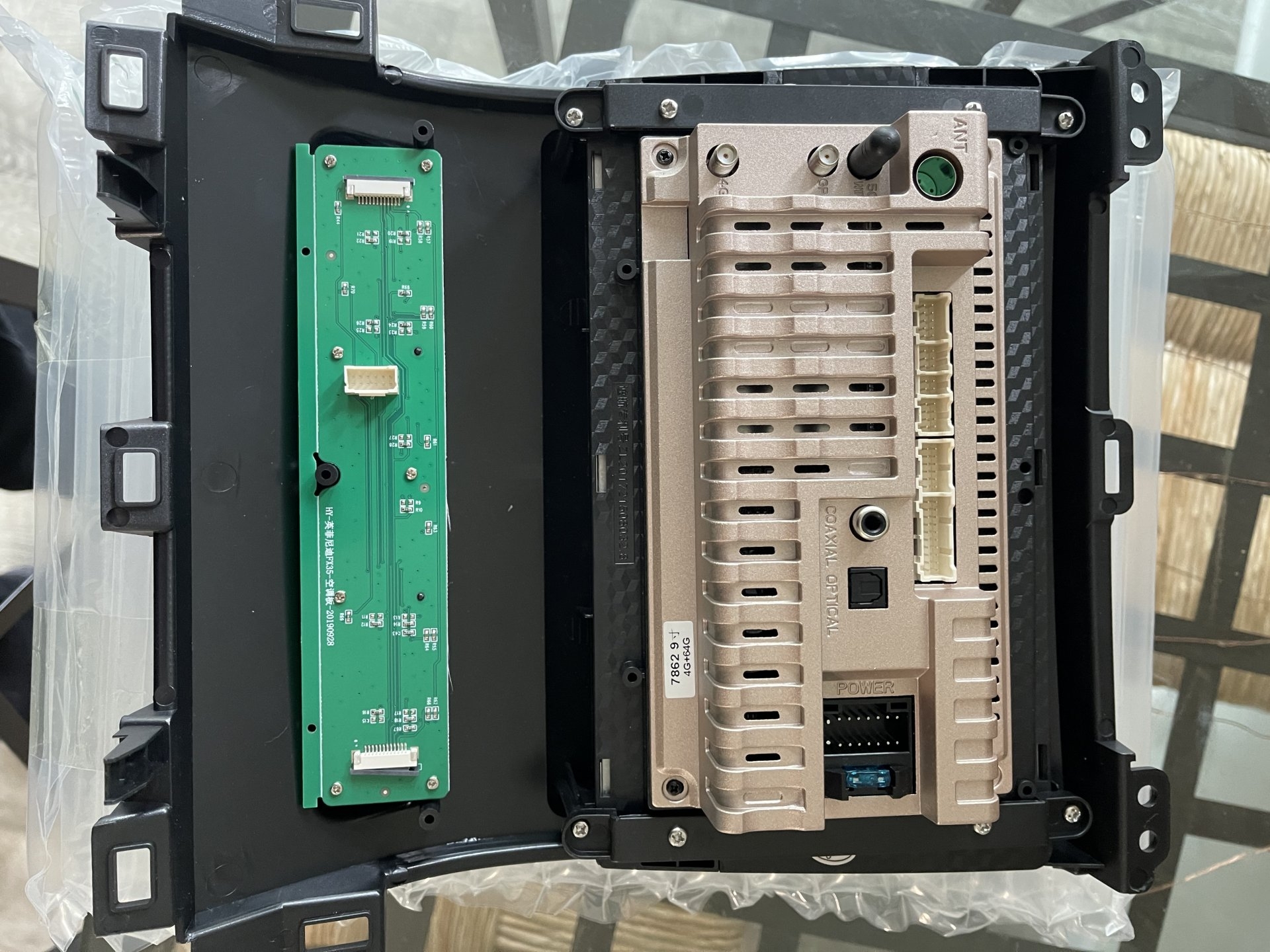

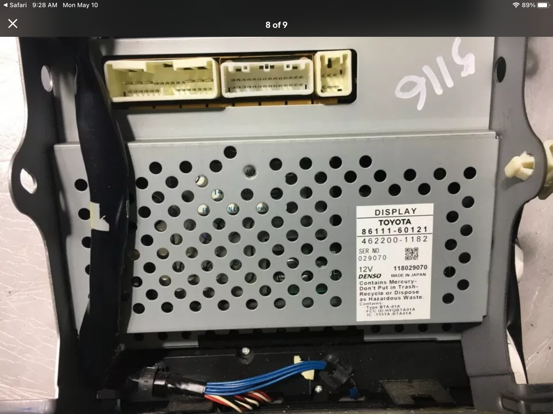

one of the reviews on the product page mentions having to remove two circuit boards from the factory radio. Also not sure what that’s about or if it was lost in translation.
I am more than happy to take pictures or videos of any specific things you request. There were a lot of things I wanted to see before I bought this but I just jumped in and went for it since there weren’t any US reviews. Hopefully this provides a good alternative for nav owners.

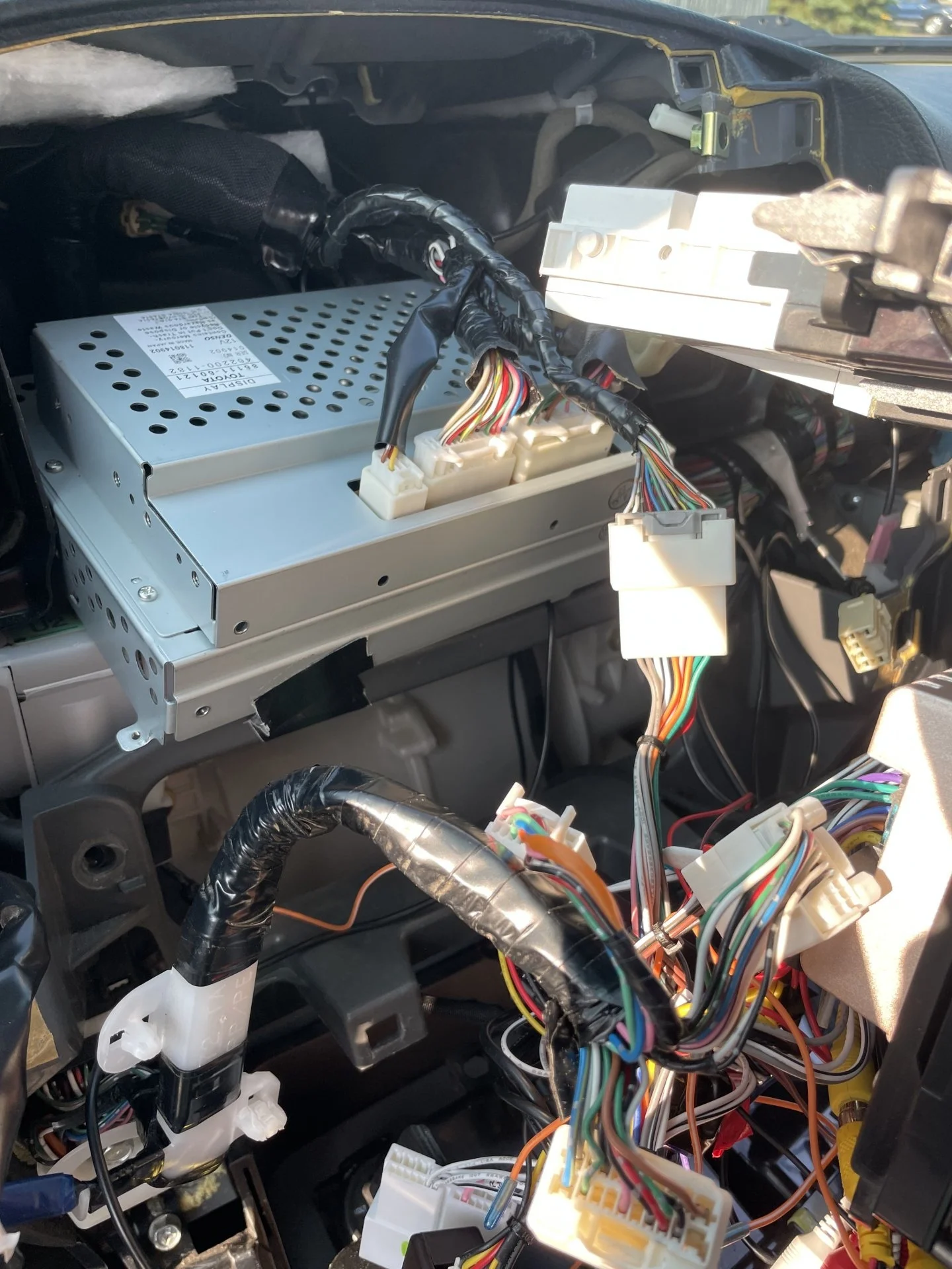

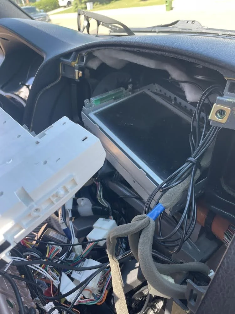

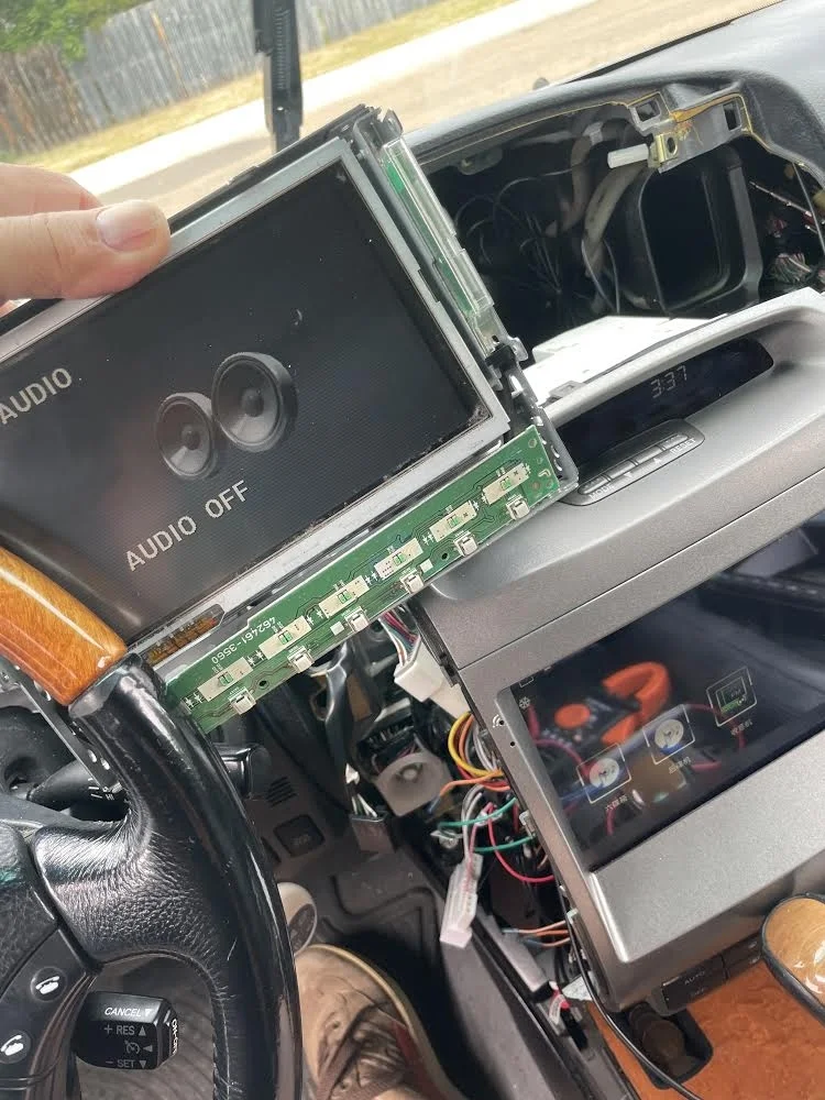

Hi…..new to the group. I have also the same unit with same issues . But after talking with the provider and some luck they are resolved. To address the clim controls you have to install the original screen(with all the plastic removed) inside behind the new unit (not an easy task ) using the original plugs. Then the climate controls will work the way they should,with the temp reading in numbers ,the mode and fan speed etc.
Now to address the sound issues…… you need to pug in the old radio section and while reading the original screen turn the amp on ( you can check on the original screen under audio ) you should now hear sound and then you can unplug the radio , rehook up the cables and it should be good
I would love to hear more about this. I tried what they suggested with the screens but couldn’t get it to work. I believe my factory screen said something about check connection or something. Do you have a detailed write up anywhere? There are several more users with this radio who would love some help!
If you tried it with the original screen plugged in and it didn’t work then I don’t have a clue . That’s the only way I could get my temp controls to work
What all did you plug into the original screen? Did your screen display any info or was it just black?
