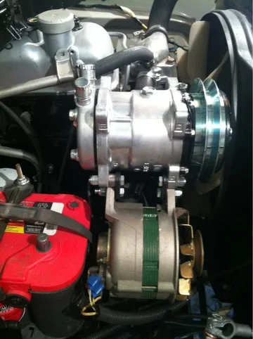

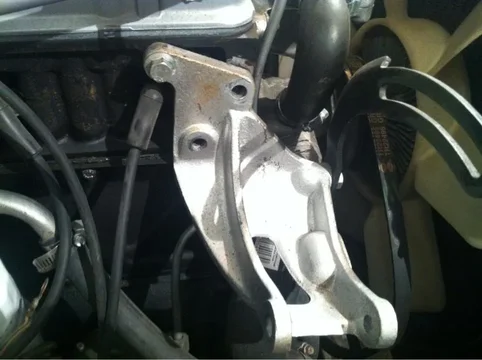

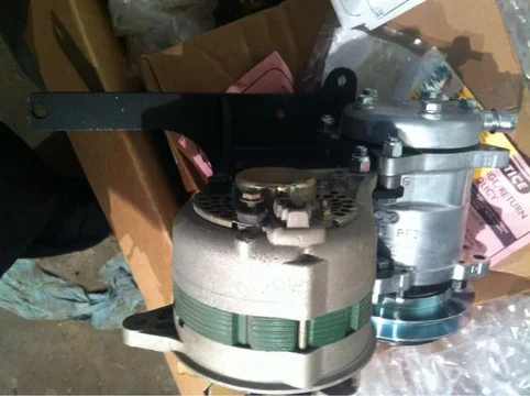

Next is to remove the alt and bracket.
next is to mount the compressor and alt to the new bracket.

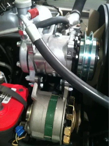

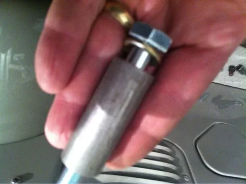

Then that goes in as an assembly using spacers and long bolts. All supplied in the kit.

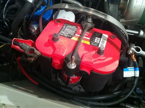

Battery follows the assembly. I had to move my battery tray back about 1 inch. I did this by simply turning the tray 180 and used different mounting holes.

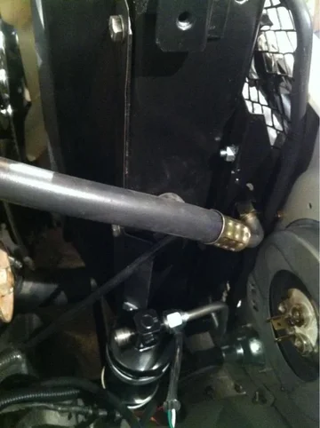

Next comes the condenser and evaporator assembly. It uses 4 brackets that attach to the back side of the condenser then you drill holes and bolt in in place. You also need to cut out two areas where the hoses attach in the rad shroud. The evade mounts to a bracket that then mounts to the rad shroud using the lower two mounting bolts.
Next is to test fit the hose and cut to length.

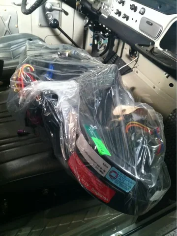

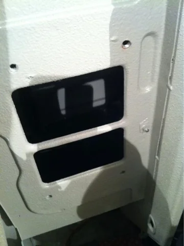

Then we turn our attention to the inside of the cab. All of the plumbing will be coming through the location where the OEM blower motor mounts.
Here's the unit in its shrink wrap. It mounts up using supplied brackets.

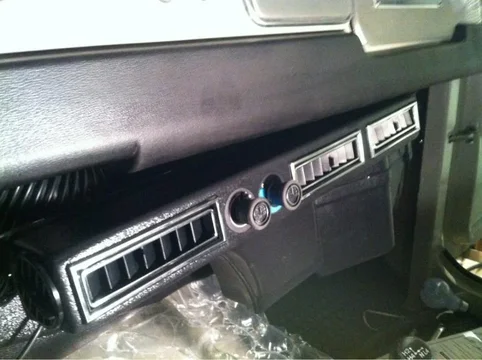

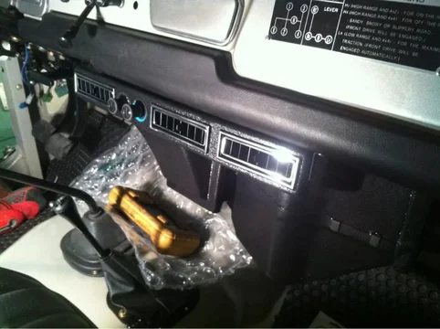

More ac work... another 7 hours today!
The hardest part of the installation is becoming a contortion artist and drilling and installing the front brackets. What a royal pain in the ass that is.
All mounted up.
also getting the defrost hoses mounted with the adaptors is super fun!

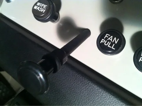

Still need to fit the warm pull knob, needs to have a large hole drilled fit it to fit. Why the hell didn't they make the knobs fit the stock holes?

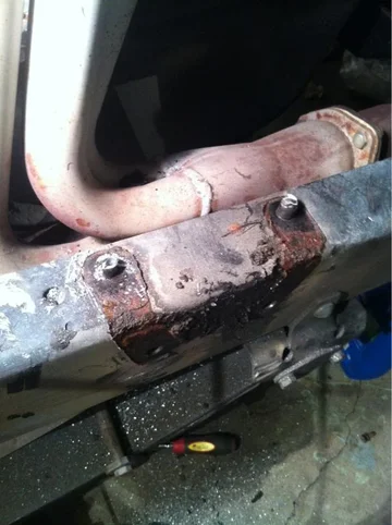

also got started on the mini truck power steering. Pulled the drivers side fender, removed the manual box the got started on the Neanderthalish work of removing the manual box bracket! This shows it just after removal. Getting the rivets out is great exercise.

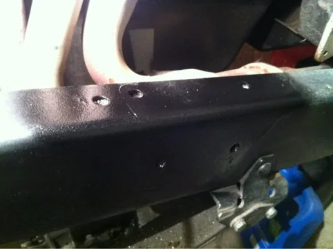

All rivets out, cleaned up and spot painted.

Looking good! do you have any pictures of the battery tray modification? having to drill the dash for this is LAME! Are you having to drill an extra hole? or just enlarge a current one?
I had to drill two holes under the dash where the two front mounts go. Those were a pita! The battery tray wasn't modified, just flipped around and re mounted. The bottom of the tray has holes in different places which gives a bit of movement back and forth.
