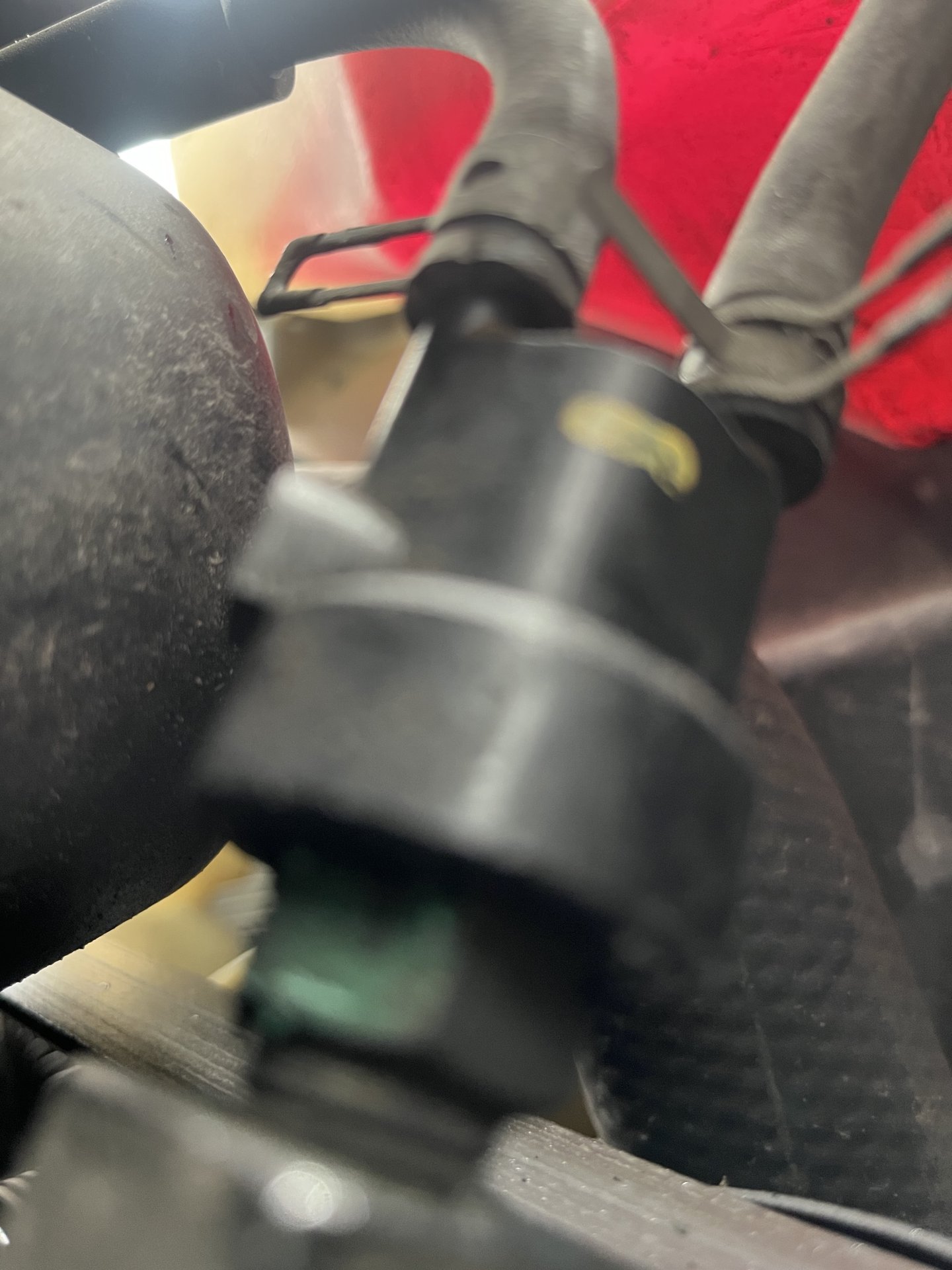

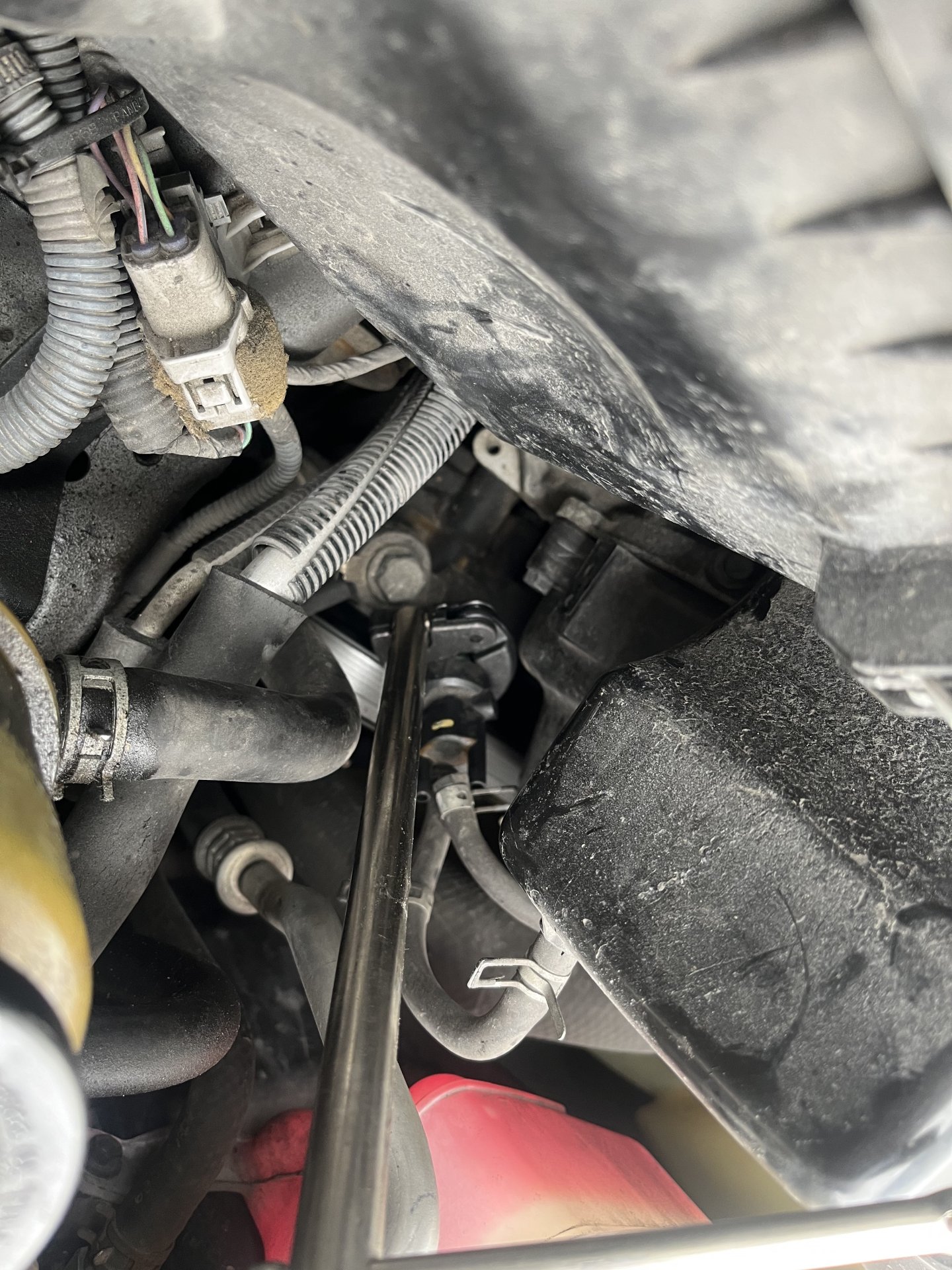

I was having issues losing power steering fluid with no apparent leak. White smoke from the exhaust suggested a bad air control valve, so I bought a replacement. I'm trying to get the old one off, it's proving difficult. I tried a basin wrench but the jaws are too wide to fit the space:

I guess my next step will be to run to the hardware store to get a narrower crows foot wrench and try that. Is it safe to use PB blaster to try to break up the corrosion and loosen the bolt, or should I avoid that? Any other tips to get the thing off?
I don’t think your getting enough leverage with that tool. Probably need to get in there with a wrench.
You should be able to get it with a crowsfoot, long extension, and a breaker bar. Definitely soak it in PB Blaster first.
If you still have problems see if you can break off the upper plastic piece and just put a socket on it.
Also you can pretty easily bypass the valve by attaching the 2 incoming vacuum lines to each other, then putting another line on the valve that loops from one nipple to the other. Just to keep from sucking in more fluid until you can get the new valve on.

For anyone coming to this trying to fix the same issue I found taking the air filter box off as that gives access. It's pretty simple - just removing the main hose and 3 bolts inside under the air filter.
