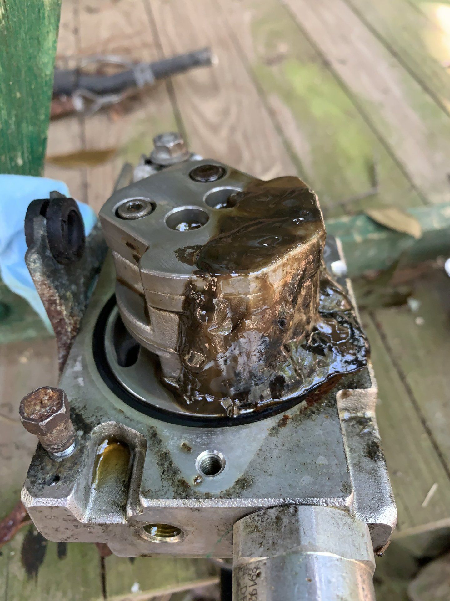

How many miles on the failed pump?

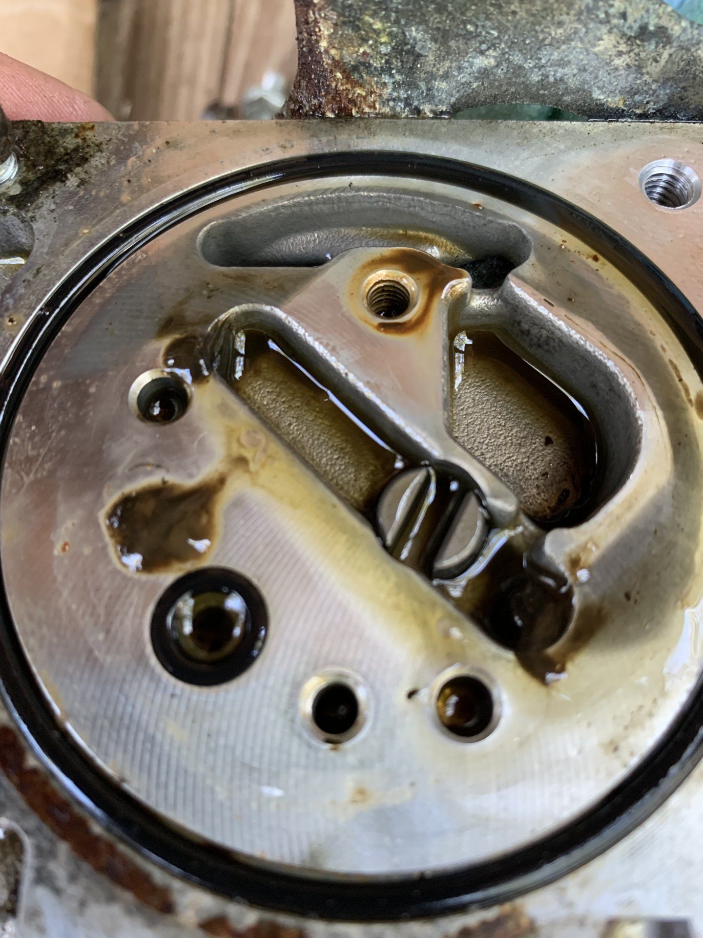

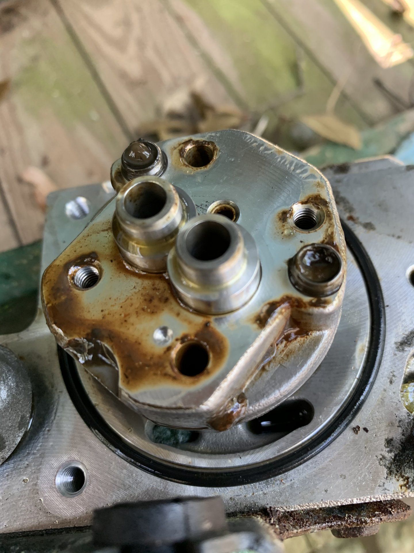

Few pics of old pump with guts open. That jelly fluid is one year and 11 months old.
Good example of why changing AHC fluid is necessary so that gunk doesn't build up like that.
I'd wager that is years of buildup, not just the stuff that built up since the most recent fluid change.

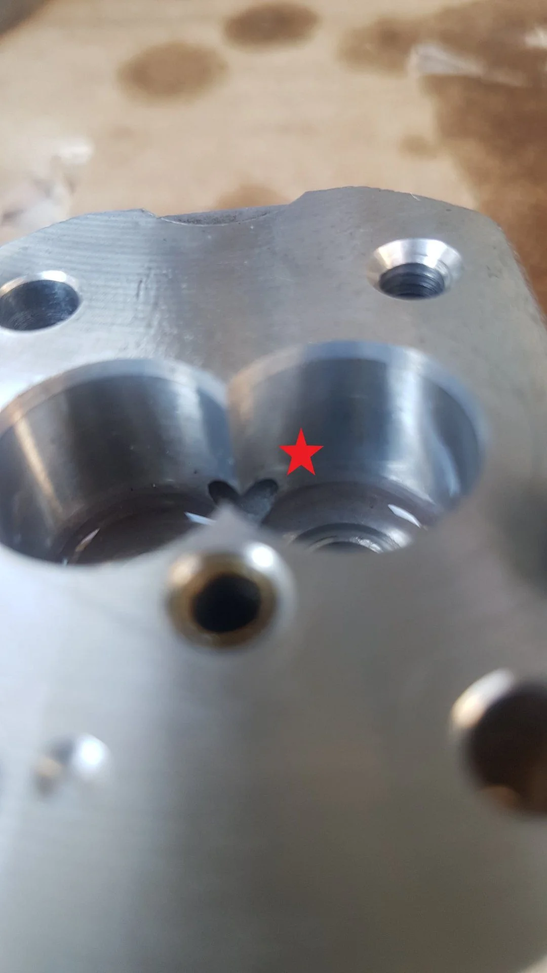

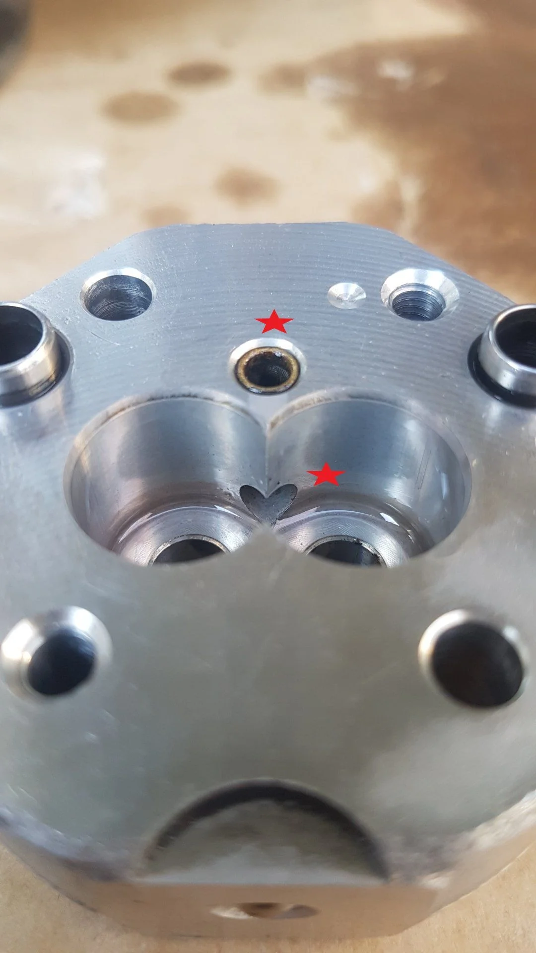

I located these pressed-in strainers near the pump ports as shown by a ‘star’ in the following pictures but was unable to remove the strainers for close inspection. Blowing through the strainers did not suggest that they were obstructed.
A further search revealed a post concerning an AHC Pump on a LX570 by IH8MUD Member @Zel. The pictures of the LX570 AHC Pump itself looks very similar to the LC100/LX470 AHC Pump even though the rest of LX570 AHC system is very different. @Zel was seeking advice about replacement strainers (helpful pictures included) but received no replies.
The pictures below show my AHC Pump as disassembled and without cleaning. The component parts appear to be in excellent condition.
The pictures below are offered for interest as the internals of the AHC Pump are rarely seen.

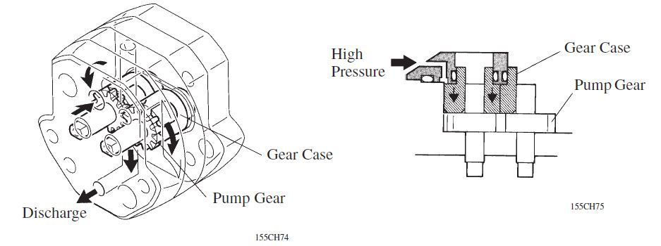

The AHC Pump is a small, simple high pressure gear displacement pump and is well-described with diagrams at FSM reference: https://lc100e.github.io/manual/ (follow tabs starting at the top:

AHC Pump Diagram From FSM

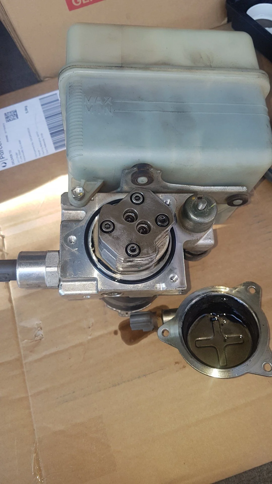

AHC Pump Cover Removed

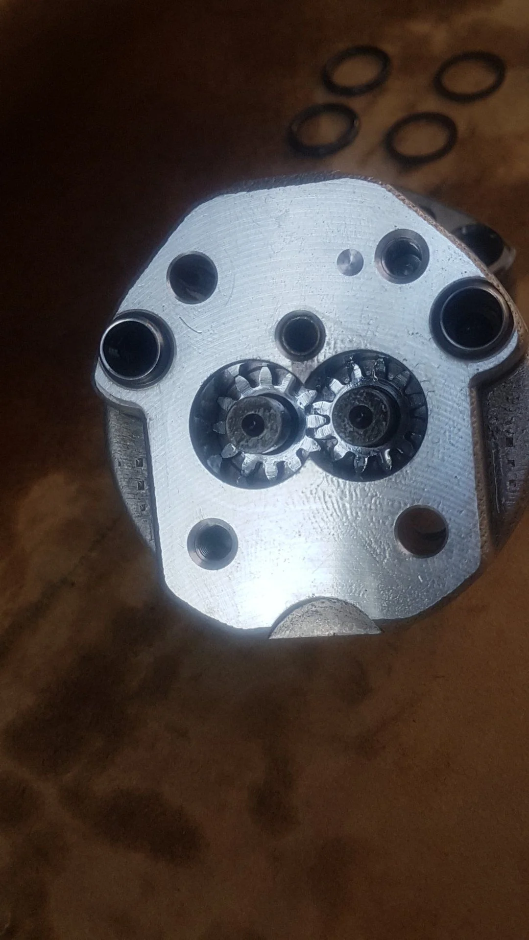

Gear Pump Exposed

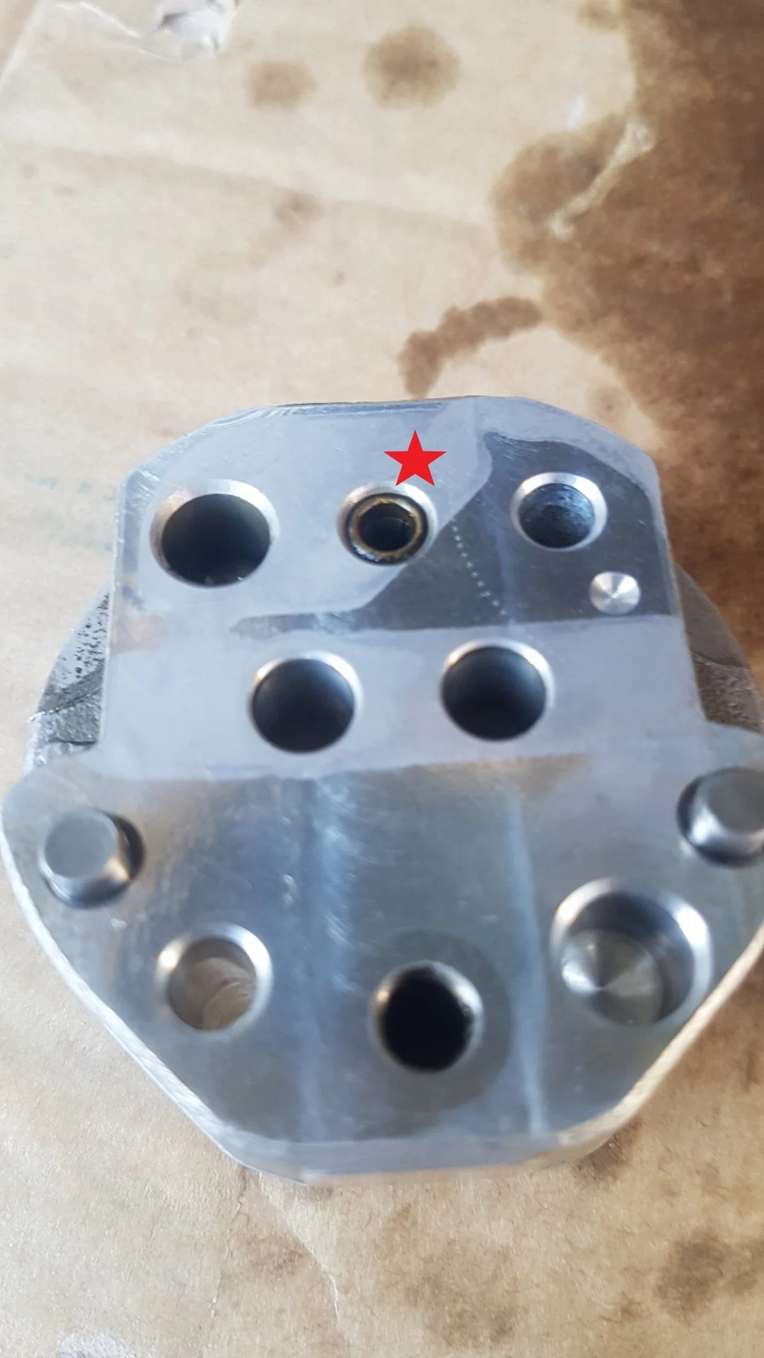

A further search revealed a post by IH8MUD Member @Zel concerning an AHC Pump on a LX570. The pictures of the LX570 AHC Pump itself looks very similar to the LC100/LX470 AHC Pump even though the rest of LX570 AHC system is very different. @Zel was seeking advice about replacement strainers (helpful pictures included) but received no replies.

Pump Inlet Port and Strainer Position
Pump Outlet Port Position
Pump Outlet Strainer Position

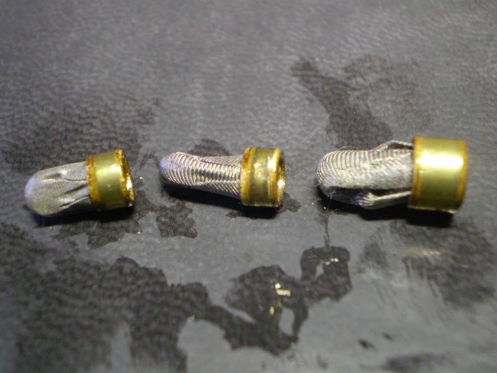

Pump Strainers (not removed by IndroCruise, picture by @Zel)

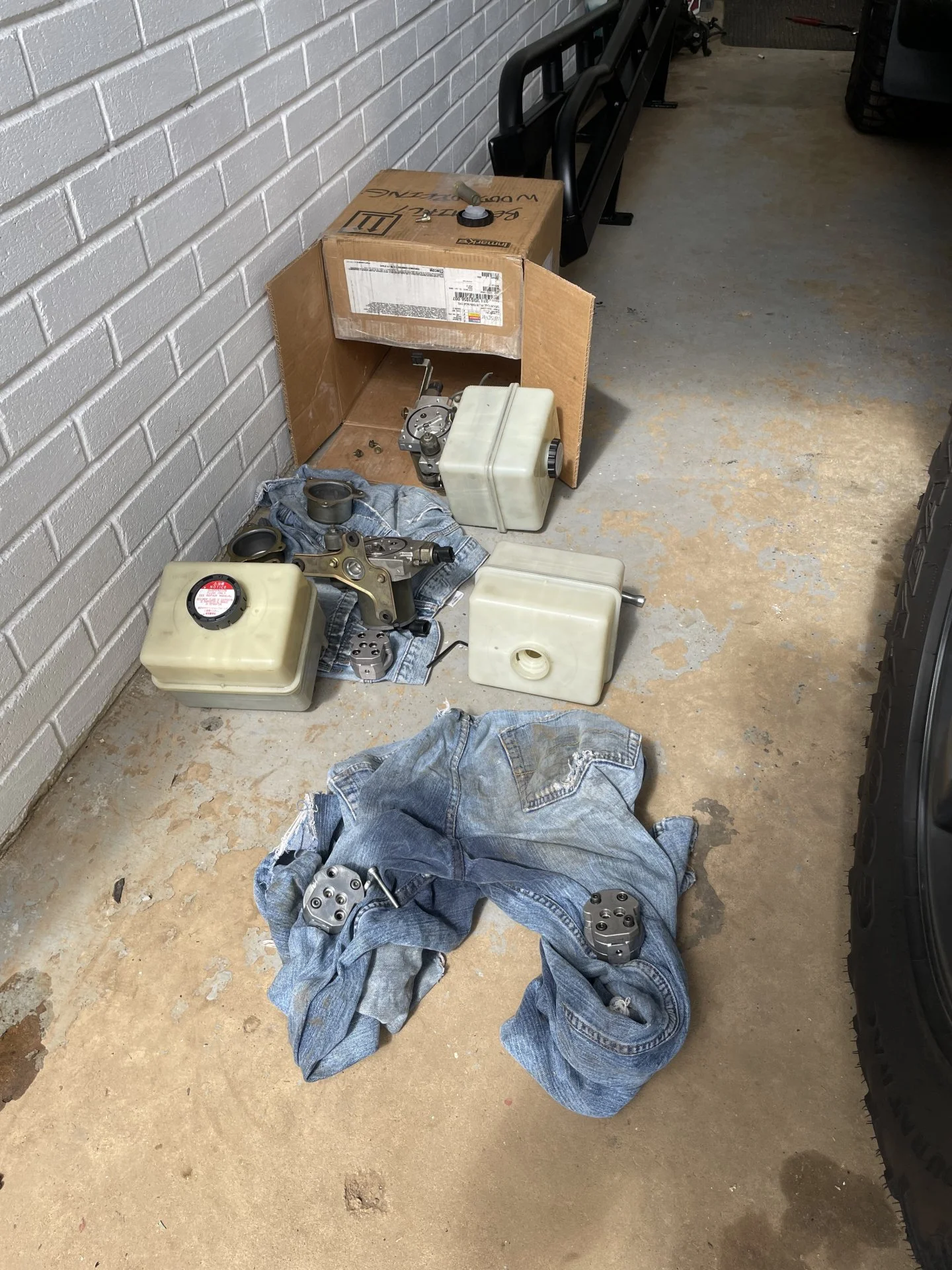

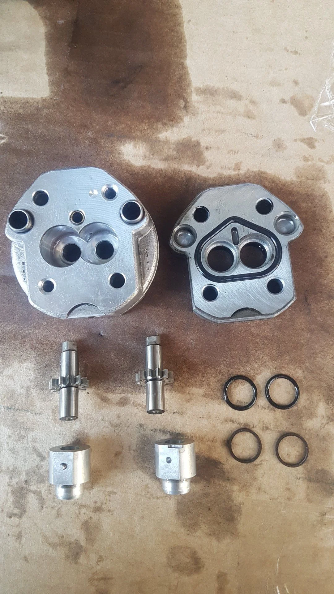

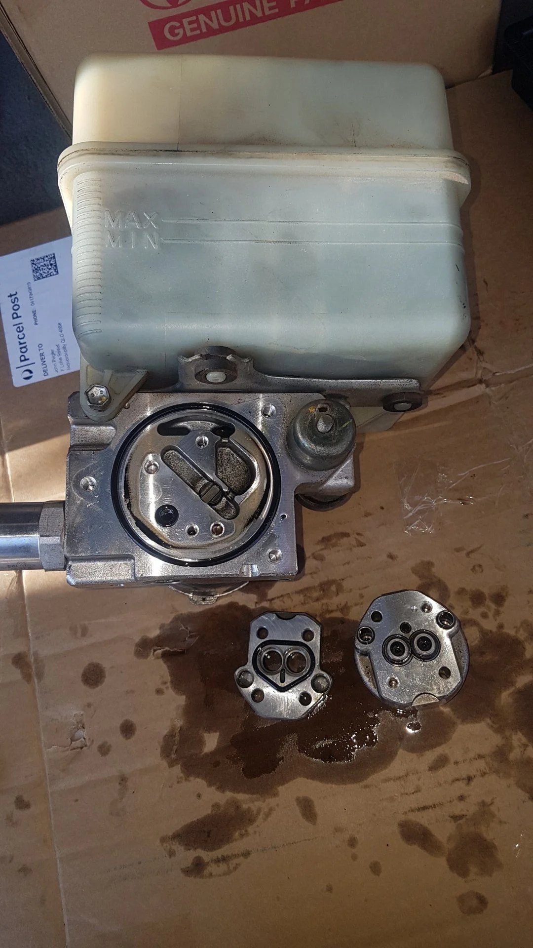

Yeah. I already opened up the pump and all looked well. No jelly or anything. I have got two used entire pumps coming to me tomorrow in the mail. Guy took them off his truck and his dads truck. Look to be in excellent condition. Going to try swapping out and seeing if this fixes the problem! 🤞

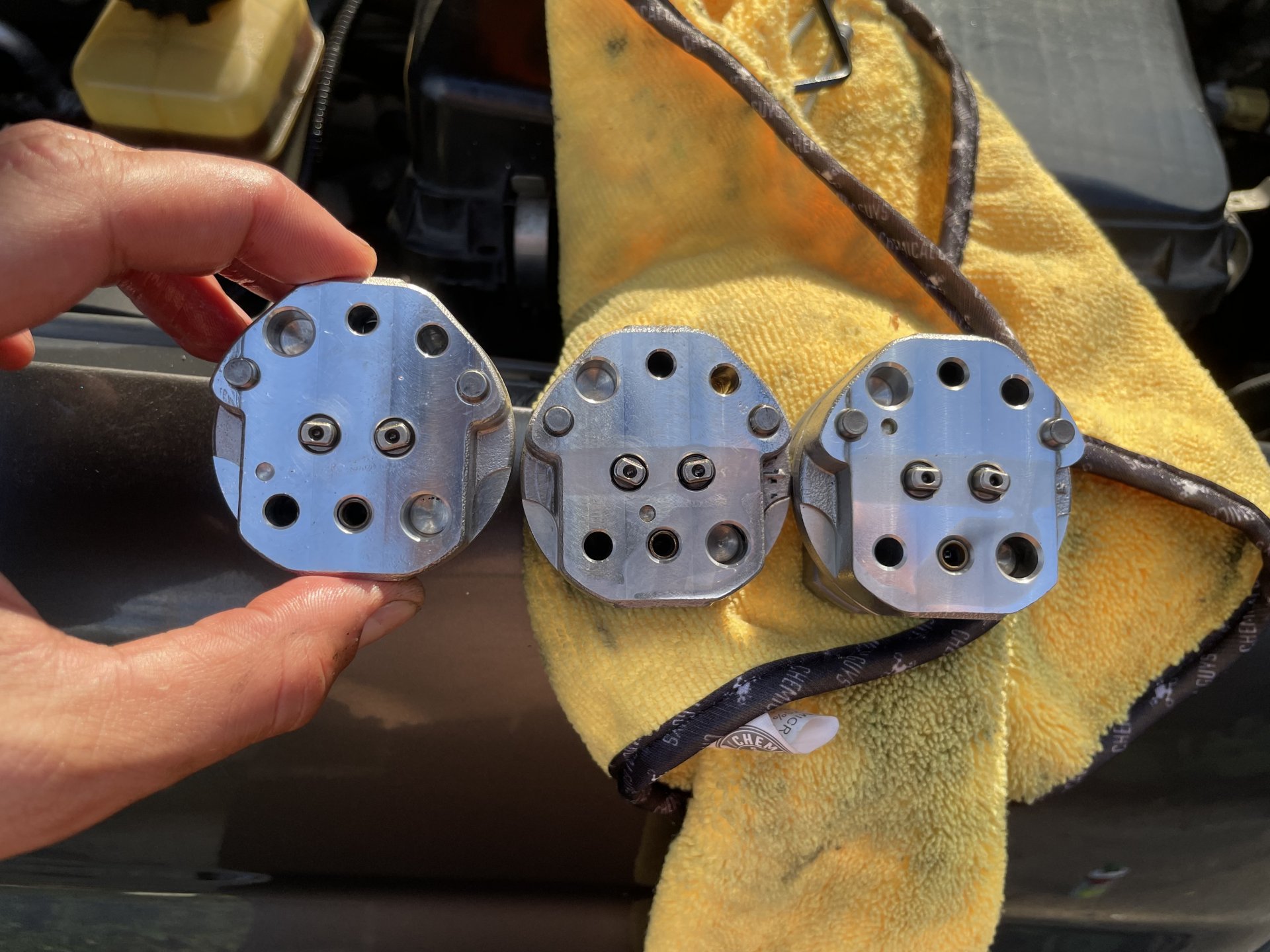

Well. Got the pumps in. And they look to be in good condition. Went to take off my whole pump and stripped the dagum feed line to the pump…soooo I said, “pump assembly is staying there for right now.”
Well I changed out the little pump with the good one the guy said there was no problems with. Nothing. Blinking off light. Tried active test. Nothing. So. Put in the second pump. Same freaking thing. Finally put back in my old pump and got it working again.
Still. Raise times are in 30 seconds.
After closer inspection you can see all three pump mechanisms have a small indentation in three completely different places. I assume this is why the pump would not work.
***Side note*** Is there anyway I can take one of the old fittings off the old pump and put it on my feed line…? And yes, I will be purchasing some flare wrenches in the future. To keep this from happening again.
