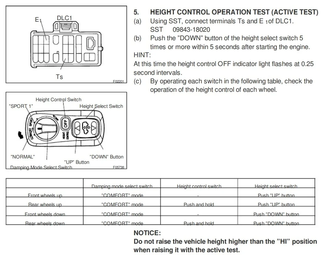

To avoid being diverted by the mysteries of Techstream and for more control, I avoid Techstream for this purpose and use the specified manual method set out in the relevant attachment to Post #19, and as below:
1. With Ignition OFF, connect terminals Ts and E1 at DLC1 (this is the socket in the engine bay, usually over the RHS wheel arch with the word DIAGNOSTIC on the top cover. The terminal "map" is shown inside this cover. Instead of Special Service Tool (SST) 09843-18020 which is just a piece of bridging wire, find something simple -- I use an unbent paperclip for this test. Voltages are low here low, about 4.5 volts, and will not cause a problem -- but be careful to connect the correct terminals,
2. Turn ON the engine.
3. Push the DOWN button on the Height Select switch within 5 seconds of engine start and hold it down for 5 seconds. There will many flashing lights in the instrument cluster (because the ECU has been by-passed). Ignore these -- they will revert to normal later, after the test, when the bridge (paperclip) is removed and the AHC ON/OFF switch is pressed down for a couple of seconds,
4. Use the combined settings to move front or rear up or down (listen for the operation of the AHC Pump and its motor)
5. When finished, switch OFF engine, then remove the bridge (paperclip),
6. Re-start, push down the AHC ON/OFF for a couple of seconds to clear the test.

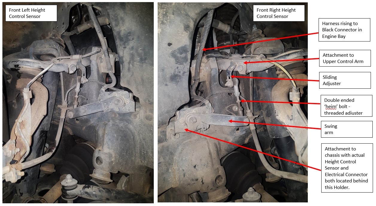

Sorry to be unclear -- the Front Sensors also can be adjusted by loosening and sliding the bolt up or down the slot to which it is attached.
@IndroCruise
......I can't believe I didn't notice those before. Thanks!

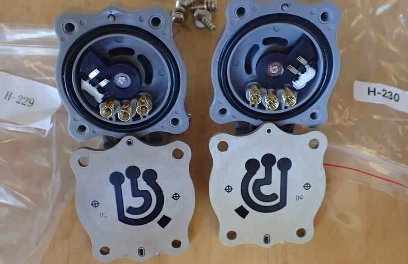

You might have two left side sensors, or two rights. It's been a few years since last time I had to touch this, but iirc, the left and right sensors are opposite of each other, and the rear is equal to one of them.
I thought this may be the case. However, one has L and one has R stamped into the side. And if they were the same, it would be pretty hard to physically attach them their respective mounting locations
Yes, the brackets are different, but you can change the sensor without changing the bracket. The difference might be only in the lid of the sensor, where the carbon traces are - if you take the cover off, one should be a mirror image of the other. Warning: I haven't checked to see if there are other differences as well.
Unless something got messed up at the factory, they should be the correct ones. I never opened them up, I just put them on.
Here's one left and one right. Don't know which is which:
Can you post a fresh screen shot of those AHC parameters in Techstream while the vehicle is running and sitting in Park?
Thanks @uHu
Now I just did some adjusting and something Is definitely not right. I'm adjusting the sliders, not the heim bolts, now.
When I adjust the FL higher towards the top of the slider groove, the sensor value in TechStream DECREASES. I have it adjusted to the top now, and it's reading -1.0. At the bottom it was reading -0.7
When I adjust the FR higher towards the top of the slider groove, the sensor value in TechStream INCREASES. I have it adjusted to the top now and it's reading -0.0. At the bottom it was reading -0.3.
Which one is correct? It's possible that there is a duplicate sensor in the incorrect housing.
