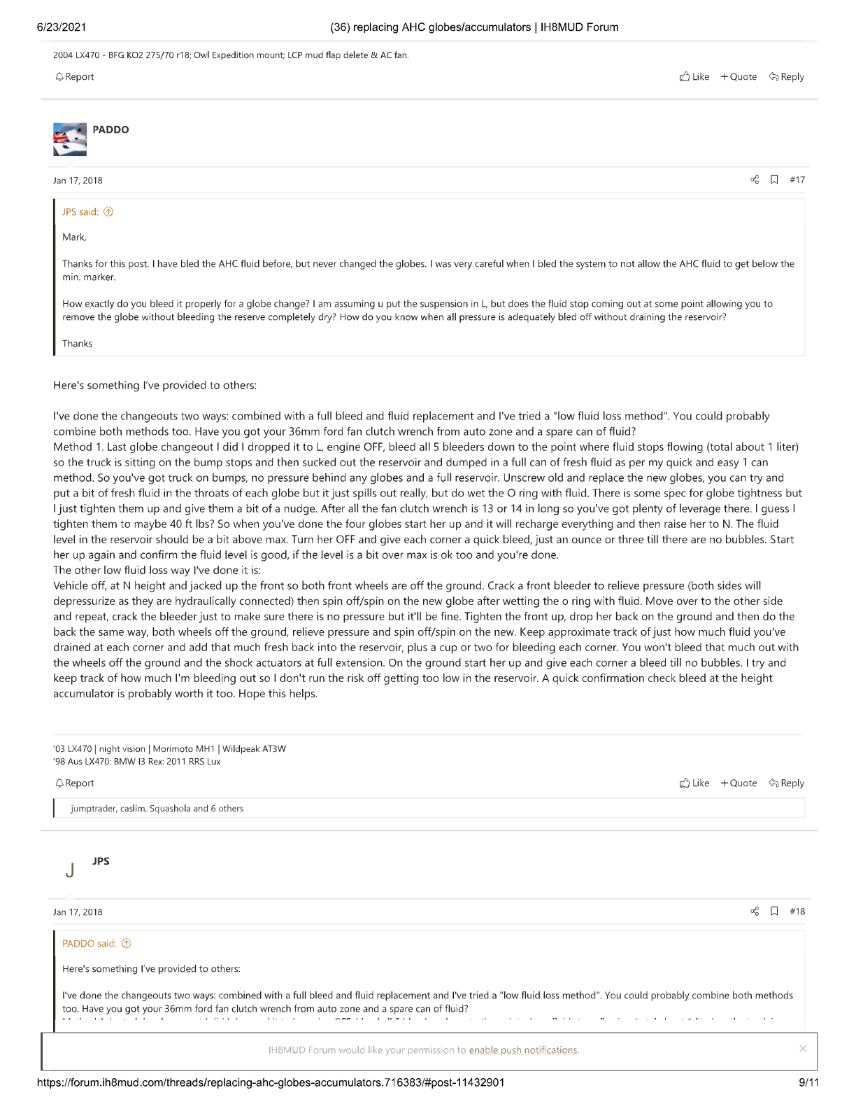

Here's something I’ve provided to others:
I've done the changeouts two ways: combined with a full bleed and fluid replacement and I've tried a "low fluid loss method". You could probably combine both methods too. Have you got your 36mm ford fan clutch wrench from auto zone and a spare can of fluid?
Method 1. Last globe changeout I did I dropped it to L, engine OFF, bleed all 5 bleeders down to the point where fluid stops flowing (total about 1 liter) so the truck is sitting on the bump stops and then sucked out the reservoir and dumped in a full can of fresh fluid as per my quick and easy 1 can method. So you've got truck on bumps, no pressure behind any globes and a full reservoir. Unscrew old and replace the new globes, you can try and put a bit of fresh fluid in the throats of each globe but it just spills out really, but do wet the O ring with fluid. There is some spec for globe tightness but I just tighten them up and give them a bit of a nudge. After all the fan clutch wrench is 13 or 14 in long so you've got plenty of leverage there. I guess I tighten them to maybe 40 ft lbs? So when you've done the four globes start her up and it will recharge everything and then raise her to N. The fluid level in the reservoir should be a bit above max. Turn her OFF and give each corner a quick bleed, just an ounce or three till there are no bubbles. Start her up again and confirm the fluid level is good, if the level is a bit over max is ok too and you're done.
The other low fluid loss way I've done it is:
Vehicle off, at N height and jacked up the front so both front wheels are off the ground. Crack a front bleeder to relieve pressure (both sides will depressurize as they are hydraulically connected) then spin off/spin on the new globe after wetting the o ring with fluid. Move over to the other side and repeat, crack the bleeder just to make sure there is no pressure but it'll be fine. Tighten the front up, drop her back on the ground and then do the back the same way, both wheels off the ground, relieve pressure and spin off/spin on the new. Keep approximate track of just how much fluid you've drained at each corner and add that much fresh back into the reservoir, plus a cup or two for bleeding each corner. You won't bleed that much out with the wheels off the ground and the shock actuators at full extension. On the ground start her up and give each corner a bleed till no bubbles. I try and keep track of how much I'm bleeding out so I don't run the risk off getting too low in the reservoir. A quick confirmation check bleed at the height accumulator is probably worth it too. Hope this helps.

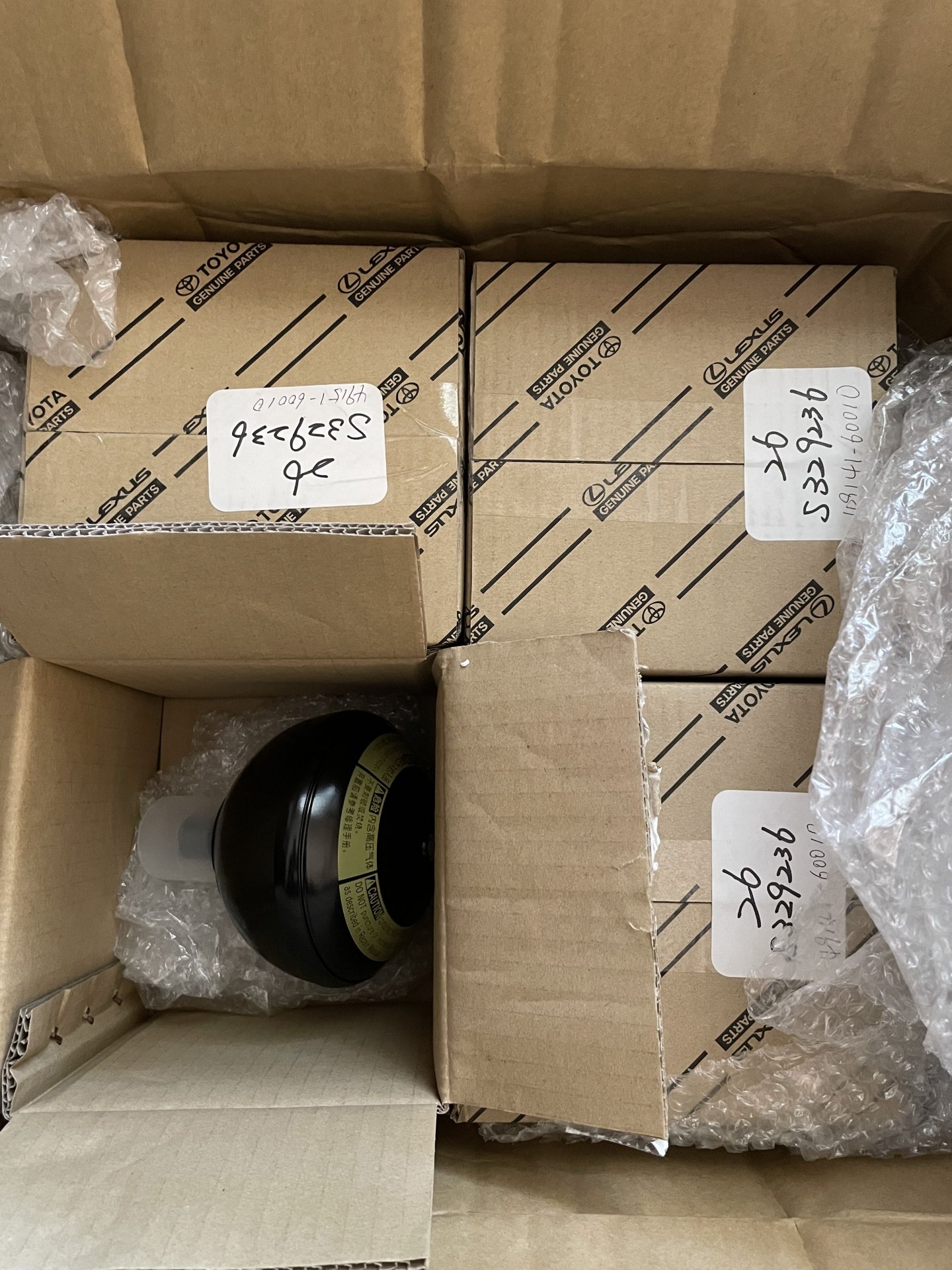

My IMPEX order was delivered today. Was scheduled for tomorrow delivery so FedEx got it here a day early. That was 13 days from order date. Went out and sprayed PBBlaster on the bleeder valves and nut on the globes at lunch today 😀 gotta feeling I'm going to be doing this when I get home

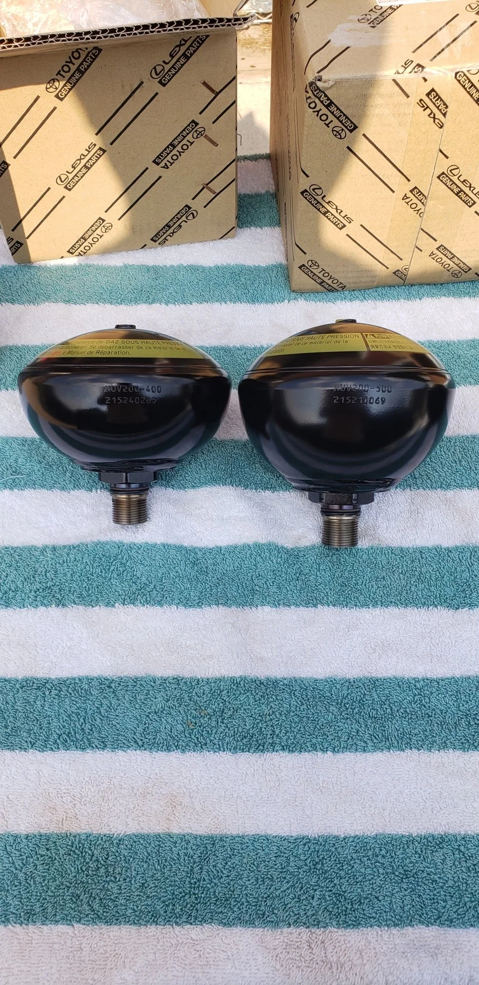

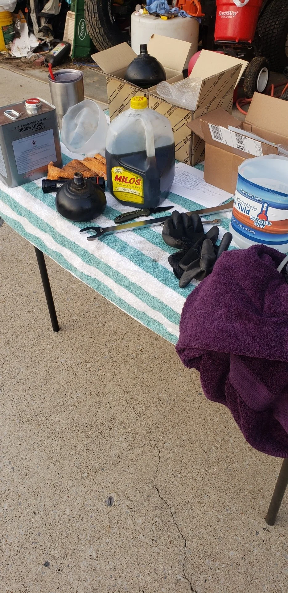

Well I managed to turn it into a 2.5hours plus including all new bleeder valves and nipple caps.
I never had to use the chisel but a couple of the globes needed some serious tugging. The biggest issue I was having was getting the new globes lined up with the threads. It was quite ridiculous on the 2nd and 3rd one but the last one was the easiest. Oh yeah I did also manage to get properly drenched in fluid while bleeding the accumulator pump thing when my hose popped off.
Rides better for sure especially in the front.
