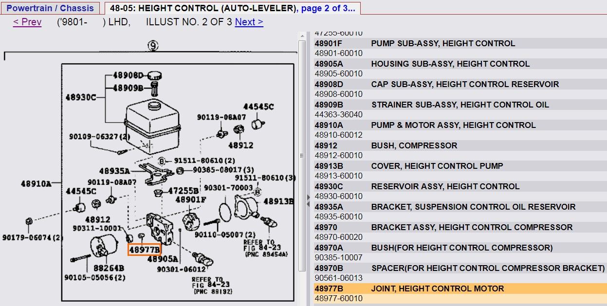

What is this 04977-60010 motor/pump coupler? I see nothing of that part number anywhere, and these parts diagrams aren't that common either.
I know it's not necessary...but...when in Rome right?
I think he actually means this one:
