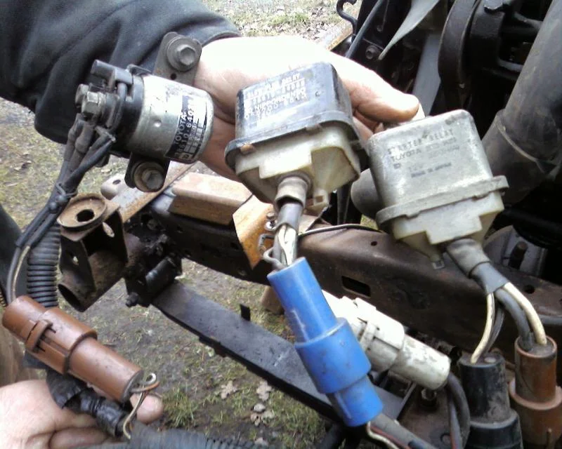

anyone know what the relay on the left does? ( BJ60-70 Harness)
Other two are starter relay and glow relay, which I plan to replace with generic relays .likely the cheapo ford starter solenoids.( unless someone has some cheap...:hillbilly:)
And I'll use the same thing to replace that 3rd one, provided it doesn't require a better duty cycle??
which is why I ask.

Ok, i will go first, It looks like a glow plug relay to me, I know I have a similar one for a replacment set up in my delica, but its hard to say with out knowing where the wires run.... could be to activate alot of things, but for sure its a gate switch inside.
whats the part #
buggered if I know... I don't actually have any of the three, so that pic is about it.
I can almost make out the number on that pic..looks like 18610-64020 maybe?
my 24v bj70 has one up forward on the drivers side mounted to the battery box, so I think it's on all the 3b trucks. I can probably check the part # on the one in my 70 and see what the 24v version does. or maybe when it clicks:lol:
I'll probably just end up grabbing 3 generic solenoids and wiring them in, see what happens.
wouldn't be a real land:censor: without faulty wiring and random electrical fires...:lol:
the relay on the left is the main glow relay,the center one is the sub glow relay,the one on the right is the starter relay.the part # on the main glow relay should be 28610-54---
well I was sorta close....:grinpimp:
jeeezus toyota makes it complicated just to start those s***ty old engines..
If I'd skipped all the edic and superglow crap I could've cut half the wires out of the harness..
anyways, thanks for the input, plain old starter solenoids should do the trick.
