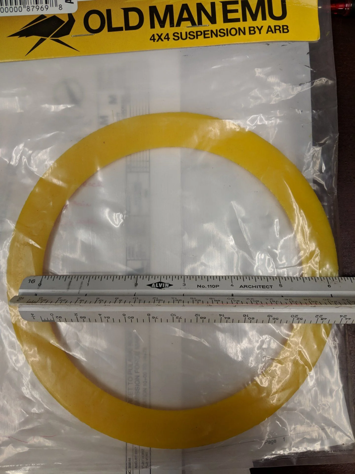

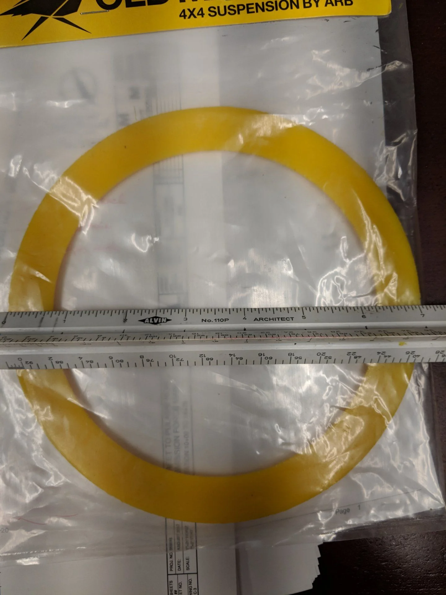

I don't suppose someone happens to know what the O.D. and I.D. spacers for the rear springs should be. I would like to make some slightly thicker ones than what I have at the moment.
TIA....
Inside and outside dimensions look to be 5 1/2 and 7 1/16th respectively.
