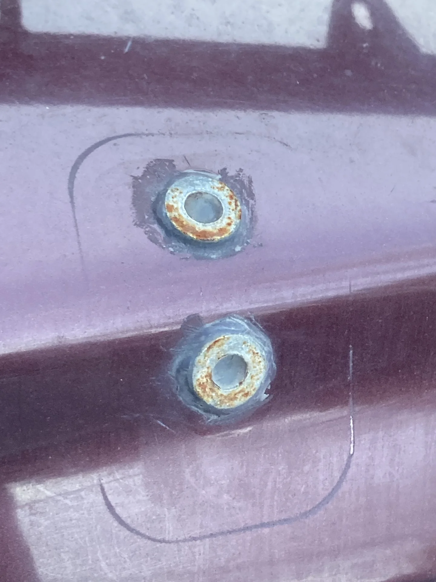

Yea, it’s not pretty either. Here’s pics of mine that were removed & silicone’d a few years ago.

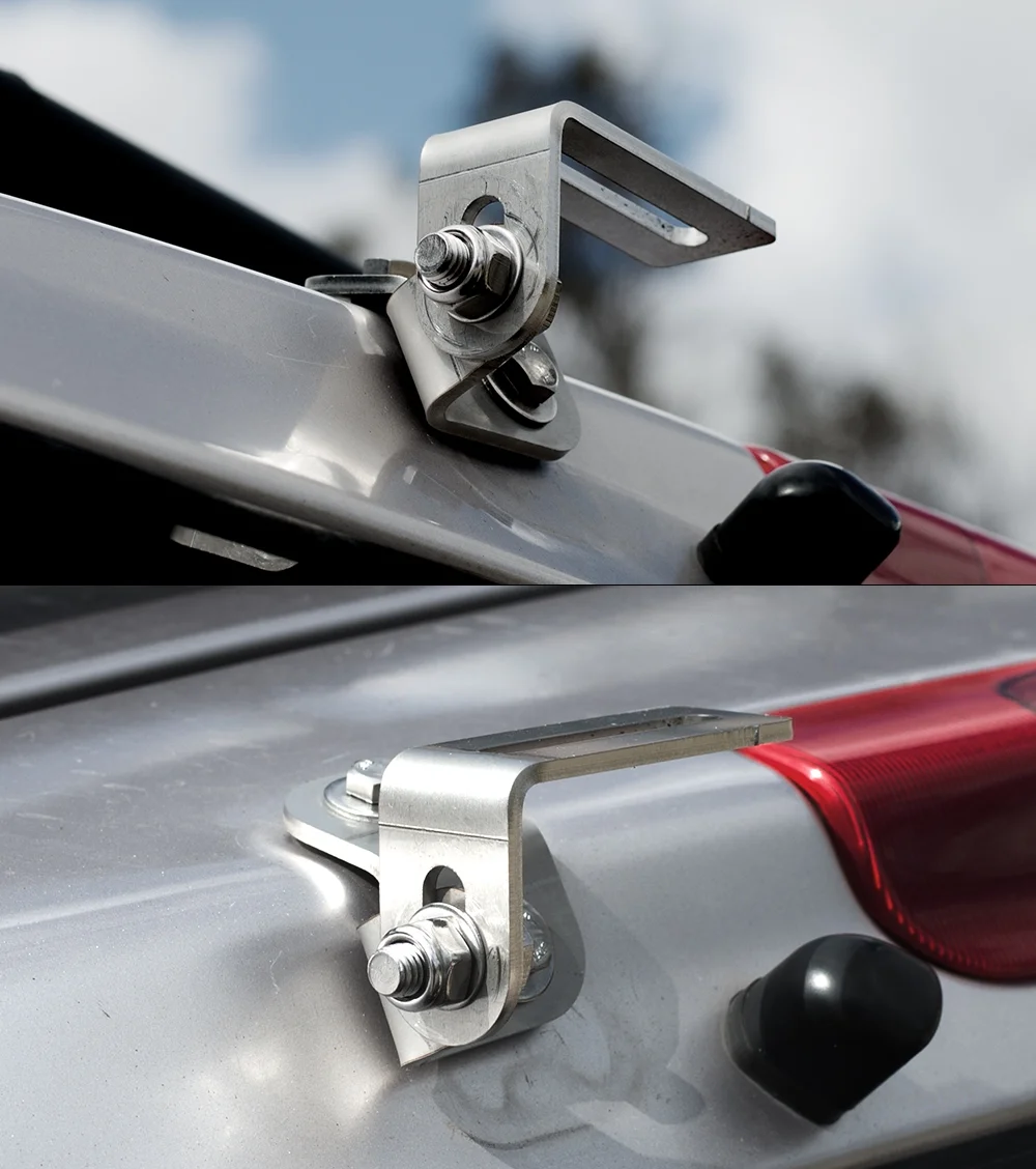

You can mount an accessory bracket there if you want: Rear Hatch Light Mount Kit – 100 Series Land Cruiser - https://www.massivemetalshop.com/shop/product/land-cruiser-100-series-rear-hatch-light-mount-kit/

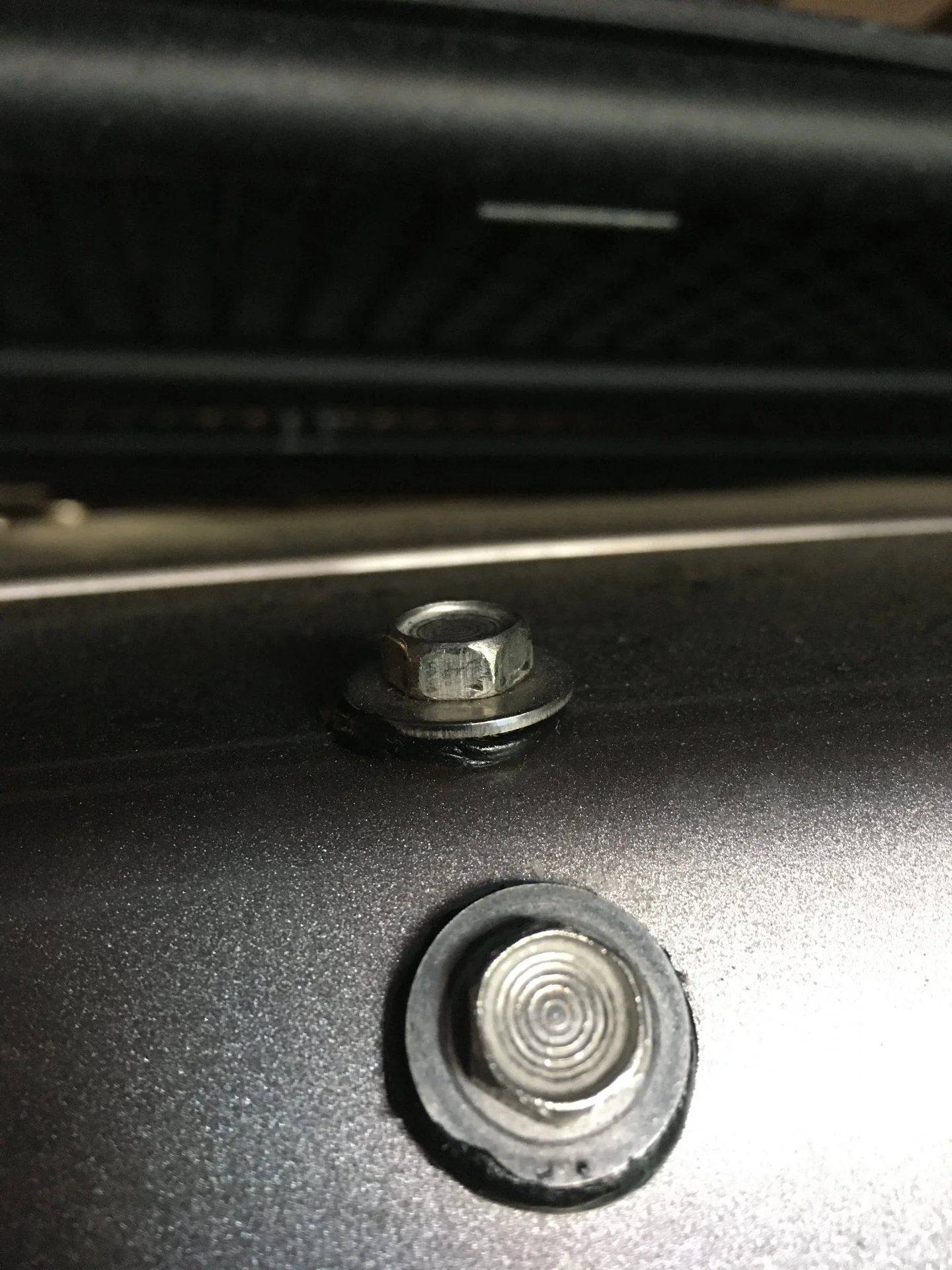

Had a branch come down on my spoiler a few weeks ago cracked both the mounting portion on the underside of the spoiler as well as the passenger side mount itself. Plastic seems super brittle.
Luckily I was able to tighten three of the bolts down fairly well after removing the plastic mounts, I did notice each of the rivnuts budge a bit though. But one of the rivnuts just broke free completely and spun freely. I dont think I used all that much force when tightening them by hand, but maybe in hindsight I should have been more careful.
I knew I had to drill out the rivnut. I was worried about damaging the body so cut out hole in sheet metal to fit around it to hopefully protect things in case I slipped.
The magnet was to catch the metal shavings. I used a wrench to hold the bolt head in place while drilling, but once I drilled through the head it just broke off and left the threads in the rivnut spinning freely.
I then tried grinding it with a die grinder and a 1/2" diameter burr but it just spun no matter what angle I tried from.
I ended up removing the sheet metal and held the sides of the rivnut with some pliers, put some painters tape around it so I wouldnt scratch the paint. I was able to drill out the rest of the rivnut using a pretty sharp 9mm carbide drill bit. Because the rest of the rivnuts moved a little when replacing the bolts I decided to drill them all out.
They were all M6 rivnuts I removed. Luckily their hole diameter was a bit smaller than what I needed for the replacements. The new rivnuts needed a 9mm diameter hole.
I cleaned up the inside edge of the new holes, put some touch up paint on the edges, put some blue loctite under lip on the new rivnuts before setting them. I replaced the m6 bolts with some button heads that have an o-ring on the underside to seal out moisture, painted them with touch up paint. Decided to replace the rear hatch light while I was at it and so far everything seems pretty water tight but I've been keeping an eye on it.
I was pretty freaked out about drilling into the body, but it ended up not being too bad. I do miss the spoiler though, been trying to figure out a way to maybe 3d print a new mounting option for it.

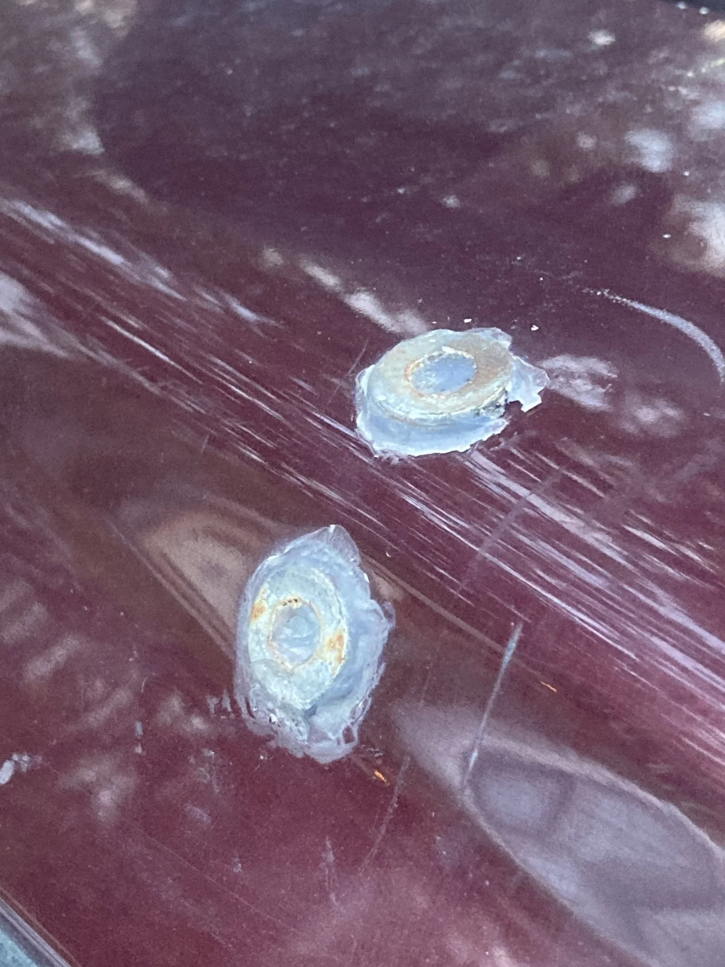

Same problem with spinning rivnuts here.
Mine were just a little loose so just to hold me over I used a small amount of black butyl tape/ rope available at Lowe’s. I formed it into small worm shaped pieces and packed it into the rivnut. I realize it’s probably not permanent but it doesn’t leak.
I think I’ll wait until I find an air deflector and then fix them properly.
