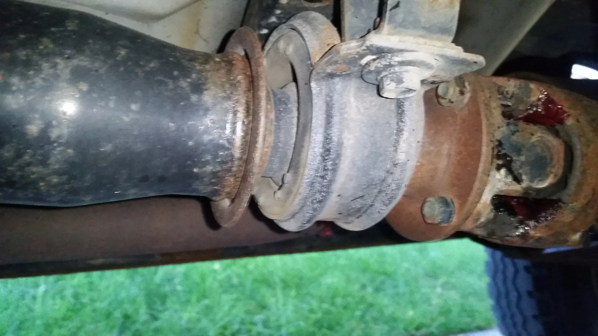

Here's a picture of the carrier bearing. As you can see it's off center. I'm thinking of shimming it in addition to replacing it.
But since greasing the driveshaft didn't yield any results I think the next step would be to drop the rear driveline and see if the clank is still there.
Just looking at the pic it seems that the shaft is off center to the low side in the bearing. This is consistent with the lift on the truck. I'm not the expert but yeah it seems it that you want that to be centered with the truck on the ground.

Over the weekend I dropped the rear drive shaft and took it for a spin. In the short time I drove I didn't hear the "clank" so I set about replacing the U-joints as well as the carrier bearing. Also consulted with Cruiser Outfitters who told me that for my year Tacoma and lift application that ARB did not recommend shimming the carrier bearing so I left the shim kit off.
Got the truck buttoned up and the sound has disappeared and there are no odd vibrations after reinstalling the driveshaft. So pretty happy about that.

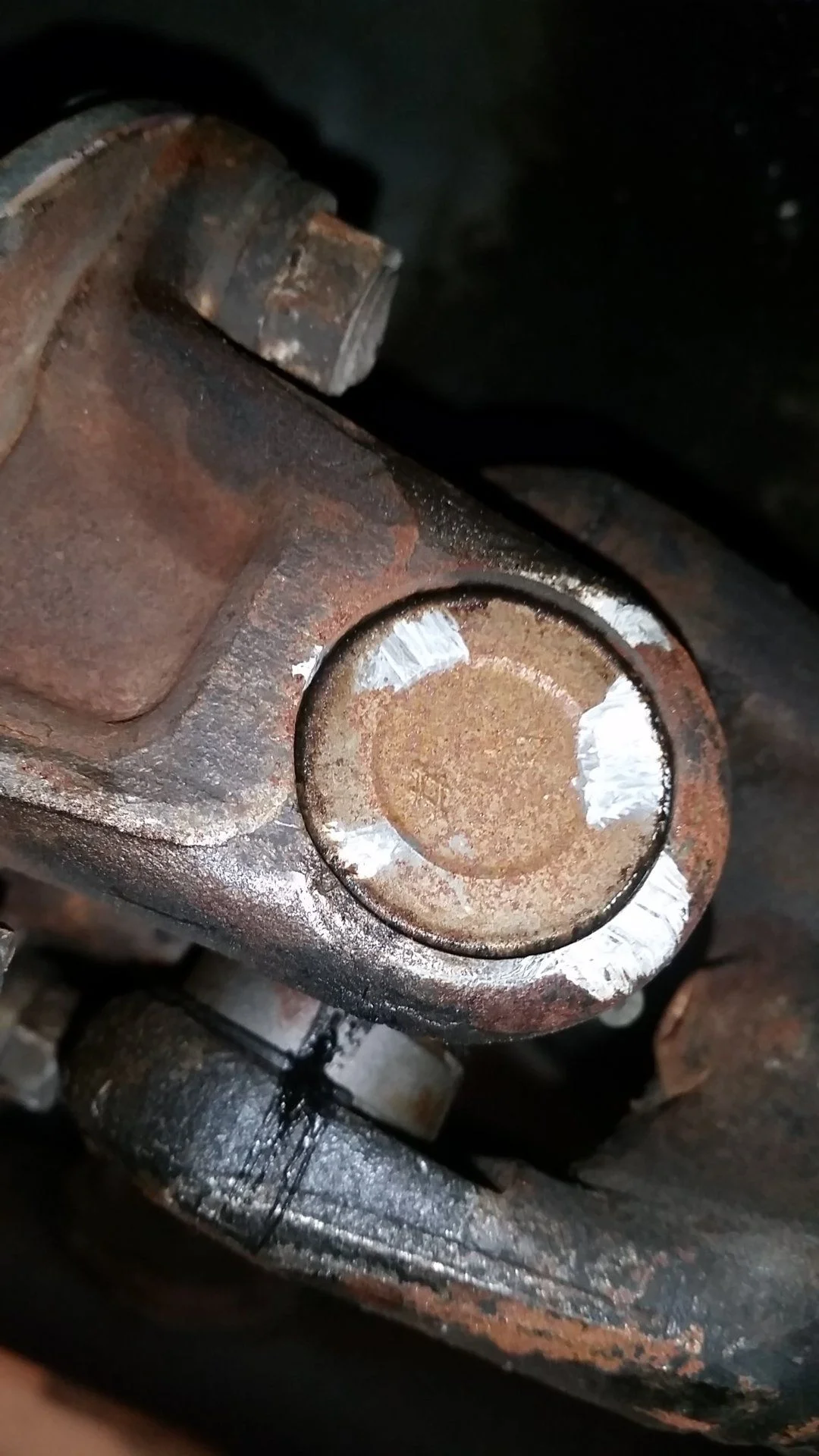

One of the caps on the U-joint slid in pretty easily into the yoke on the transfer case side of the shaft. There didn't seem to be any play but I'm still a little concerned that the cap may be free to rotate in the yoke. I'm going to mark it with some paint and see if it moves.

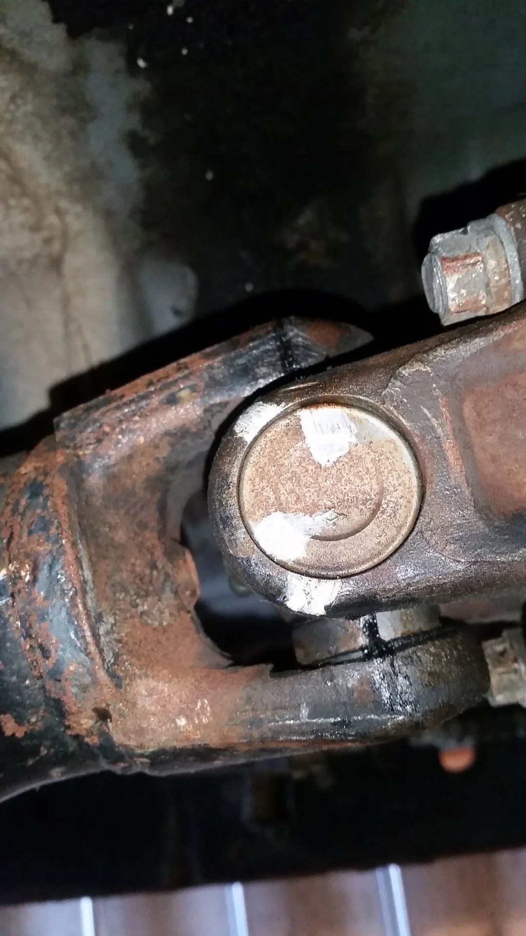

Well, 1 year later it looks as though the caps in the yoke have moved a little bit but I wonder if it's enough to worry about.
What do you all think?
I went ahead and replaced the flange yoke. It was festering in the back of my mind so it was worth it to me even just for the peace of mind. Lubed up the other U-Joints and the CV joint as well.
