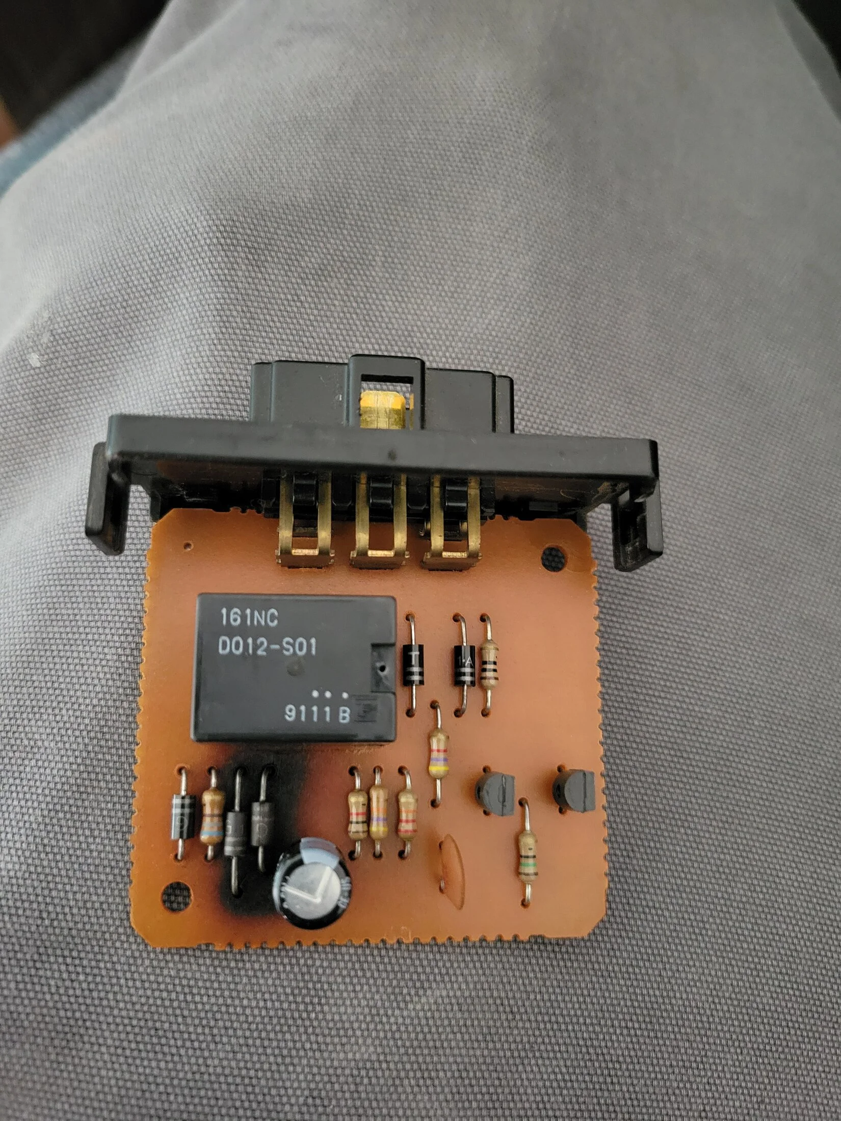

Hello I recently got into my rear hatch to try to fix the wiper and defogger. I checked the ground underneath the center console and can confirm I have 12 volts to rear wiper harness. I found the rear wiper relay was scorched so I'm thinking that should fix the wiper???

The ewd also showed me the relay box for rear window wiper does have the power go through it for on position so I grabbed one of those from cruiser corps. I found a schematic where someone replaced the one module but not the diodes and stuff.

Well plugged new wiper relay in it worked for 5 minutes it isn't melted but I'd say maybe a grounding issue since the hatch is having issues, weirdly the lock works great.
