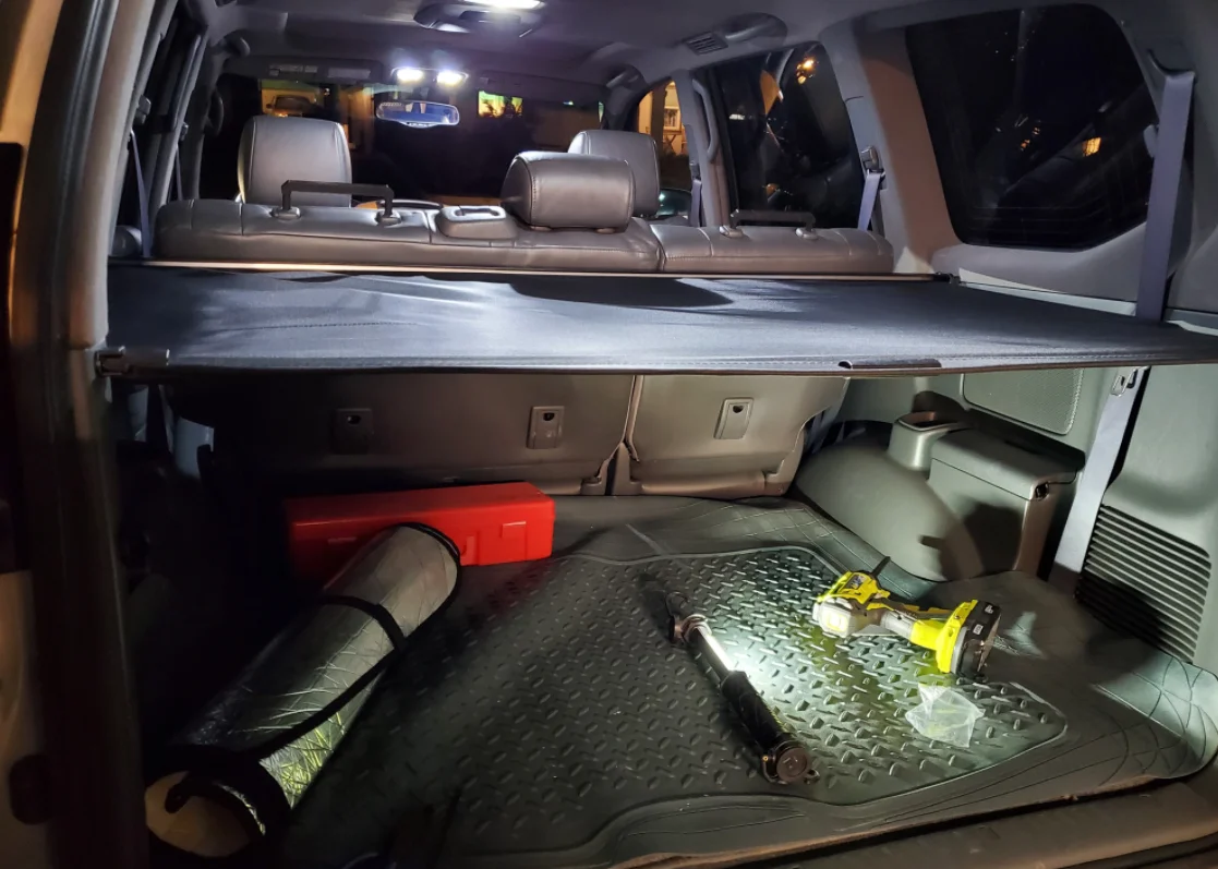

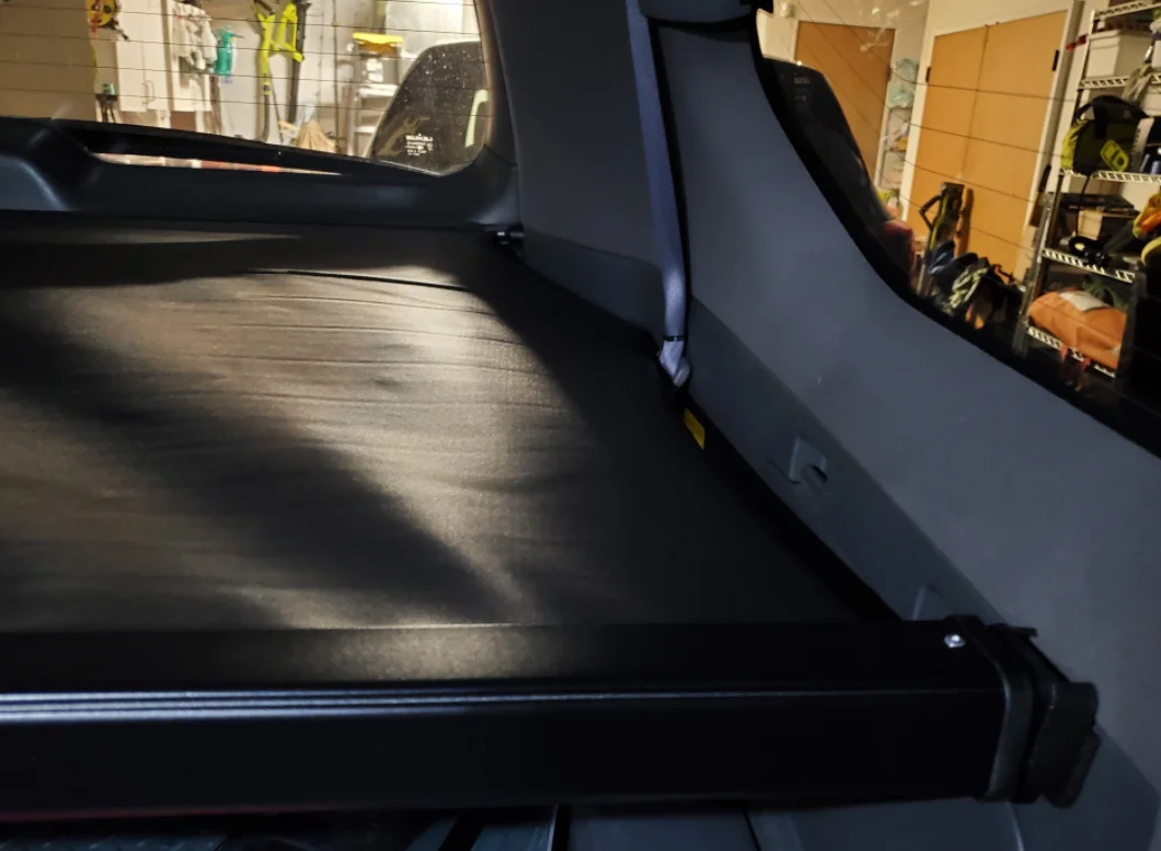

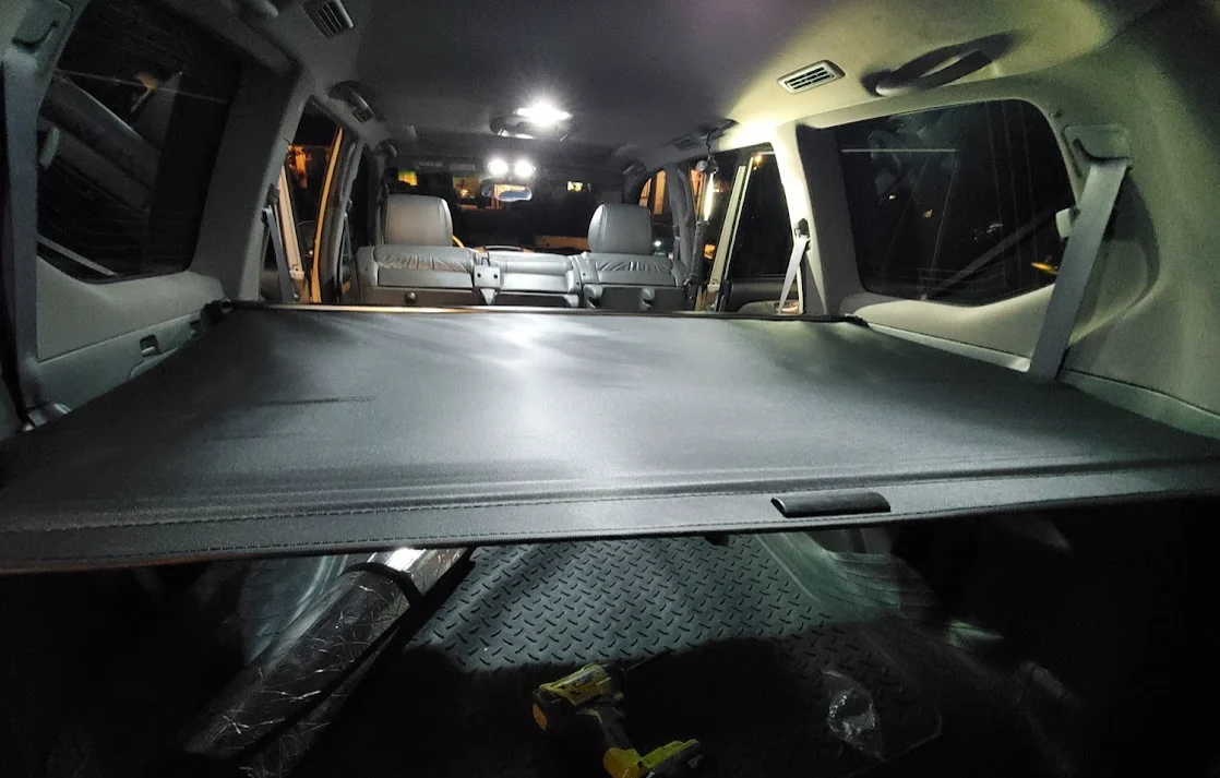

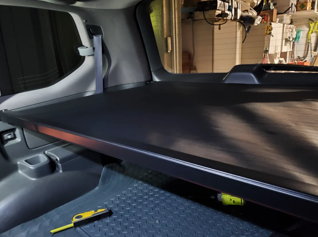

The cover finally arrived today, about 5 weeks to get it here to southern California. Initial impressions are good. It's not OEM build quality, but it seems solid enough. The cover enclosure is aluminum and the cover itself seems like durable fabric much like the OEM covers we've had in other cars. It has a couple ribs sewn in to give it a bit more rigidity. Install took all of 15 minutes or so and most of that was just figuring out where exactly I wanted to install it.
So far initial impressions are that it's good enough. It solves the problem I was looking to solve as this car has virtually no hidden storage. No idea how durable it will be, but it seems like it will be good. The only really issue I see is that it's a bit far away from the sides by the side windows, so as it is now you can peak in from the side and see under the cover a bit. You can't see much, but maybe see that something is in there. I think that can be addressed but that is an issue. It's also a little floppy toward the back corners where the cover is cut to go corner toward the back door. The cover seals nicely along the back door as it has a flap that includes the handle that basically form fits along the door trim.
I haven't used it at all yet so can't say if it rattles or anything so this is my first impressions and a few pics.
Gap looking in the side window. There's a light under the cover to make it easier to see

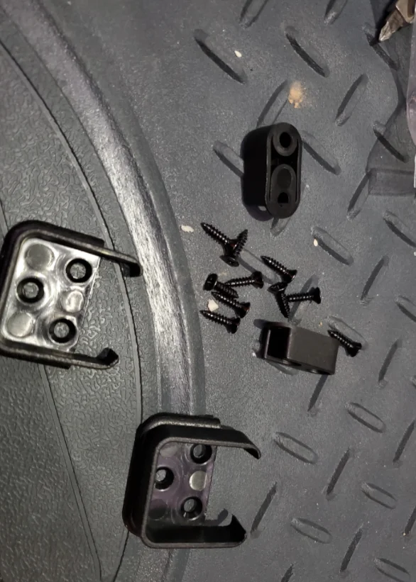

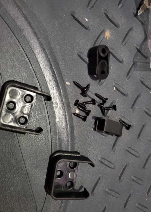

The pic below is all the mounting hardware. Just little plastic U shaped things with 3 screws each for the cover bar and the other two mounting holding the end of the top when you open it up. I really just went in there and held it where it seemed to work best. Marked the locations then I held the bracket there and used a driver to put in the screws. I used a drill driver, but a regular screw driver would have worked just fine. I didn't predrill, but you certainly could and might want to.
And, yes, most of the time on the install was just figuring out where I wanted to put it as I was apprehensive about putting holes in this thing. If I allow the seat to recline all the way and put the cover behind that, it will leave a good size gap between the seat and the cover when the seat isn't reclined. So I reclined the seat back a bit farther than we would normally use and put the top there. So enough room to recline it back some, but if you want to go farther back, we'd have to remove the cover. I doubt that will ever happen around here. Once I figured that out it was about a minute for each side to get it installed. And now I do keep my emergency stuff back there.
