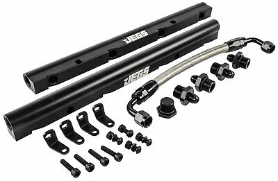

Called Jegsbtk he the run down and they were great! Actually found what I needed on eBay. I don’t jnow how but I got one that is just what I needed. Horray for Jegs!
And got it cheaper then going down other roads!
Horray
I hope what is pictured is what really shows up!
