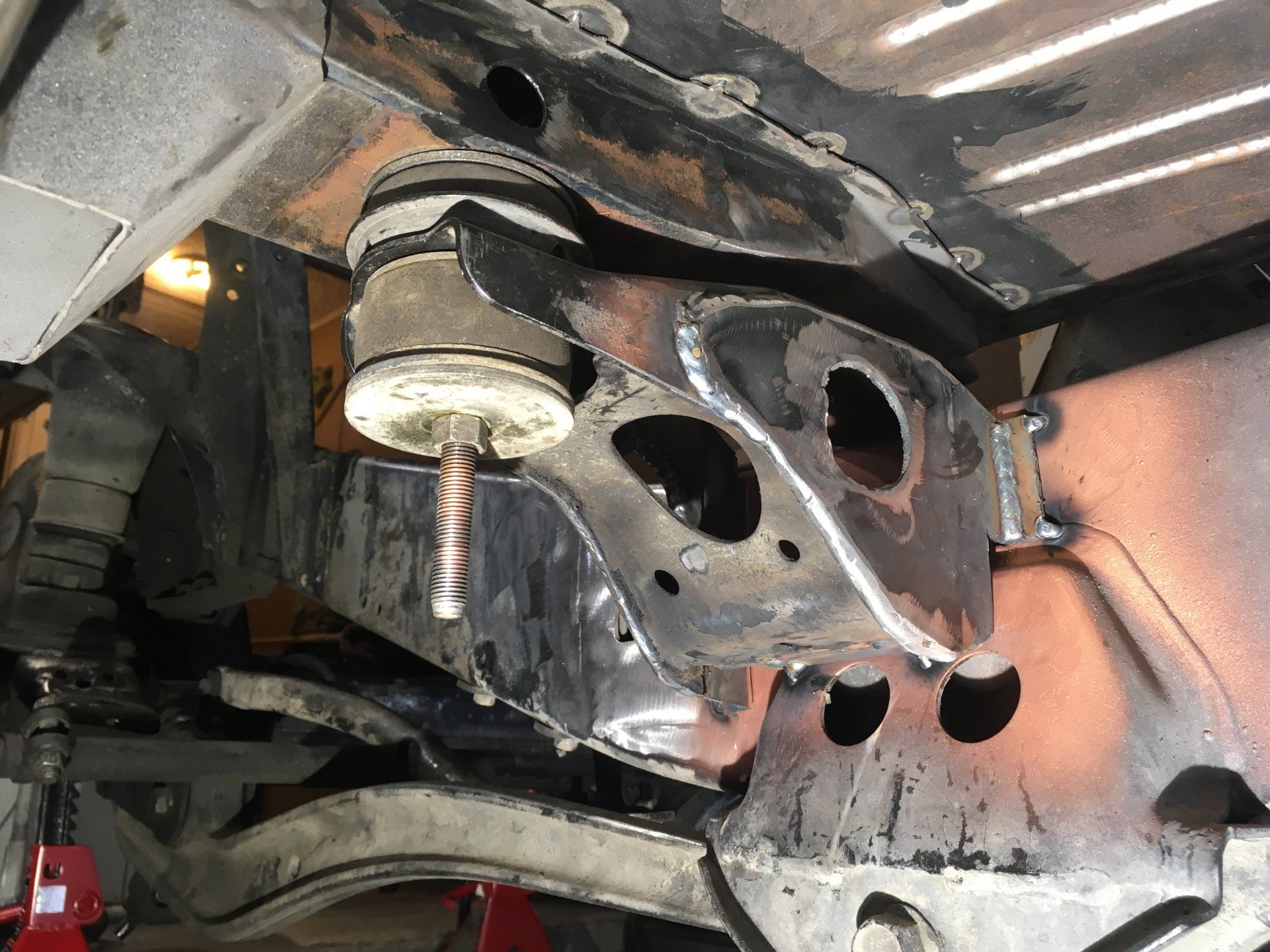

Looking through Mcmastercarr trying to find a substitute for these guys for between the A and C between the frame and body. Would you all say these are ‘medium hard’ rubber?
Anyone fabbed something to replace this?
