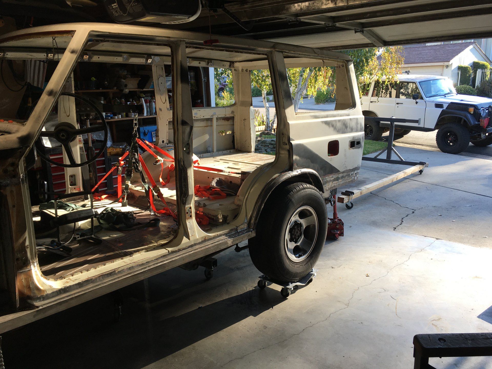

My cast of characters for the lifting dance.
Actually did not go too badly! Moving from the jackstands to nothing underneath until I got the chassis under was scary!
My Mom there to make sure I didn’t do anything wrong and viola!
just enough room. I think I should change my thread to ‘just made it’
Now onto body mounts. Gonna follow along and find that steering box brace that Briveganbj42 is using. Just makes sense to do that now.
Tough to figure the forward/aft positioning. The wheel looks too far back when moving the body forward to clear back seat/coil buckects. Got to raise it a bit to get the tire/fender better balanced looking.
Any thoughts on what I might be missing. I've got huge ears! Maybe Im not missing anything.
