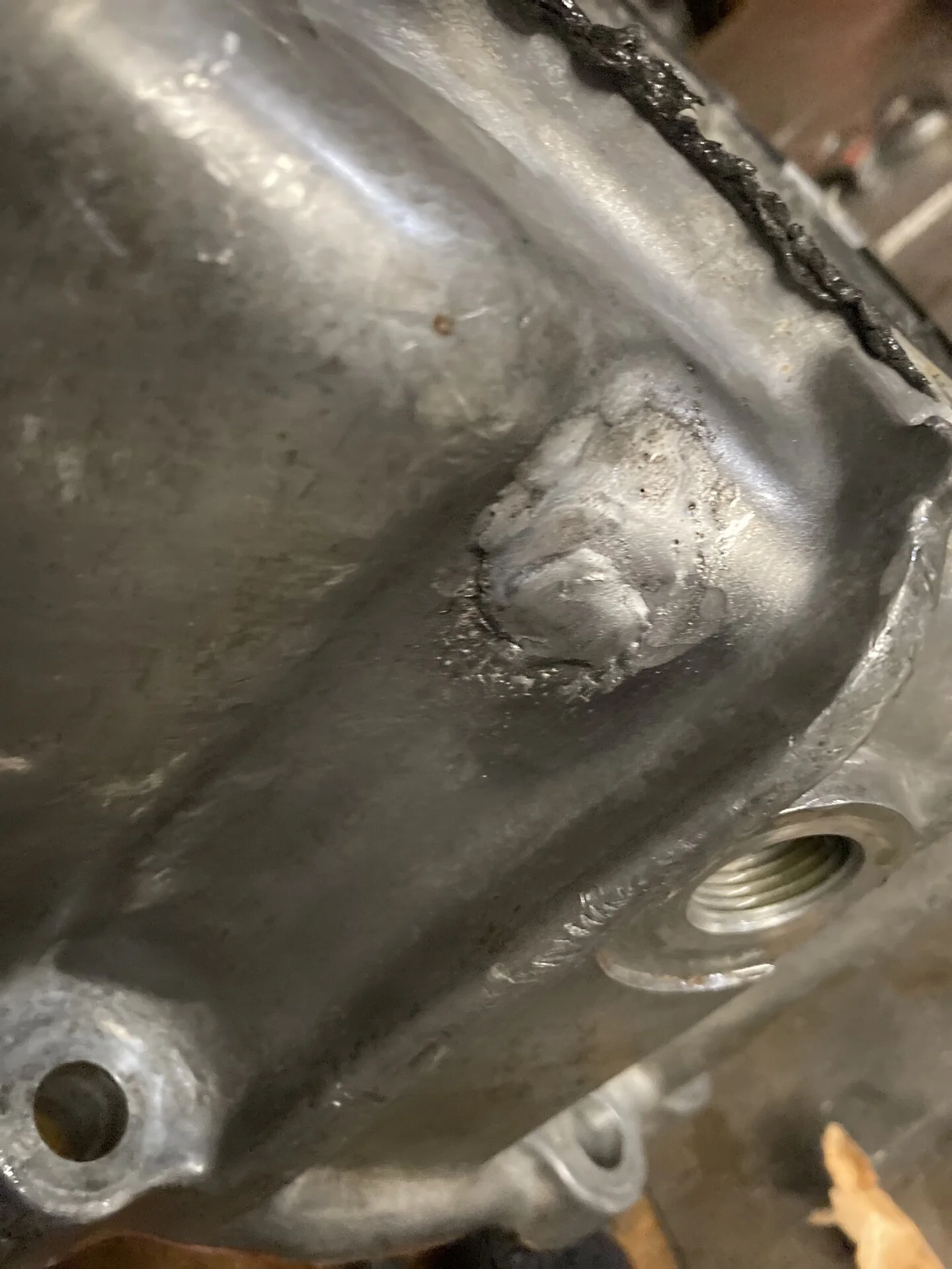

A while back I like a dumby I put a hole in the transfer case. Took it to a guy who told me I need to split the thing open and clean it before he could fix it. I didn’t wanna break all the freah gaskets doing this so he tried to do it anyway. Looked good when I got it back.

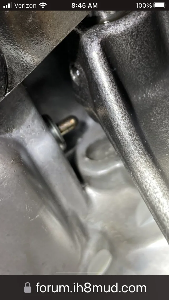

I have been putting the fluids in, diffs done, went to transfer case and it’s leaking from that spot!!!! So bummed. It’s a split case so I hear it’s easier but was not planning on this. :(
Got a photo of where its leaking?
If its just a leak could you simply seal it up with JBWeld or metal putty from the outside? Transfer case isnt' under pressure and you just need to keep the fluids in right?

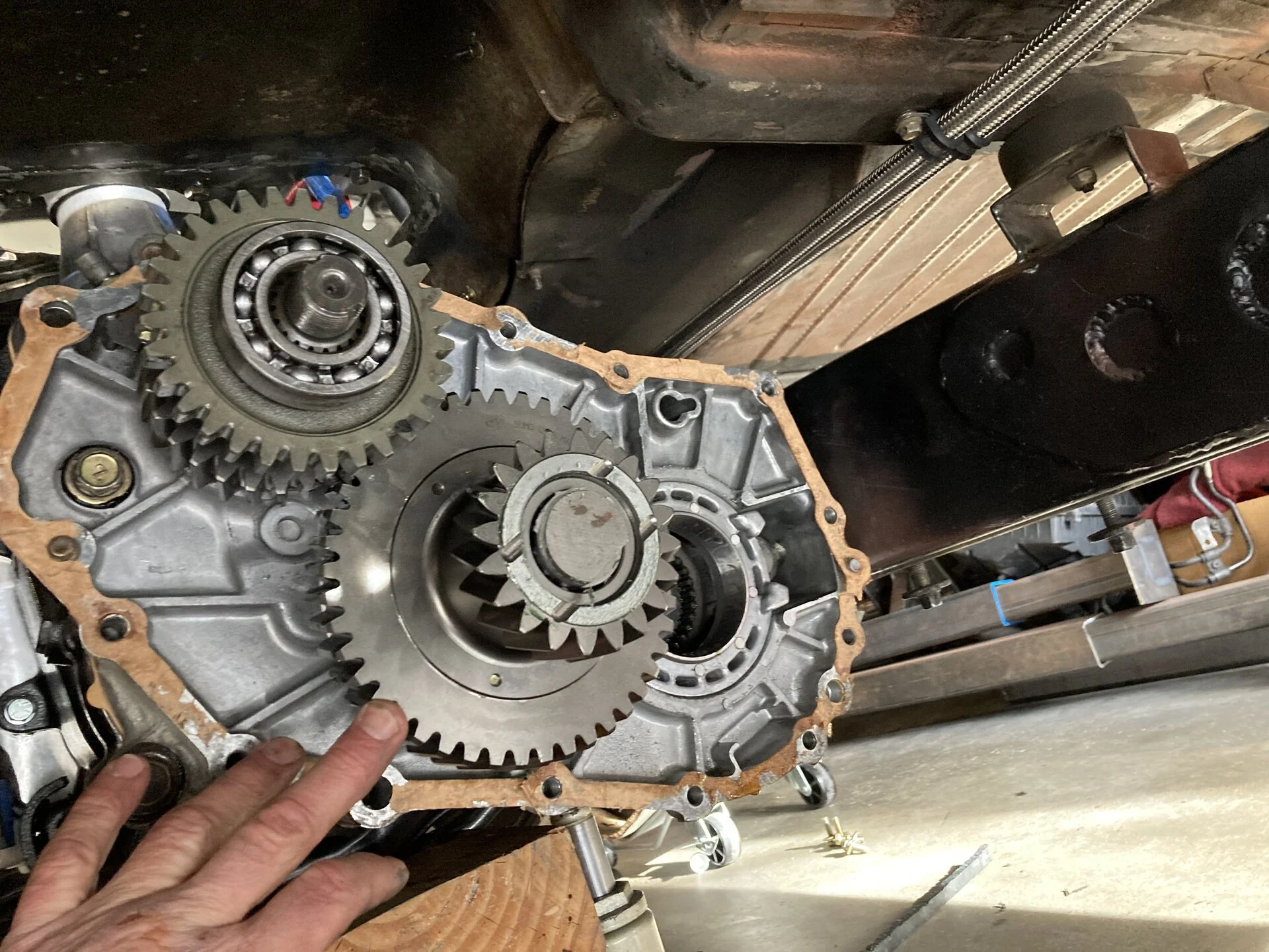

So definitely needed to be done. Thinking that I will build it up on the outside such that I can clearance the inside with no worry of thinness. With no leaks is the key!
Notice the crack! Boy, if I had only know she needed such tender hands. Thought she was tougher than that.
Funny luck that the impact, whenever it was, was right on the spot that they clearanced for the 4-1 gears. Super thin there.
Now I will make it dumby proof.
