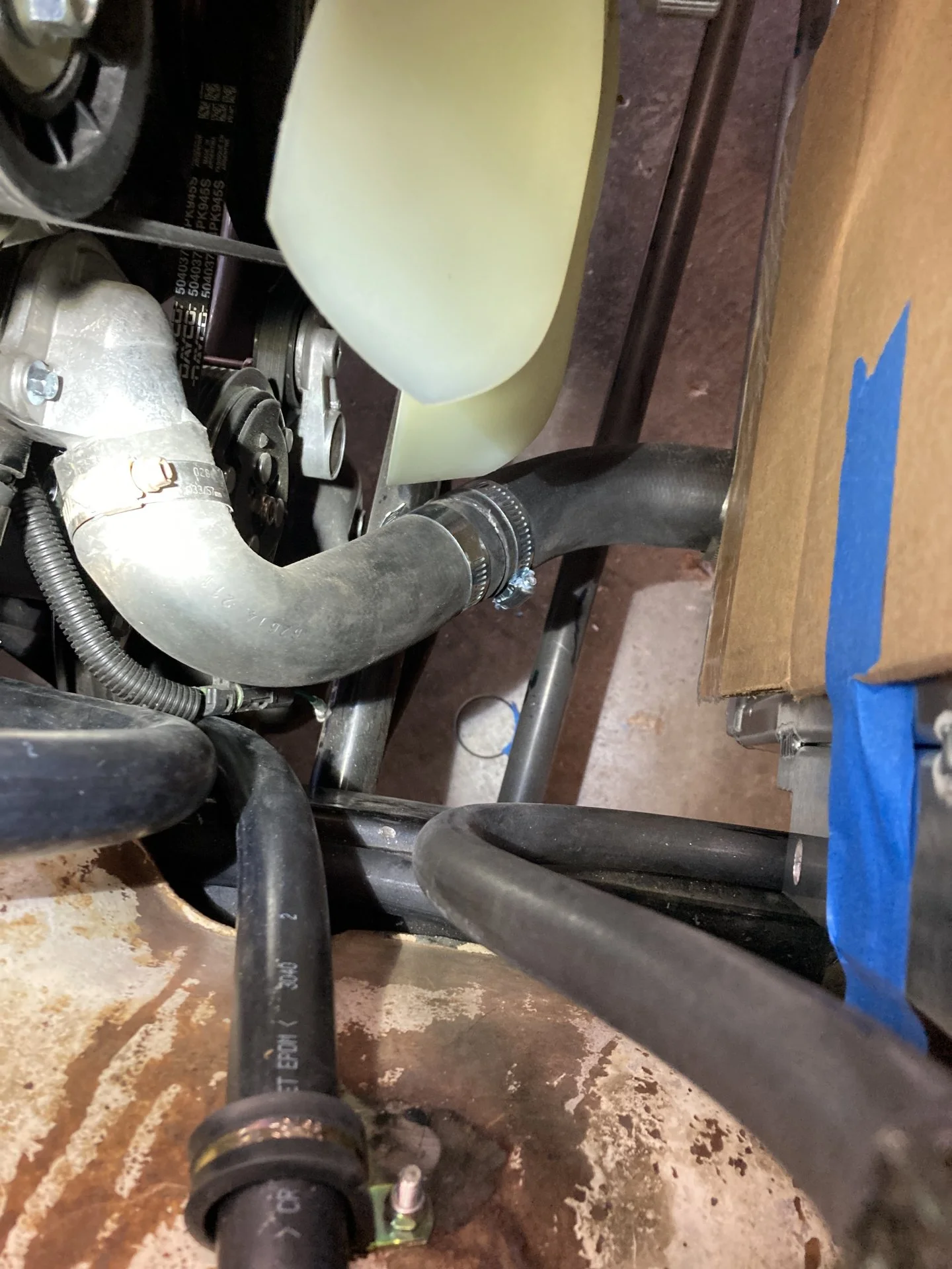

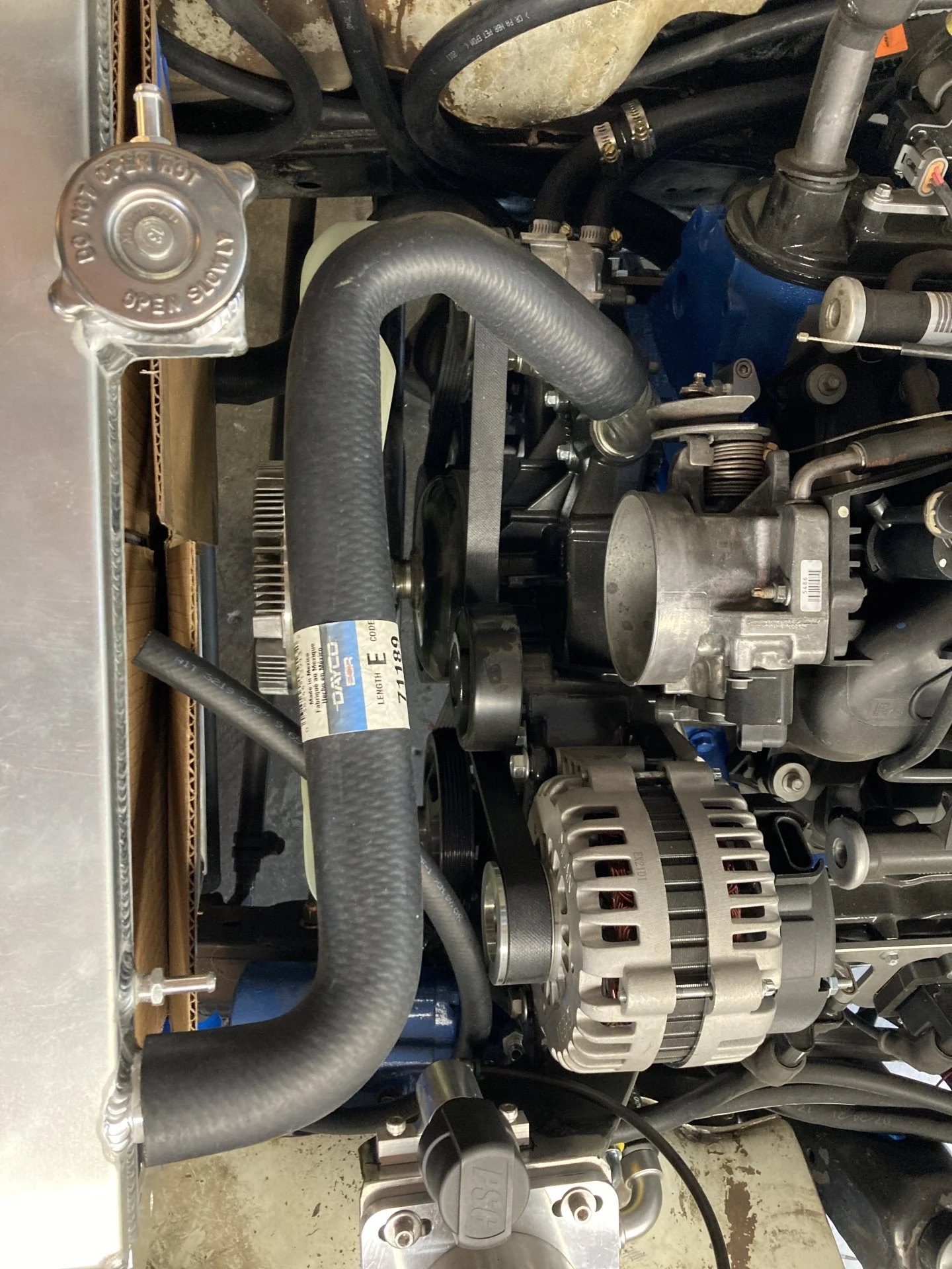

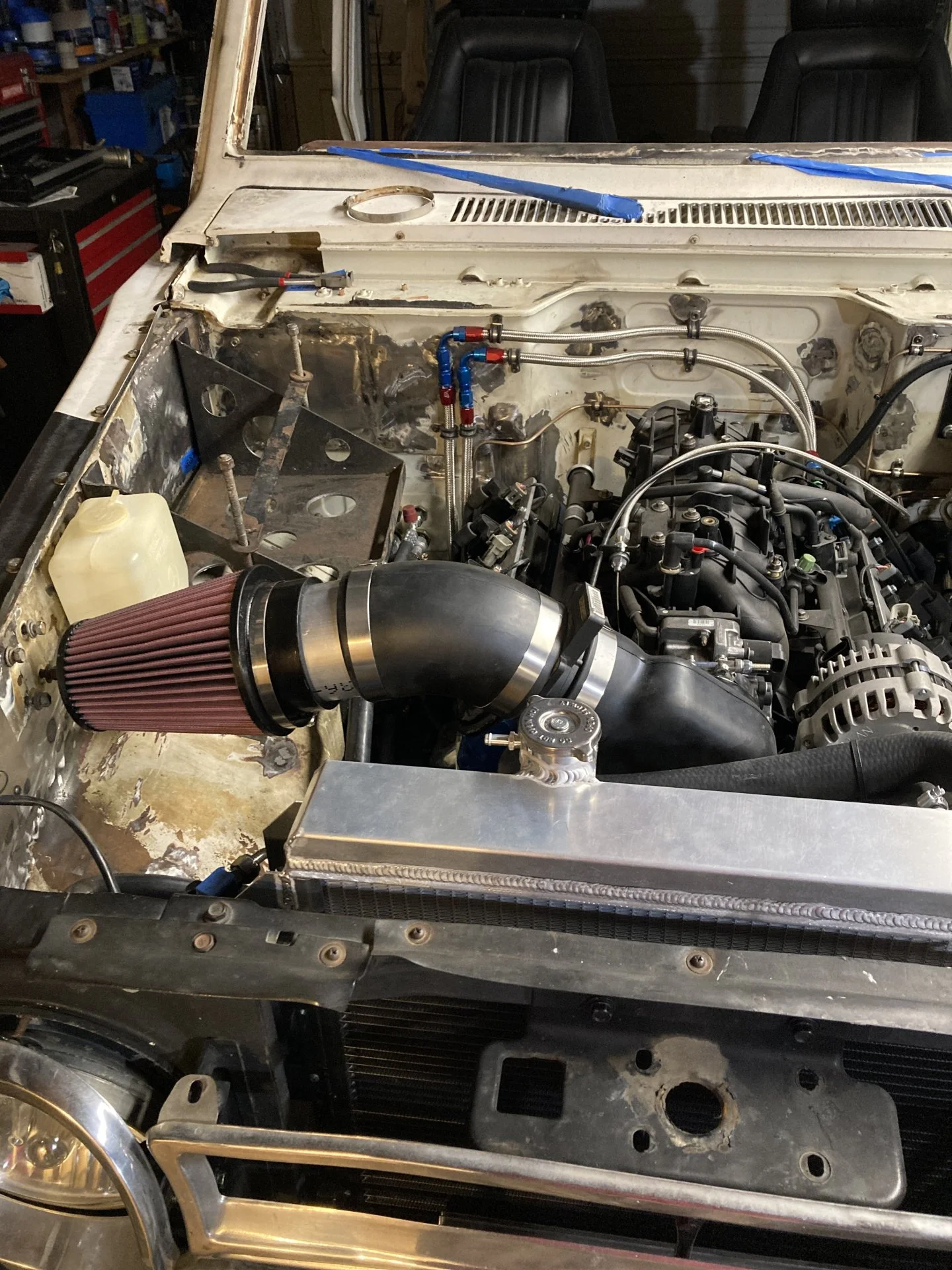

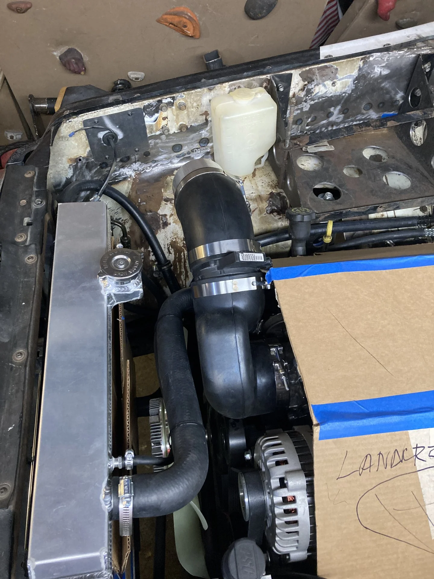

Think I might have gotten it after the second store. One uses a coupling and one seems to work with a bit of trimming.
Top hose- Dayco E 71189

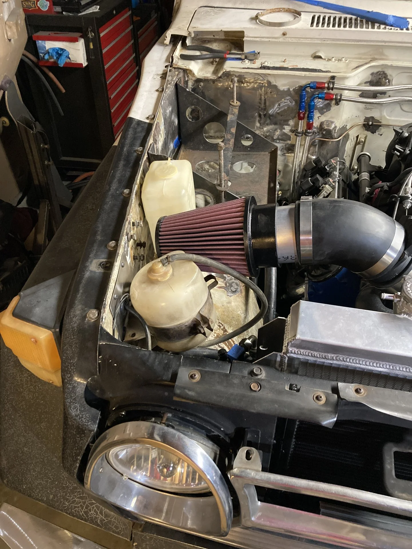

What kinda radiator over flows is anyone using? I reaaaalt wanted to use this thing but space might not allow.
Ya know, nod to the past. Or is it knod? Been drinking again…
Is there any relation between the height of the overflow container and the height of the radiator top cap?
Over thinking?
I don't think it matters since it's all fluid dynamics of hot and cool liquid that moves antifreeze between the radiator and overflow. I mounted my overflow on the drivers side because I had no room. My tube goes below the radiator to cross over. I used one of Champions overflows.
3" x 10" Champion Radiator Overflow Tank for Sale - https://www.championradiators.com/3x10_overflow_tank

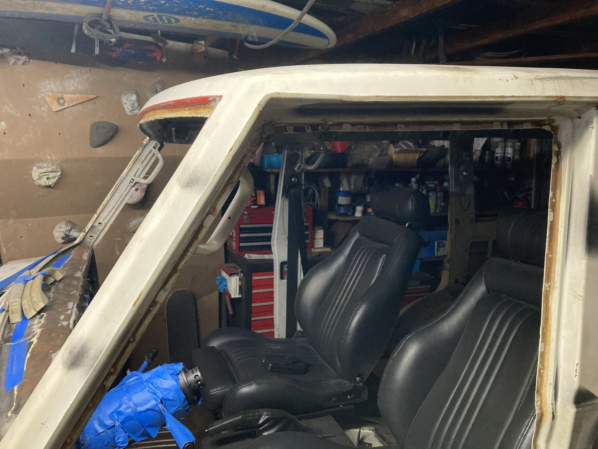

Grab handles.
If you are so inclined.
I think it will be killer with a lifted vehicle. Safe the outside bolster of the seats.
Gonna ride with these as well. Over all four doors. No love on part numbers. The outside bolt cover is the butter!
