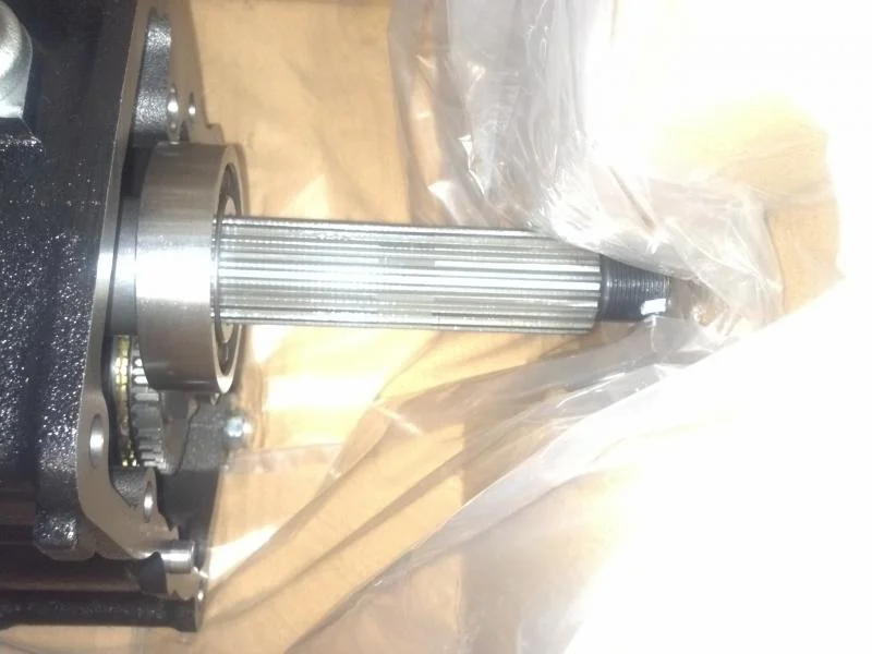

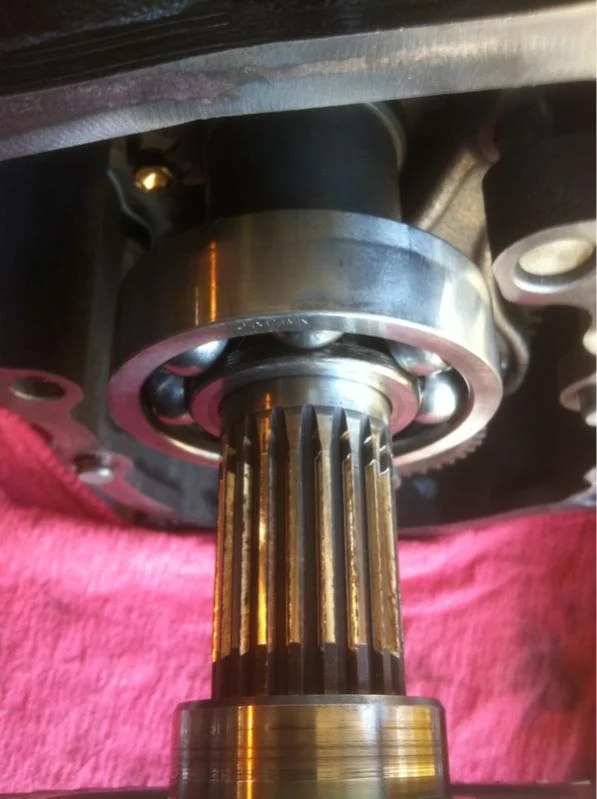

main shafts differences! from what i've seen, the h55f transmissions offered with manual shift t-cases are slightly different from the vacuum shifted cases. the splines on the rear of the main shaft, where the t-case inut gear rides, feature the same tooth count and tooth pitch, but on the manual shift case the splines run all the way underneath the bearing just in front of the front split case half. on the vacuum shift cases, the spolines end about 1/4" shy of the bearing and the useable portion of the splines ends about 1/2" from the back of the bearing surface.
this affects how much spline engagement area the shaft offers for the input gear since the gear butts up to that bearing.
what it comes down to is that the vacuum shifted cases utilized shorter female splines in the input gear. the reason for that is that the splines on the main shaft are "shorter".
in other words, you can not run a gear ( and entire split case ) on just any h55f. the h55f originally sold in conjunction with a mechanically shifter t-case will accept anyt split case from 10/82 and up. so you can use the later style 34mm case, the mechanically shifted 38mm case or the 38mm vacuum shifted case with the bearing supported output gears. from what i've seen, all the vacuum shifted cases also feature the bearing supported output gears. i'm not 100% sure if this is a fact or just that i have'nt seen any different. please correct me if i'm worng.
this also means that if you have an h55f that came originally with a vacuum shifted t-case, then you have to run not only a 38mm case, but you need to run the gear set out of a vacuum shifted case. these have the shorter female splines in the input gears and can potentially wear out faster since there's not as much contact area.........
the one exception to all of this is the fact that we do have the luxury of being able to purchase a McNamara gear which has the offset splines and will worn on either trans.

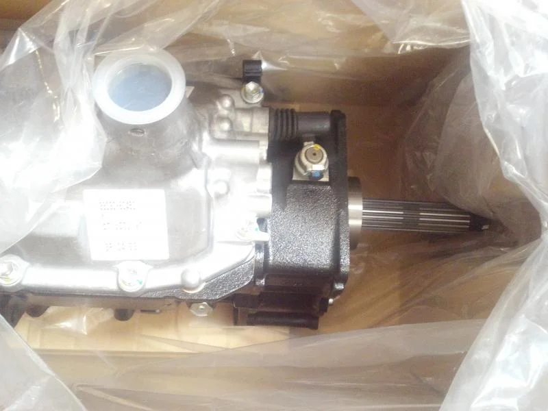

a couple of pics to follow. hope this helps!

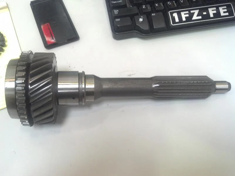

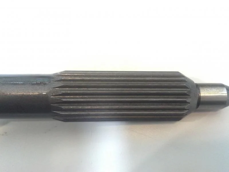

More tech: just added another thread about building a late model 70-series new OEM split case onto a “short” 19-spline H42 transmission:
"short" main shaft splines.
i don't have a great pic of the "long" spline h55f main shaft right now, but i have another trans coming in less than two weeks for a sweet fj45 project, i'll take some pics then unless somebody has one handy.

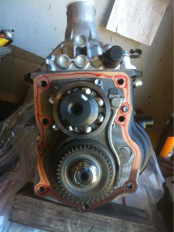

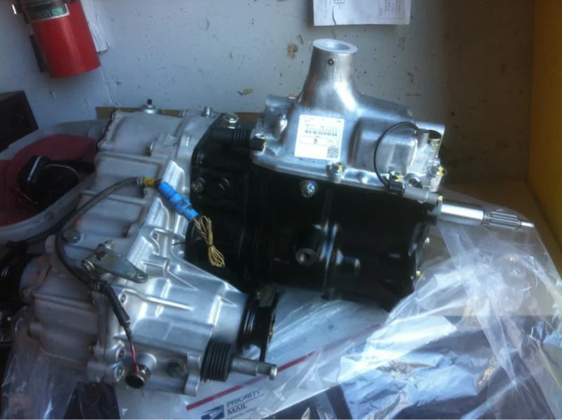

and one more tidbit about the h55fs. even when i buy a new trans from the dealer, i remove the 5th gear extension housing and apply some loctite "formula 518" to the gasket. i've seen a few of these transmissions leak between the main case and extension housing and i've heard a few people complain about it. doing this only takes 20-30 minutes ( if you get interrupted by customer phone calls :lol: ) and it's well worth the effort! you have to remove the 5th gear detent screw, spring and check ball but none of the linkage or levers. pretty simple really.
here's a crummy pic. sorry, all of these were taken with an iphone.....
hth
