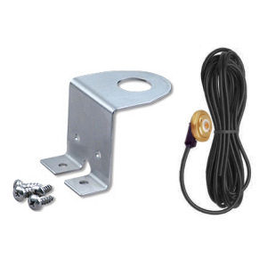

Laird Bracket & wire
So my plan is to install on the drivers side between the hood and the 1/4 panel. I know its not ideal, but the only use will be on the trail, so it needs to survive. A friends advice was to get it all installed and have a local radio shop tune the antenna.

Like I linked above, I'm using this bracket to mount on the drivers side 1/4 panel.
Here is what I'm thinking:
1) sand down to bare metal on the 1/4 panel
2) re-mount
3) "fillet seal" the edges with dielectric grease to keep the water out
Would that be good enough or should I run a separate ground cable?

Yes that would be good enough as long as you have bare metal contact.
