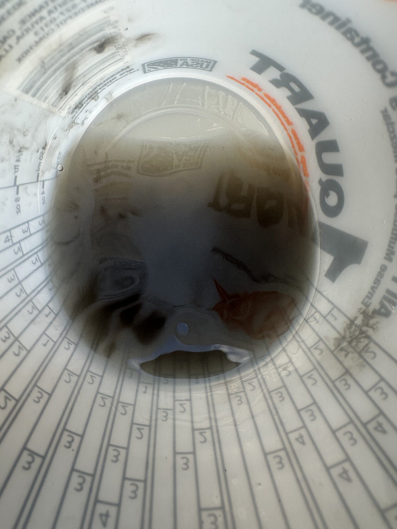

Just took off the fuel filter and shot some brake cleaner through it both ways and this is what came out, no big chunks of anything but I’m pretty sure it’s not supposed to be black/brown. Filter probably has 80k on it
Well I have my answer, cleaned the filter but now the misfire is worse and I noticed when it missed, I was getting a little puff of of white smoke. I smelled the exhaust pipe after I shut it off and it definitely smells sweet like burning coolant, pretty sure my head gasket is shot. Luckily I caught it early enough that I think I can just replace the head gasket and nothing else is damaged. The coolant is still clean and red and the oil is not milky. I think the gasket blew and was seeping coolant into the combustion chamber and it was burning off after warming up but now it’s definitely seeping in after it’s hot. Iv rebuilt this motor once so it shouldn’t take me to long to do it again and I don’t think I’m going to pull the motor out of the truck this time. Wish me luck…
