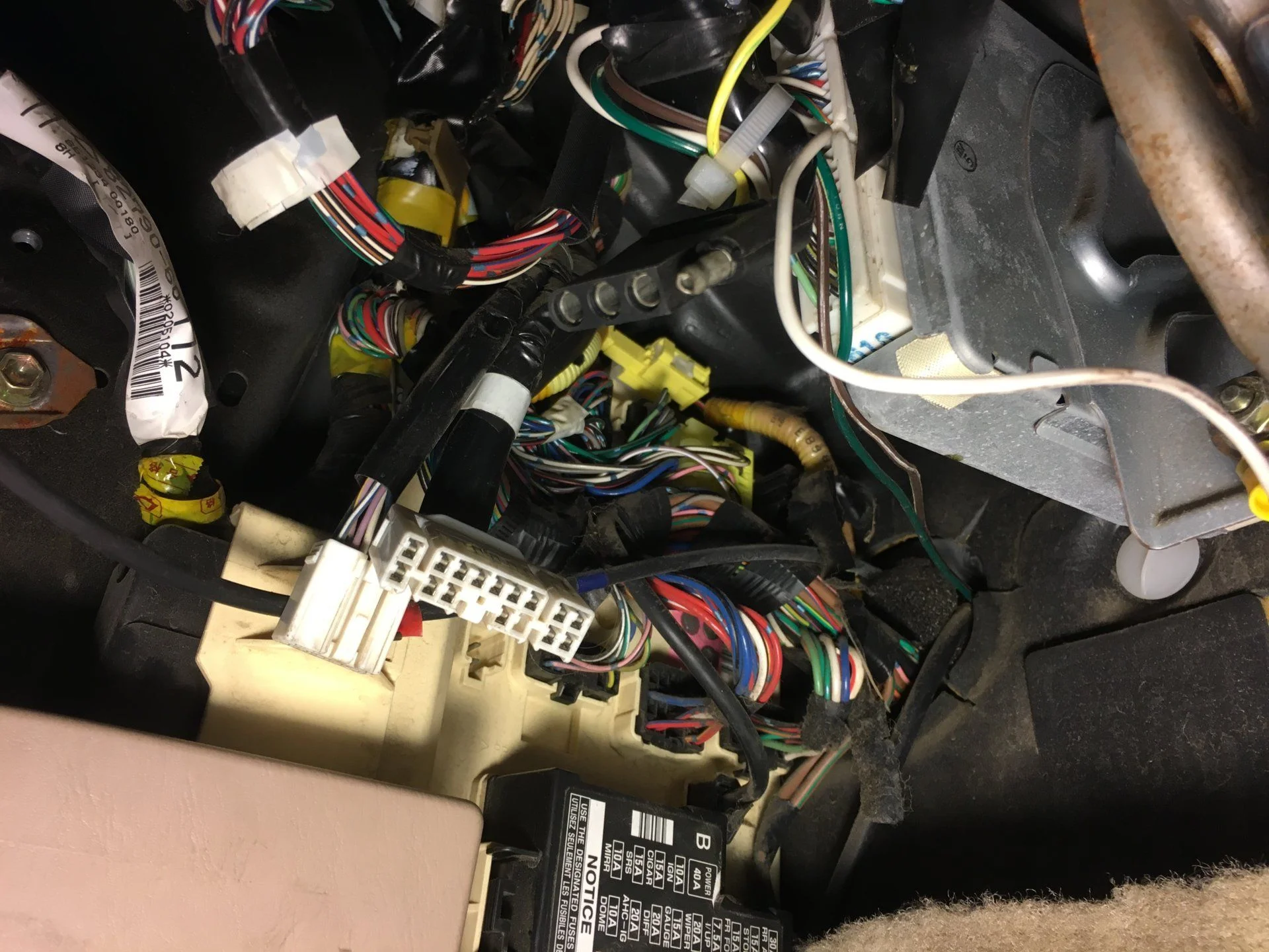

I just pulled it out of the dash, and need to know how to diagnose this. With the key off I have constant power on the red/blue wire, and on the dark green. The gray wire in between these, has power when the key is turned to acc. I'm grounding to the brown wire.

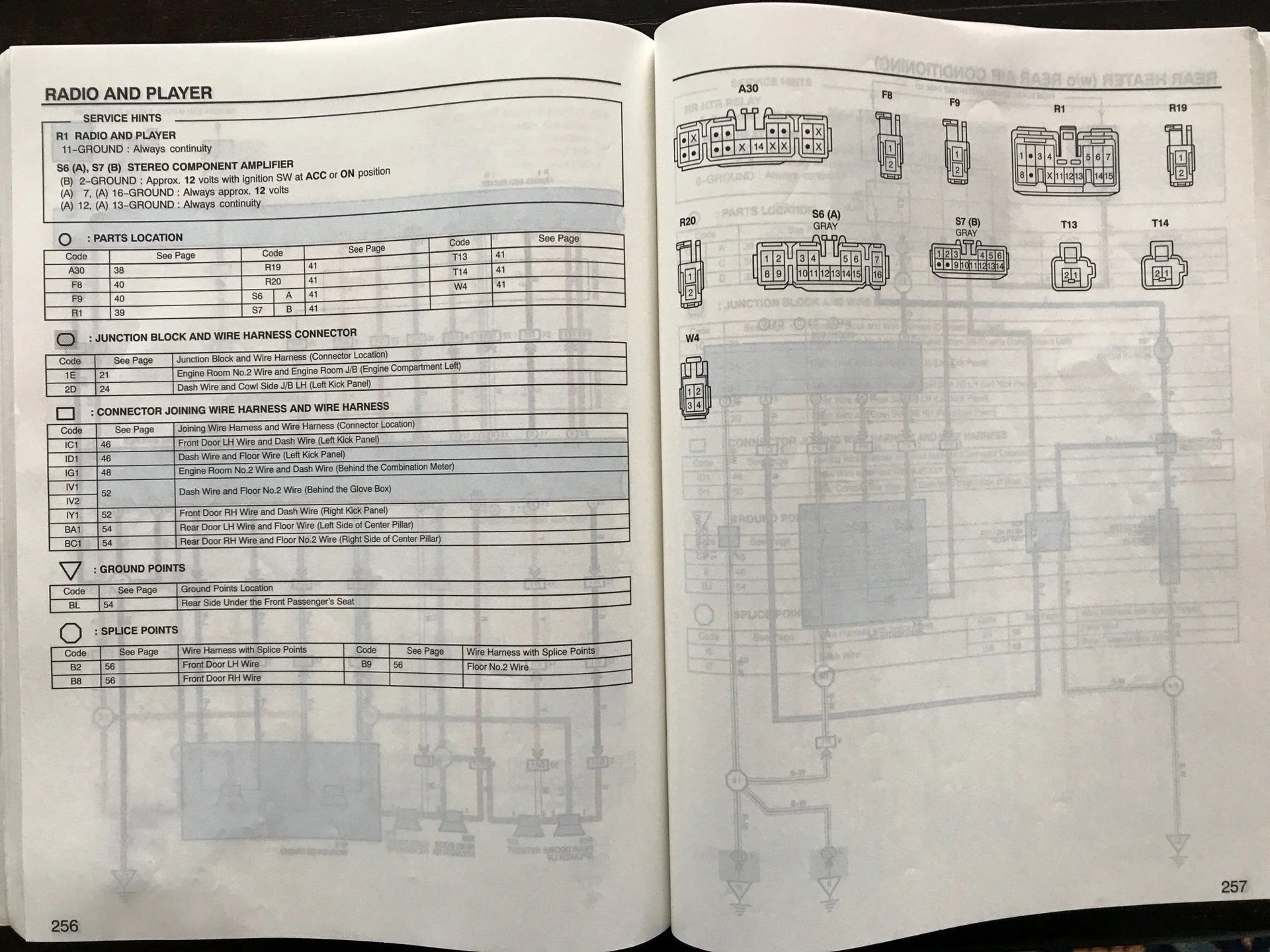

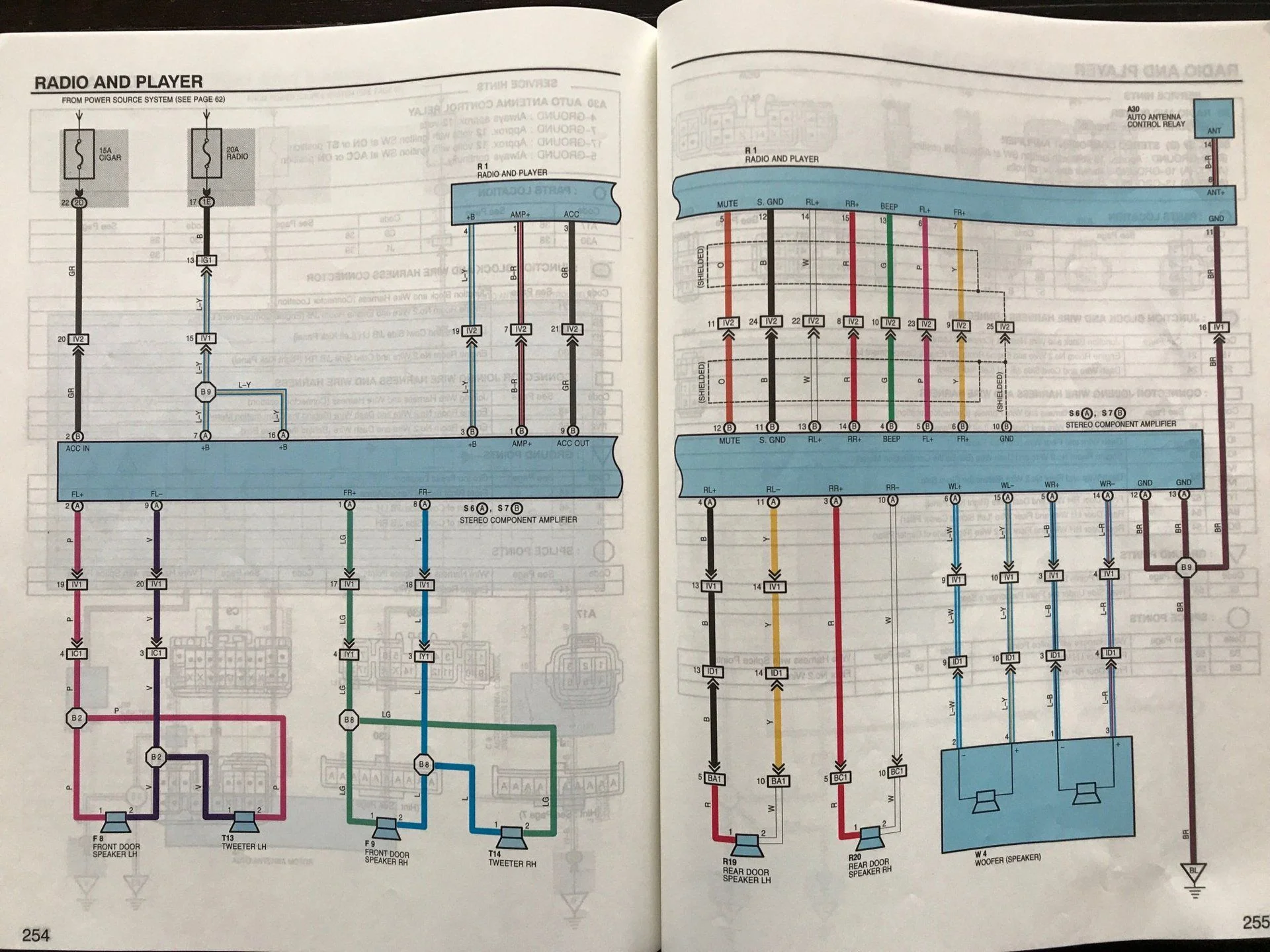

@humpndunk Have you checked the 20A radio fuse? Below are the wiring diagrams for your '98. The connector in your pic is "R1".
Looks like there's supposed to be constant power on pin 4 (L-Y or blue w/yellow stripe).

-connector S6 at the amp: I get B+ 12V at Pin 7 and Pin 16. With key turned to ACC, no other pins are live other that the B+ ones. that seems to be expected.
-at connector S7: No B+ on any pin. With key turned to ACC, i get 12V on a single pin. that's expected.
-at connector R1 (head unit) with S6 and S7 plugged into the amp: B+ power at pin 4 (expected) and ACC power at pin 3 (expected)

ayune's pic should be all you need. Check input and output ACC on the amp, check amp grounds, check radio ground. If you have no output from the amp to the stereo then something is up with the amp.

ayune's pics are super helpful, part of why this is so tedious for me is the stock harnesses are not there. The harnesses were clipped off by whoever did the install, so I am flying blind here as to which pin is which.
