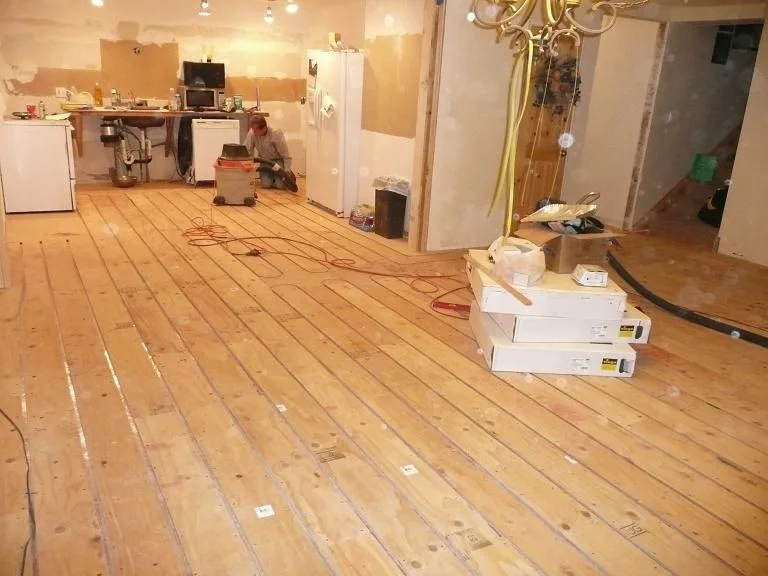

So my kitchen project is moving along. One of the things I am doing is installing pex over the floor boards and then new tile. I've talked to several people about how to do this and get a different answer each time. Here's the scenerio. I've already got the boiler and run forced hot water to some base board heater units. The area that I'm looking to add heat to is 650 sq feet. I had a heat loss calc done and was told to run 3 x 250' lines with 8"spacing between the 1/2" pex.
The original floor has 1" pine planks on the diag. with 3/4" plywood over the top of it. It then had a 1/2" article board stapled to that with Saltio tile over the top. The tile and 1/2" board are being removed. I looked at having the pex poured into a cement slab over the floor, but expense and engineering prohibit it. What I propose is ripping a bunch of 1/2" plywood into 8" strips and laying it spaced out to make the groves for the pex. I'll router half round end caps for the pex bends. Should I staple the pex down into these grooves?
I was then going to scratch coat in a layer of Hardy backer and then my 20" tiles. Should I leave any sort of expansion joints for the heat and cool cycles? What am I missing or misthinking on this? The basement cieling under this floor could be insulated is needed. Do I need an additional pump or can I run a line of the discharge of the existing system? My boiler is way under used right now as I ripped out 3/4 of the baseboard heat that was in the house when I bought it. I hated having my furniture a foot away from all the walls.

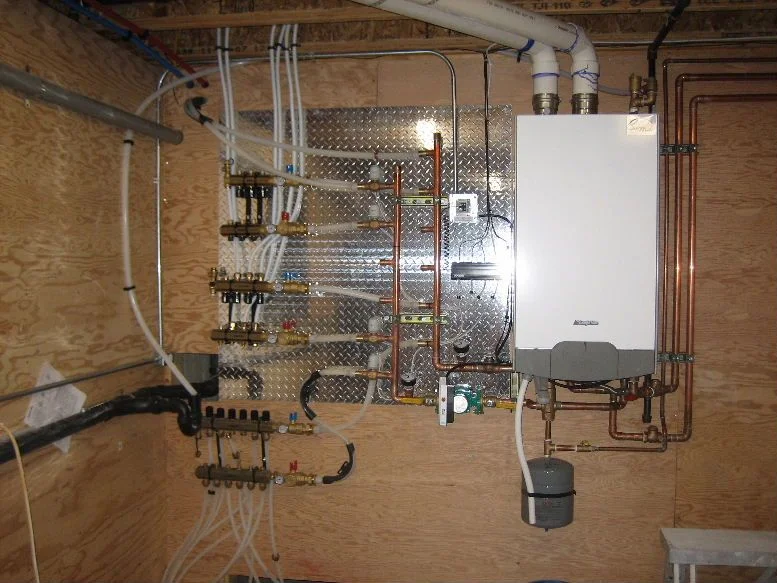

Good luck - here's a shot of my system that i installed, it's pretty easy once you decide to jump in and get to work.

Your system is way to clean looking. I'm thinking more like a spahgetti bowl...Actually it gives me something to am for.

I'm making slow progress on the radiant. My father and I installed all the sleepers during the last week and last night ran the three 250' loops. It actually looks really good. I will hook all the loops up tot the manifolds thrusday night and then we'll start laying the 4x8 sheets of 1/2" CBU.
This remodel is killing me. We laid 100 sqft of the 20" porcelain tile when I broke one while bedding it down. After inspecting the break I found a hairline crack that was in the tile before the glaze was fired. I then went through all the ones i had laid and found a few more. After replacing those I went through several boxes in my truck and had a 10-15% failure. I spent the morning with the importer of the tile and they are dropping off all new stuff in the morning. Being in the business I'm in I understand how frustrating it can be to bring something in and have problems that are not your fault. I'm not mad at the company I bought it from or the importer for that matter. I did insist that the importer go back to her boss and the manufacturer and figure out what it's worth to them to make it right beyond the replacement tile. I lost 2 day of vacation time, my father took two days off of work and my grandfather who is a General Contractor drove 200 miles to come lend a hand for a few days. They are lucky I found the problem now instead of when I turned on the heat and started snapping tiles. Then I would have them on the hook for removal and reinstallation for faulty product. Because of my work schedule I now have to hire someone to come lay the tile, in order for me to have this thing wrapped up before thanksgiving. We'll see what they do I guess.
