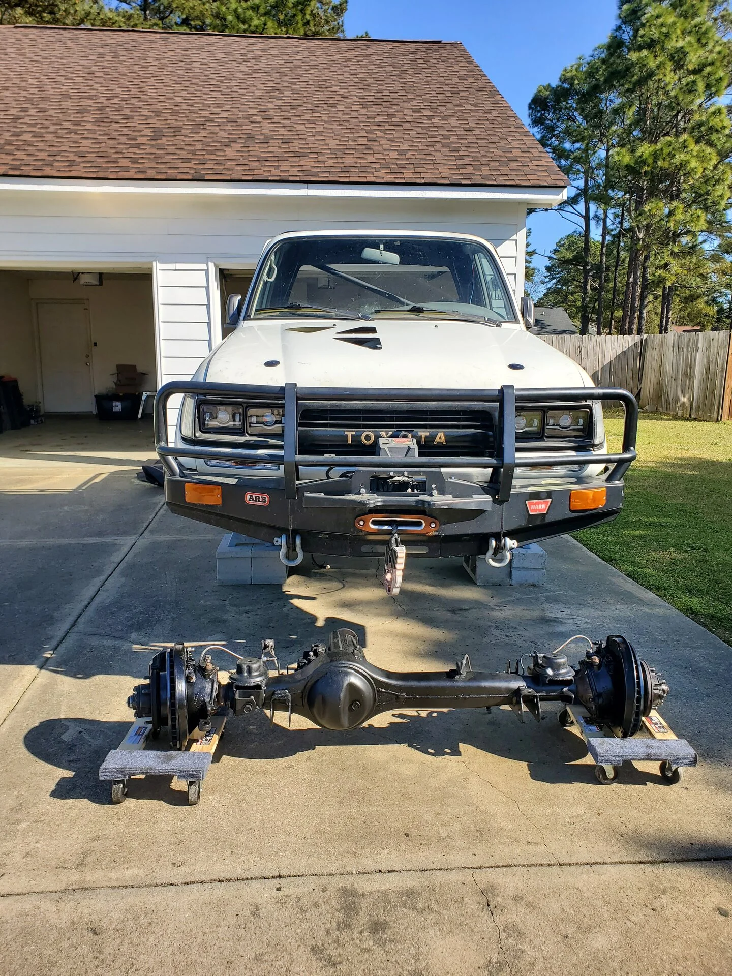

Linking would be awesome, but time is against me at the moment. I bit off way more than i can chew. Thought this was going to be a 6 month build, which i think im at a year in a half now. I start terminal leave for retirement this November, with a retirement date of March 1, 2025. I need to get it to a statis where I can take pics, show Japan, and ask them if it'll be legit to send there or not.
I also have some brand new HellFire knuckles sitting in the box that I might have to sell 🙄. Though I know it's a 🍌 jog right now that I have the axles out. . .I don't
have a welder at my spot, and don't have the knowledge/knowing placement of fabbing a new panhard mount (since im not linked). I can host a HAMMON, but this is the time that everyone is focused on thier rigs for Relic Run, GSMTR, and other Spring/Summer events.

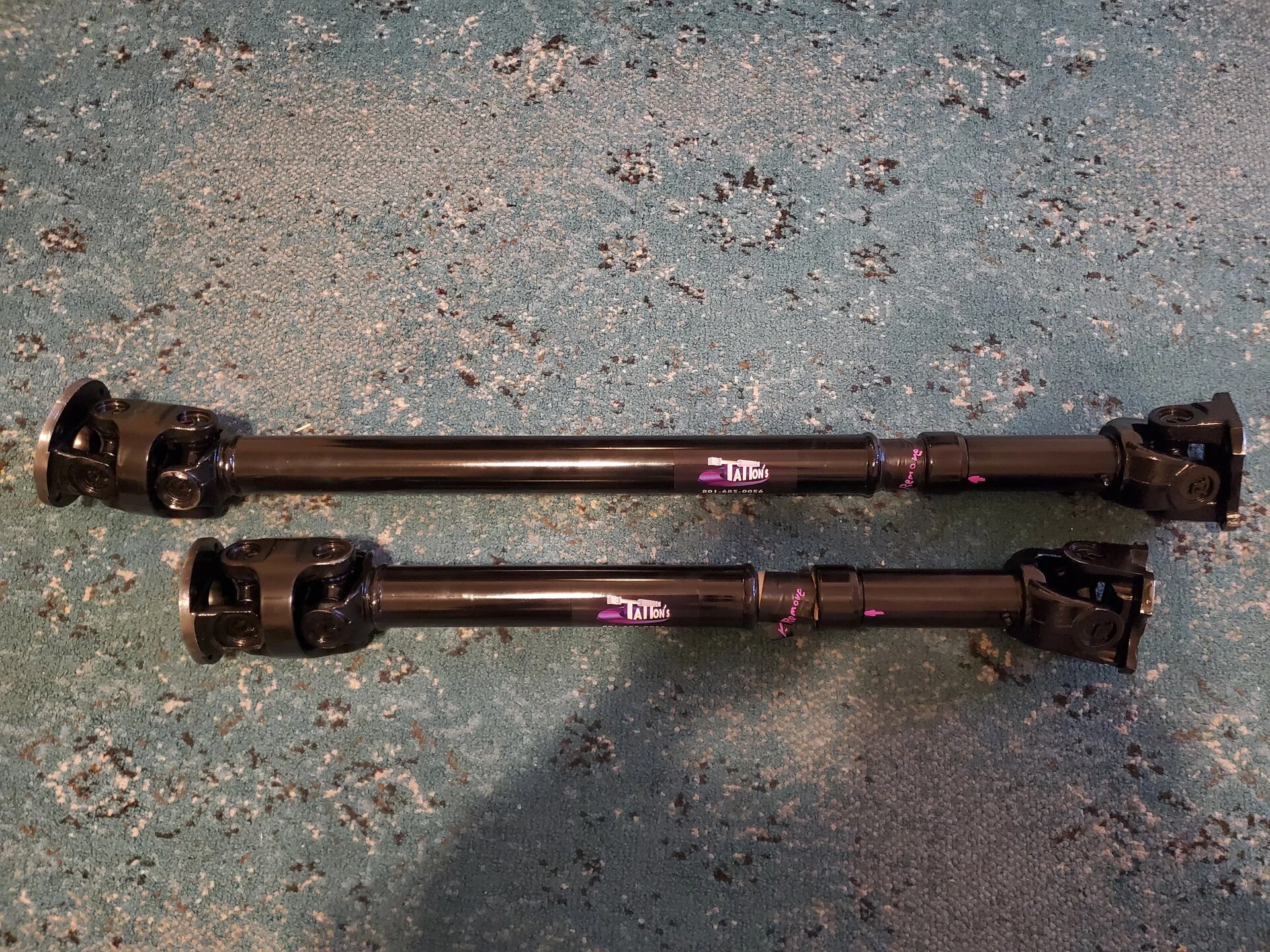

Finally got my driveshafts in.
Only took about a month in a half 🙄. Called Tatton, ordered, said they'll be shipped the following week. Each week I called, they'll be out the night week. Then I called and said don't send because I'll be gone for a week (thinking they'll be finished). Called when I returned and the same story. Called a two weeks ago, said they were done and going out the following day, but when I called last week, they were on the bench and finishing them up 🤔. Anyway, the are here now. . .should of went with Tim Wood's like I initially planned.
Caveat. I have had Tatton driveshaft before and they were pretty good.

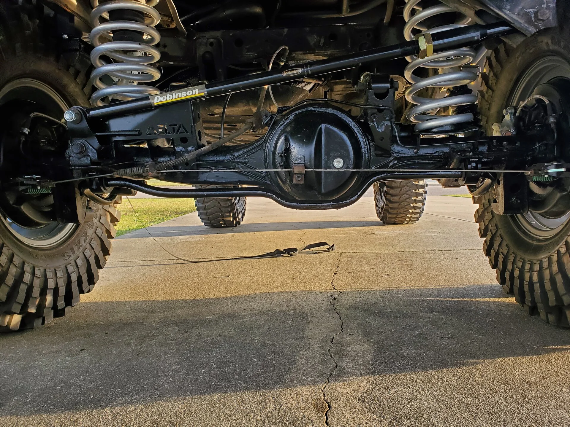

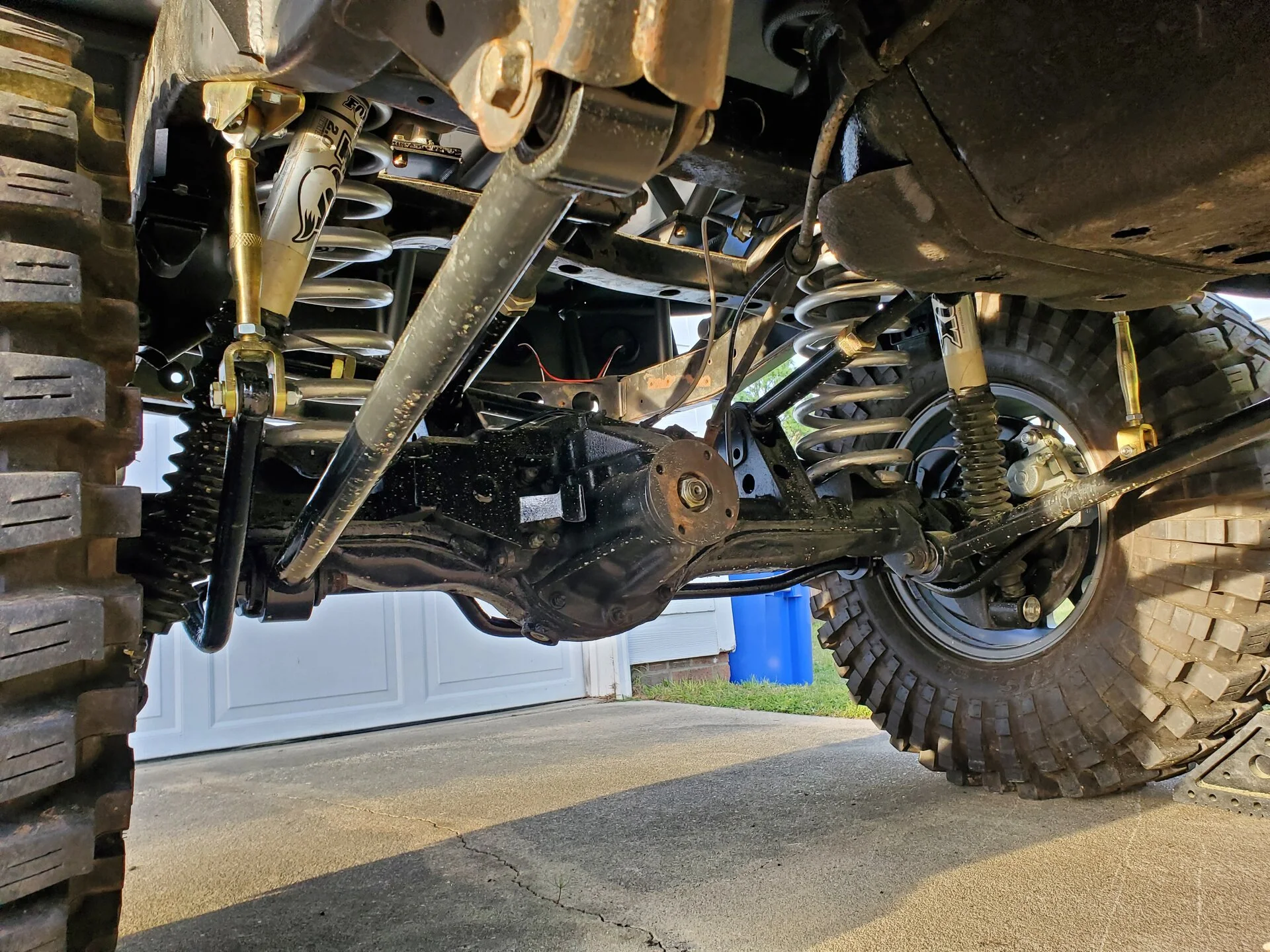

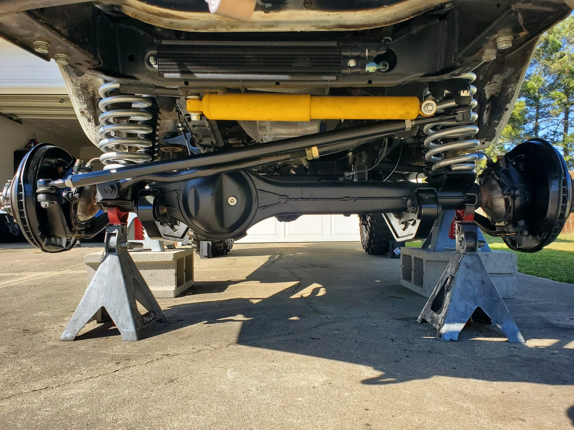

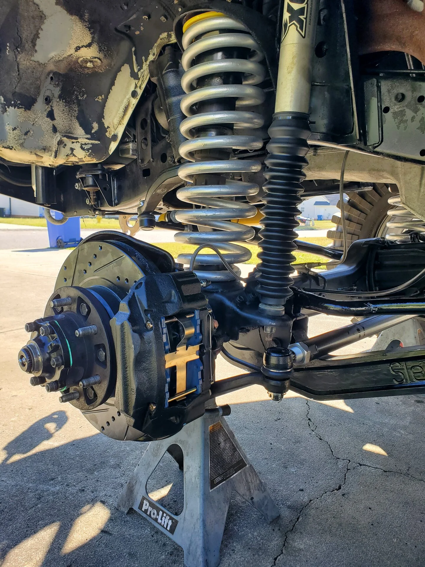

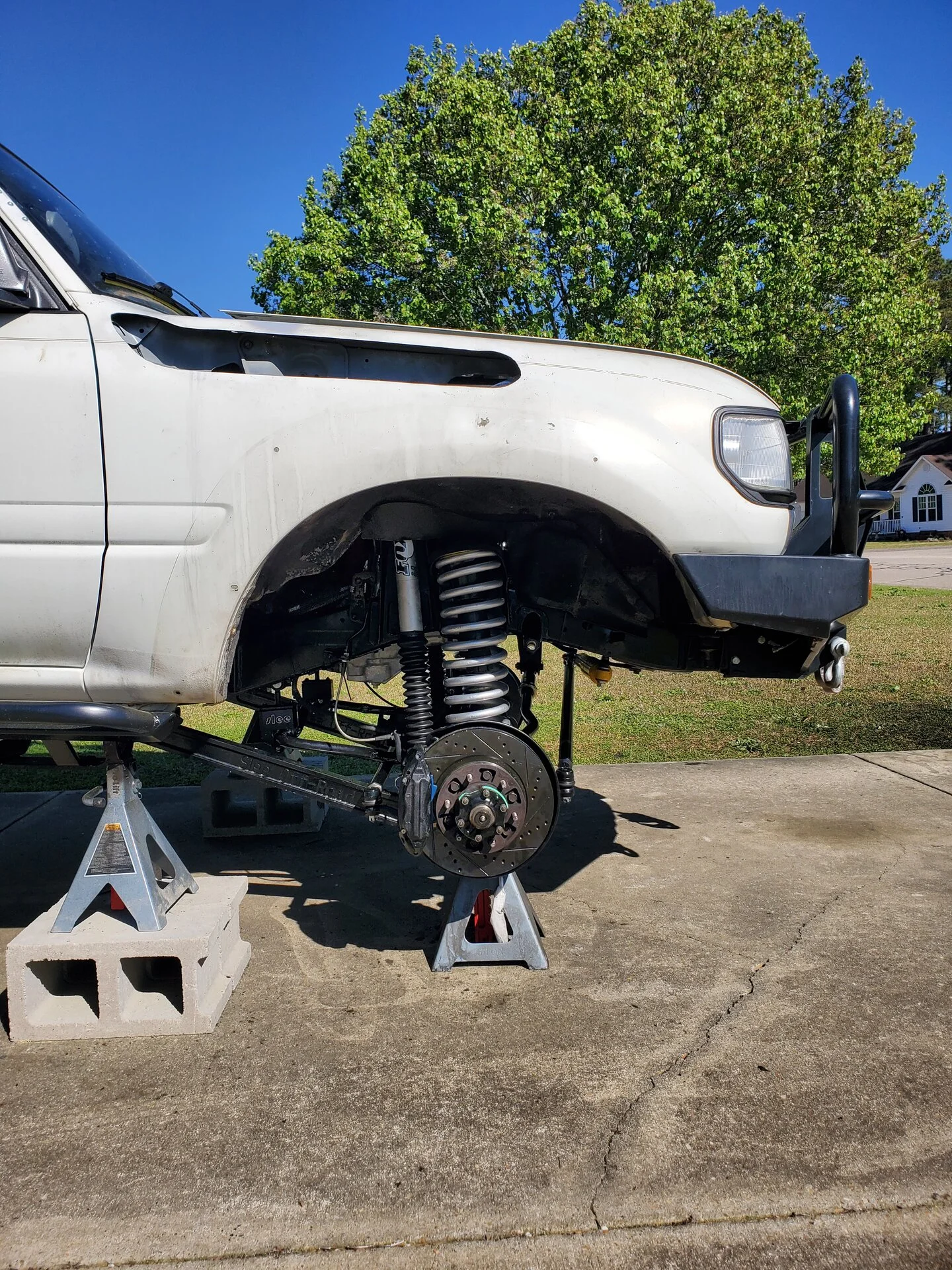

Finished up the front axles and installing a few other things that's been laying around the house this weekend.
Added the front Slee's 4" springs, drag link and tie rod; Dobinson's adjustable front panhard bar.
Fox 2.0 front shocks; braided brake lines; Slee billet front control arms.
RCV Chromoly front axles; 100 series front brake pads; and Wit's End knuckle huggers.
Also.had enough daylight to give the LC a quick rinse to knock off some pollen.

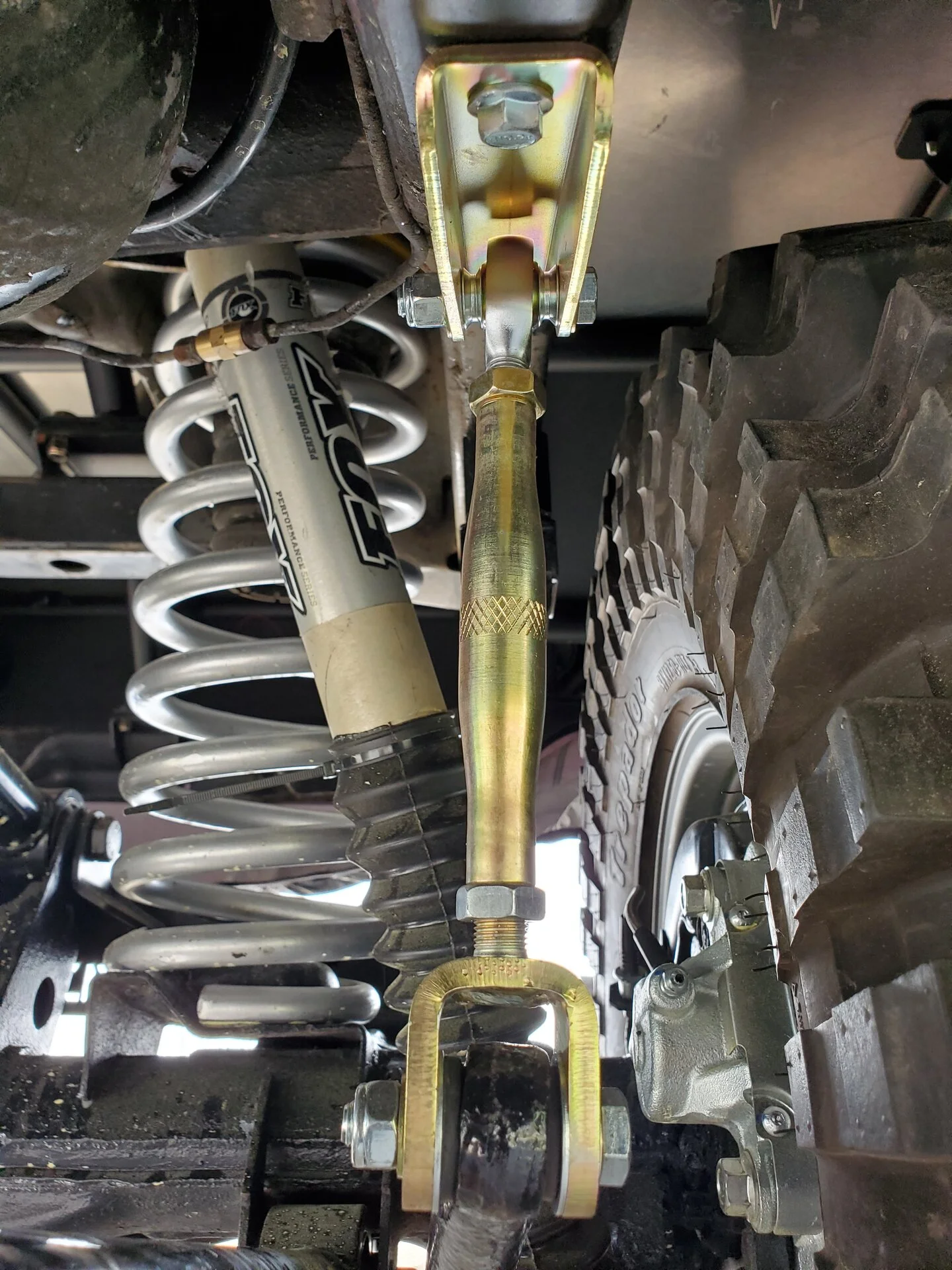

Pro install tip: Slide a large wrench along side of the Heim to align/center and then tighten jam nut.
Thanks for the Pro-tip. . Corrected.

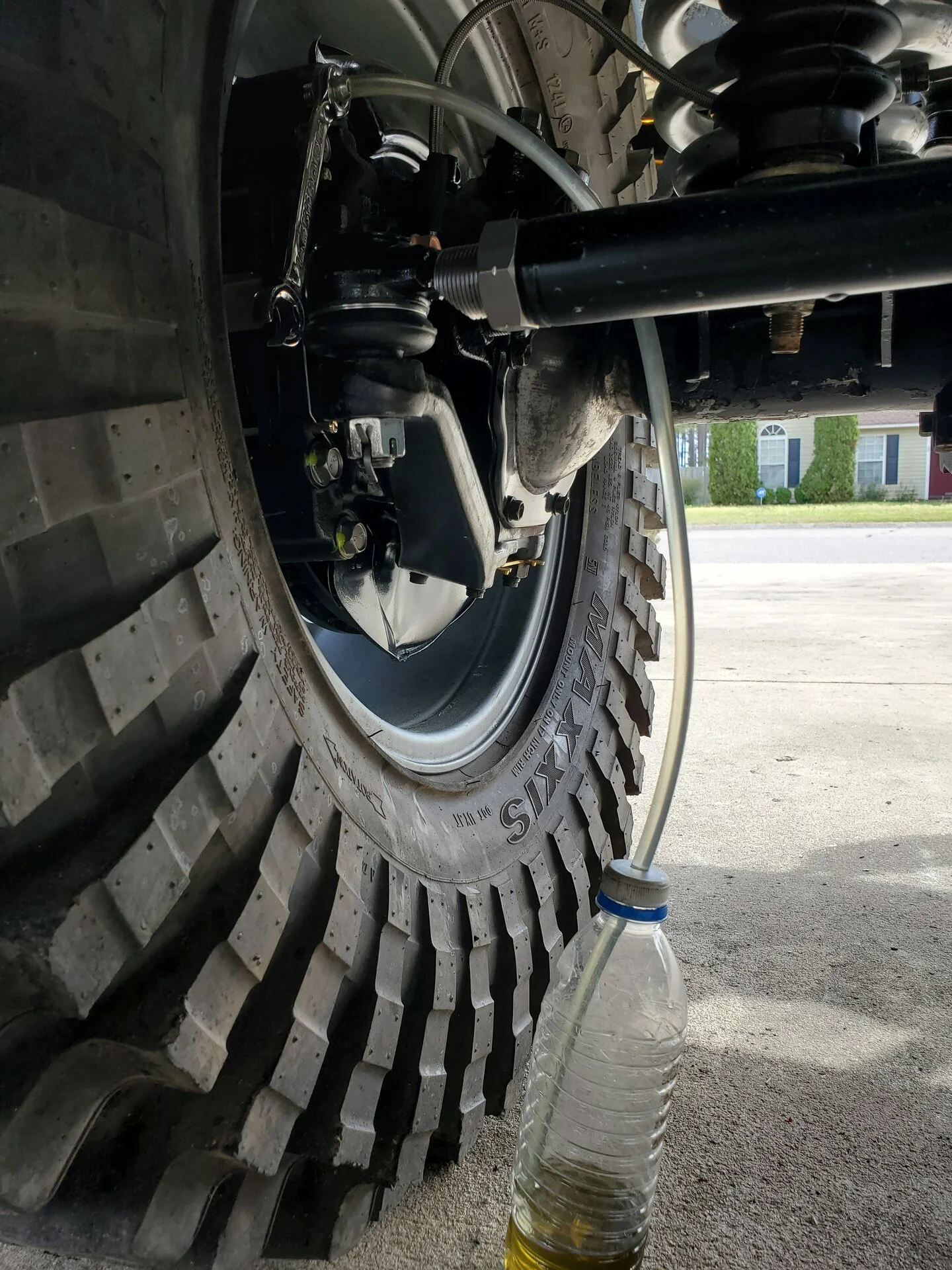

Bled the brakes and tighten up some little bits and pieces. I really like this "Speedi Bleed" thing.
As soon as I pressurized the system, it showed me all my loose brake line connections 😅
So many bubbles and dirty brake fuild. I sure this thing hasn't been serviced since 1994 🤦🏾‍♂️
Here's an example of the last brake (DS).
