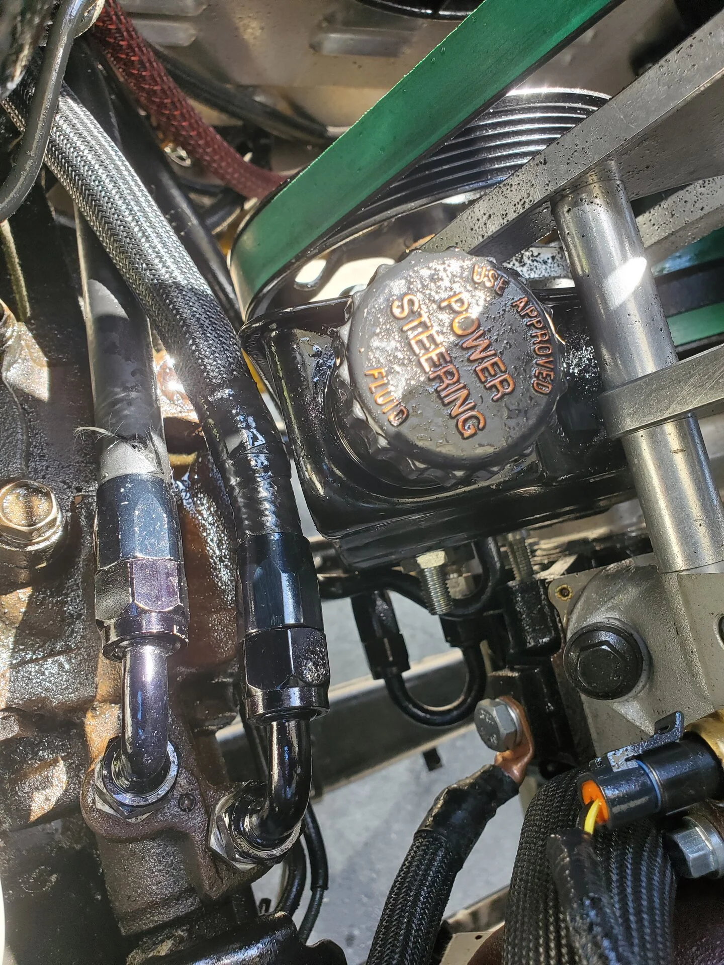

A moment ago, I wanted to make a video to listen to the exhaust and a quick drive up the block. Went to make a three point turn and the power steering lines exploded 🤦🏾‍♂️😅. . .its always something.
Any recommendations for high pressure power steering hoses? I want to think the I had was 300 psi. If 300 psi is good enough, it may of been weak from "forcing" the AN fitting on.

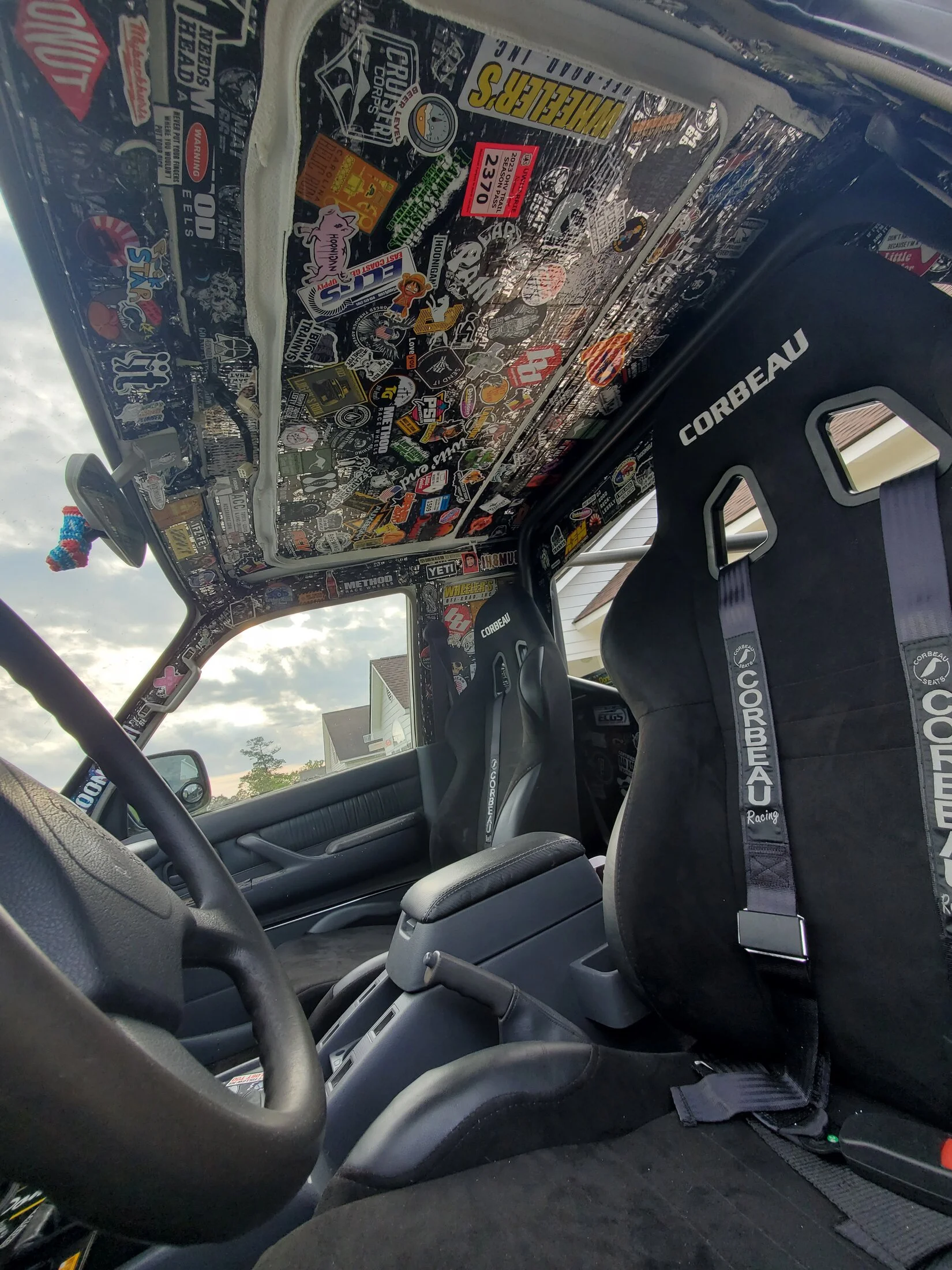

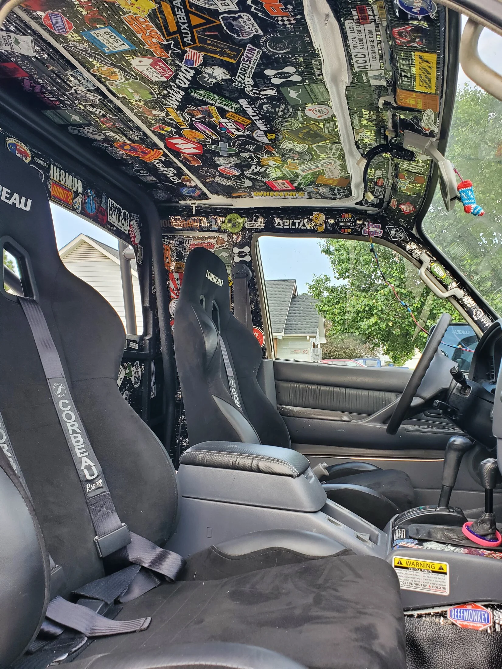

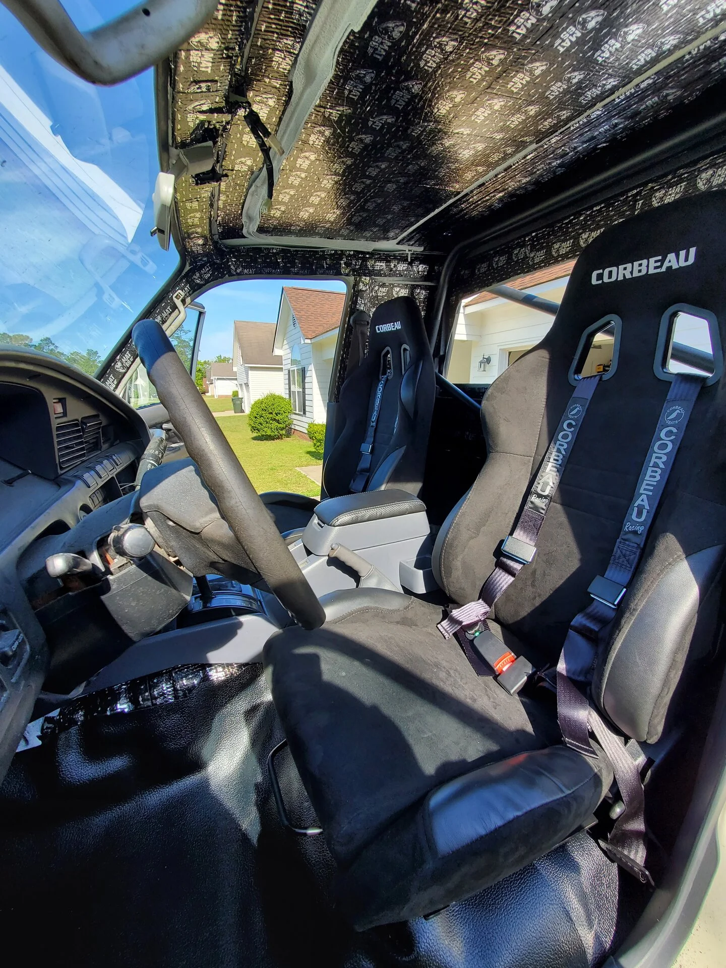

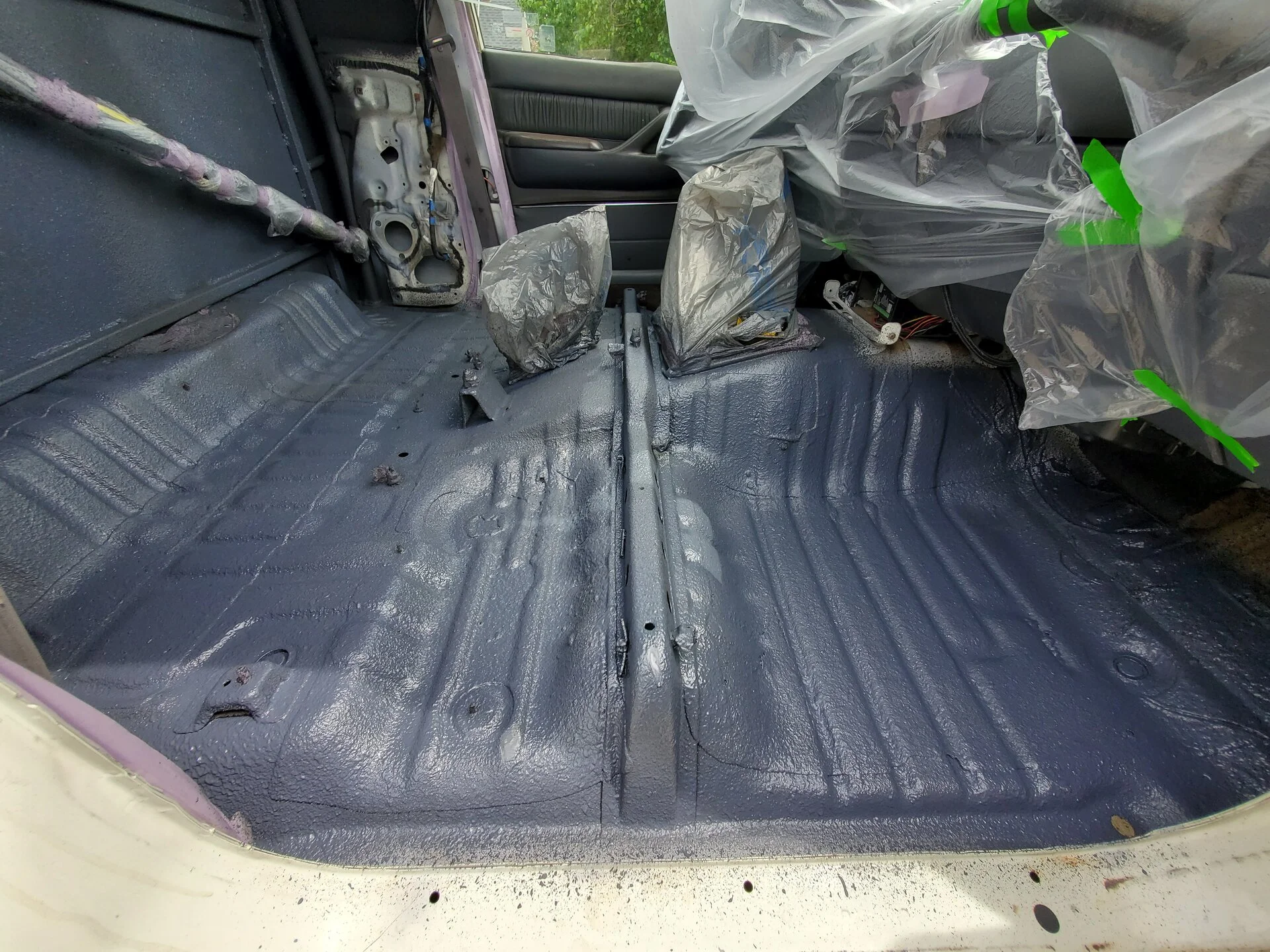

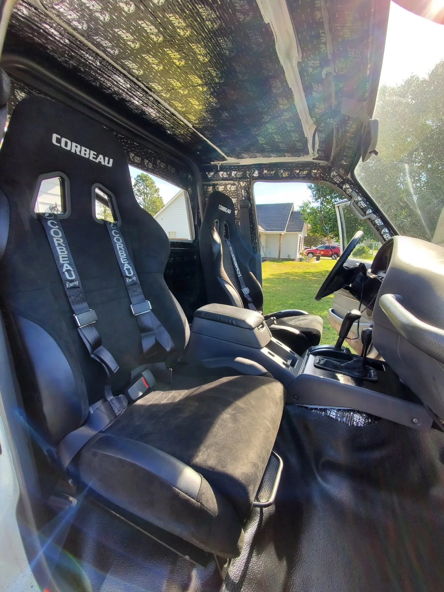

Finished up the sound deadening this afternoon. Over the past week sprayed Lizard Skin sound deadening and ceramic insulation in the LC.

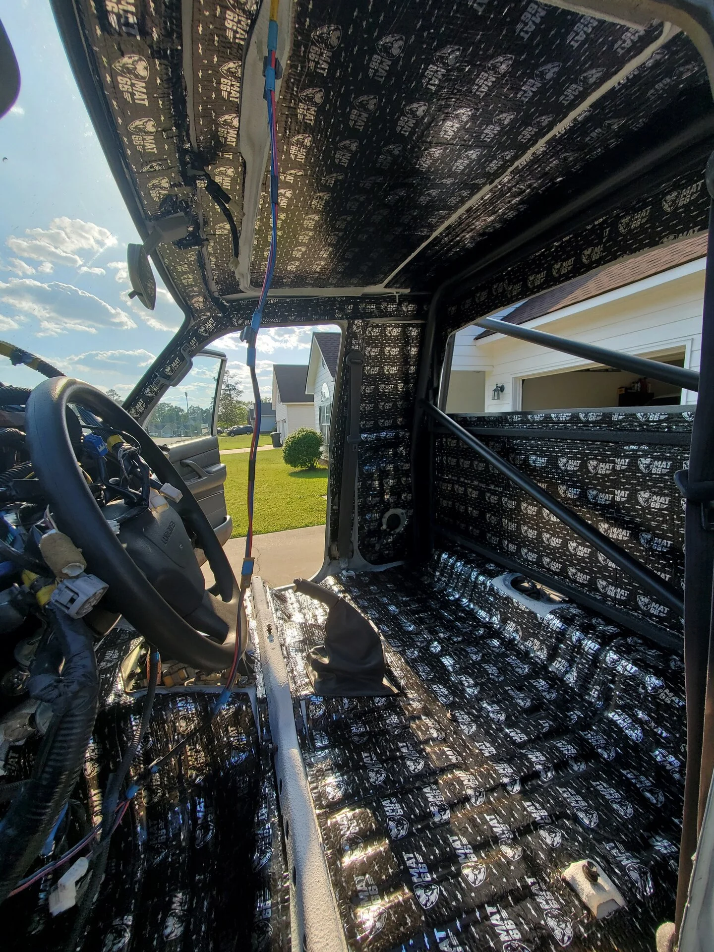

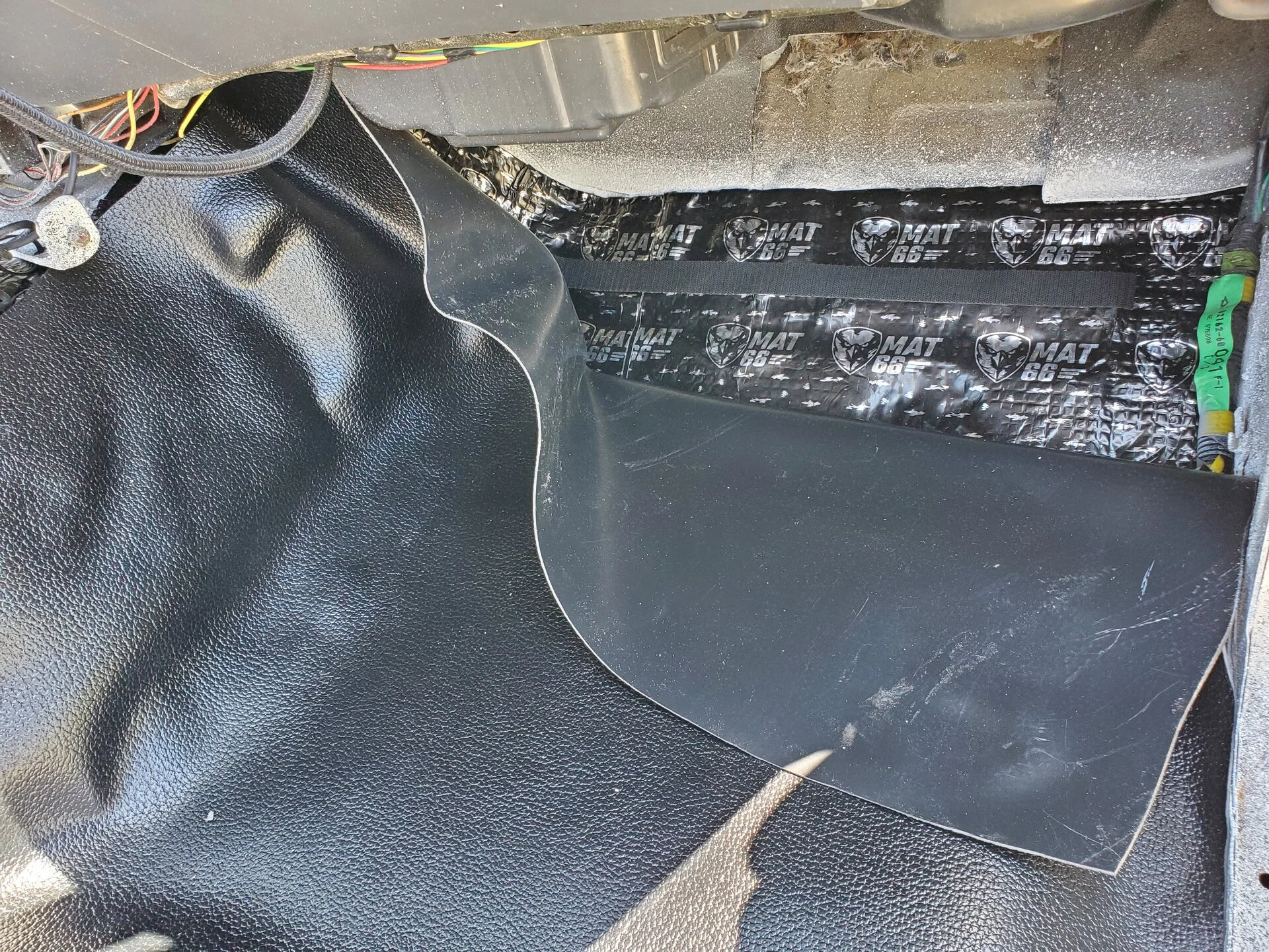

Then rolled on some MAT66 ProBlack car sound deadening mat.
Laid down some vinyl flooring and velcro'd multiple areas to keep it from moving.
Cut a bit too much around the center console, but it's good enough for government. Time to start moving on to the body.

Little more tinkering this afternoon. Hopefully fixed the power steering lines but probably not. Also noticed I had a little coolant leak at the steam port on the throttle body. Tighten it up, good as new.

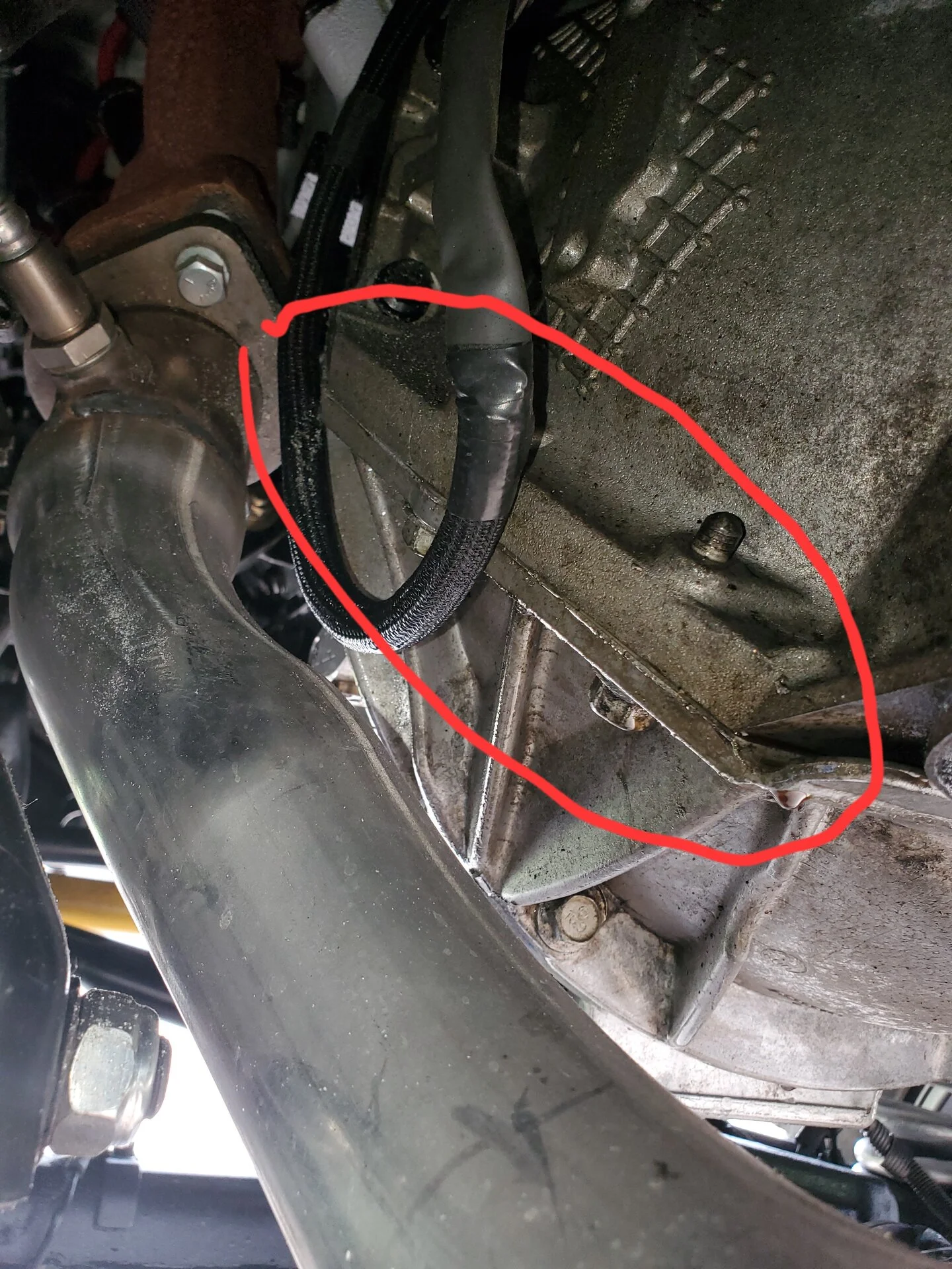

Turned the LC on and let her purr for a few minutes. Sounds good 😁. Turned the steering wheel a few times and looked to see if any of the hoses blew up in my face. . . Not yet 🙄. My tach isn't working. Probably ****ed it up when I taking it apart to soldering a jumper wire (nit really worried about that at the moment. But then I started seeing some smoke from the headers. The LC hasn't really ram for more than 5 mins, so I was thinking it's some of the paint/rust burning off. Turned it off and took a closer look. . .when merring up the transmission to the engine, I may have needed to tight up a bolts a little more. It's leaking oil from the driver's side where the engine buts up to the transmission. I'll try to reach the bolts tomorrow.

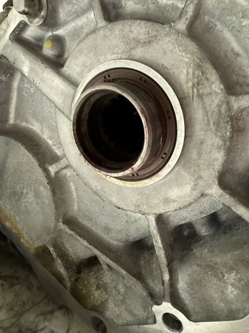

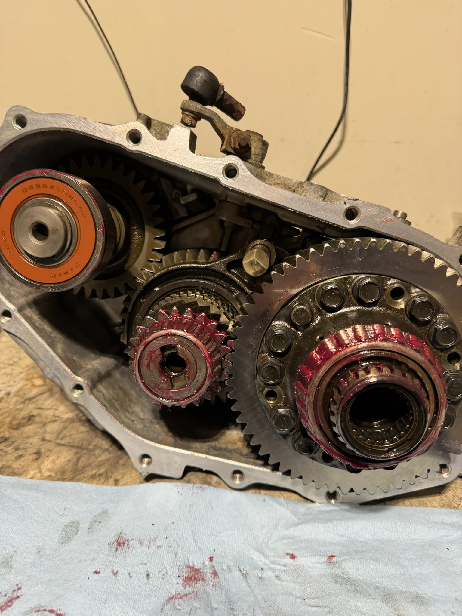

Don't know when I'm going to get around to installing it, but I made a deal with @Yotahead52 the other week. He was looking for a t-case and I had two. So I gave him one, if he'd installing my low range 3.1:1 Sumo gears for me. He also put a new seal on for me.

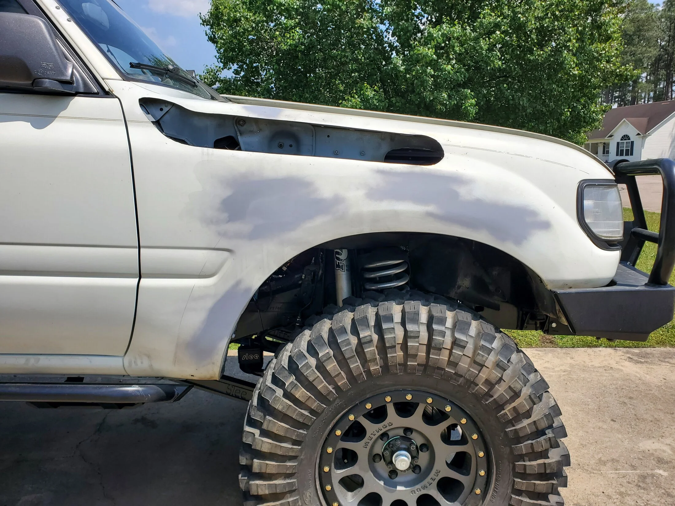

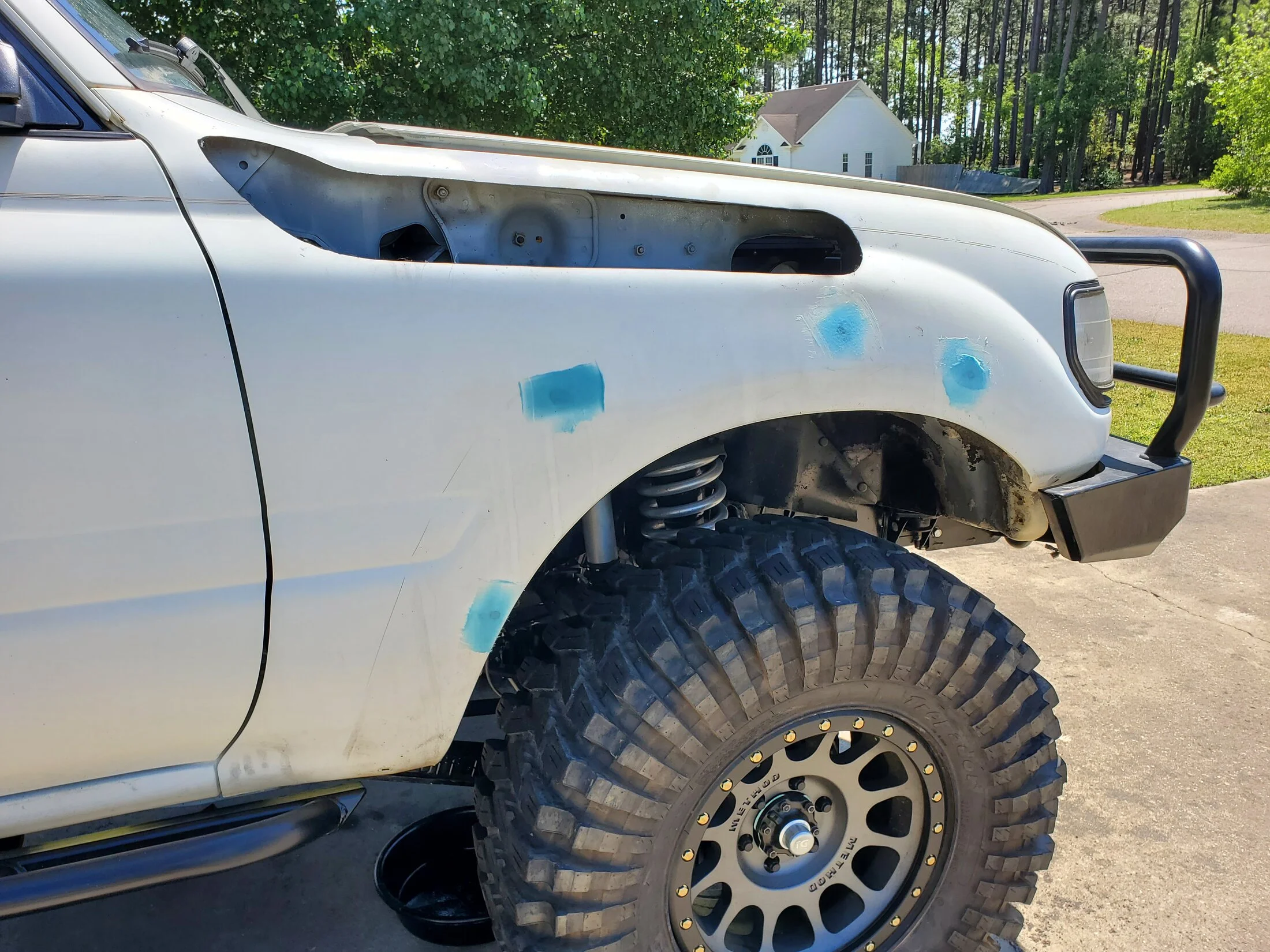

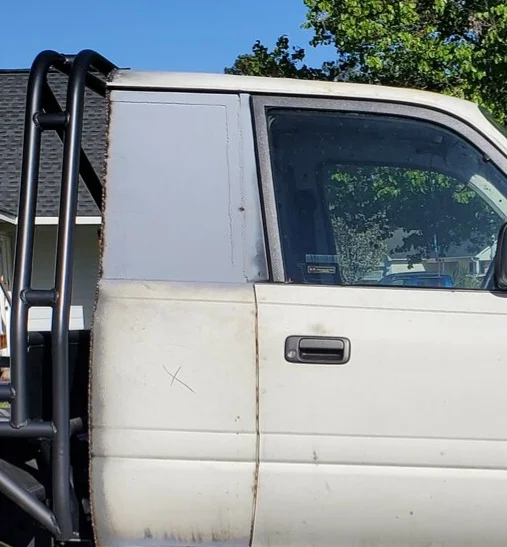

First time actually doing body, but tried to educate myself by watching YouTube. Probably a yr or so back I plugged the backing of the holes on the finders. Now sanded them with 80 grit and laid some fiberglass puddy.
I think pretty good for the first time. Very few little pinholes, but I'll be Raptor lining the LC so they'll smooth out.
I think ill do the roof tomorrow.

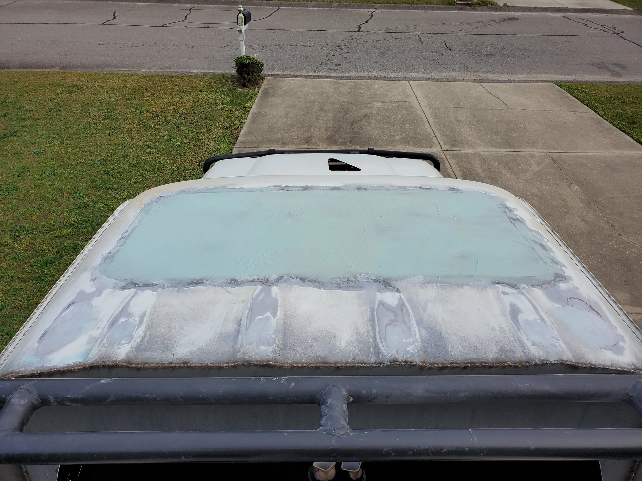

Continuing on the body I moved to the roof. Sealed off the roof rack holes and slowly smoothing out the deleted sunroof. I'll finish tomorrow and move on to the next place.

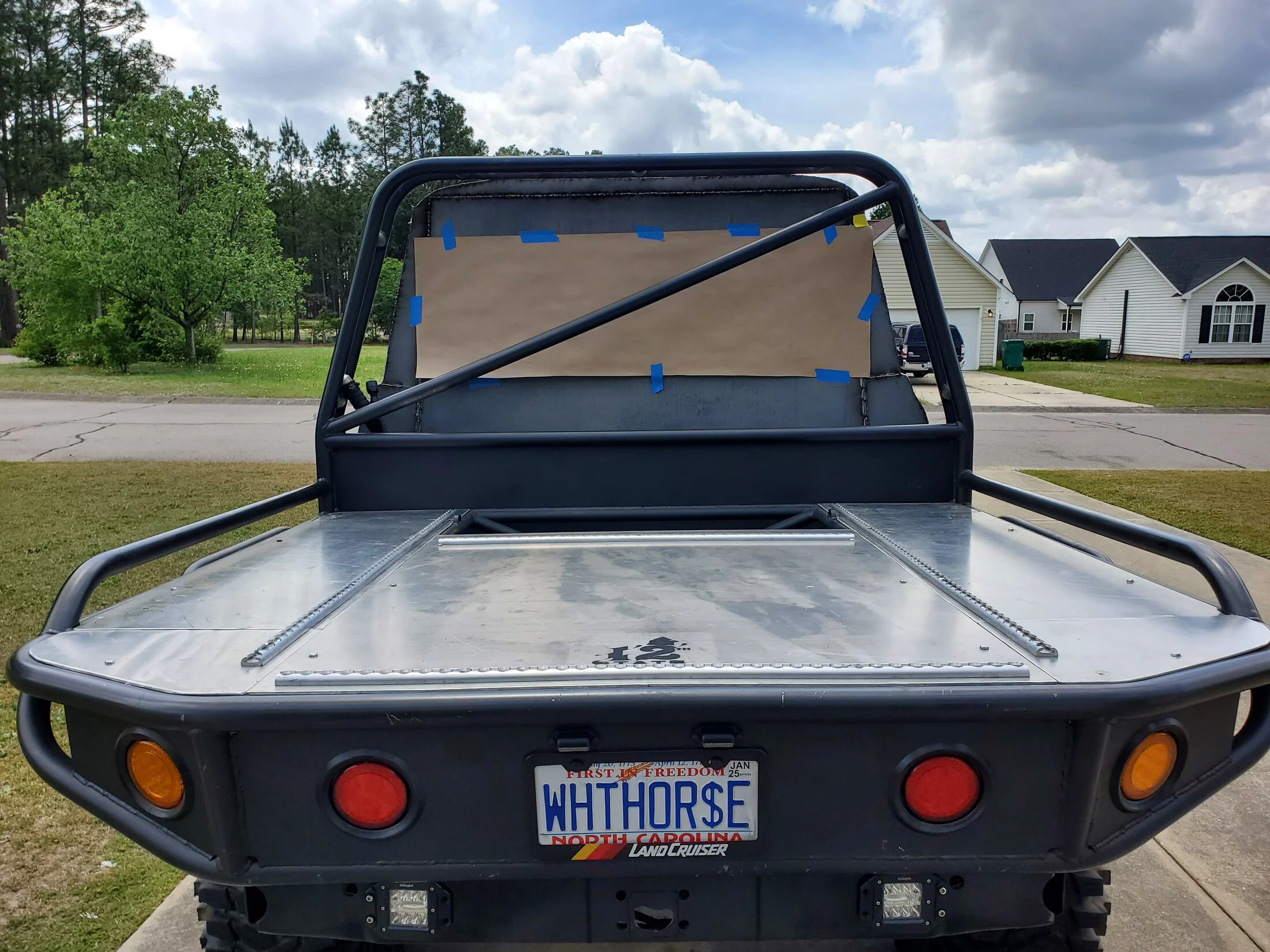

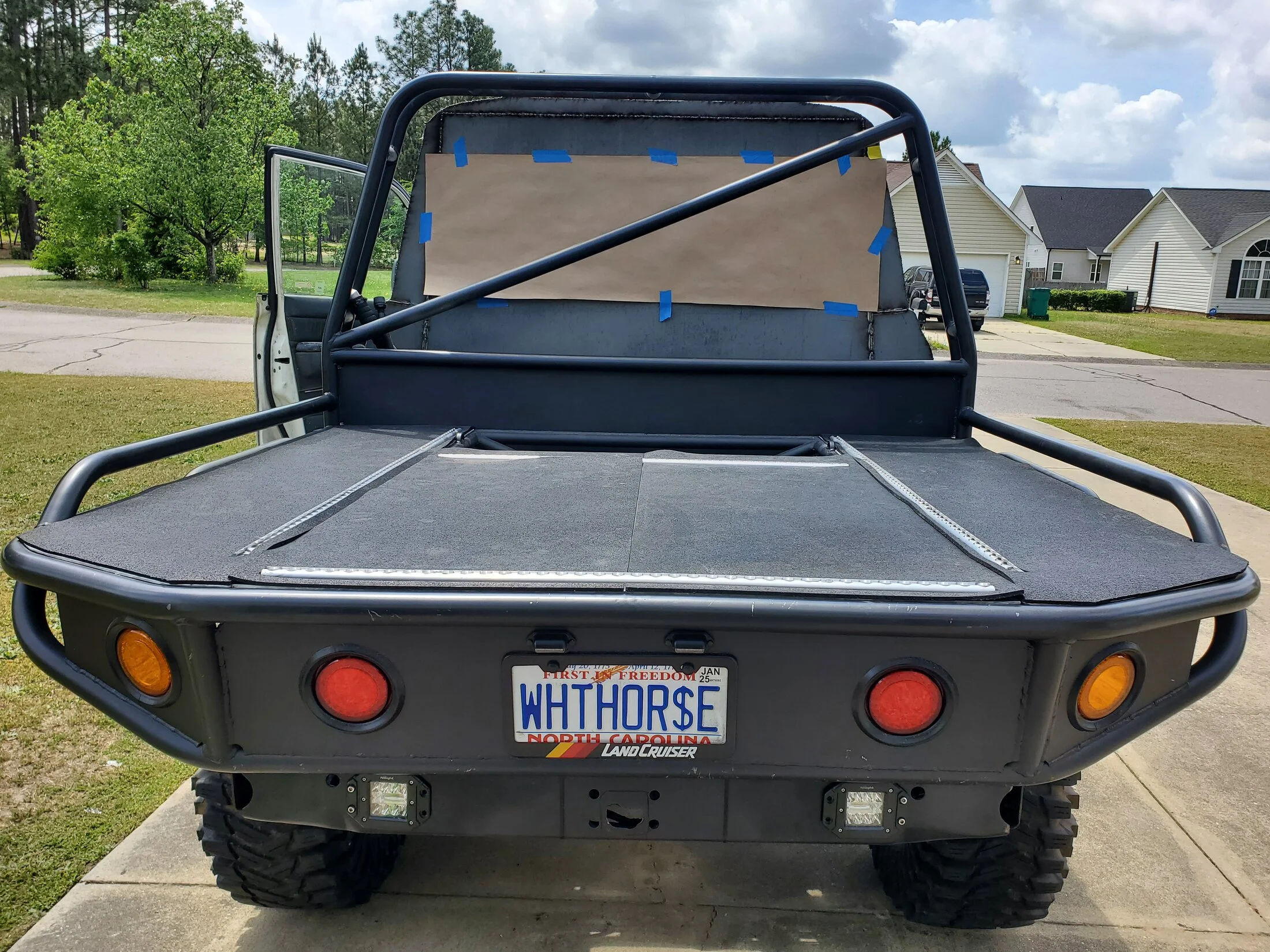

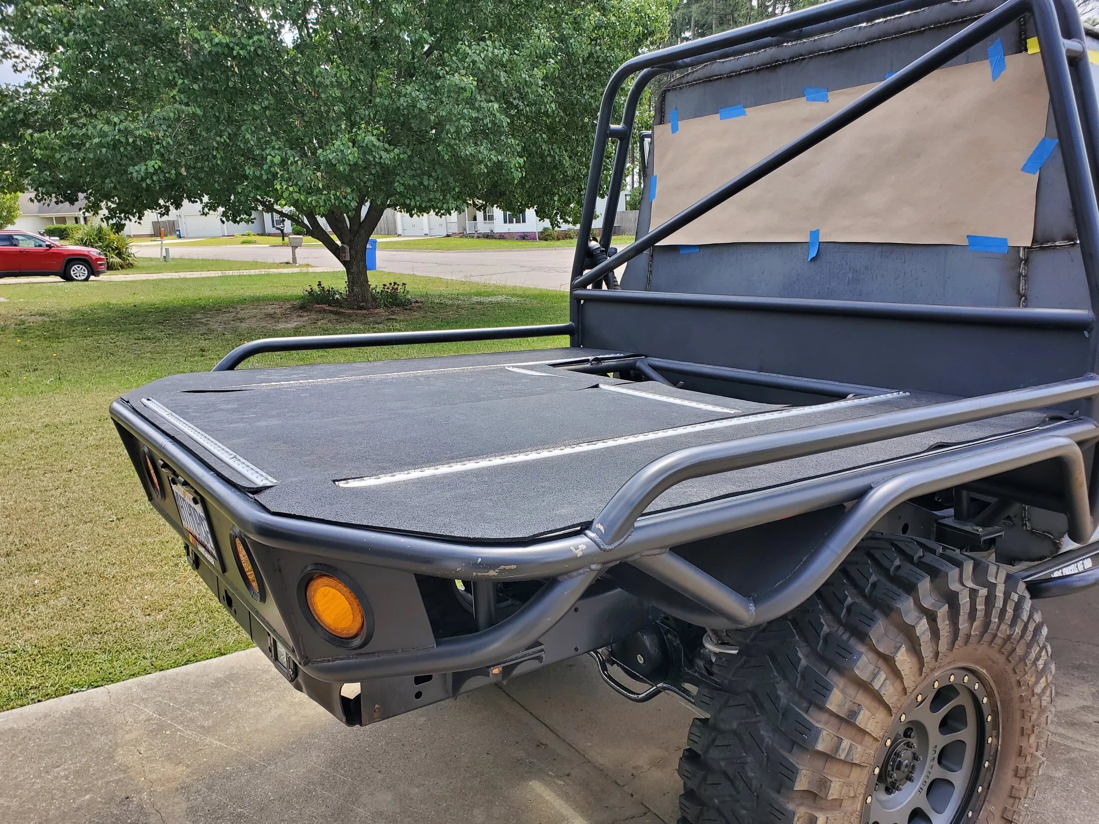

Also been messing around with the tray. Git some Mac's Custom tie-down rails and mocked up some rubber gym flooring. Haven't figured out yet what I want to glue the floor down with.
