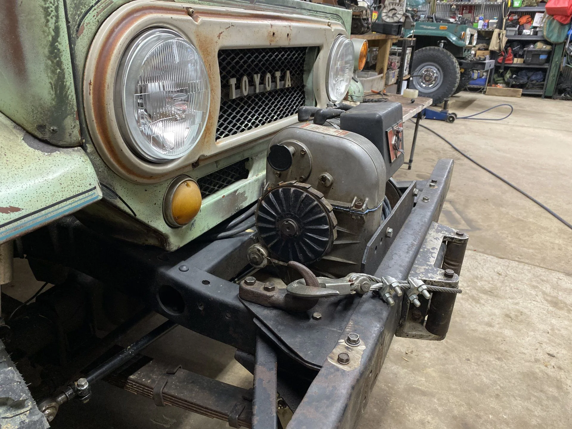

Got the Koito lights installed. It was a little more involved the way I have the lights done with my home made wiring harness.
I’ve also never had brights as the floor switch was where the fire was years ago that melted the harness.
I added the brights via a toggle switch.
Ghetto but functional.

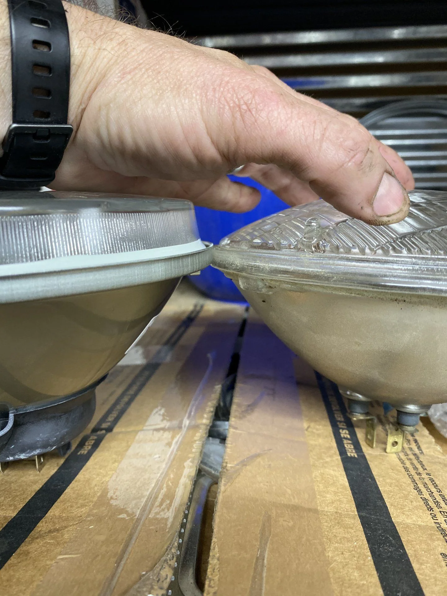

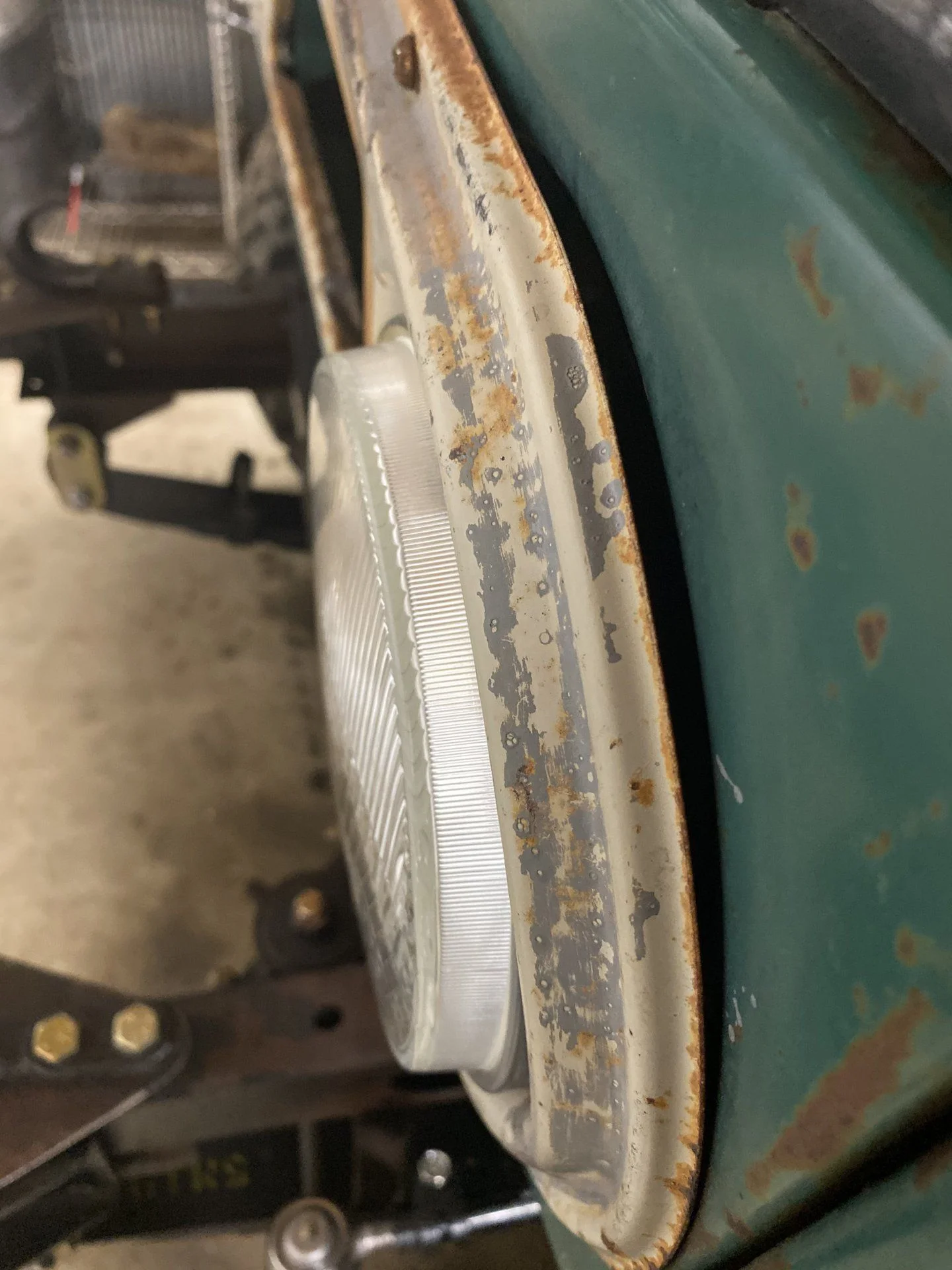

the headlights stick out too much - because you don't have spacers. OEM, the bezel is spaced out by rubber sleeves (of ~1cm length) around the mounting screws
they are designed that way. This truck has the correct bezel spacers and they still do. They are just super deep there at the Lens

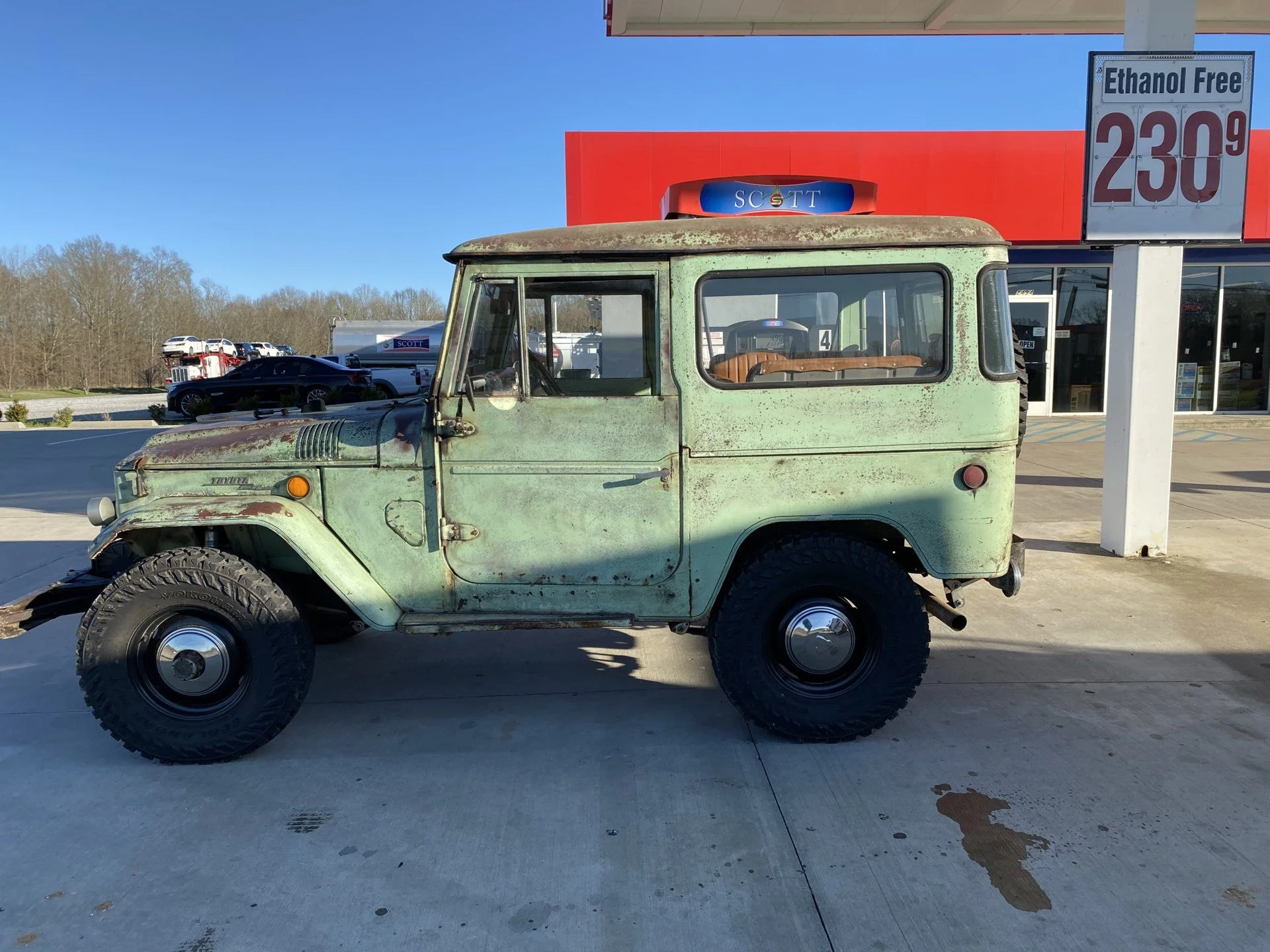

That’s a nice price, especially for ethanol free. I can’t find that here in AZ without going to a racing shop and buying it in 1 gallon cans... at a significant premium to what you are paying there. Super jealous.
