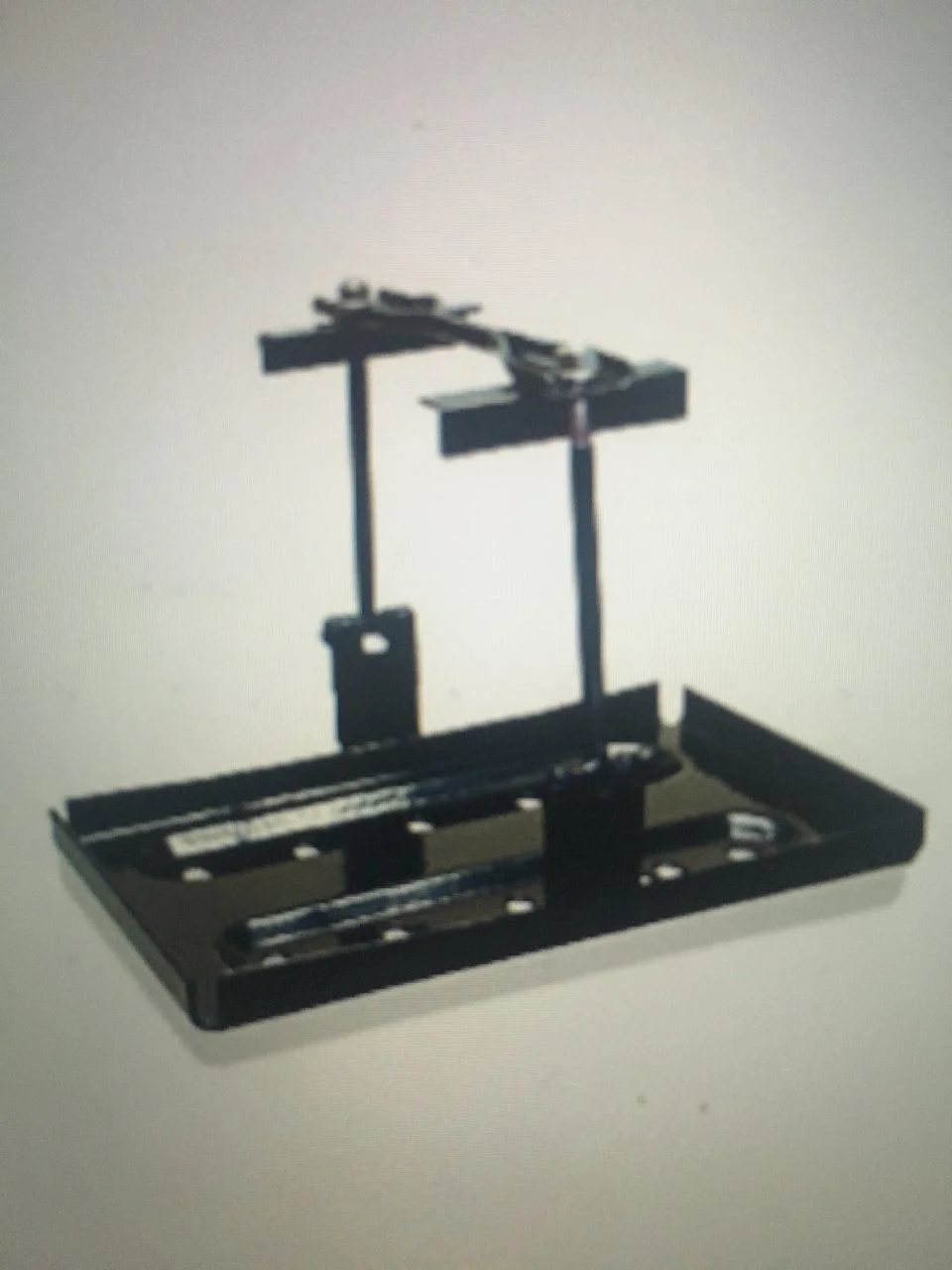

Stuff. Thanks @Mace for the input over on Pirate. TG battery box available. $20

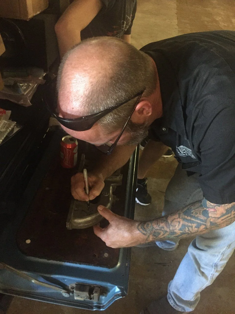

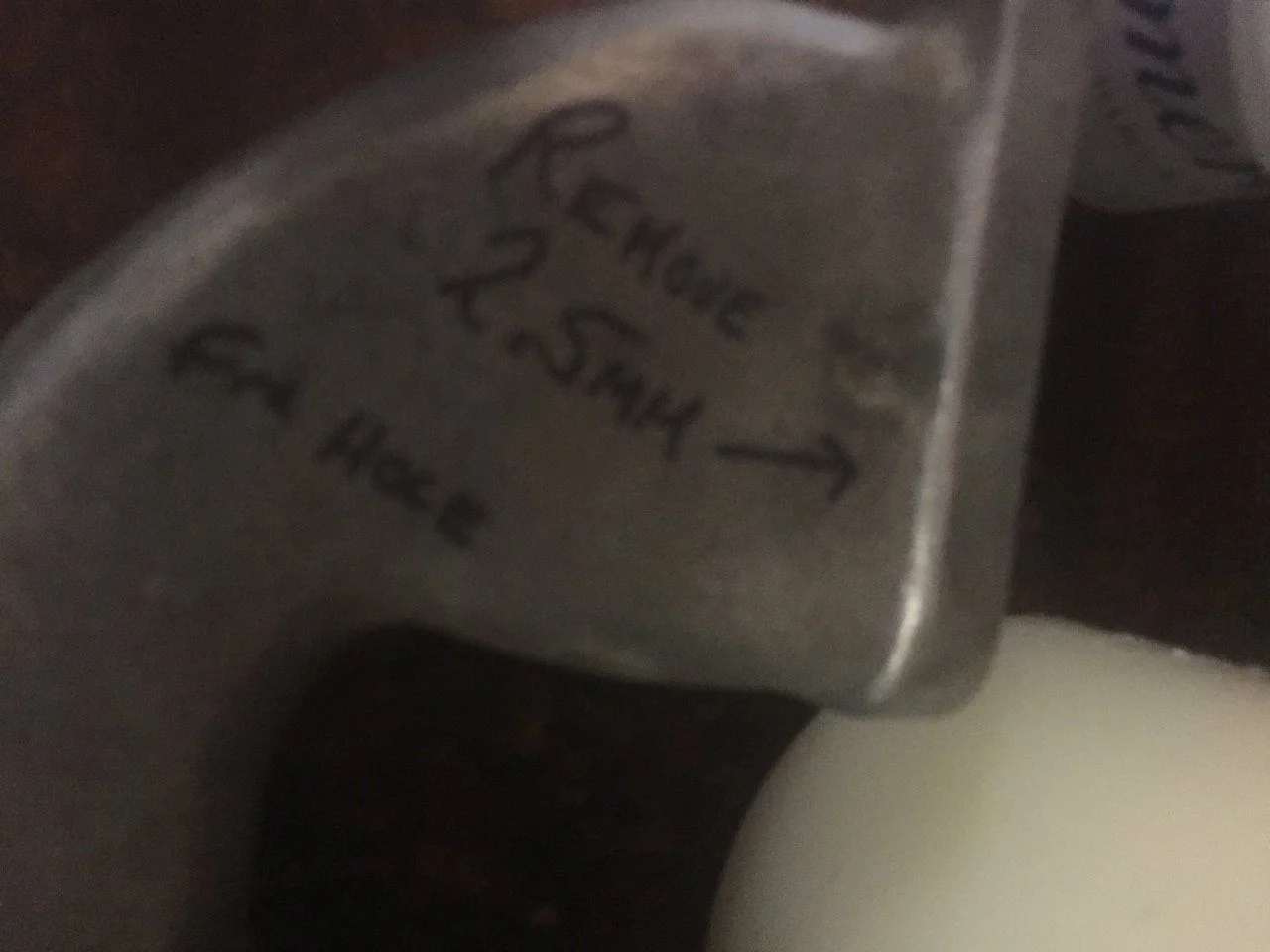

@beno hand delivered my F manifold to Altanta Custom Cruisers to have the thickness of the aluminum planed down to the thickness of the header I got from @wct49
@Poser consult revealed making these two surfaces match in thickness was key to making the seal on the exhaust perfect.
