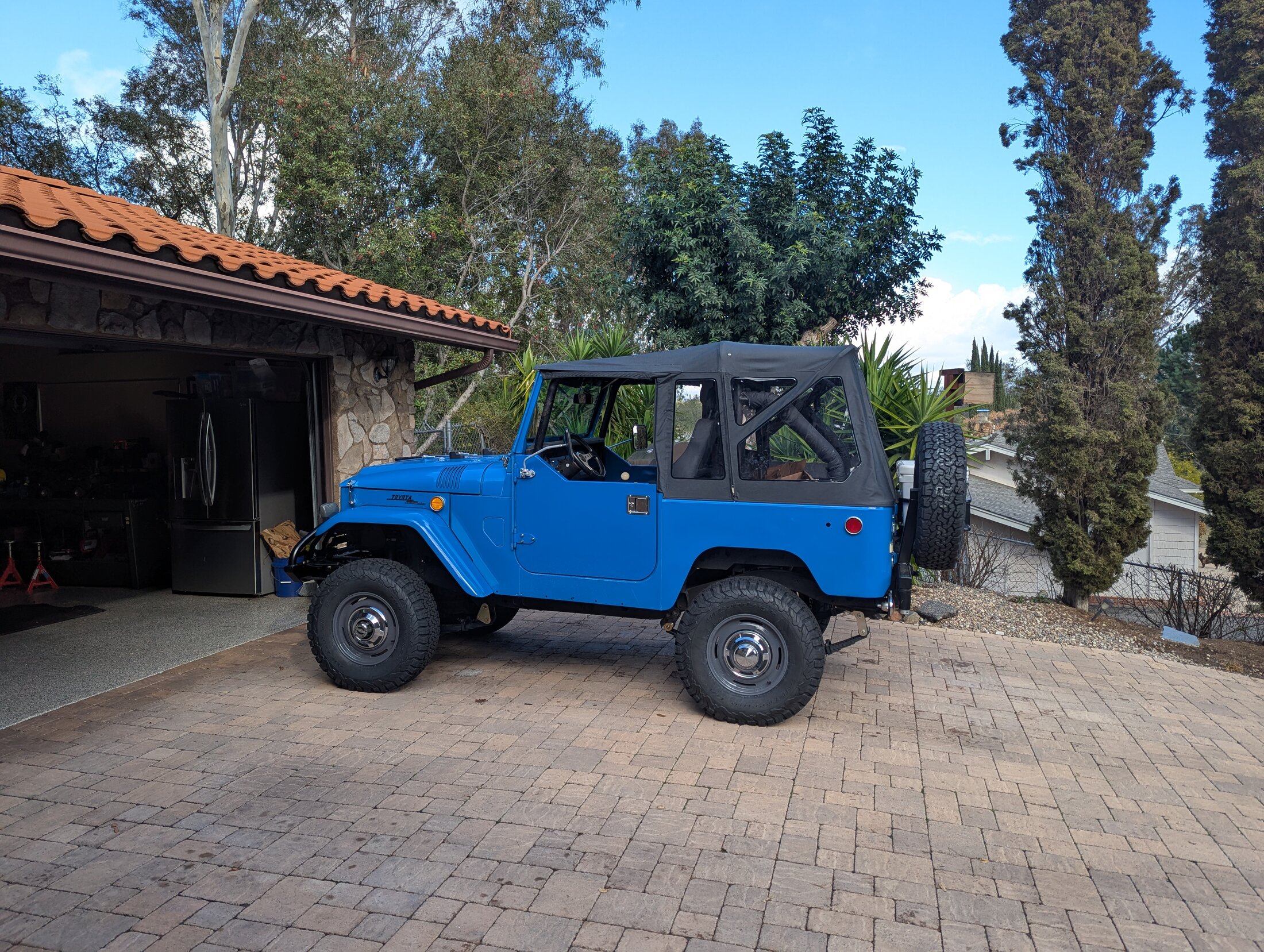

Just adding everything in one place since I asked questions elsewhere. The rig drives and handles fine, just looks over lifted with the wheels and tires I just put on it. At a minimum I'd like to get the truck level front to rear or slightly lower in the front. Open to suggestions on how to achieve this as I don't have a ton of experience with the suspension on these. I can replace suspension items, but something big like removing the shackle reversal I would have to get a shop to do. Shackles, pins, bushings, etc all look good. The springs look pretty rusty and beat up.

      • Front of rig sits ~2" higher than the rear.

      • Rear sags ~2" compared to the front.

Got some time to do some homework on the Rancho part numbers I found stamped on the springs. I was able to find an older Rancho Catalog and look up what lift kit used my leaf spring numbers. Was kind of disappointed to see that it's just an older Rancho 2.5" lift. I was actually hoping it was more like a 3 or 4" lift since I wanted to bring the height down a ways. I updated post #41 above.
I also reached out to Alcan about custom springs with a lower amount of lift and spoke to cruiseroutfitters as well about OME 2.5" lift. They seemed to want to talk me out of buying that kit and mentioned parts of it were on back order. From my view, it can't make the rig any worse and at least everything would be new and in good condition. Still going to try and find some time to pull a leaf and see if that helps some.
Ordered and received my OME lift from Cruiser Outfitters and had a local shop install it. Really wanted to do the work myself but with work travel it wouldn't get done for months. Overall the ride height came down about 1/2" and the body sits much more level front to rear. In the pictures the old suspension is still in the back so it's slightly lower. I can still pull the body lift once I get trans and tcase ironed out and get those wheel well gaps a little smaller.
Perfect stance
