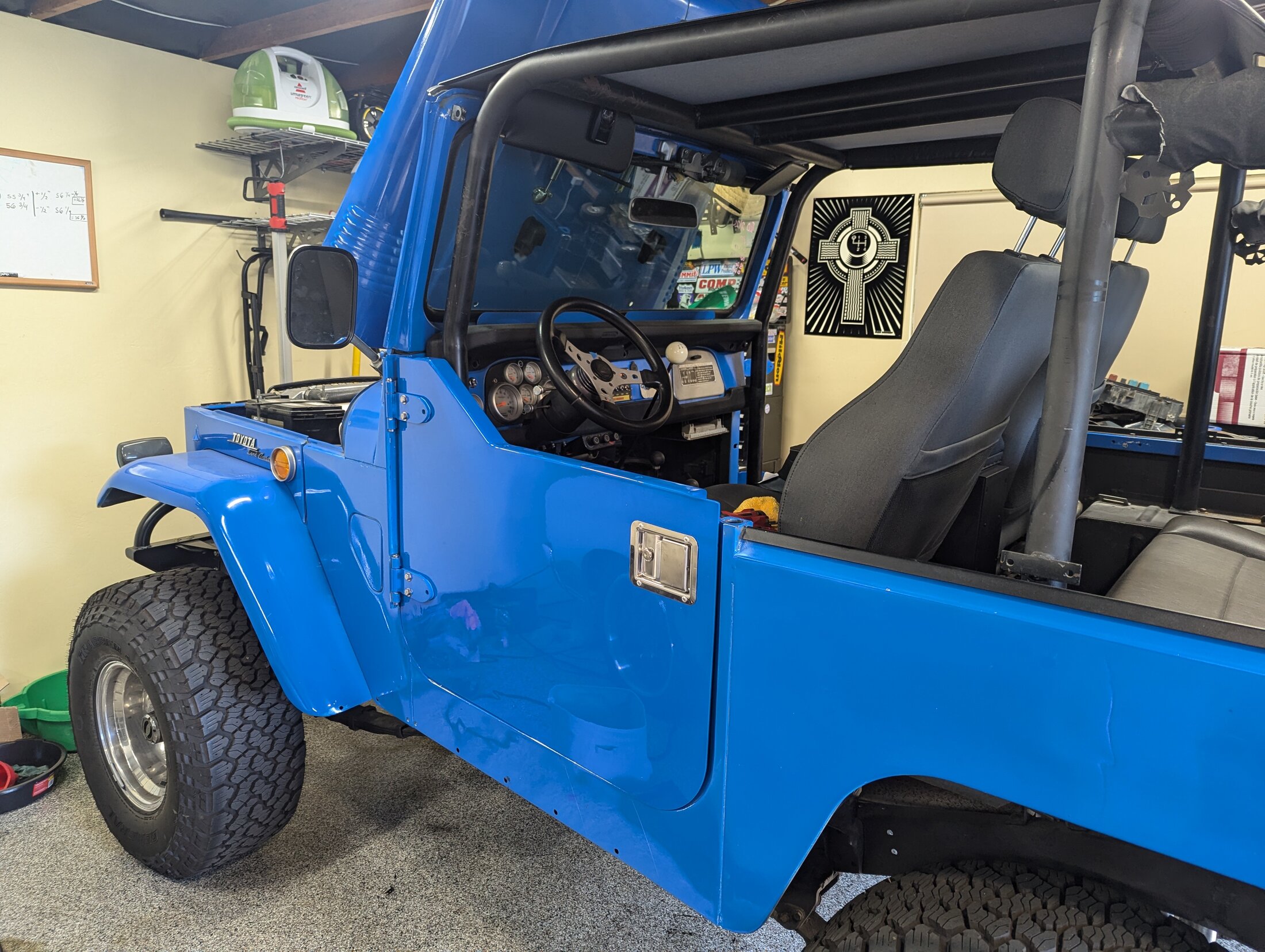

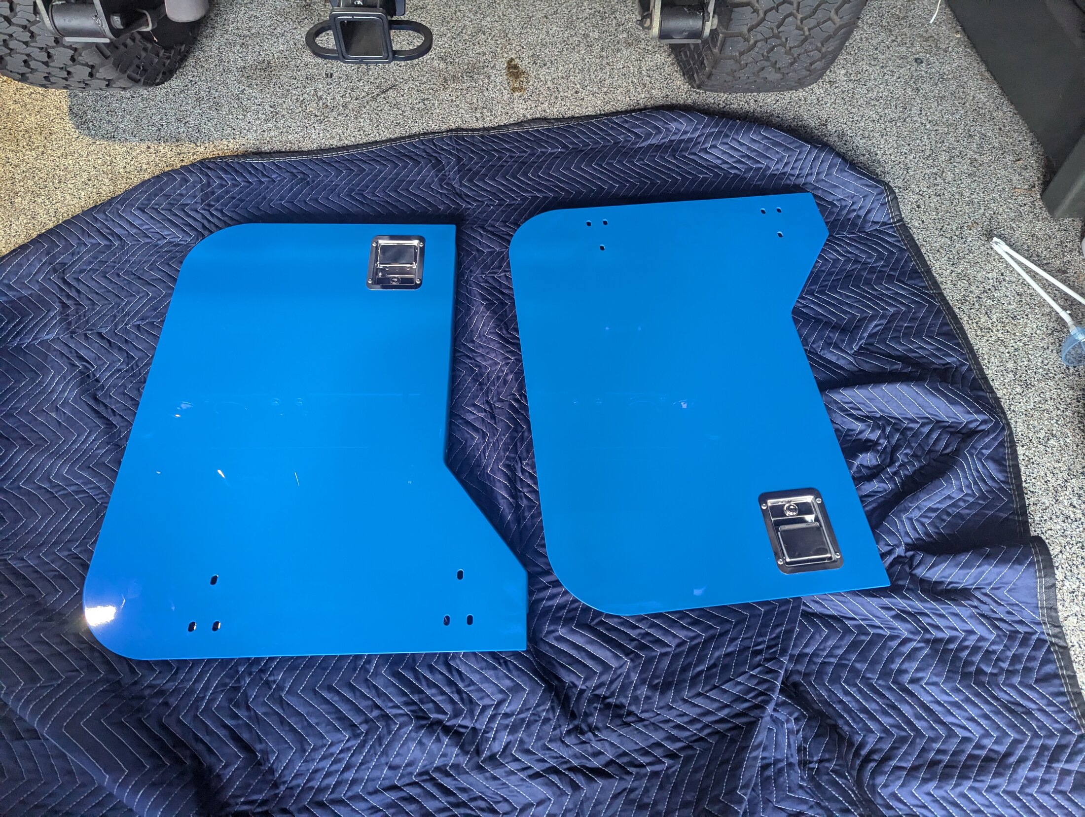

I've knocked out a few more issues in the last couple of months and added some nice to haves as well:
  • Bought a set of Aqualu doors and had them painted to match the rest of the rig, or at least as close as possible. Just wrapped up getting the door stops and some new door hinge mounted mirrors installed.
  • New TRE's and a quick home alignment.
  • Fixed a huge exhaust leak which has so far eliminated the popping and backfiring on deceleration
  • Fixed pesky heater core leak that ended up being dry/rotten seals in my ORB to AN fitting adapters. Replaced the heater hoses as well to be safe
Working now to correct the following
  • Wheel width is too wide and wheel weights hit the TRE's and are tearing the boots. Looking to get the City Racer 16" w/hubcaps
  • Saginaw box is really tight and driving the 40 on the freeway is requires a ton of concentration, even at 55-60mph. Need to find a 3 bolt saginaw box with 16:1 ratio I think
  • Still need to address the ghetto ass rollbar and get some sliders made as well.

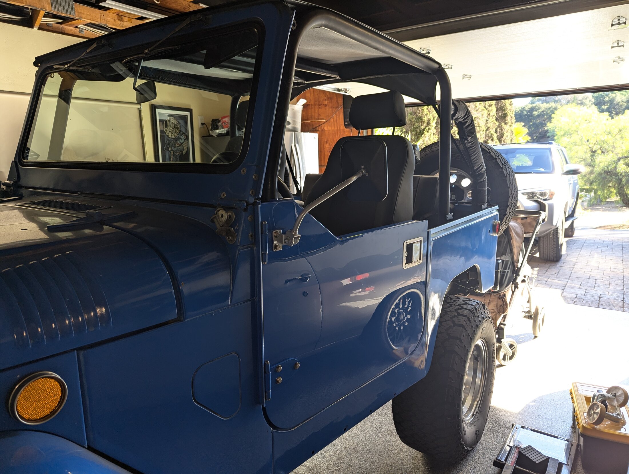

Purchased a new soft top and a new set of wheels from the FJ CO. Tires are 235/85/R16 BFG AT's. Working next on pulling out the 1990's 4" Rancho Lift and the 2" body lift that is on there so it sit's a bit better. It's kind of dorky looking at the moment. This truck had 37's on it when I bought it, and the suspension I think revolved around that size tire. Before these there was 33x12.50 on 15x10 wheels that looked great but everything else about them was pretty bad. I'm planning on ordering a OME suspension package on Monday and go from there.
Some more pictures from this morning. Top one is the rig just sitting normally. Rear wheel opening is about 2" smaller that the front. Bottom picture is with my floor jack propping it up to that it's more level. Which doesn't look too bad to me, removing the body lift will help to close the big gap

Generally speaking, the SUA shackle reversal lifts the front 1.5”. Yours may vary.
A common solution is to use a 3” longer shackle in the back to even it out. I have this setup in my rig and I like it quite a bit. Essentially I get 4” of lift from a 2.5” lift spring. Rides nice on the hwy and flexes nicely in the rocks. Only downside is the front hangers find all the rocks when I go wheeling on trails with a lot of ledges to climb up.
Thanks for the reply! Do you think it's possible to close the gap that I have above? I think I have 4in of lift was hoping to get closer to stock with the new 32" tires
It wouldn’t be more than an inch, but I’m almost positive you have lift shackles on there now and OME offers stock height shackles as well
