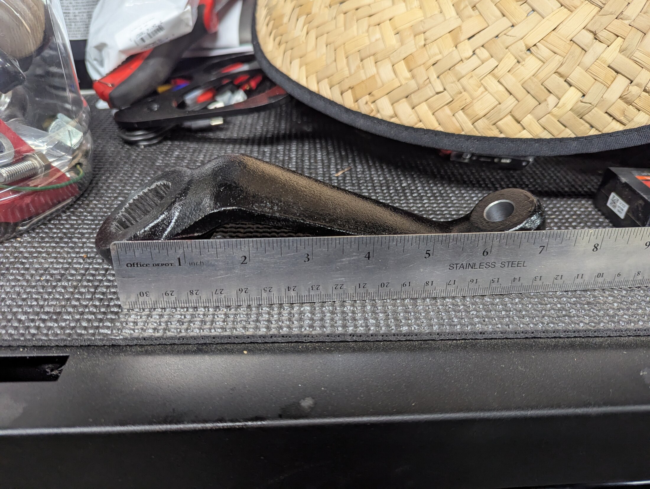

Interesting picture of my original pitman arm and the two I ordered.
Left: My OG Pitman arm, 3" drop unknown origins
Middle: Cruiser Outfitters 2" drop. Pretty beefy, wish they had the 3" drop in stock when I called because I think I would run it. I also can't believe how fast it got here despite the holiday.
Right: RoughCountry 3in drop (slightly longer than the rest). This is the same one BTB sells, I got it off of amazon.
Out of the 3 I am going to start with my original arm, and maybe try the RC one to see if it being slightly longer gives me a better feel. the 2" drop puts the steering rod at a weird angle.
