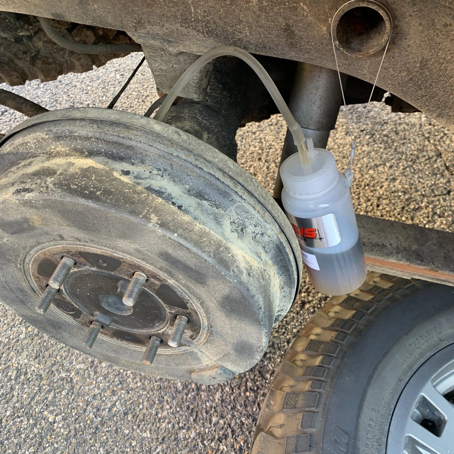

I some masters come with a bleeder kit that includes plastic threaded fittings with nipples and plastic hose to return fluid to the reservoir. I made a set out of some old hard brake lines and fittings.

Bleed all 4 wheels in order (LR, RR, LF, LR). only got big air bubbles coming through the left front. Left front didn’t have great flow, bleeder a screw was not clogged. Rears flowed the most per pump. There is zero improvement....what the f.
Out of time tonight .... I know I need to bleed more but it still pretty just goes straight to the floor and can’t hold the vehicle.

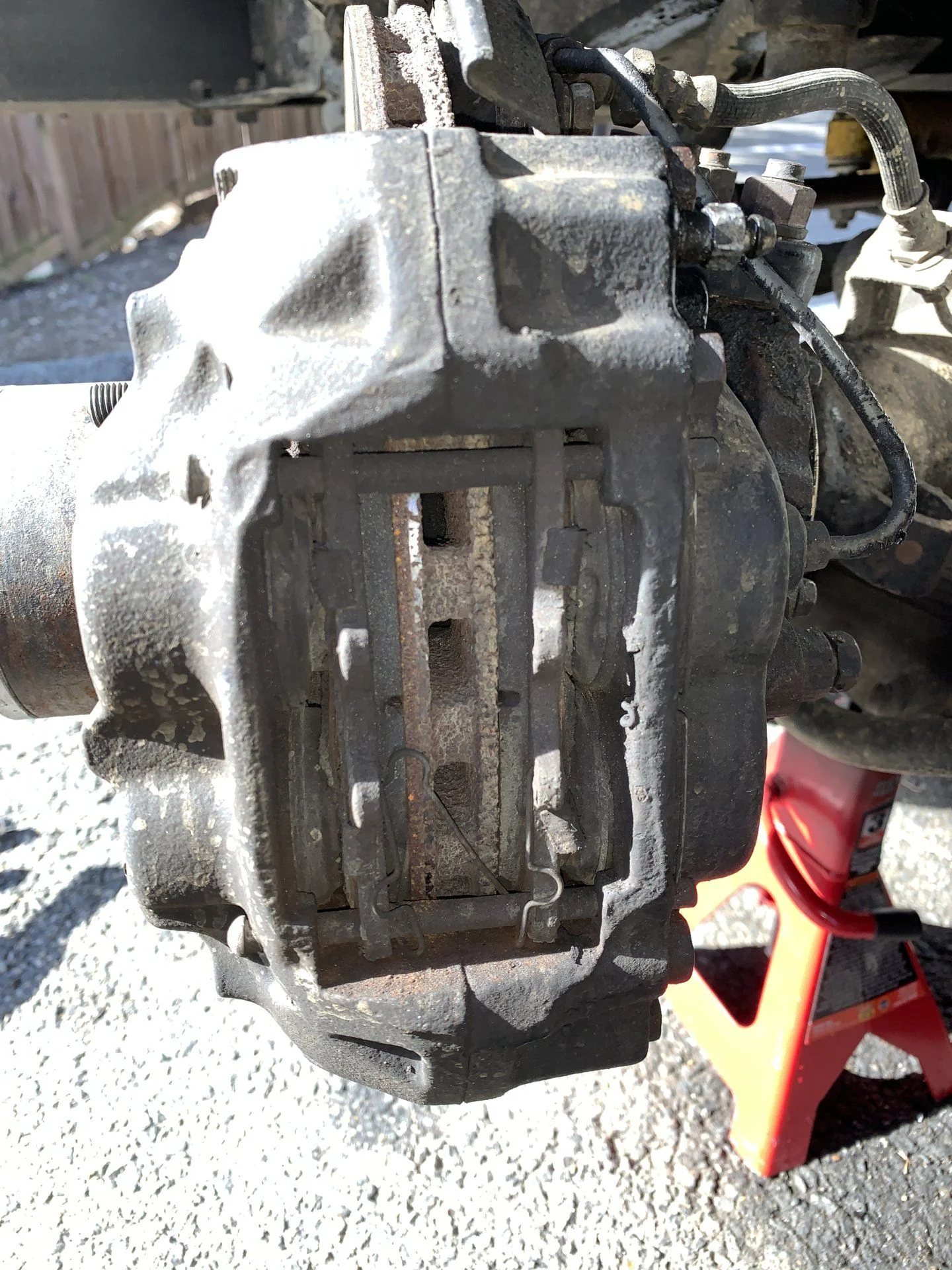

Did you try spinning each wheel/hub while having someone press the pedal? How do your front pads look?
I ask because you may have frozen caliper(s) or individual pistons. Easiest way to check is to jack up a wheel, step hold the pedal down and see if you can still rotate it.

Pedal does get firm-ish after pumping a couple times but only with the engine off. The pads do need to be replaced soon. I’ll have to do the caliper test this weekend— braking was good not great before tearing things apart.

You can get fluid out of a caliper and still have seized pistons.

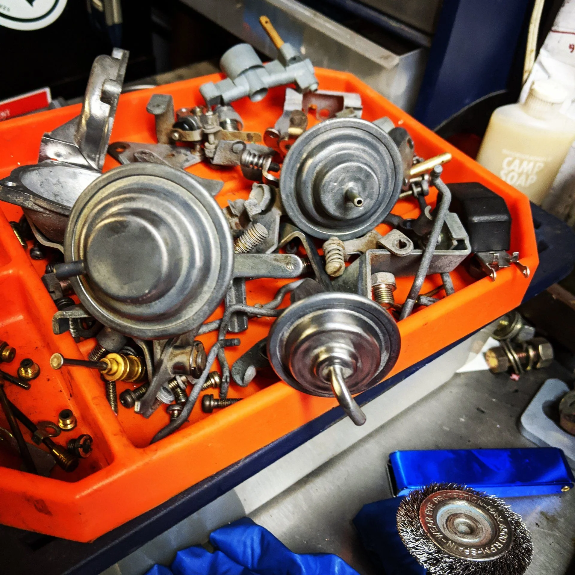

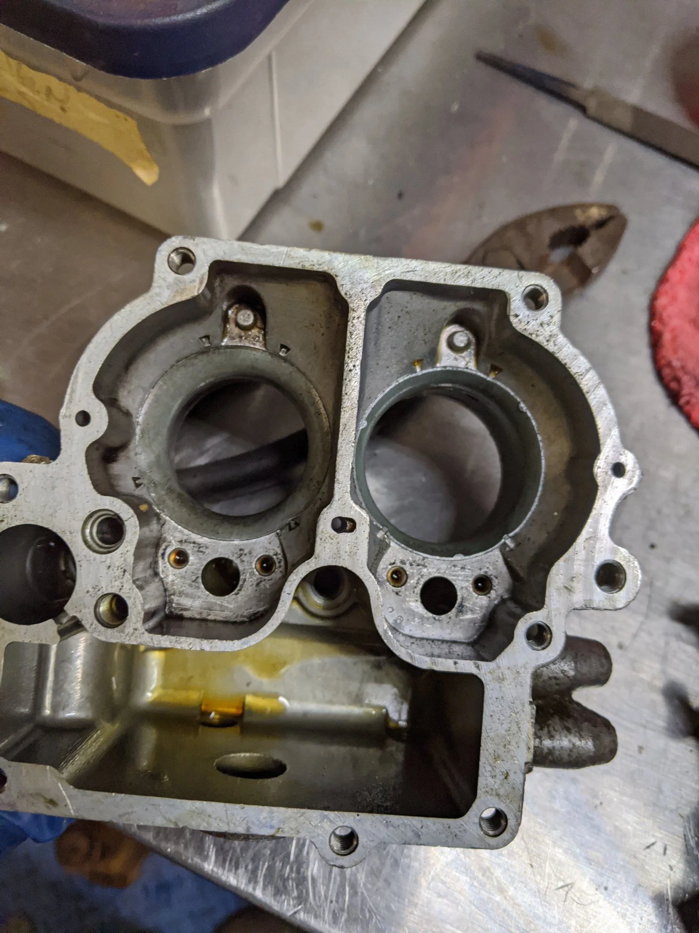

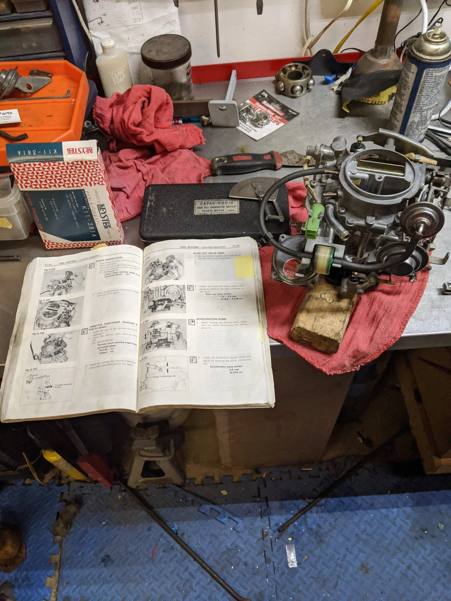

Mike how did you clean the carb parts?
Berryman's carb and parts dip and my Harbor Freight ultrasonic cleaner then a wire wheel on an air tool.

•I’ve bled 1.5 liters including the LSPV total (another 0.5 this morning). There is almost no flow from the RF caliper. All others were clean bleeds with no visible bubbles.
•I was unable to get the RF pads out and I think that may be the culprit. It had more pad wear and seems to not be retracting. The pads didn’t look as bad as I recalled but it was dark. Would that cause no pedal though?
