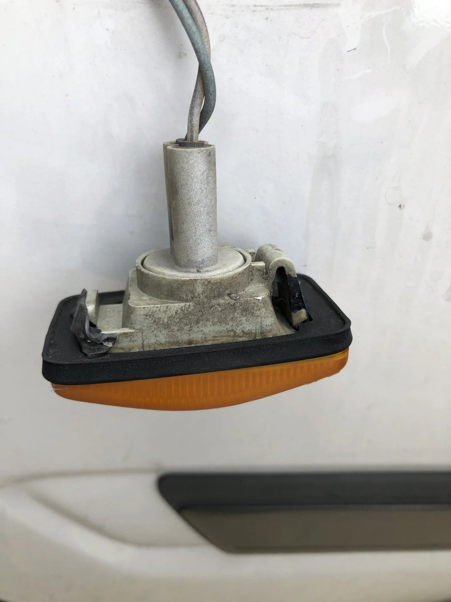

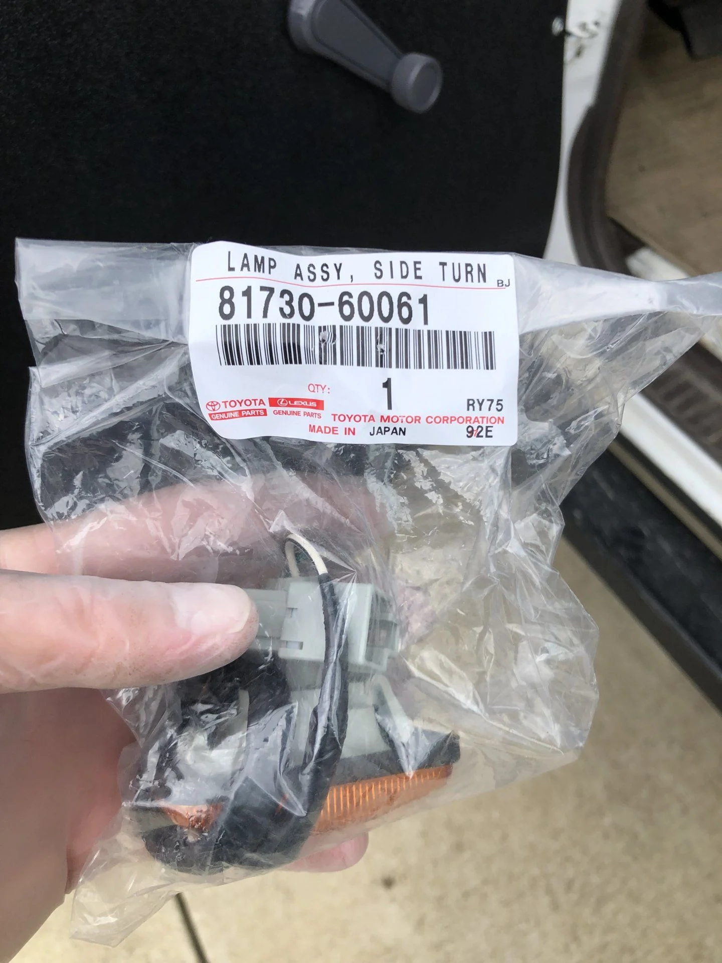

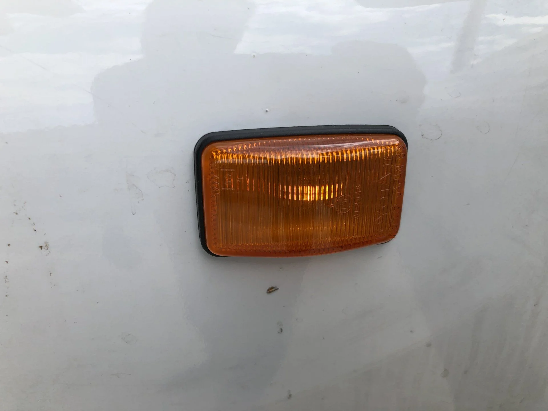

New side marker lights. 0.01 banana job.

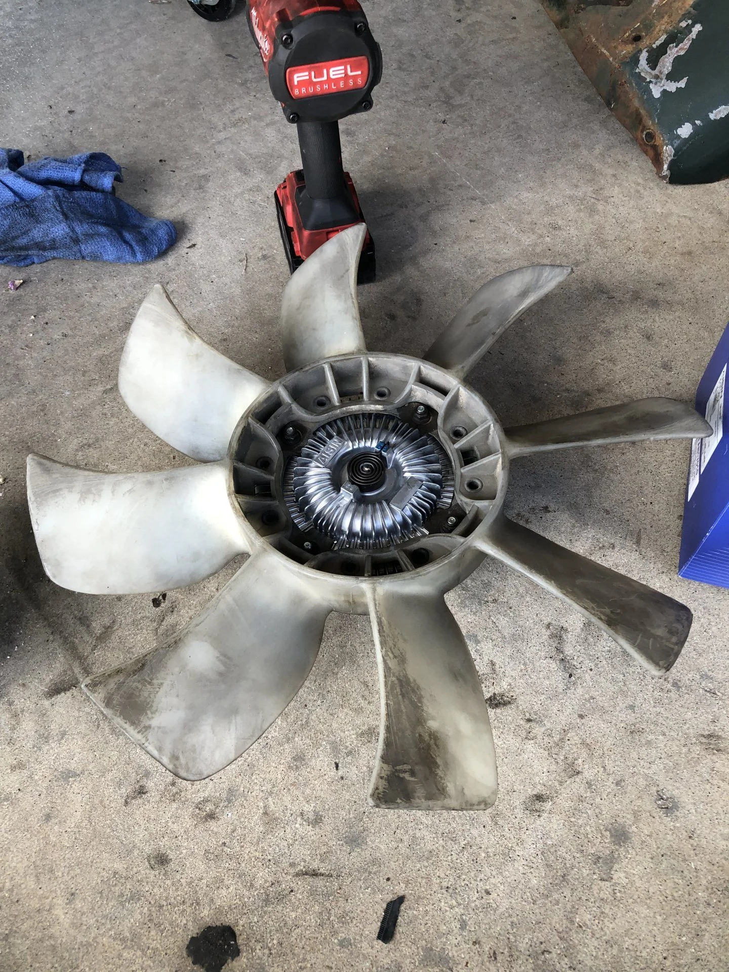

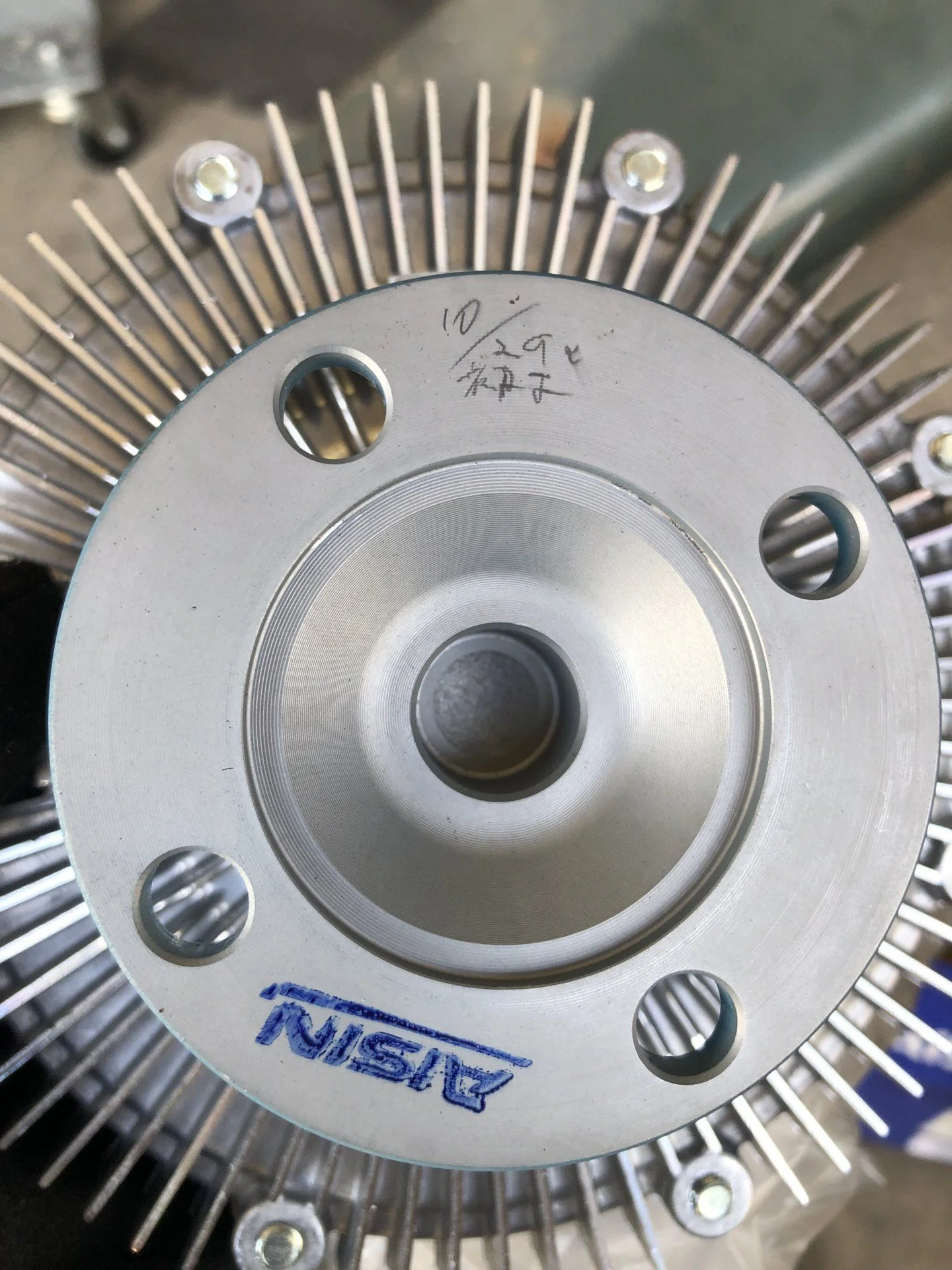

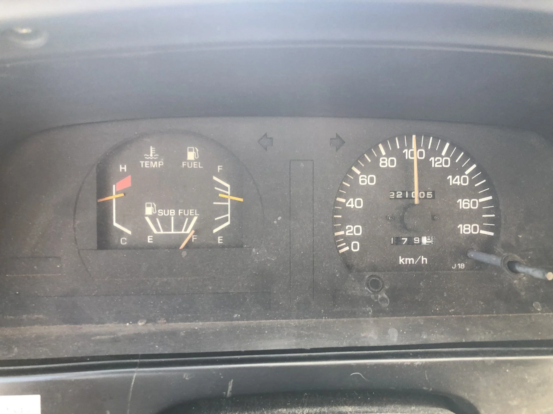

So I’ve been flirting with overheating. The water temperature gauge - the only gauge on my entire dash - has been flirting with the red when the outside temperature is over 95°, I’m driving more than 60 on the highway, and the air conditioning is on. Coolant could use a flush and some new Toyota red, and the fan clutch feels OK, but I’m starting with a new fan clutch that @davegonz supplied.
The fan was in decent condition and I did not replace it. The old fan clutch is a no name, but I went straight with an Aisin this time.

Kenny: What Dave said - they are Euro lights.
I have a new dilemma: the new fan clutch didn’t do very much to reduce temps at highways speeds.
