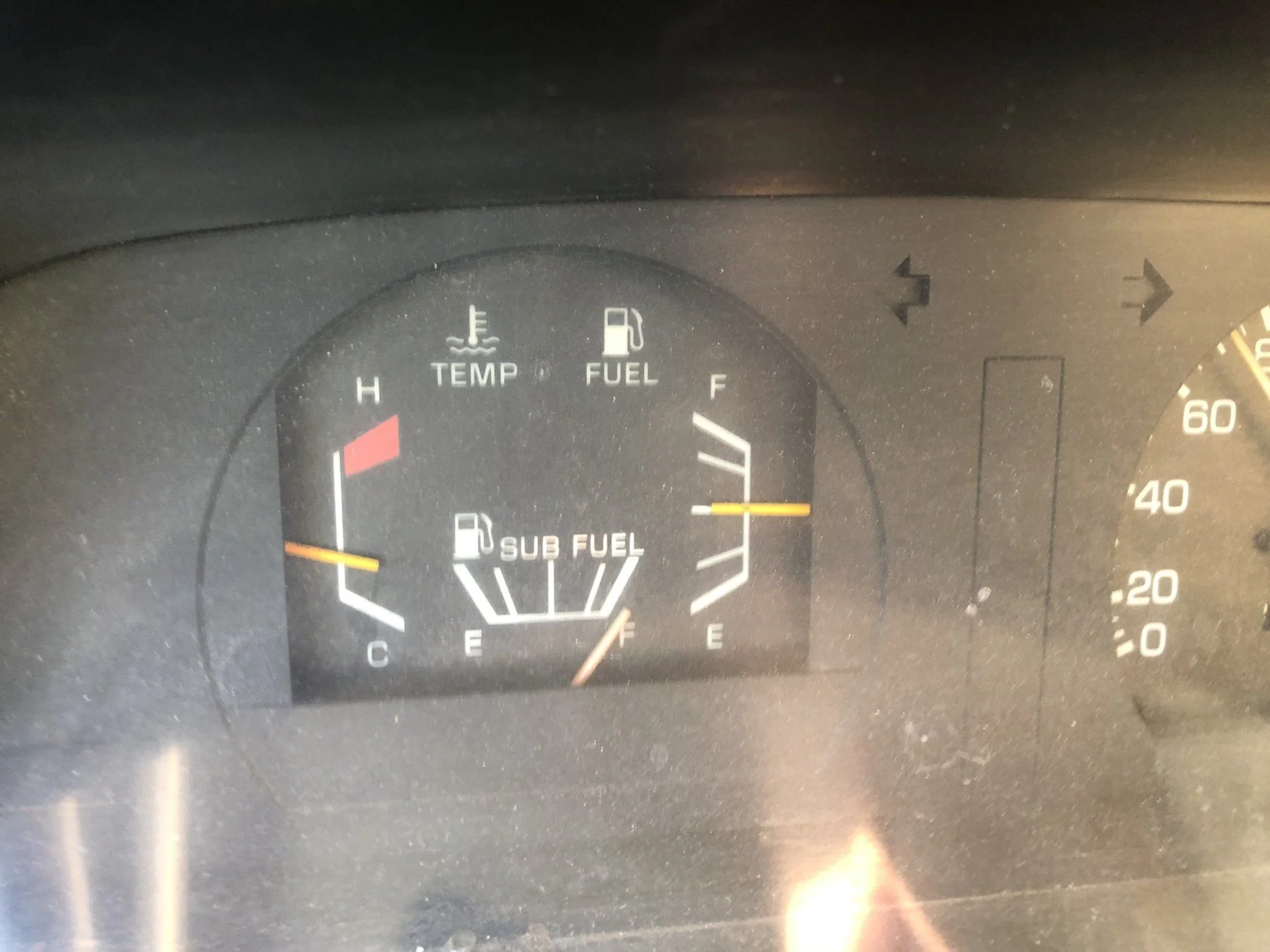

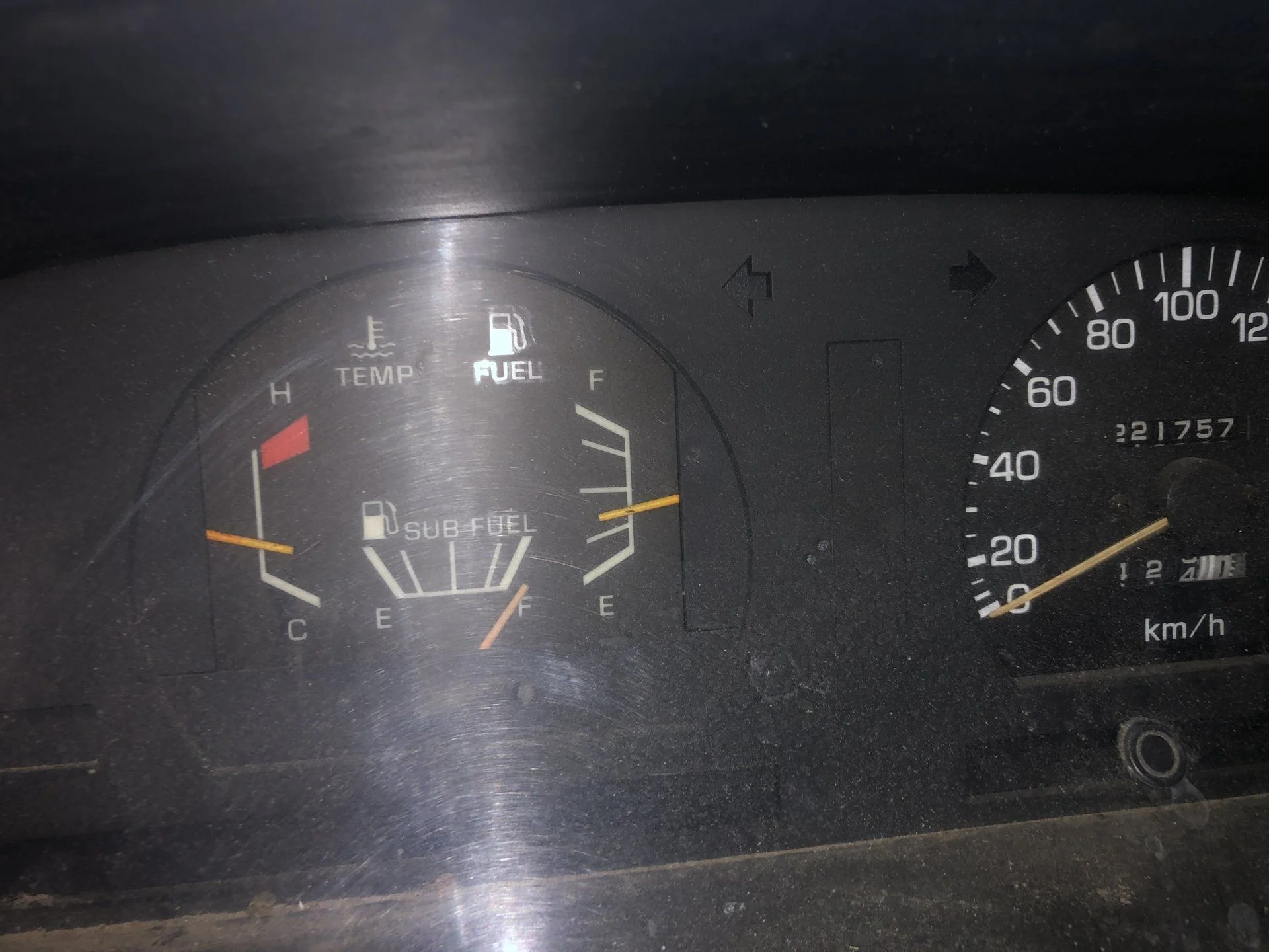

The maddening thing is that 90+ percent of the time, this is where my temp gauge sets.
Tech is tech. It’s never a hijack.......no fan roar on start up. Visually things look pretty clean, except for the coolant. In a couple of weeks when all the parts get here I will delve into it more deeply.

As to the cluster, have you got any familiarity with the @RavenTai cluster mod to the resistor for the gauge?
Cliff Note is that at least in the OBD2/late cluster the ohm resistance was swapped, makes the cluster temp gauge more responsive & that “don’t worry about it” -zone quits acting like that.
I’m not sure or even have a clue if it cross-translates into a mod you can do to your cluster —
(any of you early cluster / poverty pack owners have a voice of exp here???) —
-But it’s one of those things from the days of Mud past that unless you know to look, you can miss it.
If it’s not buried in the “stickies” threads of tech/mods up top, it is worth searching & seeing if you can make it work - if not, then yeah, a good “live” H2O temp gauge would be on my punchlist since you don’t have OBD2 connectivity.

Factory gauges are notorious for saying temp is ok, then the next second you are WAY overheated. The raventai mod is great, or additional aftermarket guages.
The FJ73 I had taught me to not trust factory temp gauges early on in cruiser ownership. I just hate running all kinds of aftermarket gauges if they are not neatly installed.

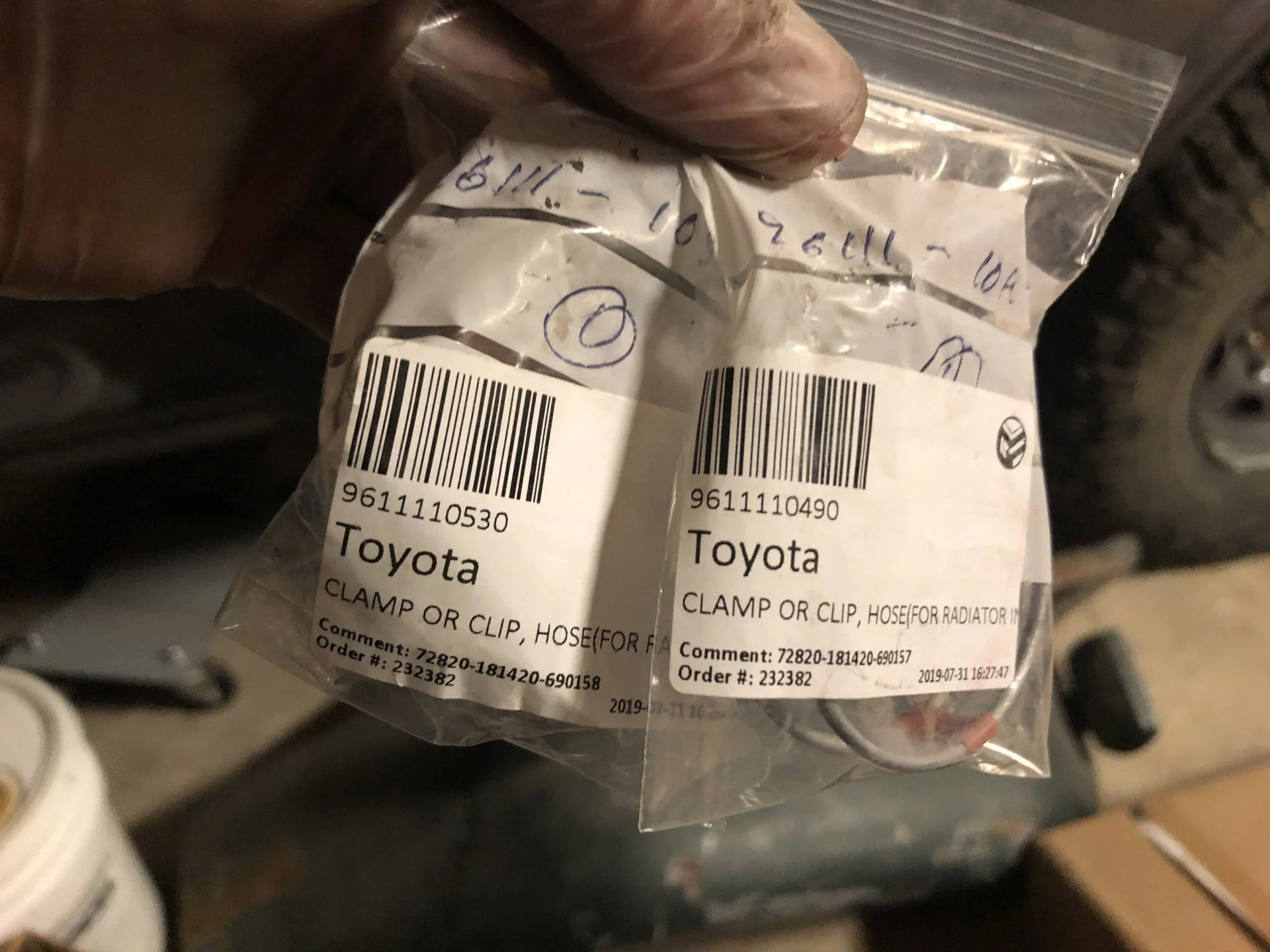

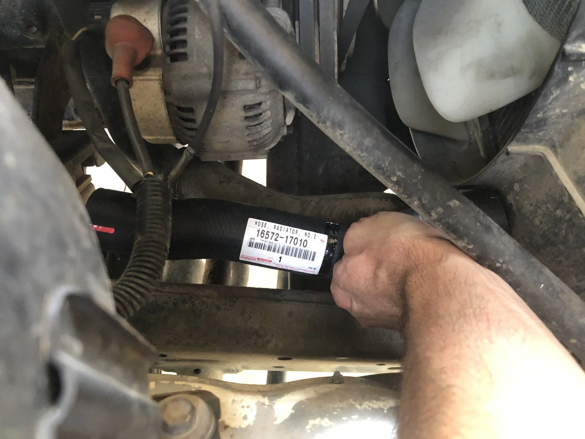

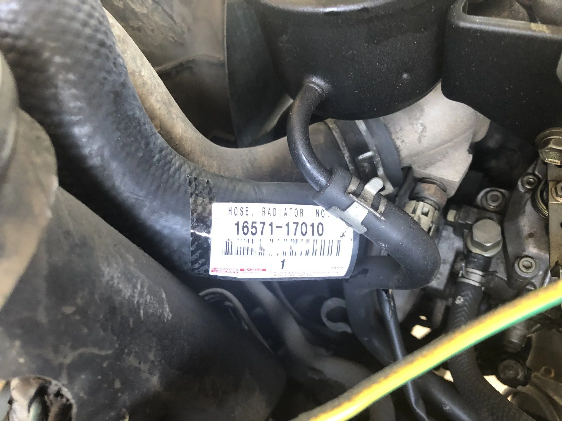

Part numbers for radiator hoses. I have new clamps too.

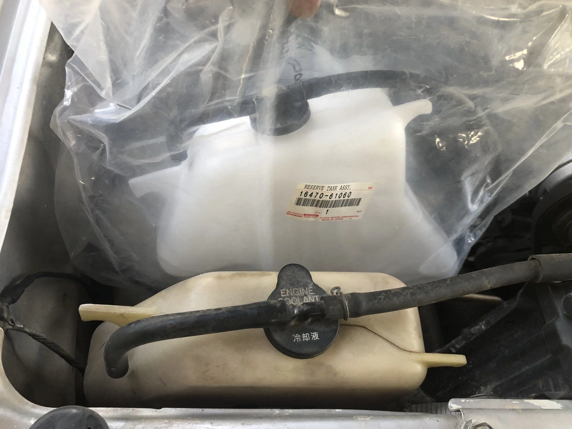

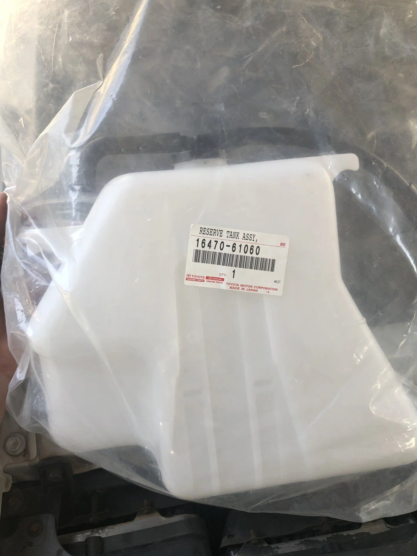

The overflow bottle was available new for 30 bucks. Couldn’t resist. Say goodbye to brittle 27-year-old plastic. I can’t believe Toyota still makes these parts. I try to take advantage of little things like this while they are still available new OEM.

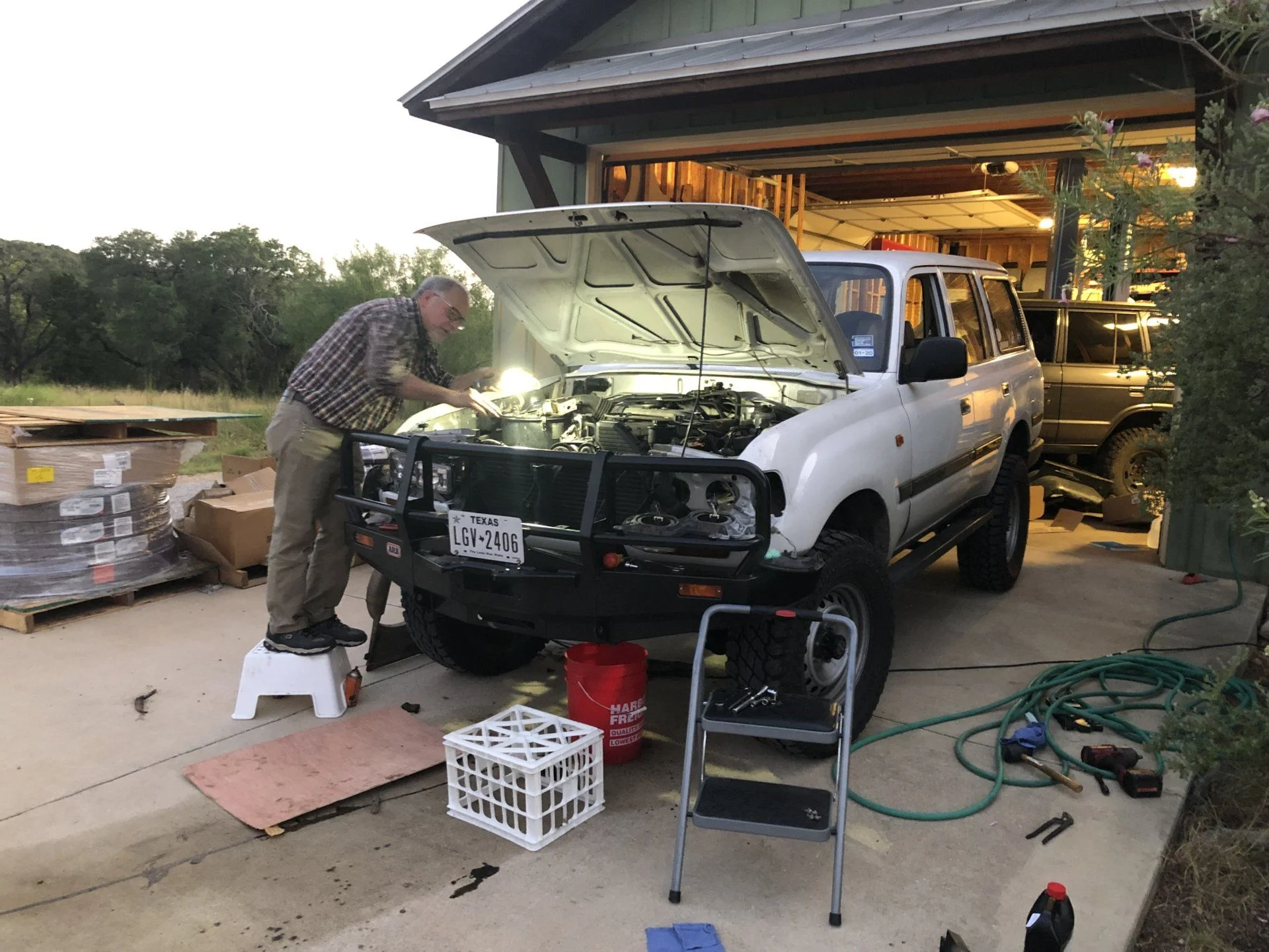

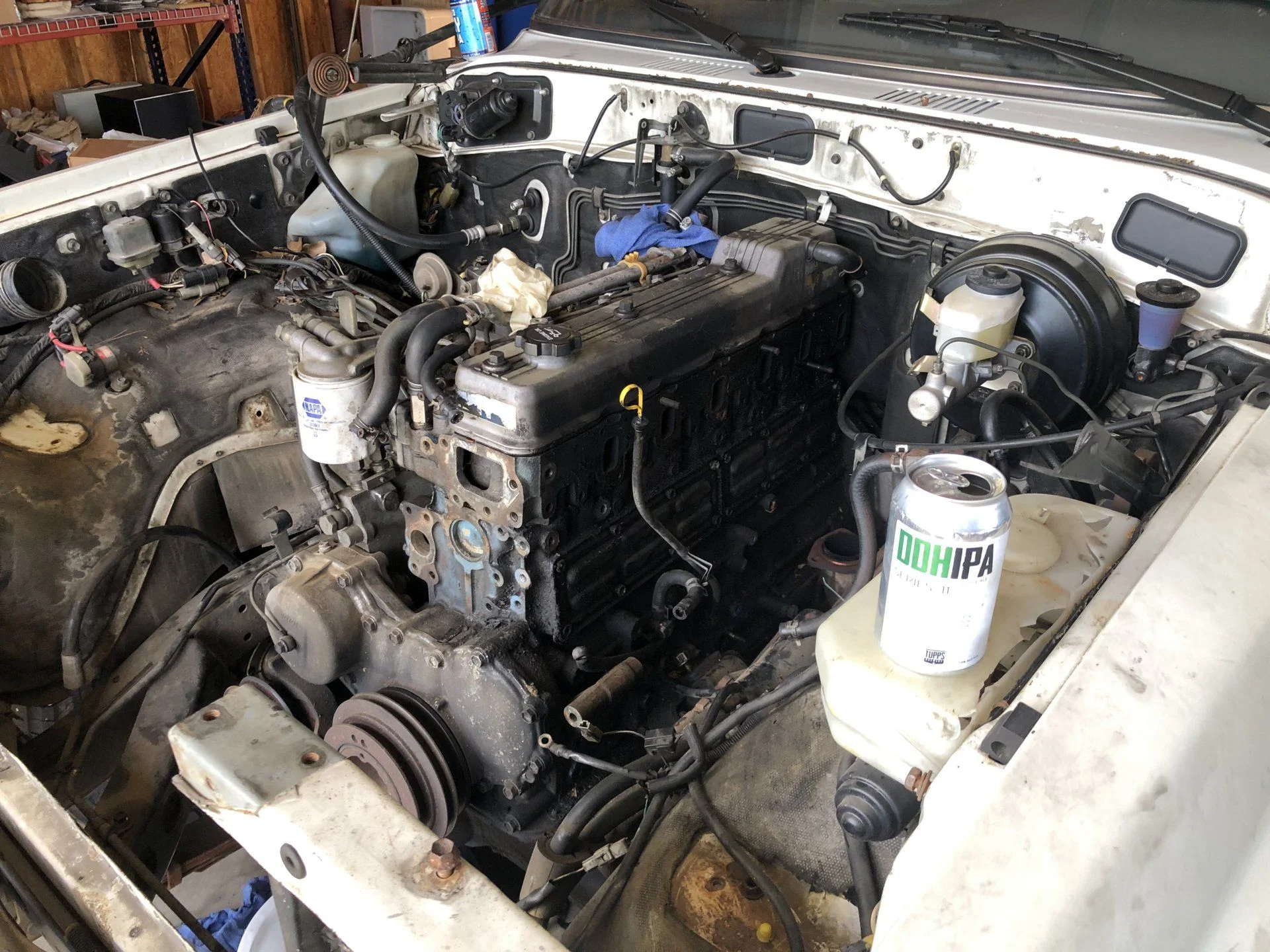

Today I had an early day at work and I was able to get out to the new place and swap the cooling system.
It was 100° in Austin today and the temp gauge was almost pegged into the red on the highway at 60mph. I had to roll the windows down and turn the heat up to full blast to keep things from seriously overheating. Perfect timing for a cooling overhaul.
A friend from work, Kevin, the best x-ray tech on the planet, stopped by to check out our new place. I showed him around the house and property and before you knew it, he rolled up his sleeves and dug in to to help me. A true friend, he reached into his pick up and pulled out a cooler with a couple of Founders IPAs.

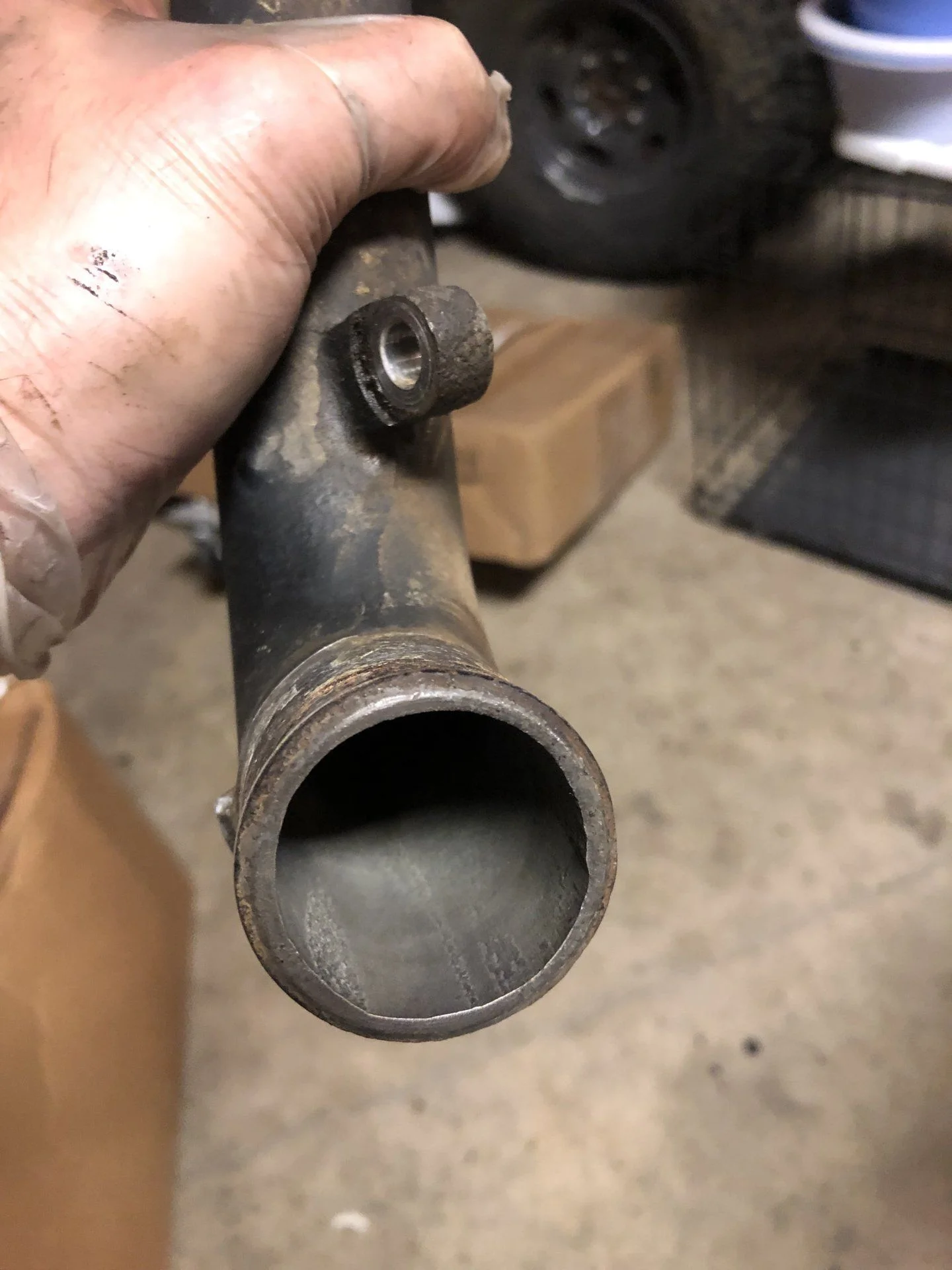

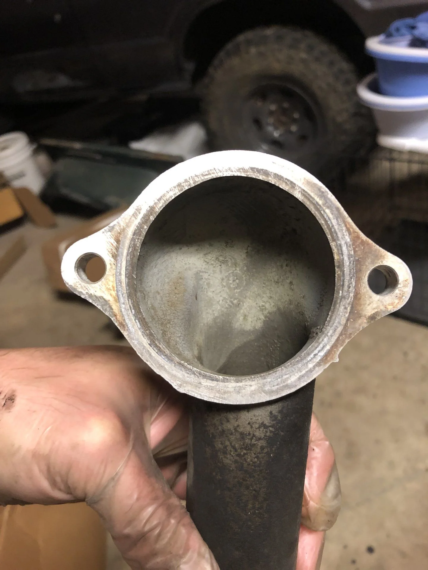

With the two of us working (and fueled by excellent beer) we were able to get the front end apart enough to get the old radiator out. As I drained the coolant, it looked like muddy brown water. We stuck a garden hose in the top radiator hose and flushed the block, and it ran clean and clear surprisingly quickly. We flushed the heater circuit and got nothing more out. I didn’t even feel the need to open the petcock on the block to drain it.

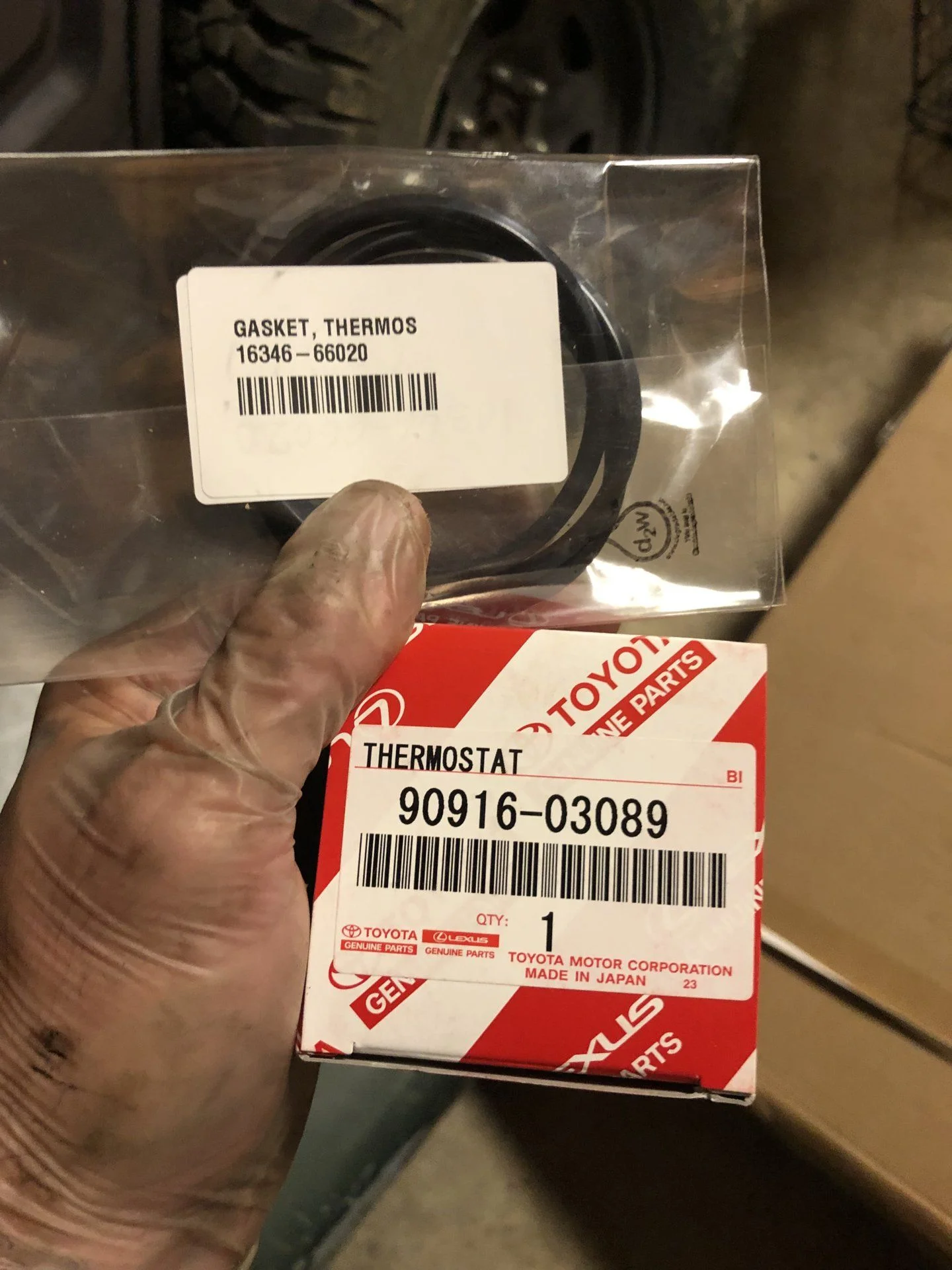

The thermostat was aftermarket but looked pretty new. OEM t-stat and gasket went in. Both water inlet and outlet from the block were clean and had no sediment or corrosion. I did not replace them.
Thermostat and gasket part numbers for
posterity:
