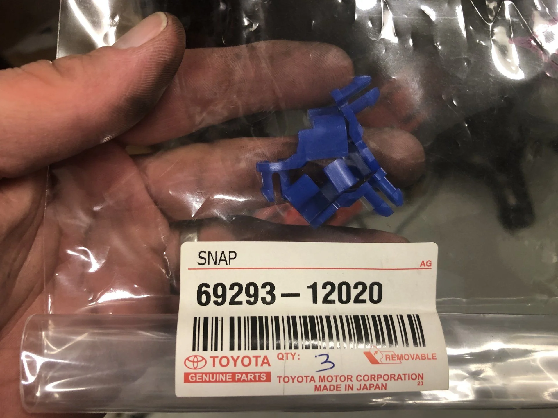

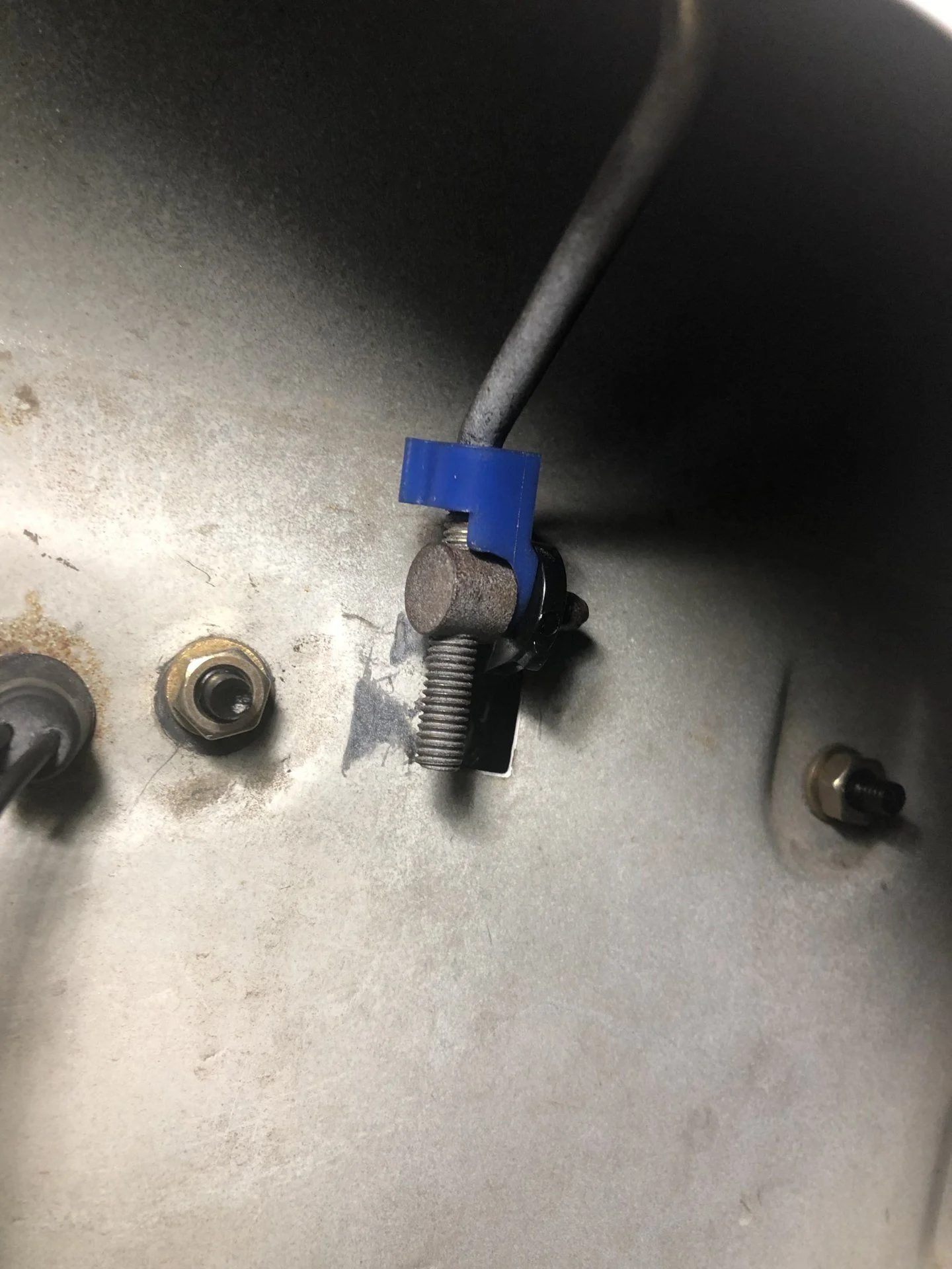

Barn door latch linkage:
The $1.36 plastic latch for the barn door linkage came in. It is actually beautifully engineered and incredibly simple. Just like most Toyota designs.
The barn door latch now has full function.

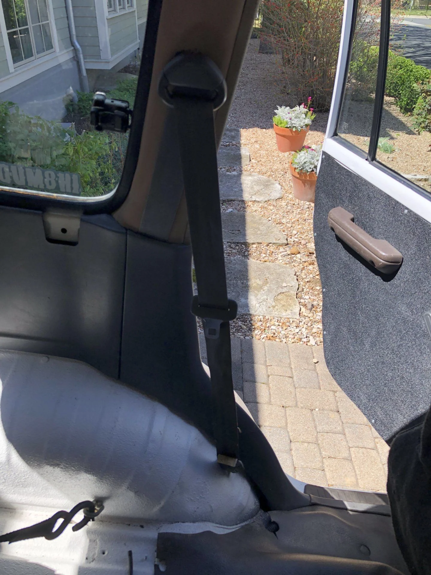

Rear seatbelt installation:

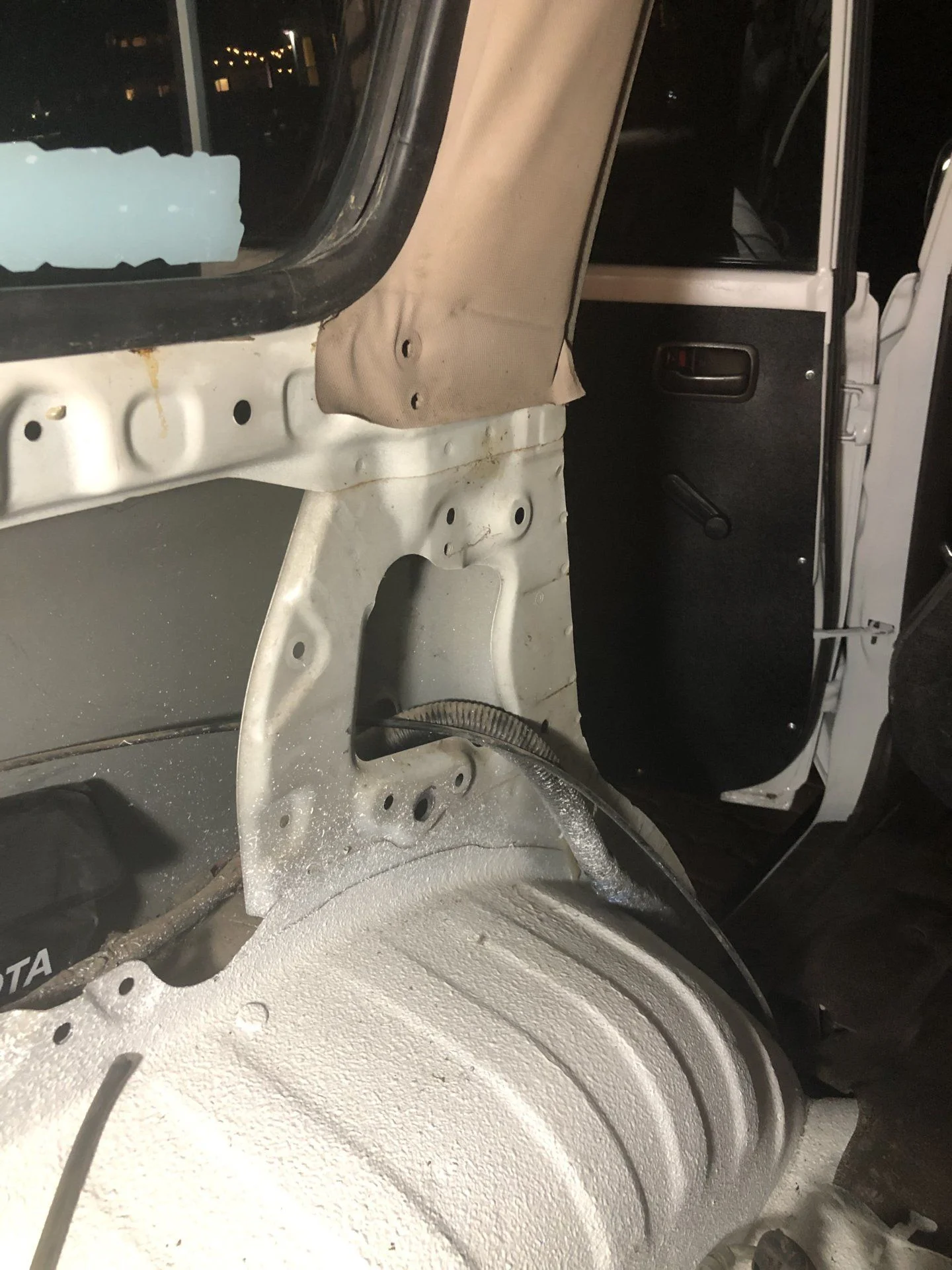

Last night I grabbed my new used seatbelts and went to install them only to find out that the sheet-metal cut out on the C pillar is lacking a welded nut on the backside.

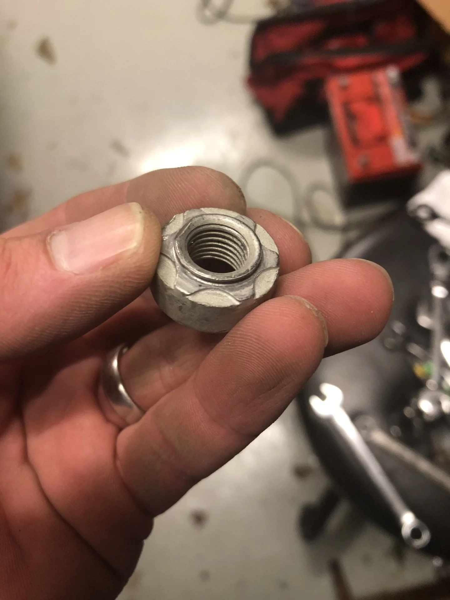

I found some 7/16 x 20 captured nuts on a set of installation brackets for a pair of Humvee seatbelts that I had put into my FJ40. At times like this I’m glad that I hoard seemingly useless things and never throw anything away.
On the right, I drilled the sheet metal out a tiny bit with a step drill and JB welded the right side into place. On the left side, I dropped the nut into a chasm of despair....the gulch between the inner and outer fender wells at the C pillar. Fark.
I came back tonight and rigged up a piece of flexible plastic tubing with a strong magnet gorilla taped to the end. I went fishing down the surprisingly small and inaccessible gap between the inner and outer right fender wells, and was able to finally take out the captive nut. I JB welded it back into place this time with a zip tie over top of it for safety.
I was able to get the right rear seatbelt in place and cover it with my new to me gray C pillar trim.
The gray conversion is now 1/4 done. And 2/3 of my kids can safely ride in the 80.

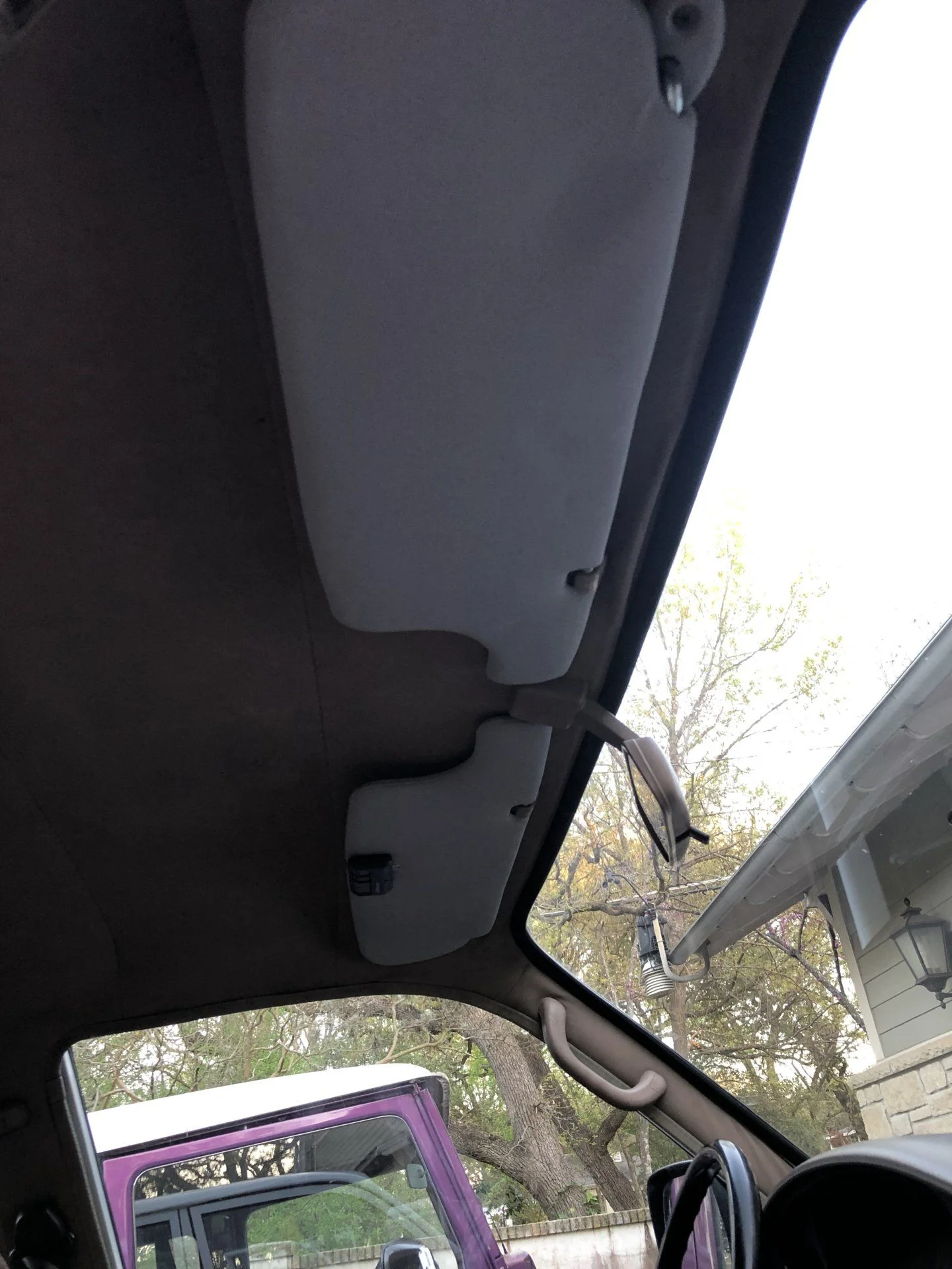

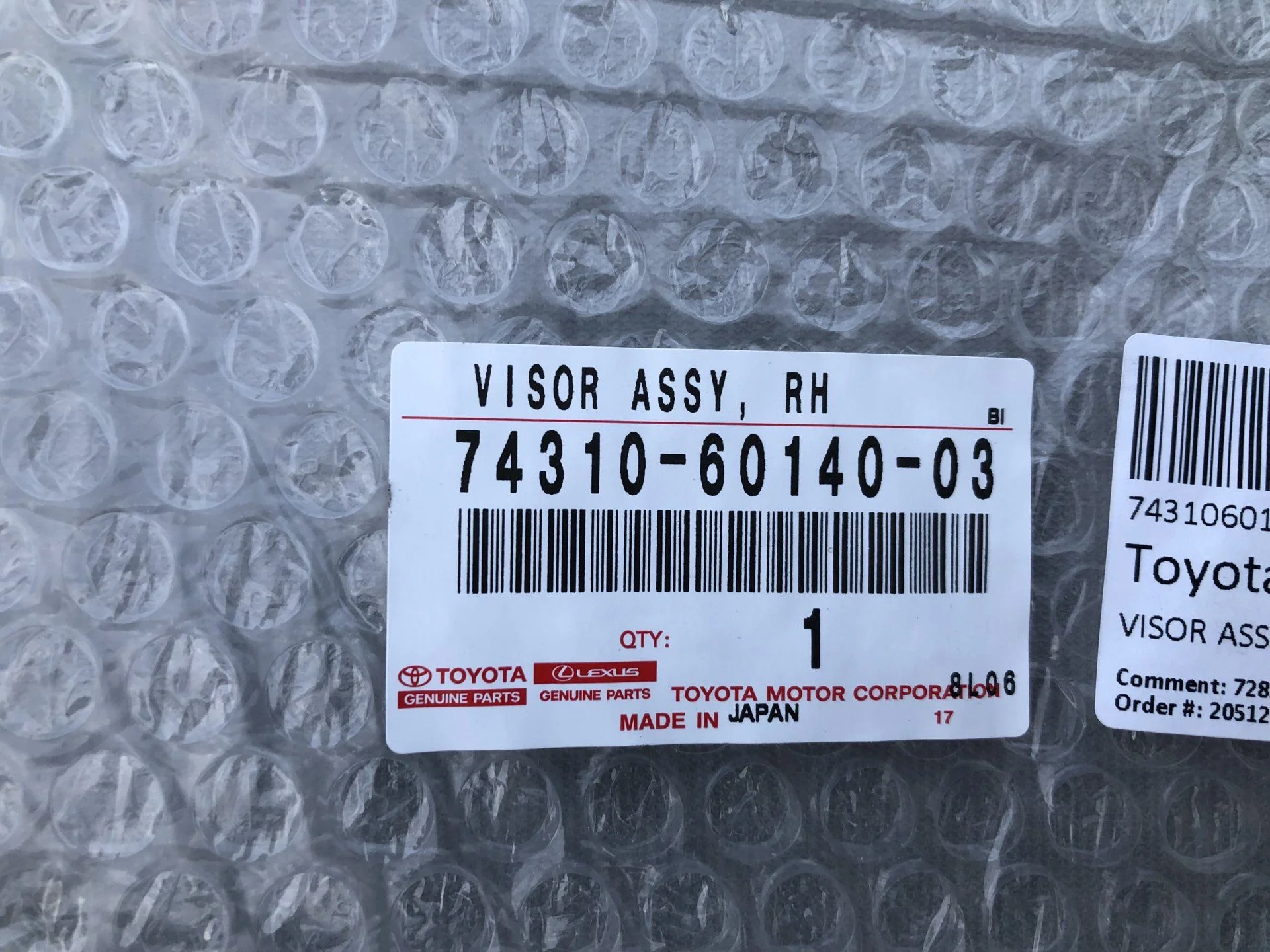

Passenger visor:
While it may seem silly to post up on every little thing I’m doing, I’m really doing it to keep track of the part numbers. I have been trying to keep track of part numbers for my various cruisers on different spreadsheets on my laptop but I find myself getting sloppy. So I’m posting here for posterity.
But I do have two functioning sun visors now.
Left rear seat belt in.
Gray conversion 32% done.
