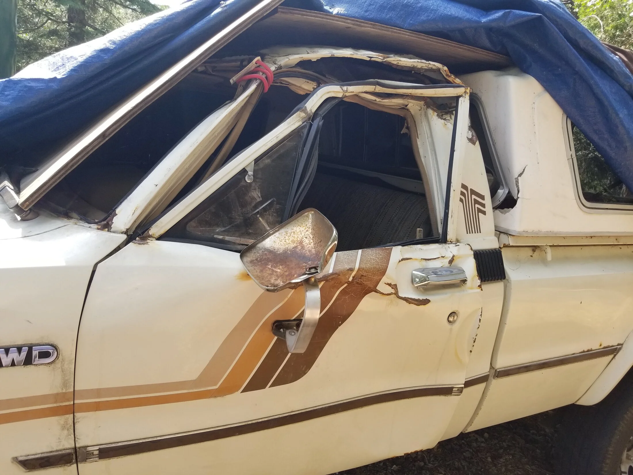

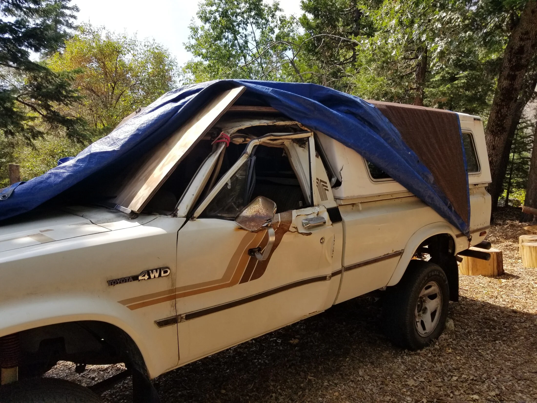

I had been offered the vehicle identified in the subject, but the cabin is rather damaged, please see the pictures:
The damage was sustained about two years ago, when a branch broke of a tree due to heavy snow coverage and flattened the roof of the cabin. My friend wanted to fix it for his son, so he straightened the roof, but then abandoned the project and offered it to me for free. It is rather rust free, the engine starts and runs, and it is moving under its own power.
The problem is that although I had been working on my cars, I know nothing about this Toyota. As such, I have done some research, e.g., I understand a cabin from 2WD will not fit without modification, found a company that makes replacement fenders, hood, and bed, but not a cabin. So, I want to ask the members:
1. What years of cabins would fit, so that I have a little wider choice. In that respect, I can do simple modifications, e.g., relocated the mount points, modify the central section for a shifter and transfer-case stick, and the like. Would an Xtra cab fit with such minor modifications and either shortening the bed or making it a flat-bed?
2. Where should I look for such a cabin? I tried the usual suspects, Craigslist, e-bay. I have a junk yard about 1.5 hours drive away, but they will not list the vehicles that they have, so every trip there is a gamble, and considering that I would need to ask a friend with truck to go along, so this option is rather difficult
3. Is there a good resource showing removing a cabin, so that I can estimate the time if I were to find a junk-yard one?
4. Anything else that I might be missing?
