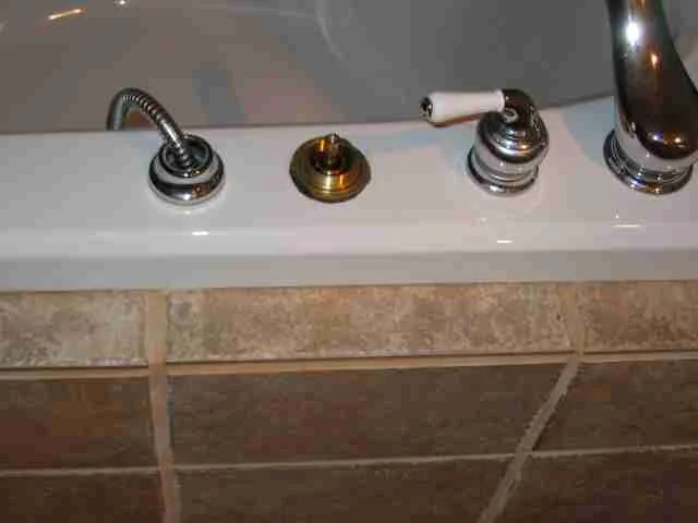

I've got a 7 year old Moen fixture on our bathtub. The valve that controls the hand rinse thingy doesn't totally shut off the flow completely anymore. It used to work fine until about 3 months ago. I've been directed to get this fixed. :rolleyes: as it can make a mess.
Of course it's tiled around the side of the tub so I can't get at the unit from the side or underneath.

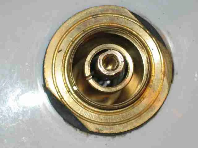

I pulled off what I could easily, thinking it would have a cartridge or something I could service from above. The second pic is how far I got.
Note the notch in the ring, it looks like it's a groove for some SST. Anybody know how to fix this sort of thing short of pulling tiles :rolleyes: and or calling a plumber? I bet calling a plumber would cost me my future onboard air CO2 tank system. :banana: :banana:
have you contacted moen yet, they offer life time wrranties on there products. i used to have one of there kitchen faucets and when it broke i just called them, told them what happened and they sent the parts for free. i dont have the # any more but go to the hardware store and look at a moen box or just try the internet, do you know the part # of the fixture, you could maybe send them the pic. and from the looks of the pic it does take a special tool or a big cresent wrench to remove, it looks like it unscrews because of the 2 flat sides kinda like a hub socket. from the sounds of it though it sounds like it needs a new seal or seat in it, it might be cuased from over tightning it when turning it of or just from age. hope some of this helps hard to say without being there but i have done my fare share of plumbing. good luck!
Sounds like it needs a new seat. Search on line for info about rebuilding faucets or stems. It's not too hard and shouldn't cost but a few dollars for new seals and such.
I've rebuilt lots of faucets over the years. Problem is that this diverter thing is very different from your typical faucet. The large nut you see simply holds the assembly up to the tub surface. I need to pull out the center of it somehow. I think the slotted groove plays a role in that but I'm not sure.
