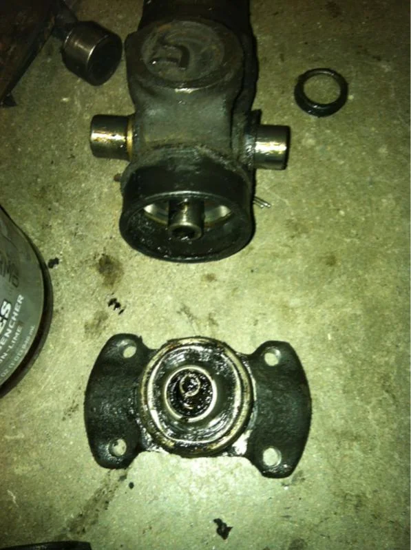

Please tell me this CV end just slides back on

So I'm replacing all my DL u-joints trouble shooting some weird vibration. While taking out the old Ujoints, this part of the CV. Separated. There is a little spring that goes into the tube at the DL end and the separated part has needle bearings in it (bottom of pic). Please tell me I just grease it, make sure the needle bearings are all in place, and slide it back on. If not what's my options?

If that small part is replaceable I take it that it does come apart. I'll see how much a new one is while apart. Thanks
I'm not looking that small part up correctly. What's its technical name? I keep getting the axle cv on searches. In bottom of pic. . Thanks

No. SM420 to Dana 18 with a Grand Cherokee CV top and FJ40 lower Driveline. It's called a CV ball joint. Had to post in the general section for the identification and found one at Rock Auto. When I got to replacing the 40's section of the DL, I could slide the joint back and forth. It had about 1/4" of play in it. I think that was the culprit. I still need to get a replacement joint for that so it's either the Dealership or order one online. I'll need a press to get that one out and a new joint back in.

Centering Ball Assy. If that is worn/busted your drive line would not be spinning on its axis, but in an orbit around the axis.

Thanks Drake. There are a bunch of common names for that part, but it was challenging finding the correct name to get a part number. I will know if i need that part after a test drive.
After replacing the 1350 joints, I moved to the Cruiser end. I could slide the joint up and down 1/4" while inside the driveline. I figure that was the problem. It was wobbling around at the axle end. I would think that was my problem. (hopefully).
