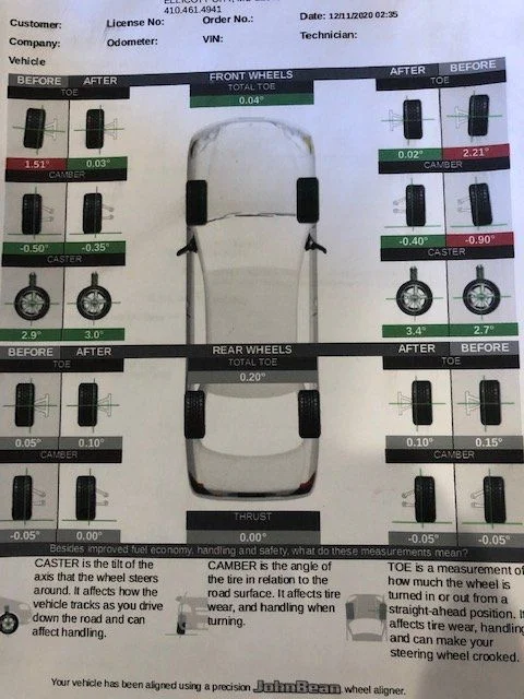

Also, the loose steering - reading several posts on the web, it seems it has something to do with alignment. Although, I got the alignment done right after the suspension work so not sure what to do. I'm attaching the alignment specs below, so let me know if you think anything is out of whack. Also, would putting new wheels and tires now might improve this issue or do you think i should wait until this problem is resolved?

My caster is set at 3.0/3.4 - maybe if I have them increase that it might help with the steering issue. The steering is not as responsive as it used to be before the lift.

The caster at 3 is on low side. Normally 3.5-4° is ideal. More would give better high-speed stability but tax the power steering more.
