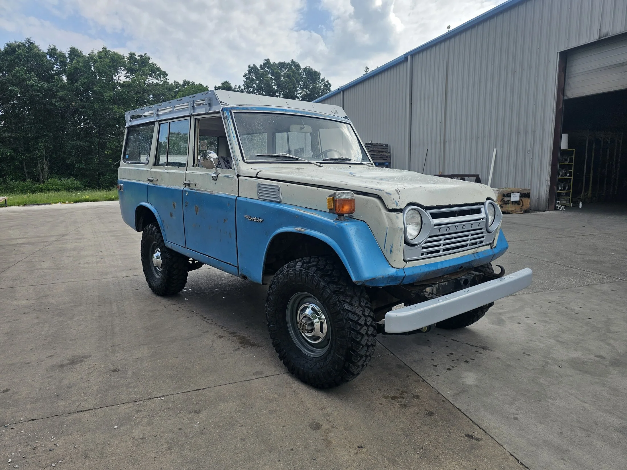

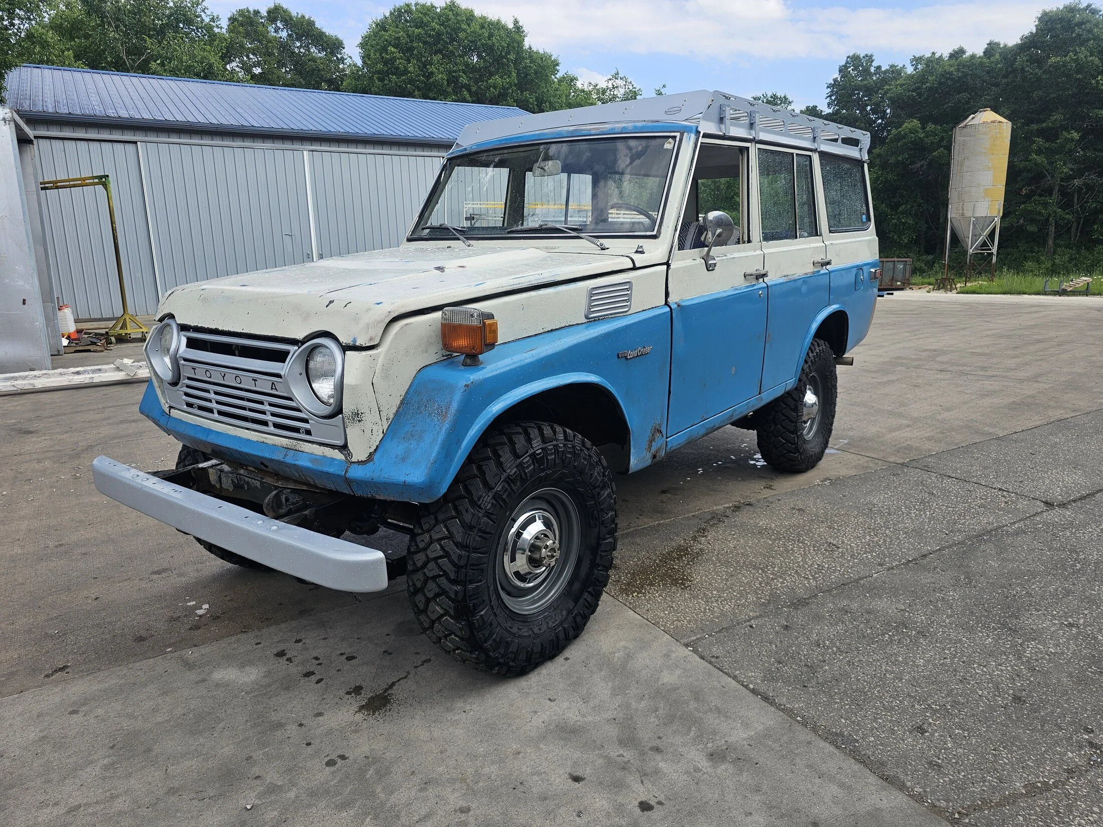

We wound up noticing a slow leak in the radiator 2 weeks ago. Ugh.... Out it came and off for a re-core job. A small fortune later, we have it back in the truck and running. I still have to drive it farther that around the turnaround in our parking lot, lol.

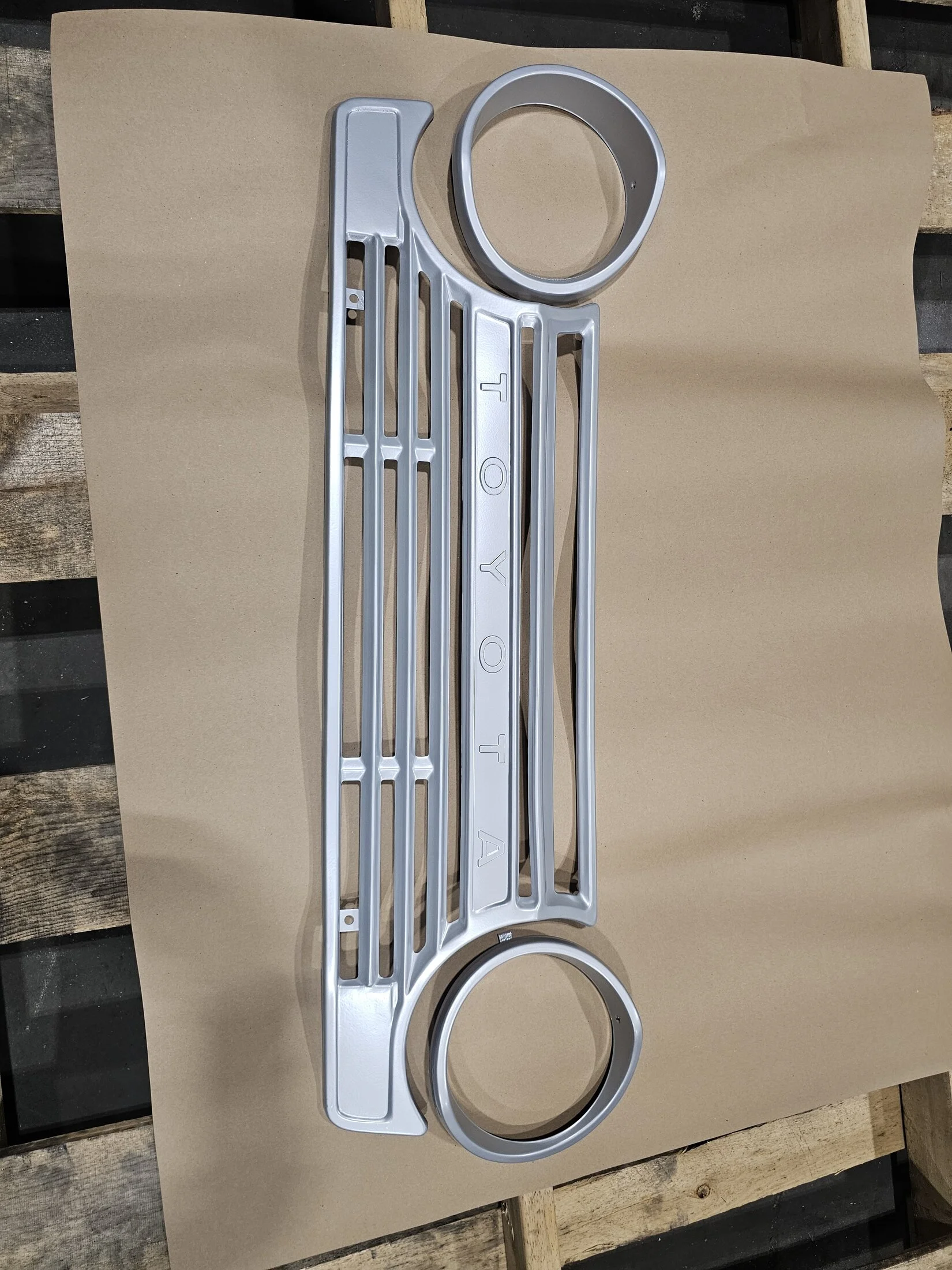

Anywhoo, front bumper and grill are powder coated. Still working on the rear bumper then it will be coated.
Another big distraction was the treasure stash for my FJ-45 from by buddy @landcrusher909. Looking forward to getting after that project soonish
First pictures after a quick rinse off and lap of the parking lot

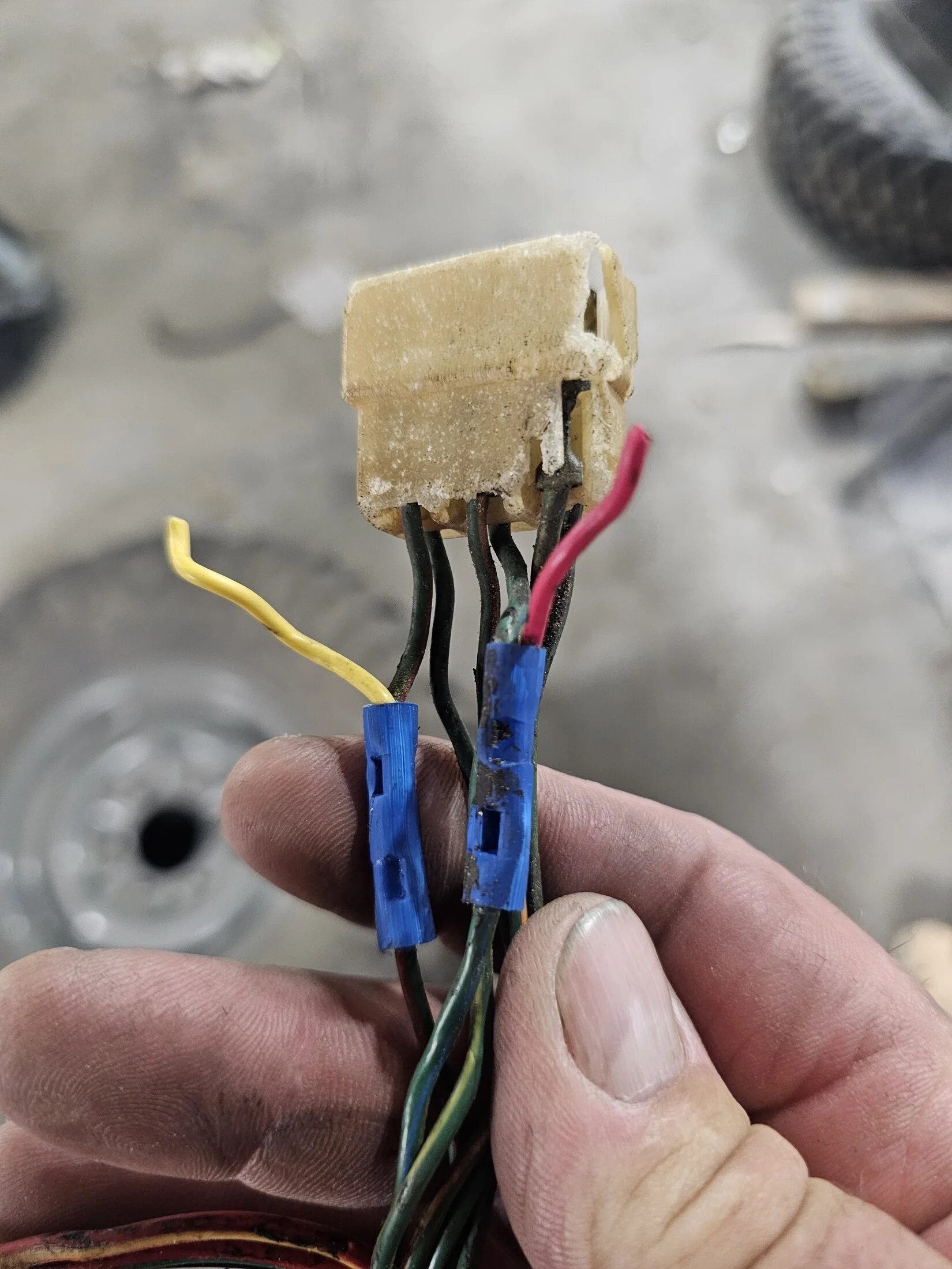

We have been chasing electrical issues on the truck. I get weird indicator lights on the dash and turn signal issues, plus a RR brake light non-op. It had a K-mart stereo from the 80's in it and we discovered some seriously botched wiring. They tapped into the turn signal circuit for radio powder. So we have a new Toyota turn signal switch and harness coming, a new brake light switch, and pulled all the old radio stuff and we'll see if that helps things.View attachment 3638398View attachment 3638399View attachment 3638400

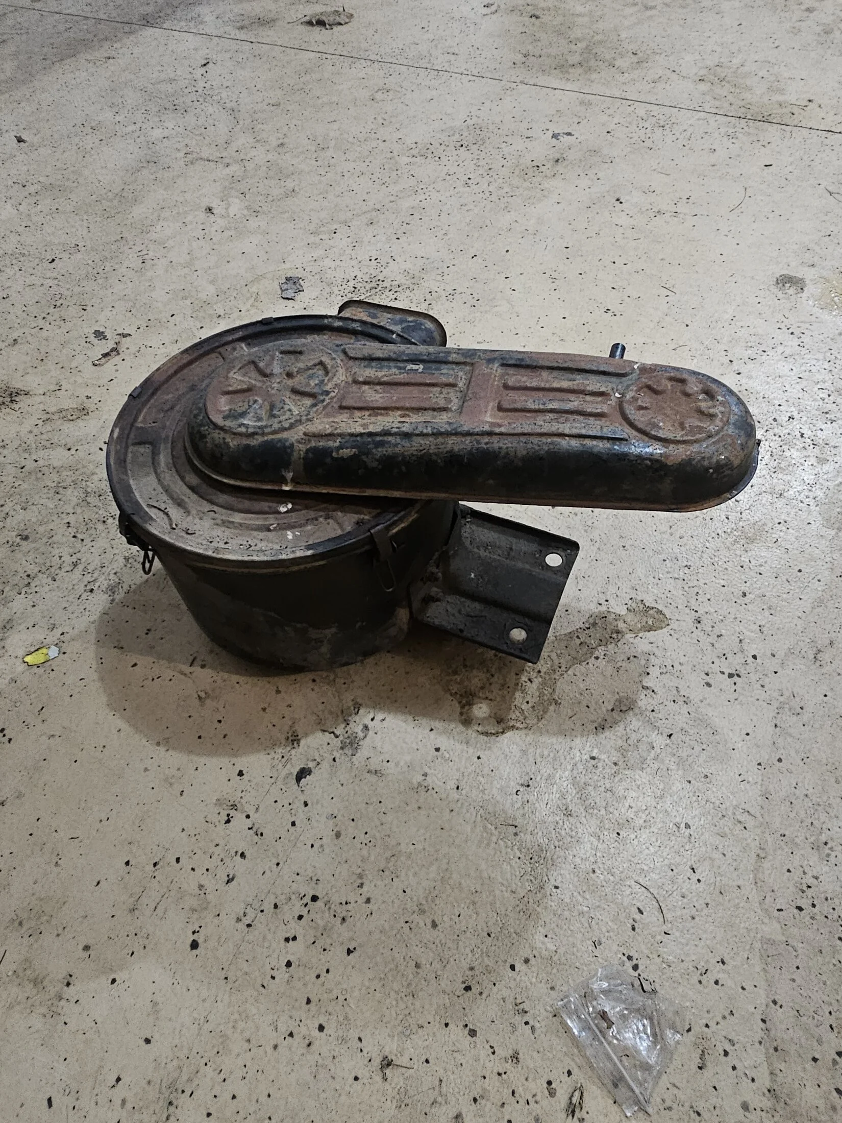

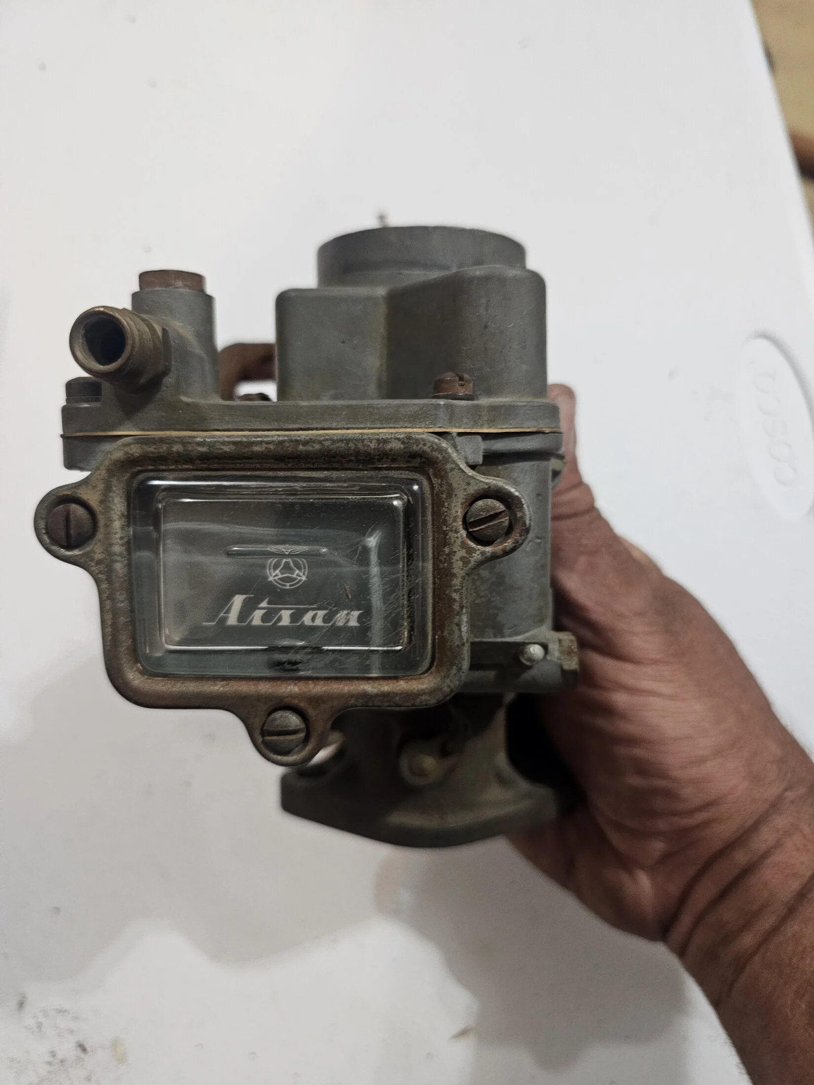

Another big distraction was the treasure stash for my FJ-45 from by buddy @landcrusher909. Looking forward to getting after that project soonishView attachment 3659226View attachment 3659227View attachment 3659228View attachment 3659229
Big window carb - so cool!
