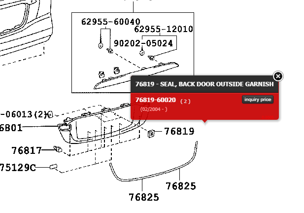

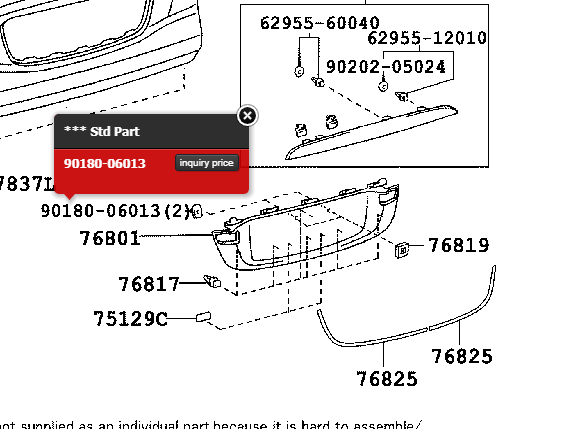

Here you are:
japan-parts.eu gx470

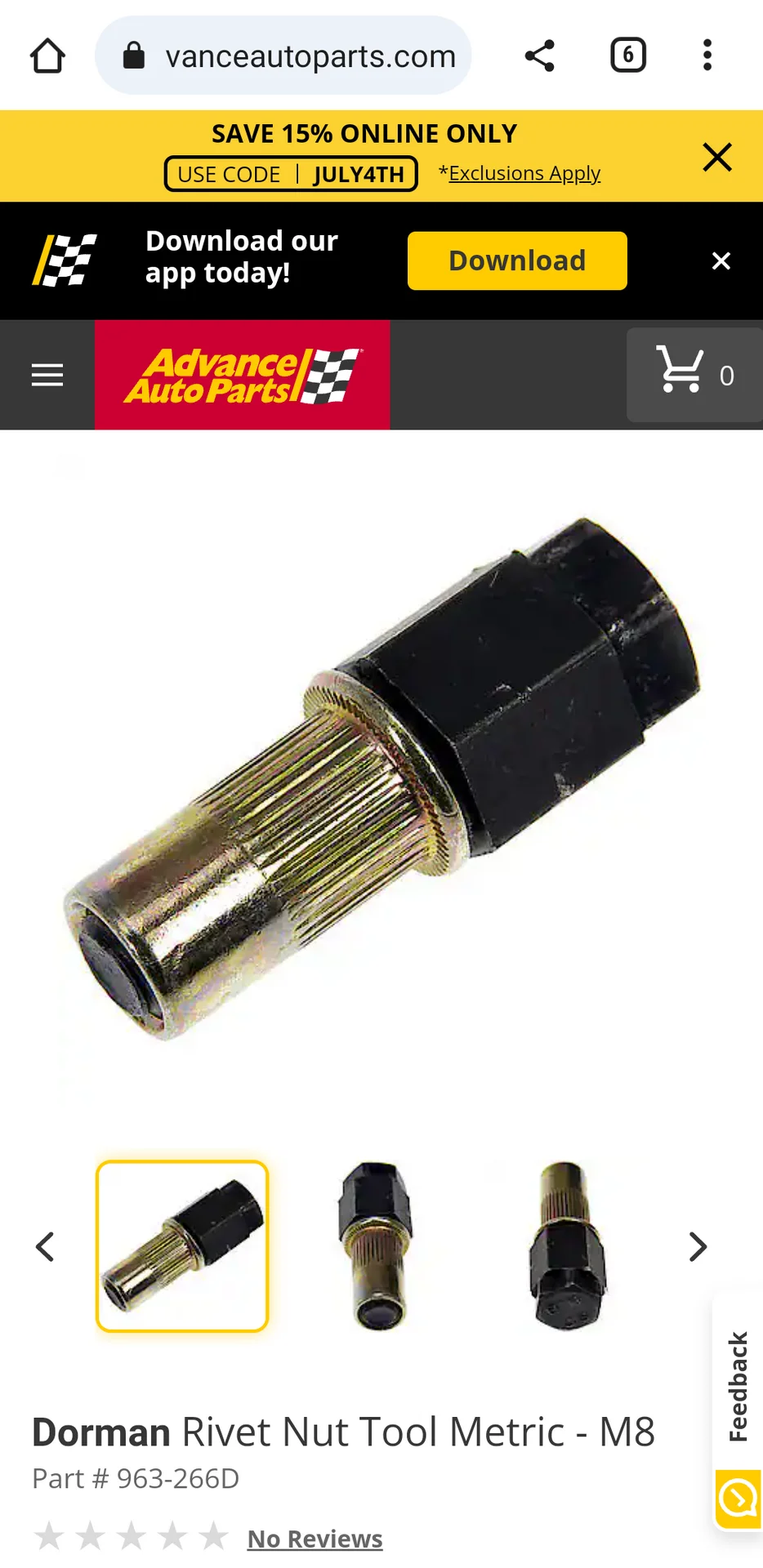

FWIW mine were stuck/rusted so I replaced with some M8 rivnuts
