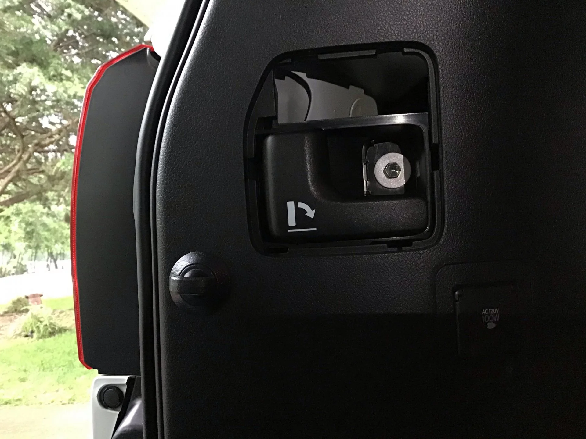

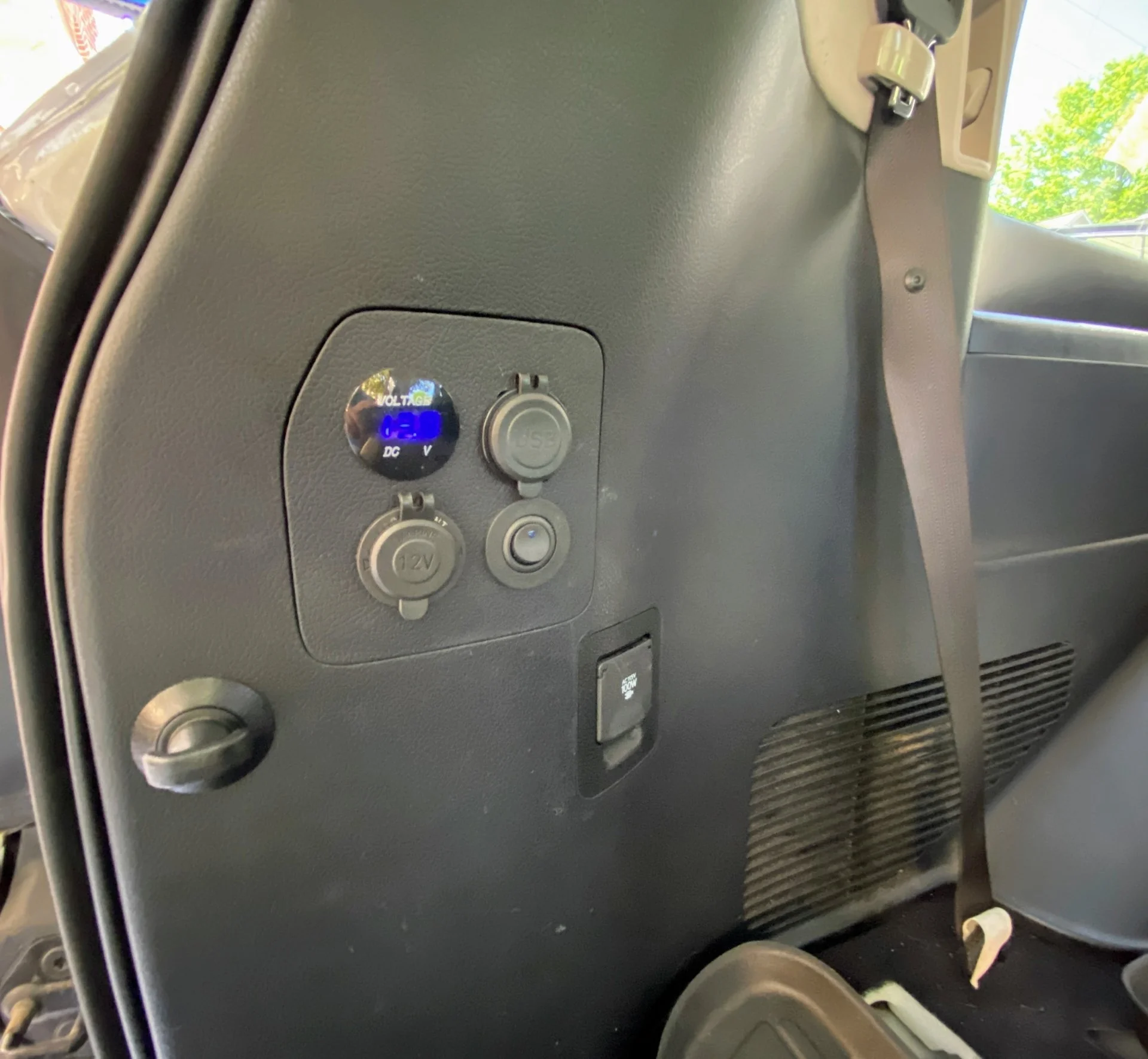

Does anyone know if the LX blank panel that goes where the lever is to release the third row seats in a LC is located will work in an LC? I no longer have my third row. The lever does not bother me, but I'd like to use that space for my electrical outlets. I saw BigMF did that in his LX, I'm guessing an LX has electric third row, or perhaps they don't all have a third row. Either way, does anyone know if they will work in a LC?
Thanks!
BigMF's setup

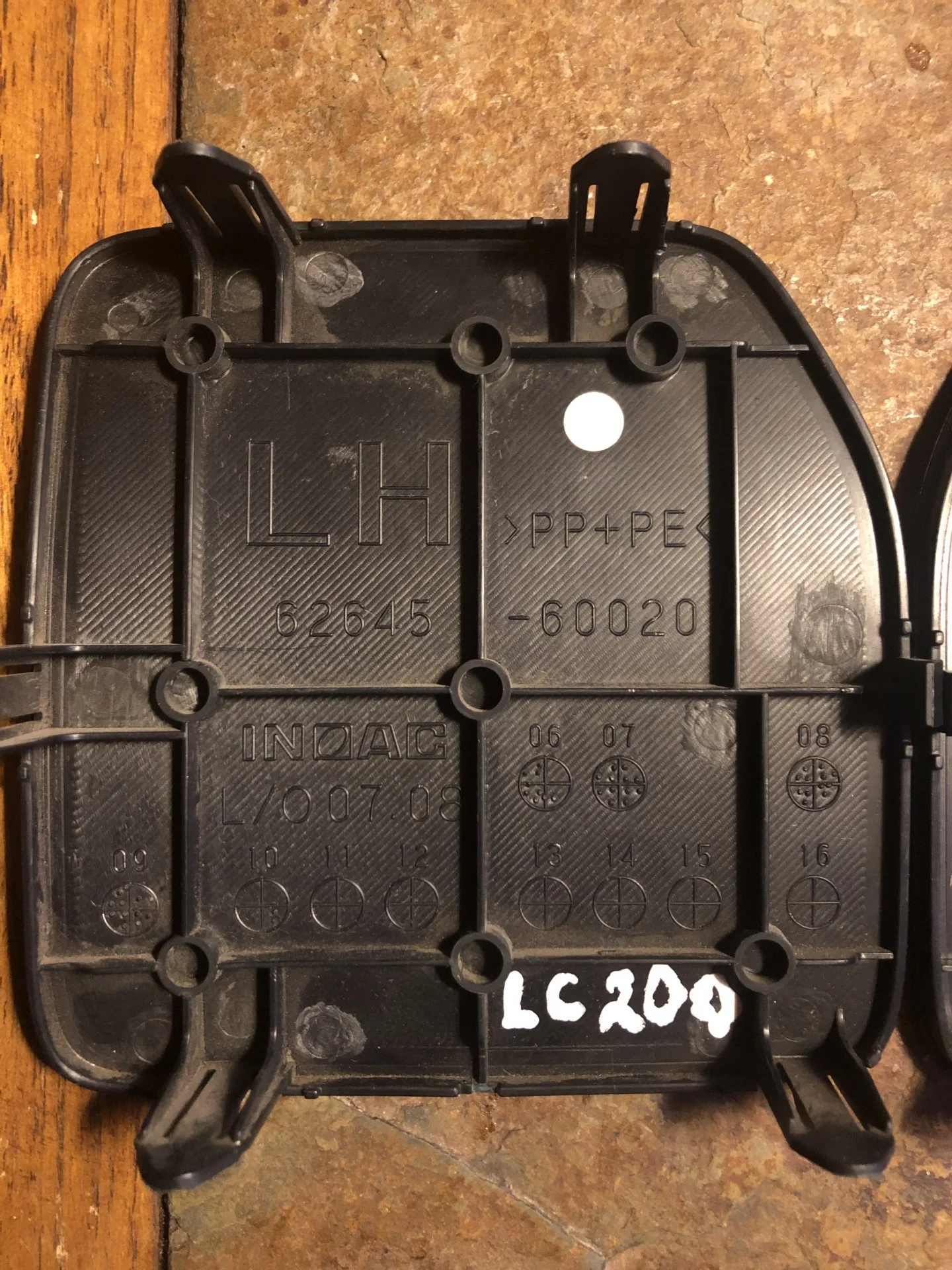

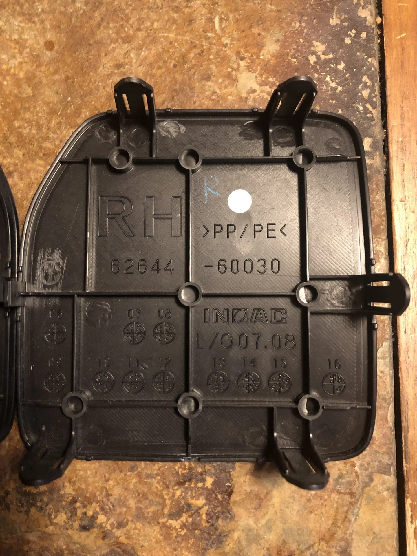

There are Toyota parts numbers for that blank panel. One is readily available in the US since I think the ‘18+ uses it, and the other was available overseas when I was shopping. It may be available in the us now because it may be used in the 2 row HE?
62645-60020 (left)
62644-60030 (right)
it’ll have a -C0 ending for black.

Confirmed. 2 row H.E. has that blank cover on both sides of rear.
Thanks CharlieS for the part numbers and thanks MTN2SND for confirmation they are used in the 2 row HE!
I punched the part numbers into the website of my local dealer, the parts guy will call me tomorrow and confirm if he can get them!
Thanks!!!!
If not, just look at the online dealer parts sites - you may find a better price. IIRC, they’re about $15 each. I bought extras for mine so I could revert back to stock later if I decide to remove my outlets. Just pay attention to color codes to make sure you match your interior.
I got them on-line for ~$18 each and $8 shipping which was less than my dealer was going to charge me. Ordered them this morning!

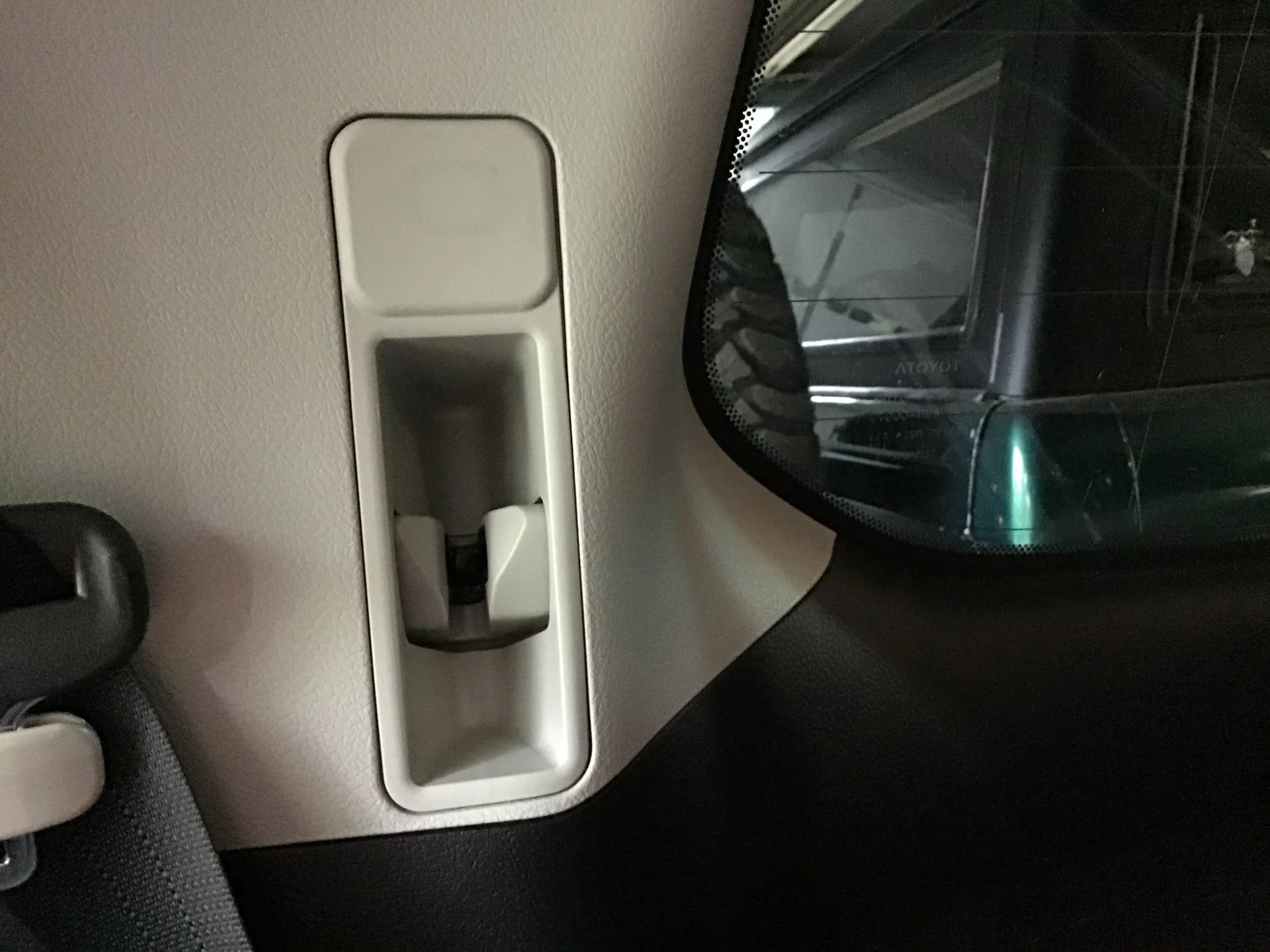

Another question regarding the HE. What is in the location where the actual latch is in a 3 row model?
I'm talking about here? That would be a great place for some LED lights to illuminate my cargo area.
Upper panel on 2 row H.E. doesn't have openings for seat belt or seat.

Can't help you there. Rear upper pannel on 2 row H.E. is one solid piece and doesn't have openings for seat bracket anchor or seat belt.
