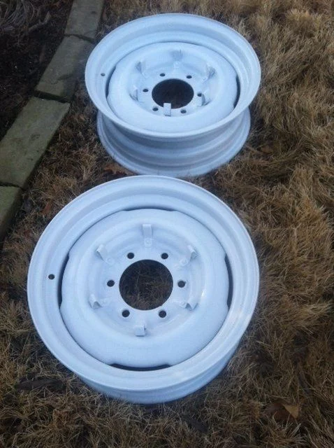

I've painted lots of powder coated items. I'd use a de-greaser, like simple green etc. and a scotchbrite pad to thouroughly clean the wheels, wipe down with alcohol and rattle can away. My .02

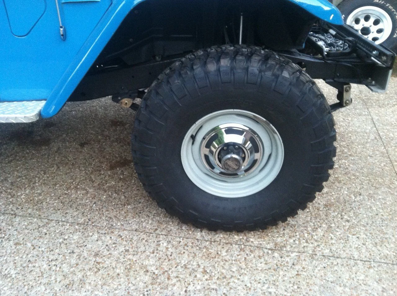

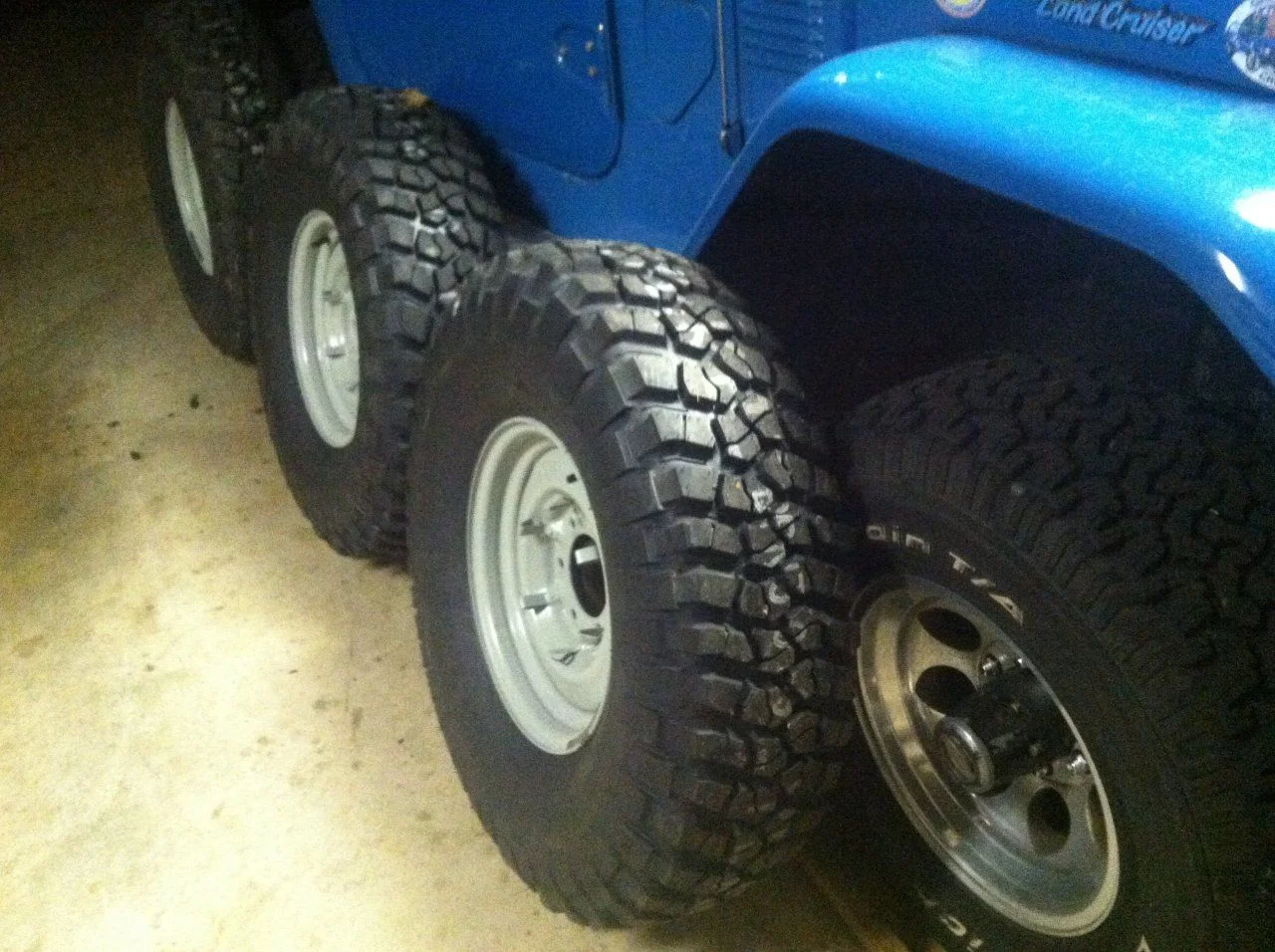

Decided to just paint them.Preped and then primed. They look great today.
They're 33x10.5x15s BFG KM2s. Thanks
